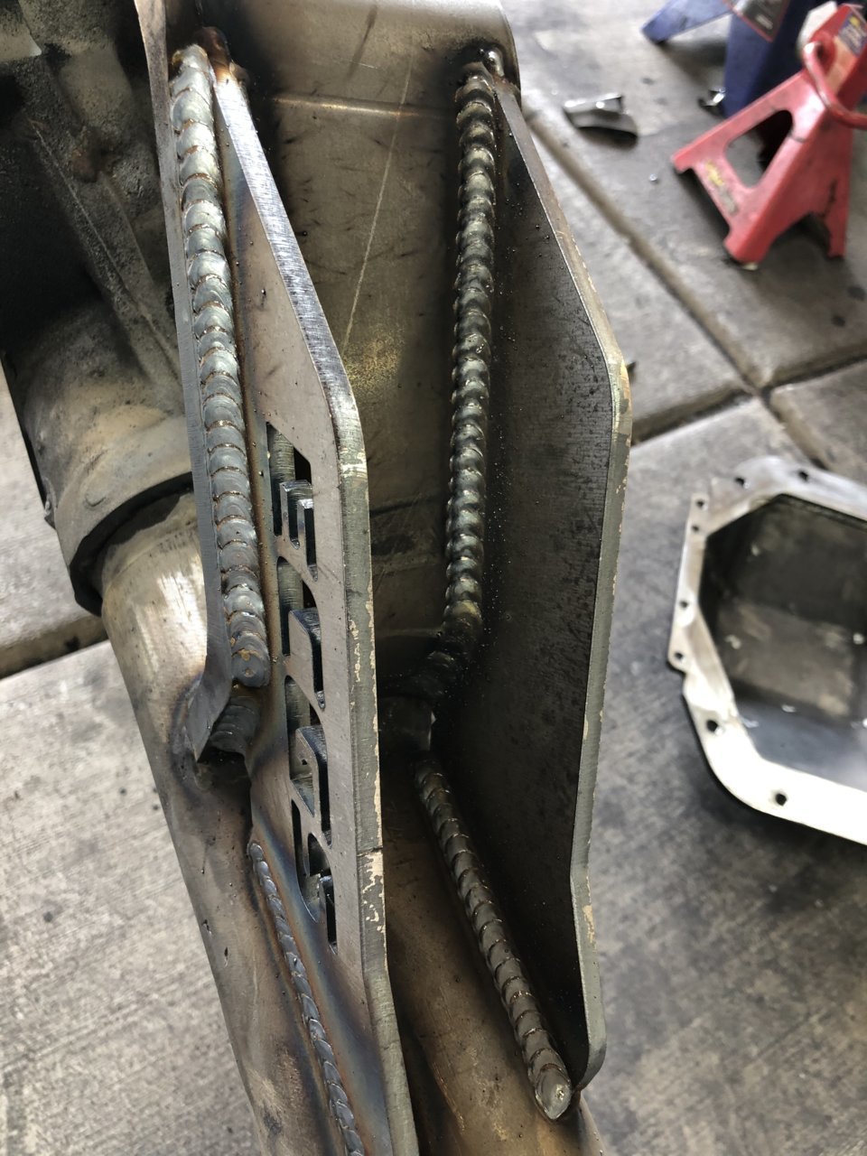

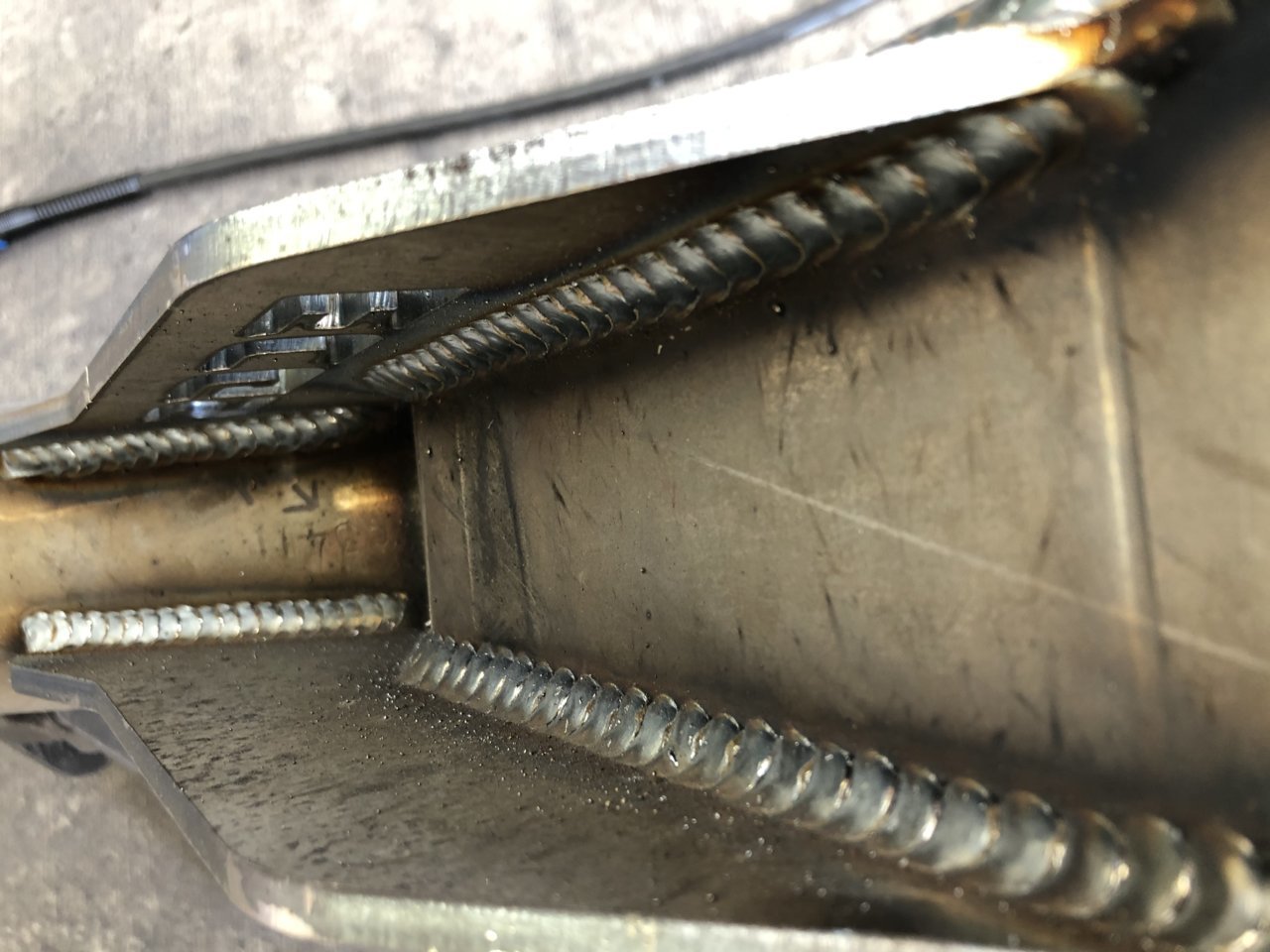

    Check Build thread
    Few fun ones of some gussets that are gonna get covered up by a bigger truss 07BD0C89-DAE9-4639-AD4D-D0BFC3CF08F2.jpg
