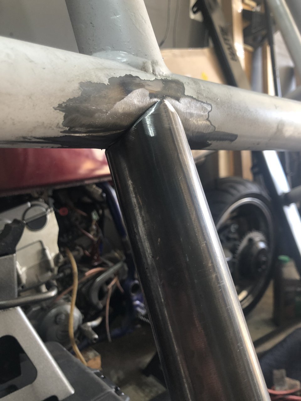

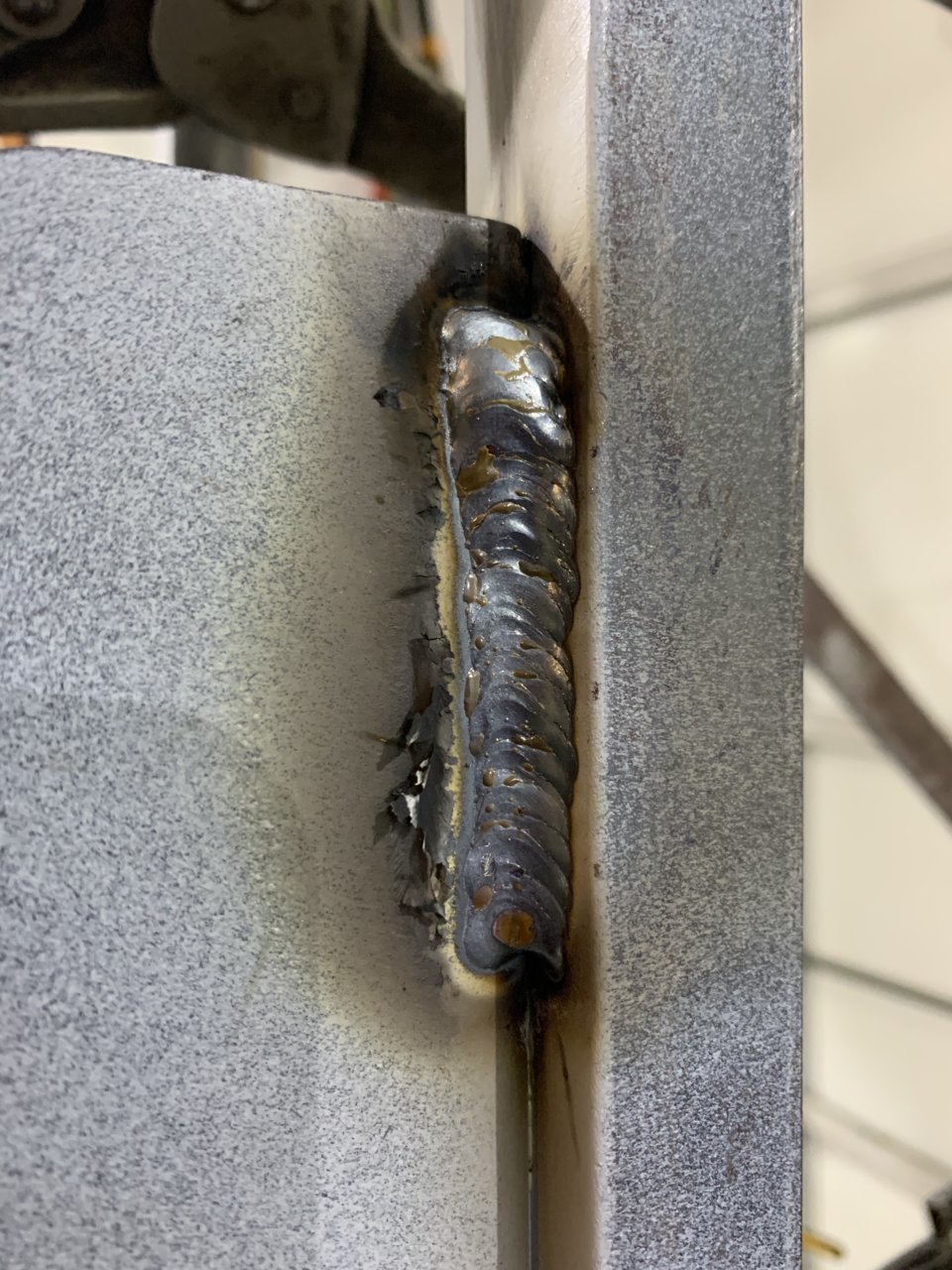

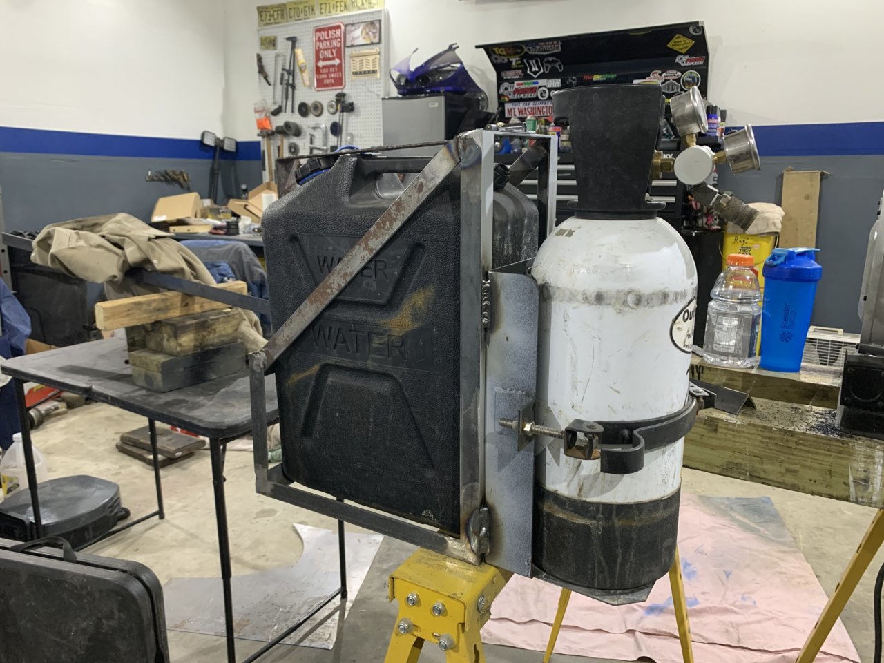

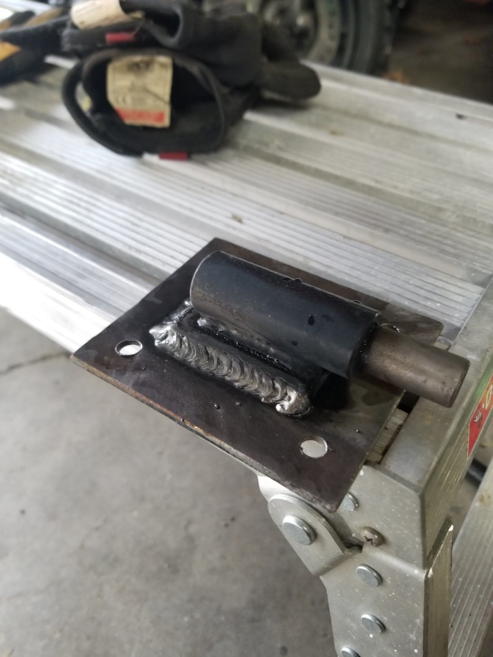

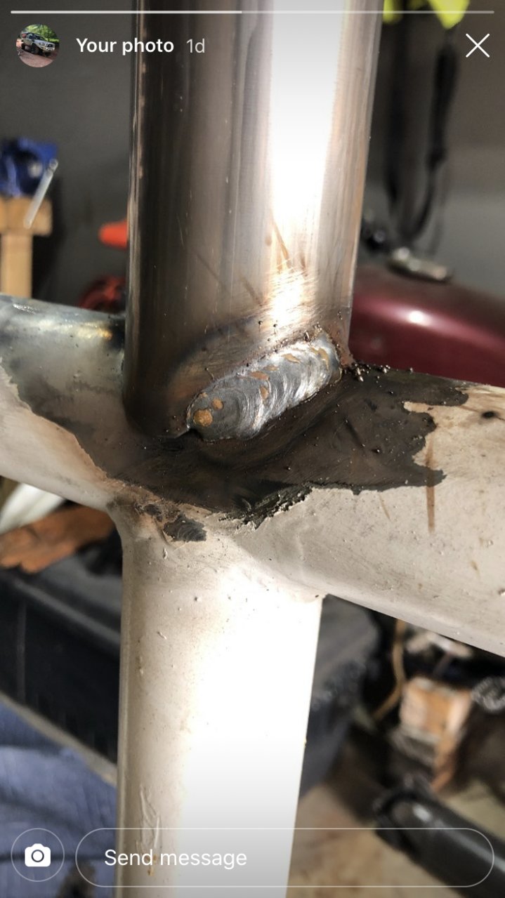

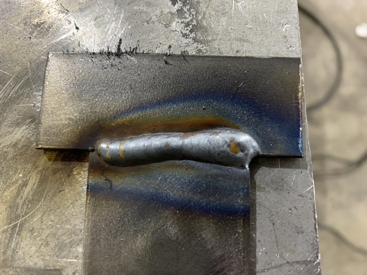

    Drop bracket lift and booger welds
    Bad weld:
    Weld I’m happy with:
    So so weld.

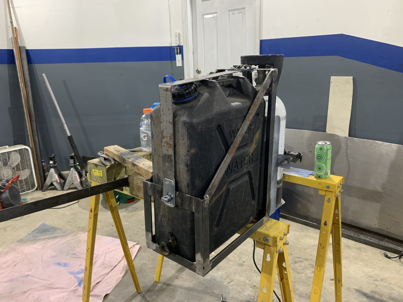

    I finished this today:
    I am only half happy with it. Mostly because I built half of it with 6013 and a stick welder, so slag pockets are trapped in some corners. Then it wasn’t square, so I cut half of it apart and finished it after I got my MIG.
    D2., irayfz6, koditten and 6 others like this.

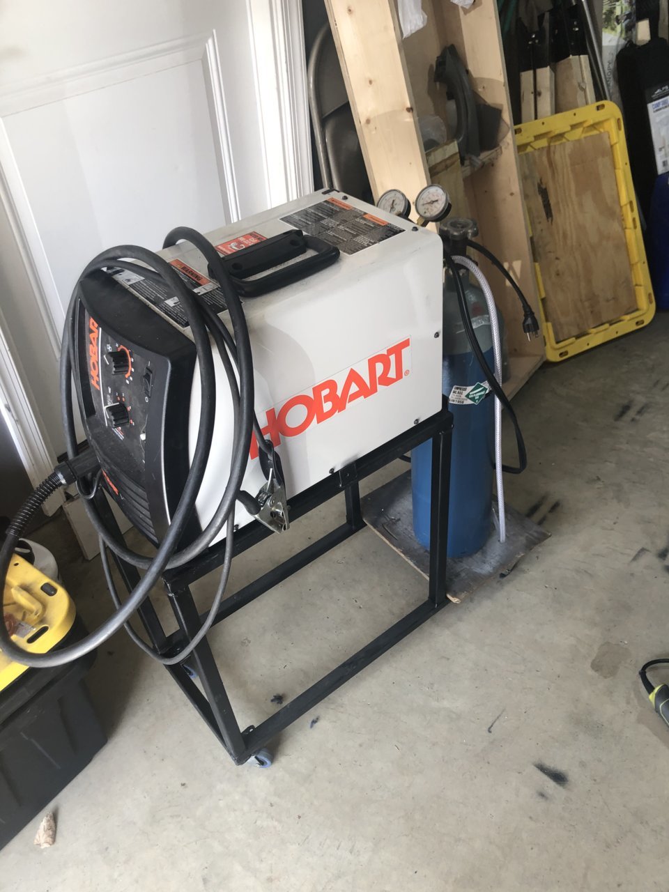

    What Model Hobart are you using?

    Hobart 140

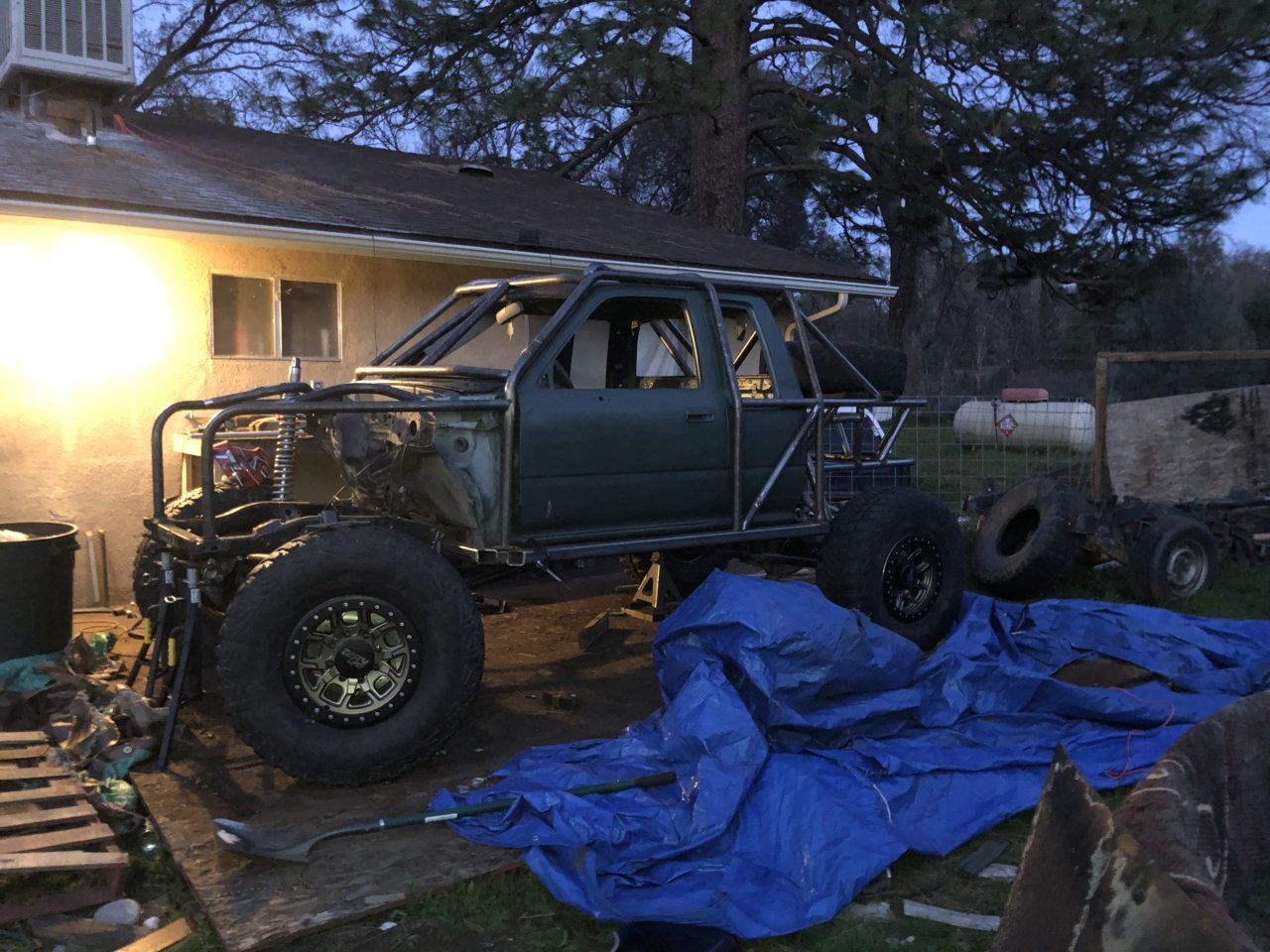

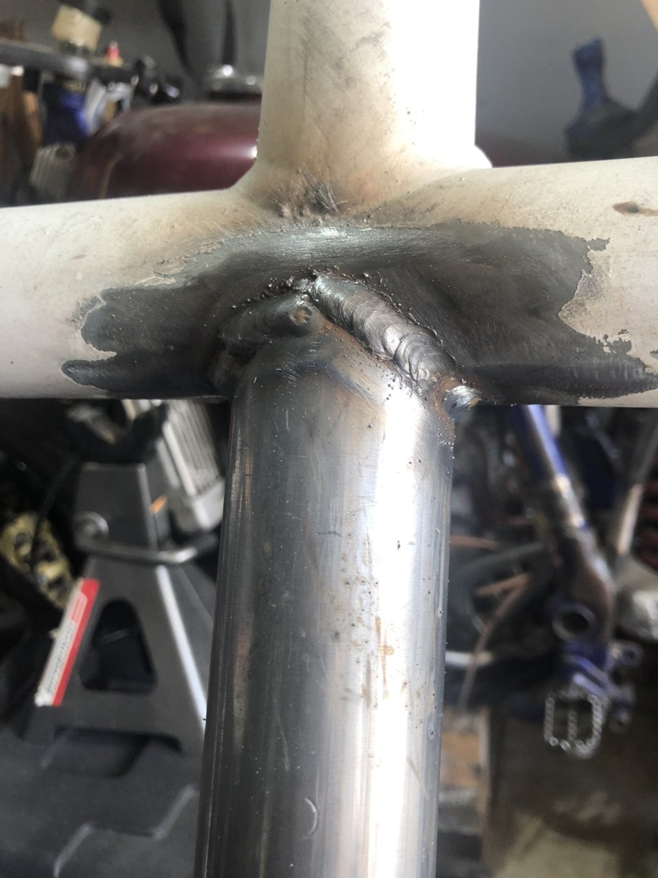

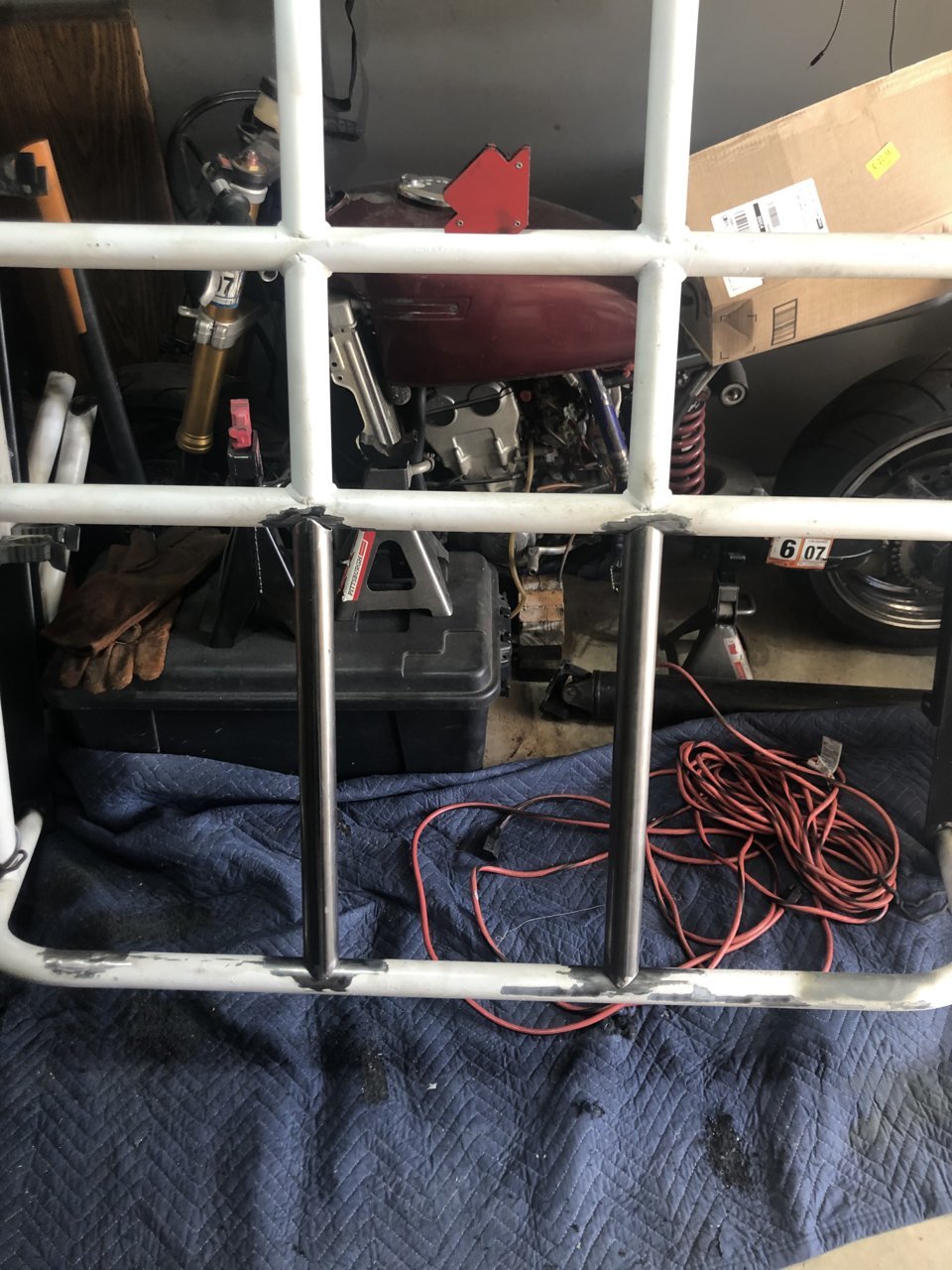

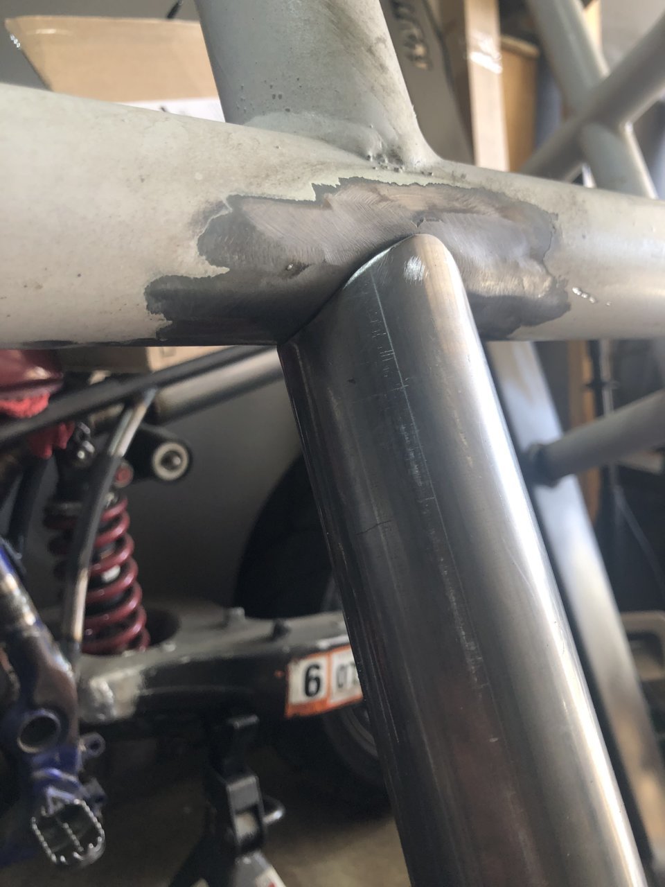

    Getting close to finished with the cage. Just needs gussets and 4 more tubes then pull it all off and fully weld it 2DC53ADF-15B3-4940-B23C-090339CFED3B.jpg
    deeezy, la0d0g, malburg114 and 7 others like this.

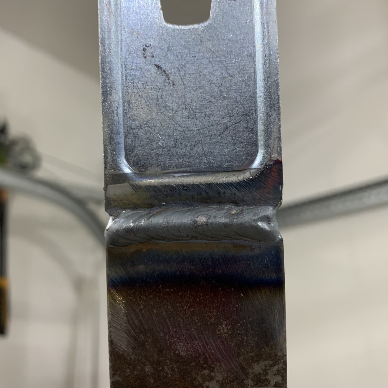

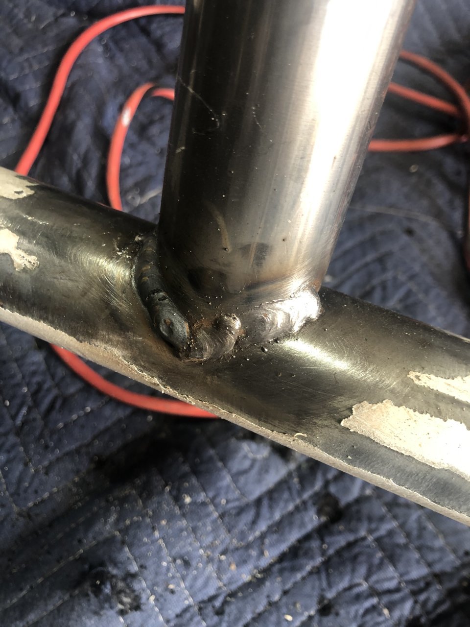

    Friend told me to crank up the heat, and I think these are much better. Im using 035 wire, and the tube wall thickness is 0.120.
    Hobart 140, 30 wire speed, 5 V
    deeezy, Zebinator, jjsul and 3 others like this.

    I was thinking the same thing, I was pretty sure you were going to figure it out on your own.
    The 1st ones looked good. These look great.

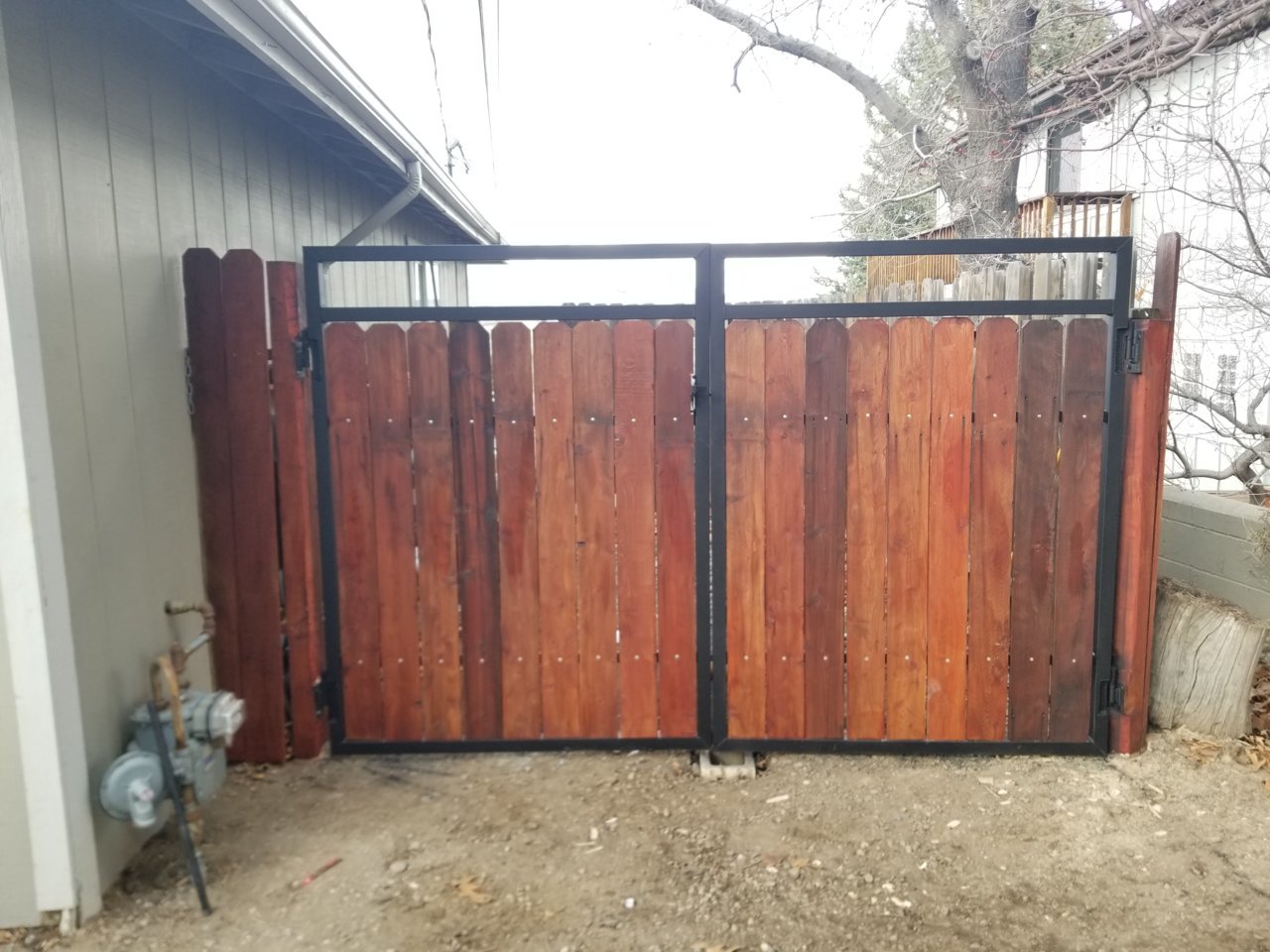

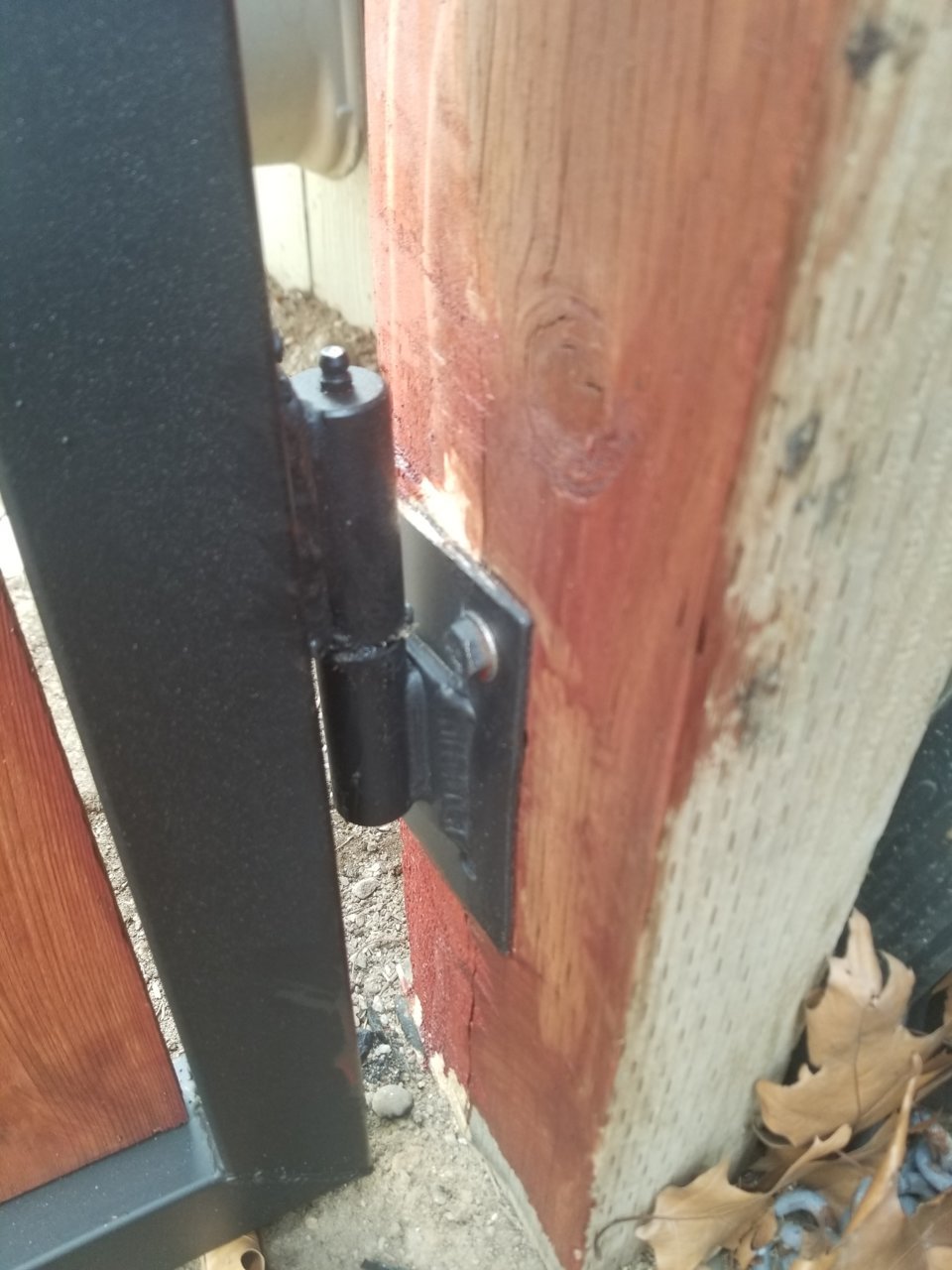

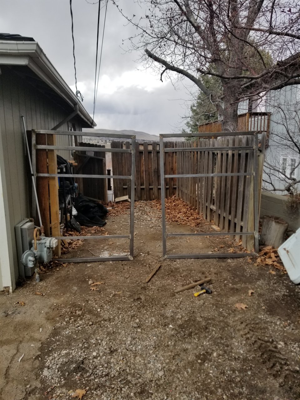

    Just finished a gate for where I park boat.
    Making the Amazon "weldable gate hinge" a bracket to bolt to wood posts. This is about as pretty as my welds ever look.
    After
    WarrenG, D2., deeezy and 8 others like this.

    Next time you replace the wire try 030. I like it a whole lot better in these small machines.

    Definitely. I bought a 10lb spool and have been trying to use it up. I think its too much for what i do

    Welds look fine.
    Those are some good hinges, the only issue is if they don't get used, they will sieze up. I've repaired several trailers that use these. They freeze up, the gate gets dropped down and the hinges break or bend the trailer frame.
    Oil them a couple times a year and they will never fail.

    These ones have built in grease zerks they are super heavy duty and unbeatable imo for ~$20 for a pair. Pumped them full with the grease gun I use on my truck.
    koditten[QUOTED] and irayfz6 like this.
