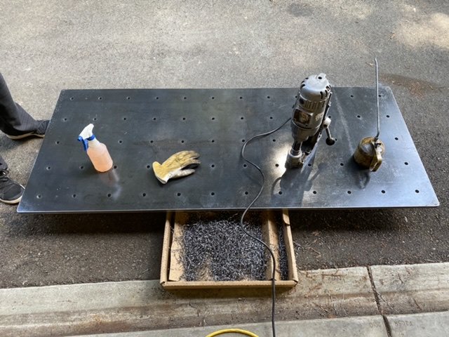

    Just Curious why you did not wait till the legs were on the table and it was at working height ??
    No way my knees could take working that low .
    You might need to remove the mill scale where your work clamp goes to get the best connection

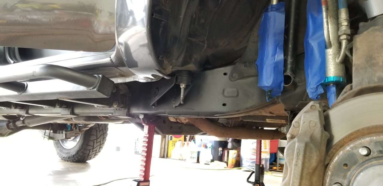

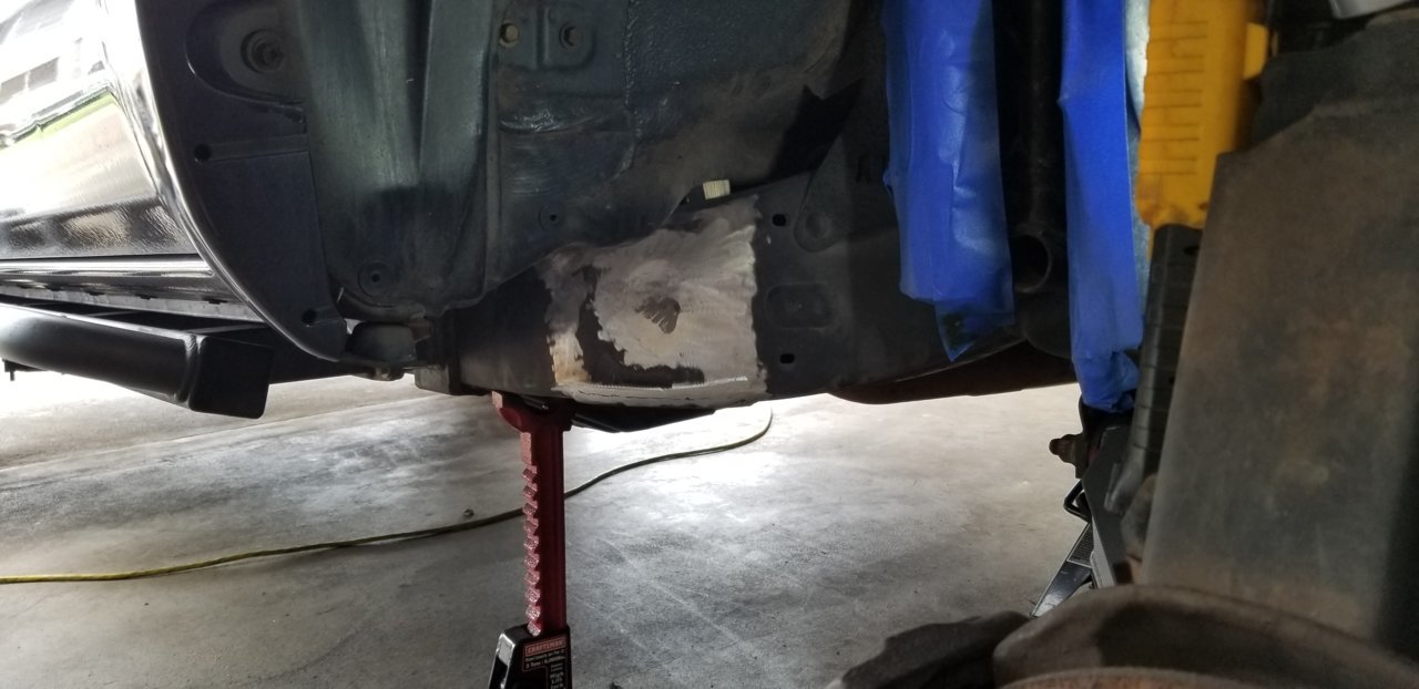

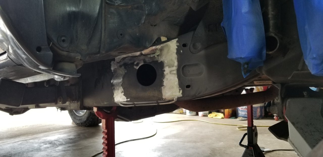

    I have about 5 hours to complete one side. Again, I'm not a speed demon and that is totally cleaning the old mounts smooth and patching the hole in the frame, painting, etc.. I'm also using an angle grinder. Since the owner left his truck, I am kinda taking my time and making it as nice as I can.

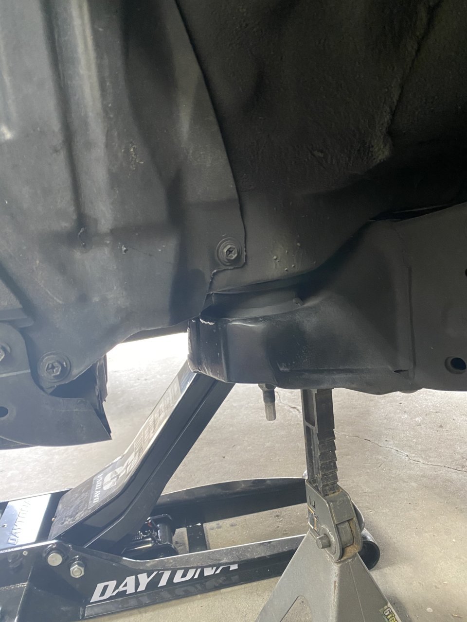

    Man, I just tried using a carbide sawzall blade and it cut the mount off in less than 5 min. Granted, now comes the loads of grinding, but I wish I had tried that yesterday.

    That would have been smart! I never claimed to be very smart....
    But actually, i was feeling pressure to get the holes drilled so i could return the drill. All my material showed up at once.
    Good point on the clamp... I often just clamp to work pieces.
    Just finished cutting all the base/leg pieces to shape... just joint prep left to do. Whew.
