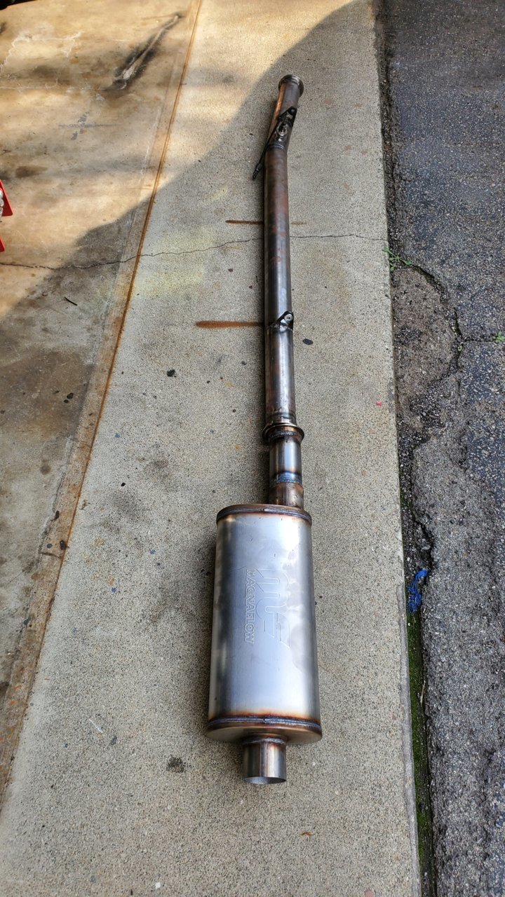

    Welded up the vband for my muffler. Ran out of piping for the exit though so that sucks.

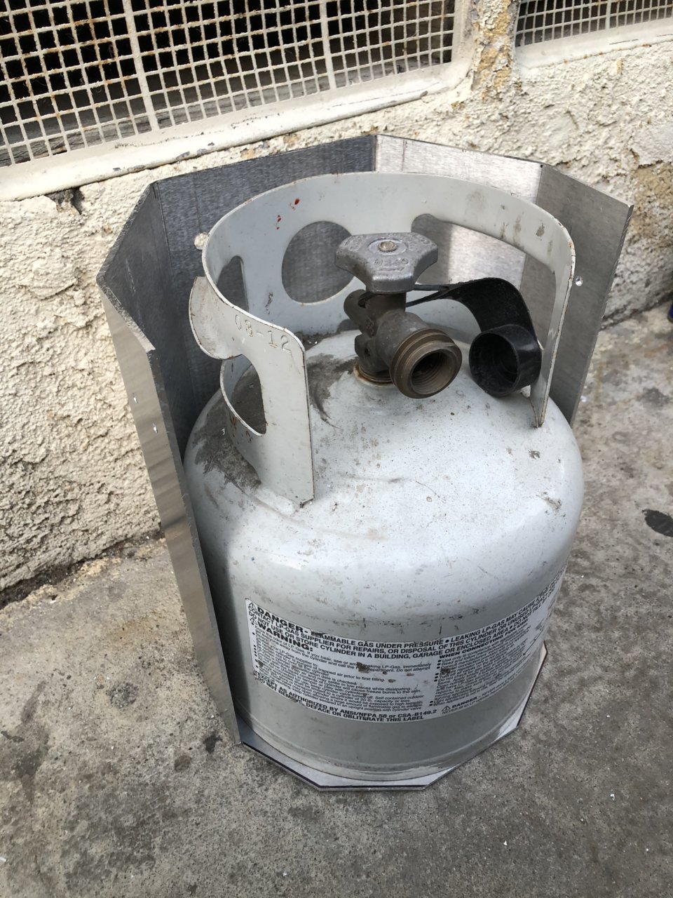

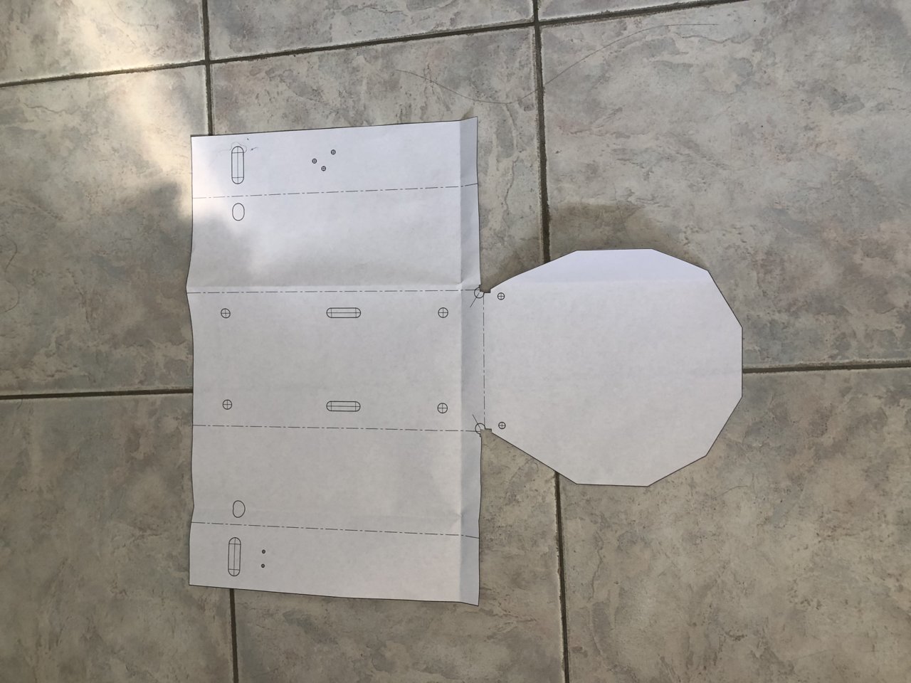

    Decide to make a mount for my little tank with left over from a cutout
    started with this
    Finished with
    Welding up the bottom tomorrow after work
    la0d0g, GHOST SHIP, jjsul and 7 others like this.

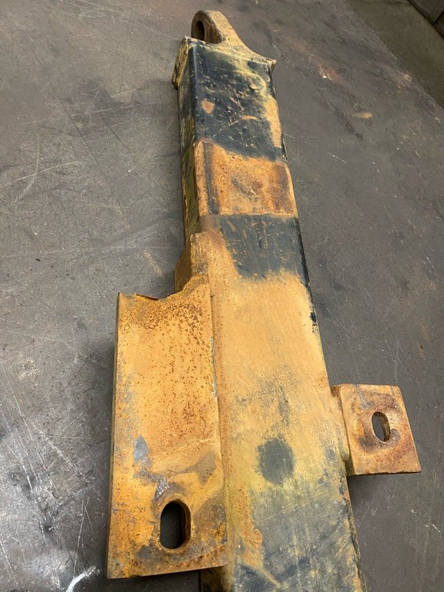

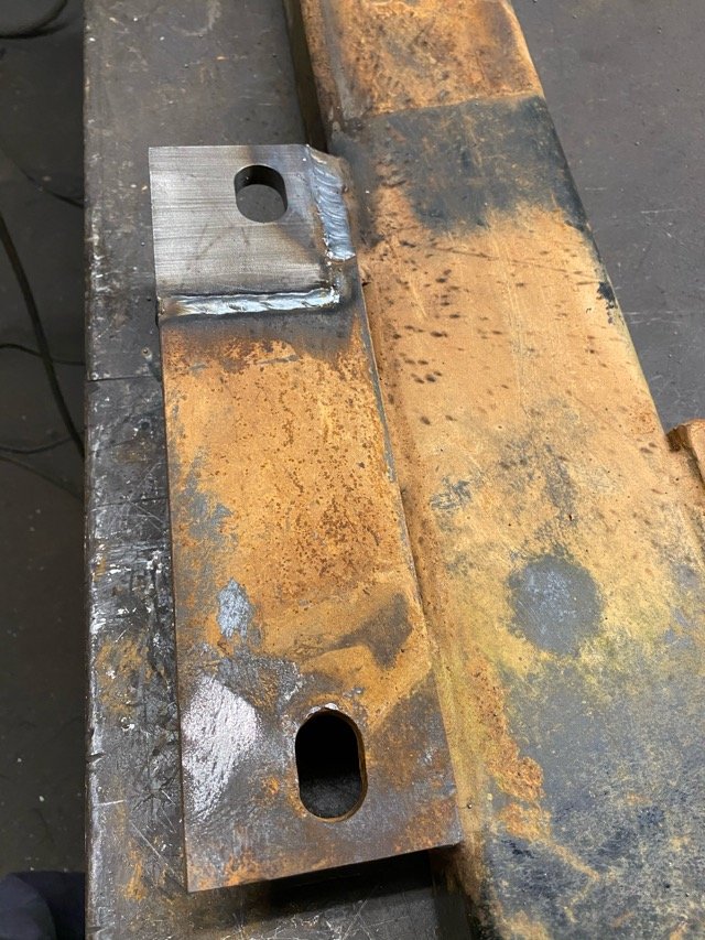

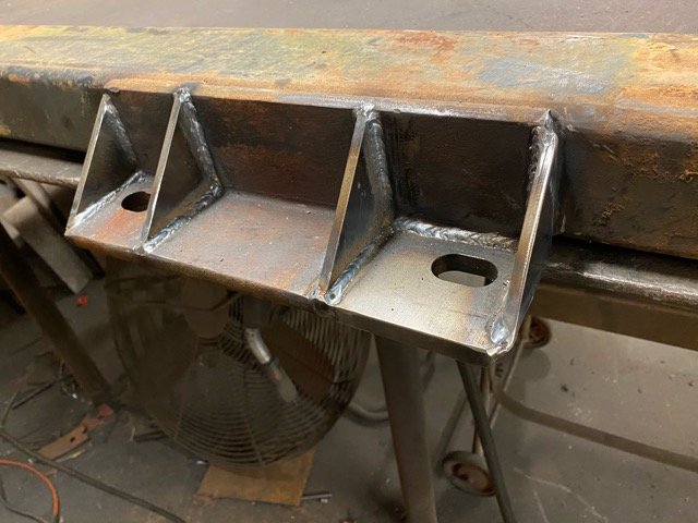

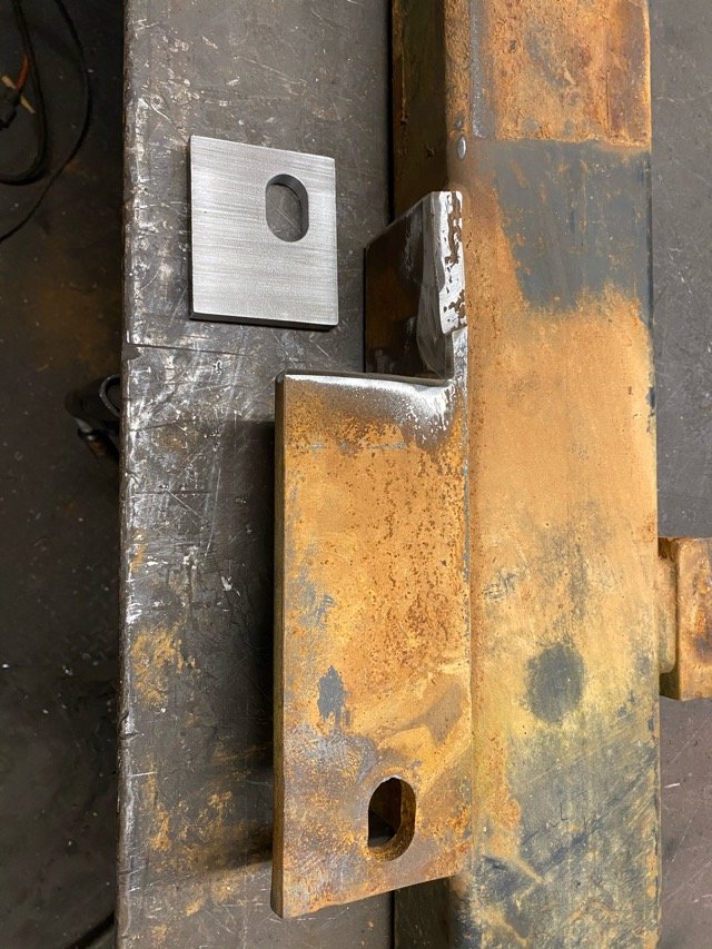

    Friend of mine is a farmer with some large equipment. This is a wing off a fold out hare. Piece was missing so made one and braced it up underneath.
