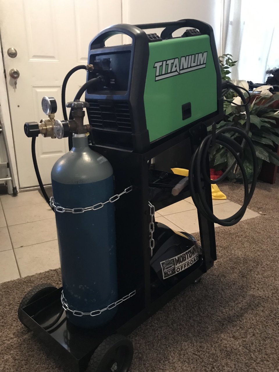

    Since we’re on the topic, anyone know why my welder constantly flows gas? As soon as I crack the bottle gas starts flowing through the tip whether the welder is on or off it still does it. Tired of blowing through gas...

    Bad solenoid more than likely.

    Internal regulator issues? There might be a problem with the valve at the drive mechanism.

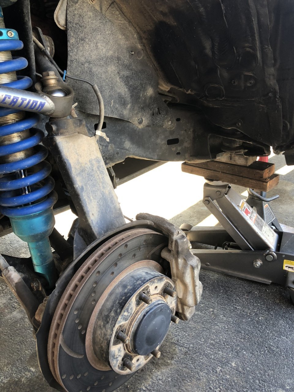

  10. Mar 25, 2020 at 10:47 AM
    fatfurious2
    Jun 28, 2014
    #132884
    49,776
    David
    Ashburn, VA
    2010 TRD OR Access Cab
    I have a new frame, and I dont have a hole there on my 2010. This is a shot of my CMC hopefully you can see it

    Sounds like a bad gas valve/solenoid. With the regulator on, gas flows to the solenoid. The solenoid lets gas through when the trigger on the mig gun is pulled. If the trigger isn't pulled, either the solenoid is bad, or its getting a false reading from the electronics in the machine telling it to stay open. I'd definitely put my money on the bad gas solenoid though.

    If your flow meter or flow gauge has the pressure to high (not the flow) it will force past the solenoid .
    What kind of machine does it have a preflow timer they can fail in the closed position .
    Most times the coils fail in the solenoid then it does not energize .
    Dirt holding the solenoid open.
    Leak before the solenoid then you would not be getting good gas coverage
