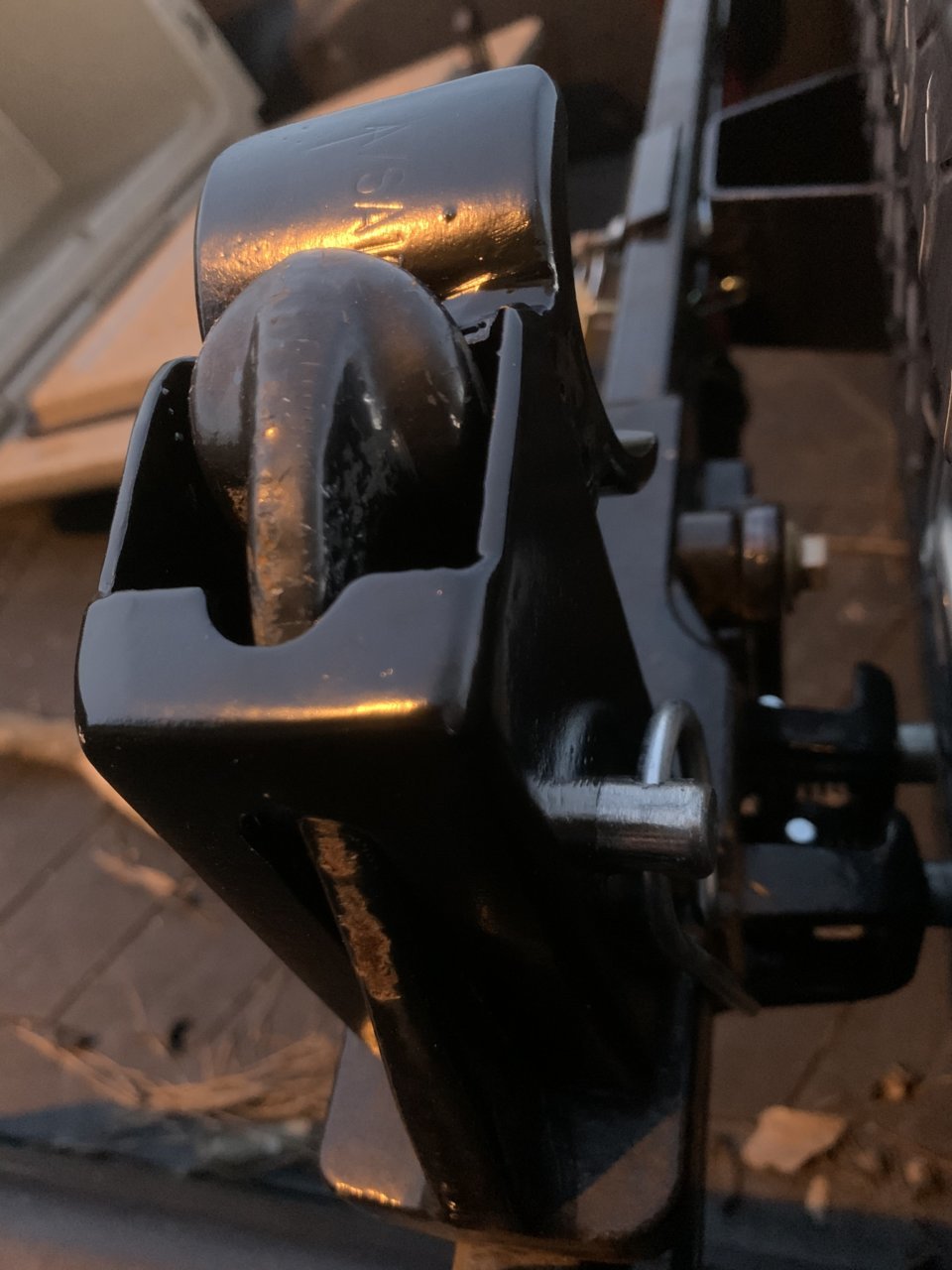

    Just finished up this guy. Probably a little excessive with the gusseting.

    Cool!! IMO you can never over build something that's safety related!

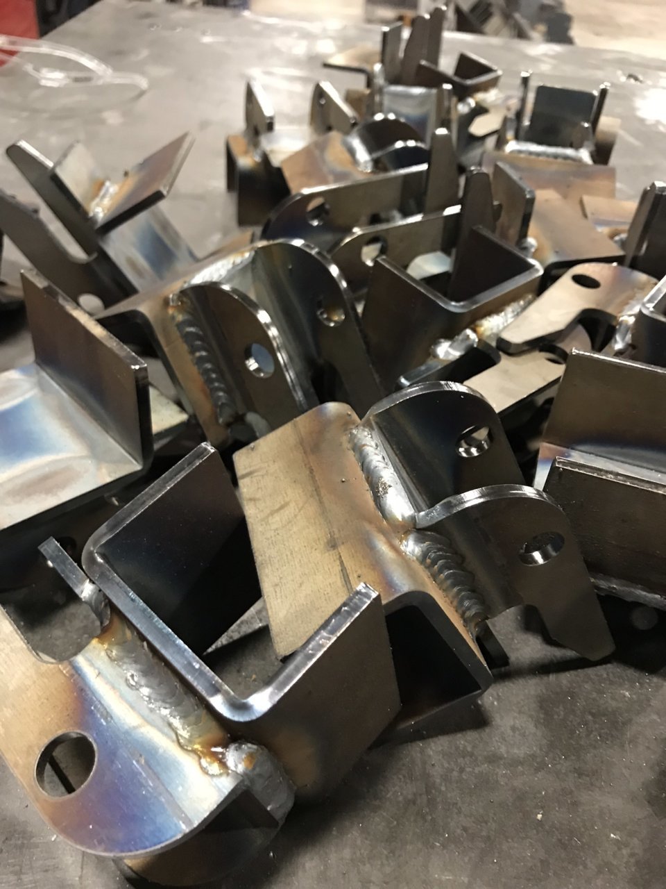

    I just made one too a couple weeks Ago at work. Worked on it while i was caught up and waiting on my fitter. Yours looks good! E43863C4-B5D3-4292-829B-51B523118673.jpg

    Nice, square is the way to go! You can kinda see mine here from mobtown, who also does square.

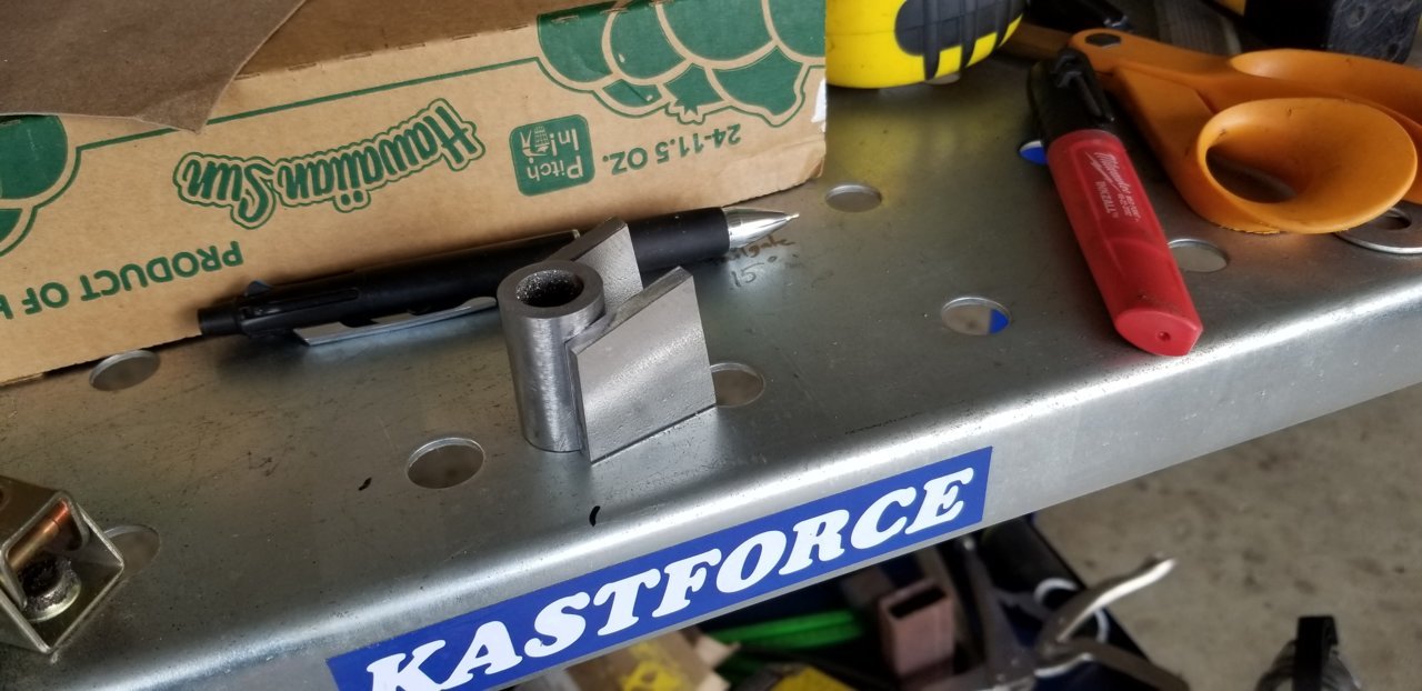

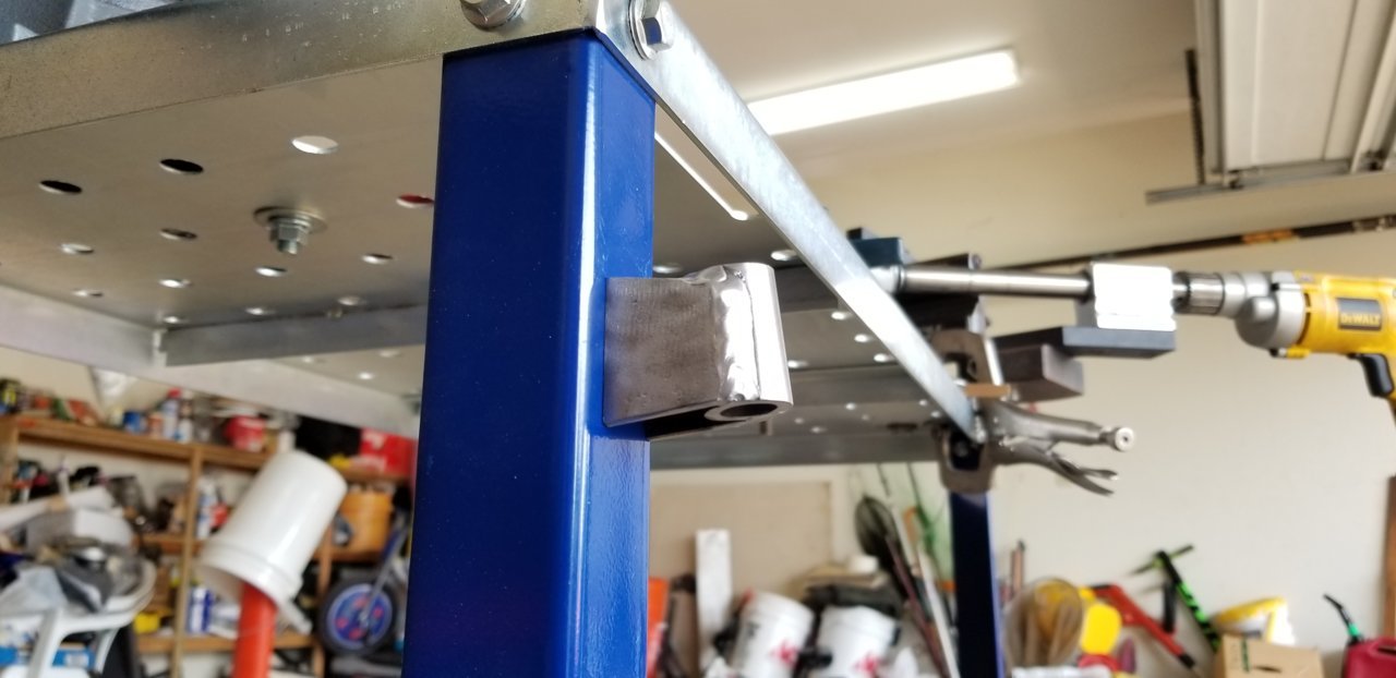

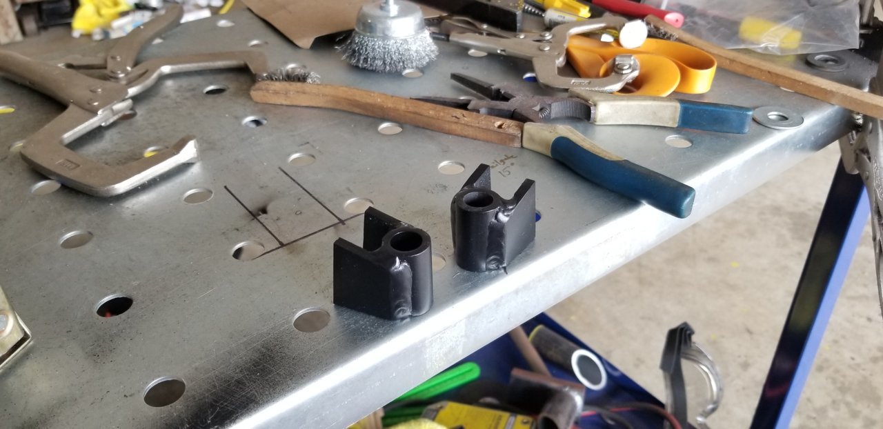

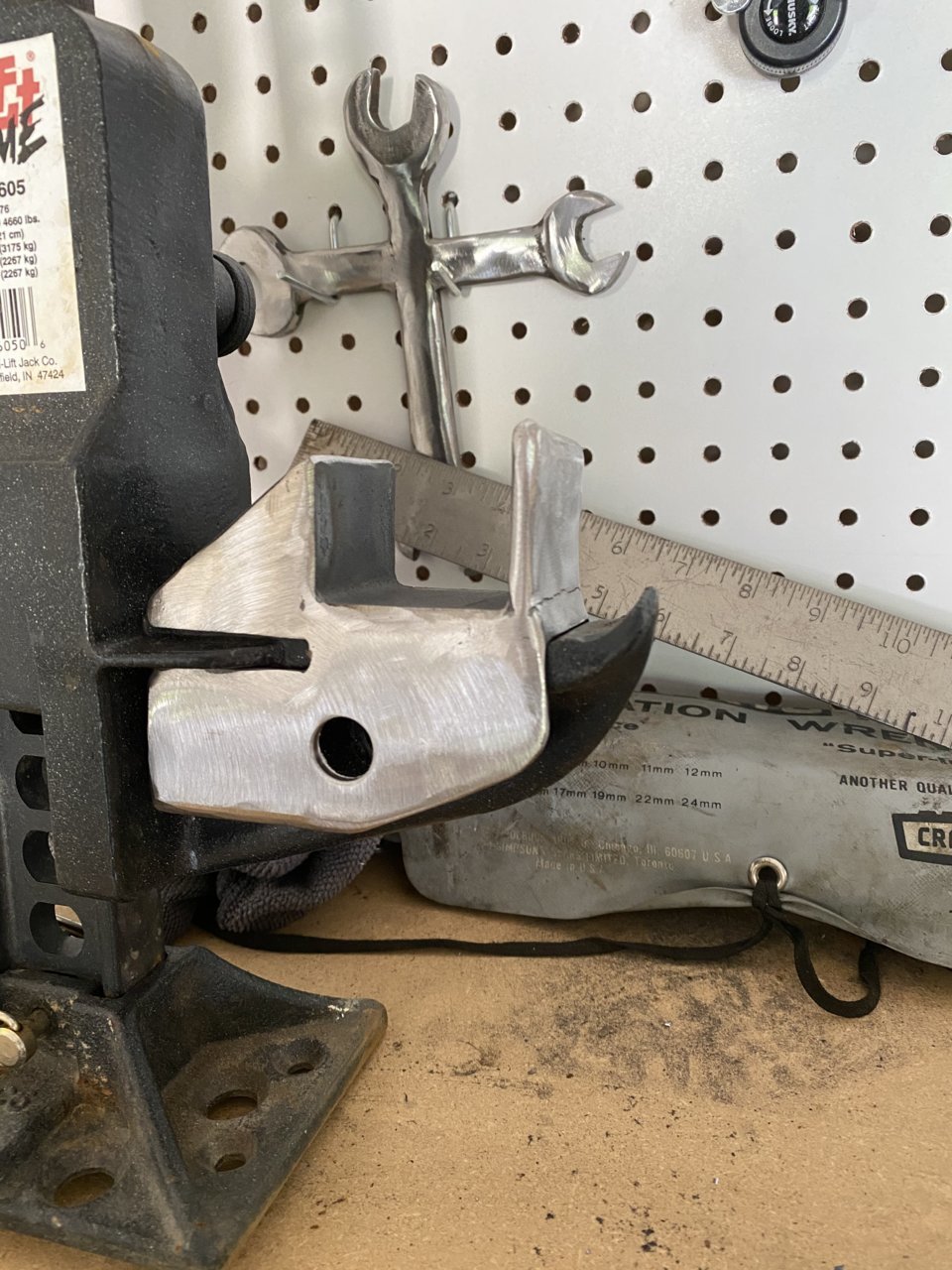

    Not much going on with me at home, but I after my kids got bored of hanging out with me, I distanced myself to the garage and made these little limit strap mounts. Lol

    Looks pretty good. Is the weld cracked in the last picture?

    negative, it’s just a ground down weld but not all the way.
