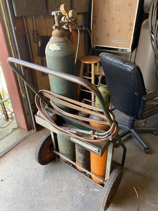

    The man came and picked up the welder, I said are you interested in the torch, we can do some trading. Swapped him the torch and he’s going to get and replace valve cover gaskets on my Tacoma. Fair enough to me!

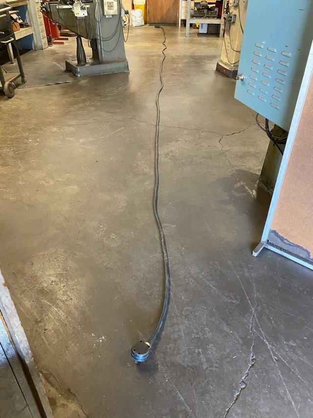

    I swapped my torch head and gauges, kept this 33’ drop cord and made $150. I like those deals :thumbsup:

    Just be careful if you use that extension cord.
    Those Male and female plugs have a bad habit of coming loose where the wire attaches to the blades.
    Then you might already know.
    So often customer says"my welder does not power up" Those plugs are a Major cause.

    I had the same plug on my welder previously. I had a hard time keeping the stranded wire landed on the screw posts. Every once and while I would lose a 120 volt leg. Let me tell you, the welder will still work, but you will vaporize the contact tip.
    Sending all those amps thru one leg is not a good thing.

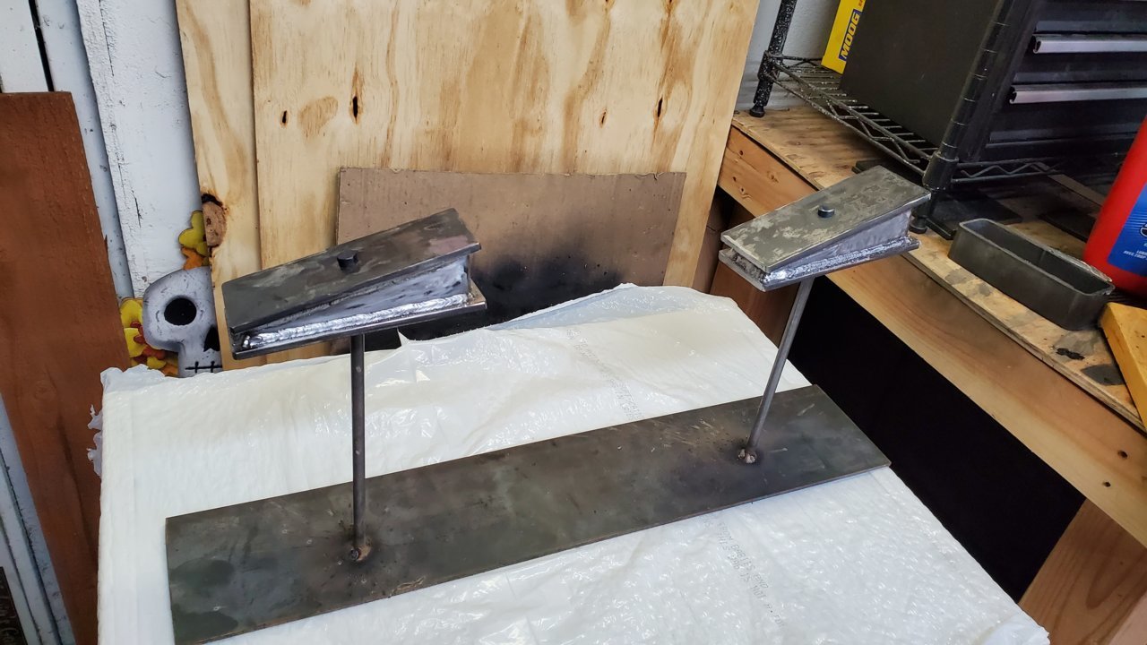

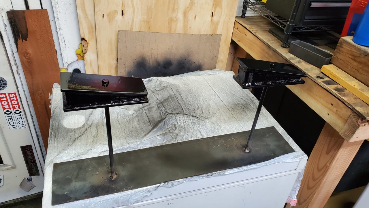

    Made a painting jig lol. Also made these custom 10 degree blocks to help correct opinion angle on a lifted truck

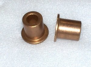

    I have a project I'm working on that will require me to drill a bunch of 3/4" holes in 1/8" wall mild steel for inserting bronze flange bushings. Is there a breaking point for hole diameters were it would make more since to use a hole saw vs drill bit? I will be drilling with a press if that matters.

    The bushings have a flange to keep them in place and a half inch bolt will will hold everything together.
    Probably a poor description of what I'm doing but basically building an adjustable height tent rack that will work like a big motorcycle jack.
