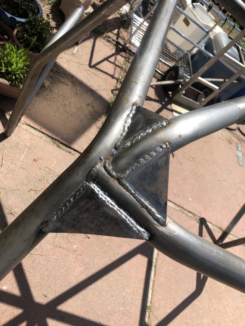

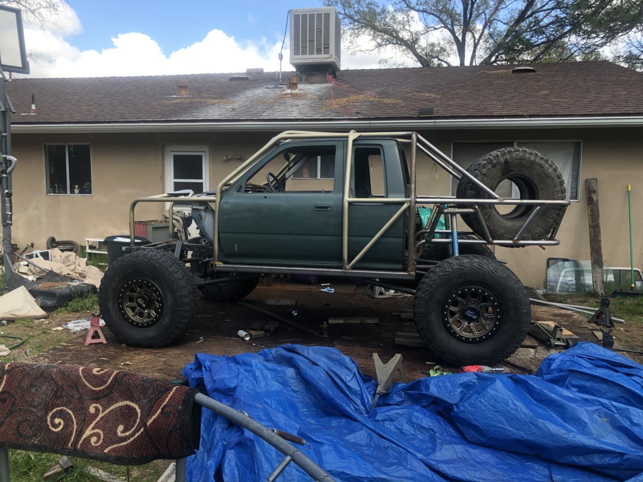

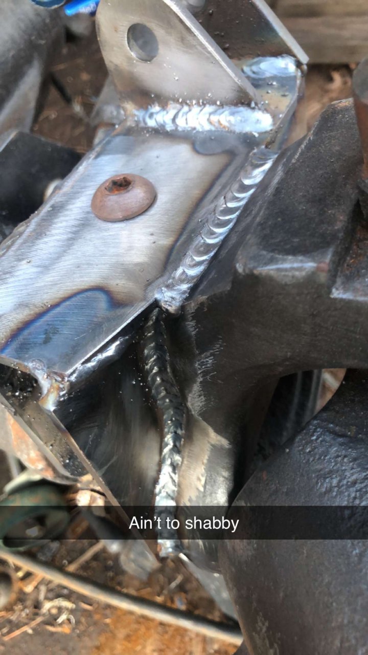

    Finally got my cage fully welded, put it on and put the rear under its own weight for the first time. 0A0DFCBD-2DC6-48F0-865B-7221DE4BC049.jpg
