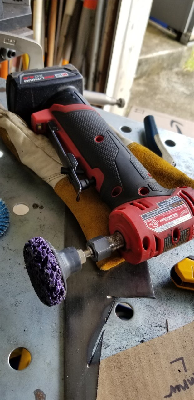

    I use these. I also use them for mill scale. Depends how thick the mill scale is, but it works for me most of the time. And very good for stripping paint and rust. I like using them because they don't take off much metal.
    https://benchmarkabrasives.com/coll...roducts/2-premium-quick-change-stripper-discs

    I use mine on this die grinder.

    Yup, that's what I got. That thing is hard as a rock, maybe harder. I'll try it out again. Hope results are different..

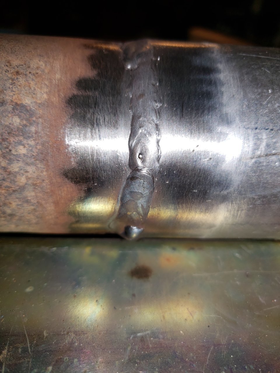

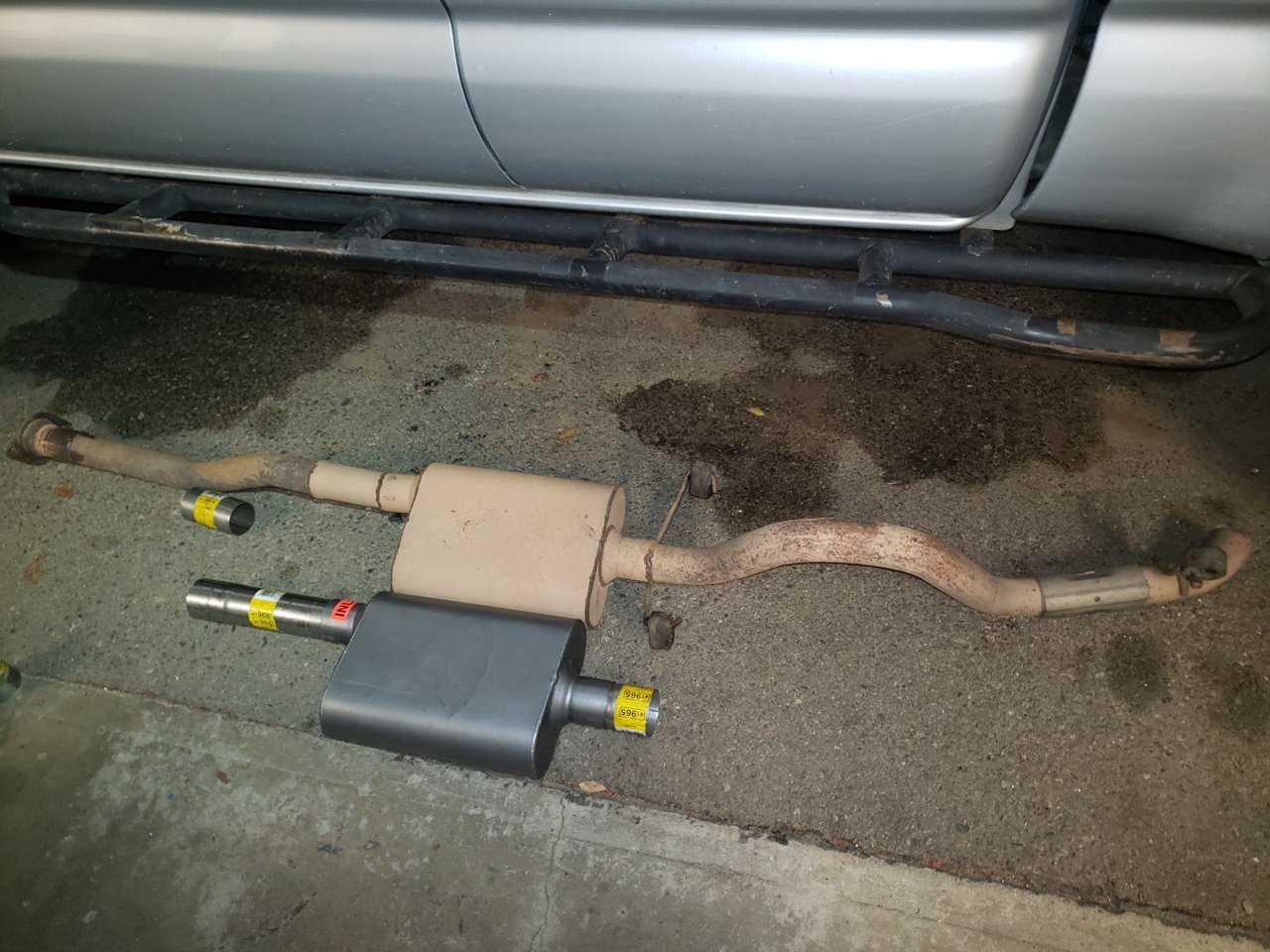

    UPS delivered my muffler to the wrong house this week. But I finally tracked it down. And tomorrow is supposed to be sunny finally!
    Although it turns out my tools leave a lot to be desired for exhaust work... tonight's practice weld went a lot better than I thought it would... no holes!

    Edited to add: does anyone know an easy way to get these god damn labels off the exhaust couplers?

    To take off the sticker residue? I use lacquer thinner sometimes to kinda melt it down and wipe off.
