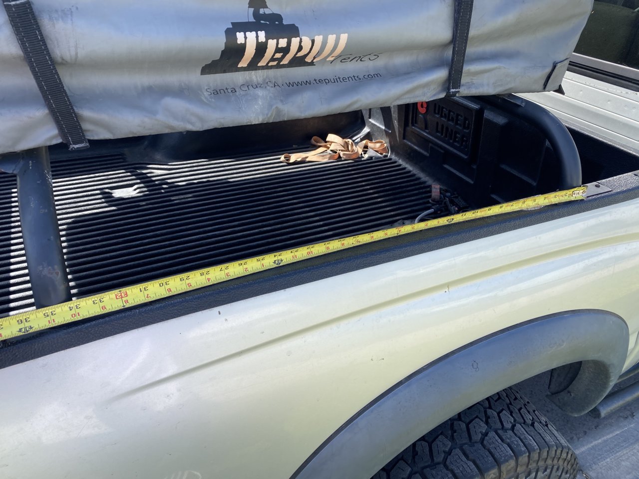

    DF4C1000-9819-4D00-BFD8-AB5649F4FA7F.jpg Anyone in Orange County Ca that can help a member out with some welding? I’m looking at welding 1x4” by 55in long rectangle tube on to my bed bars. Wondering what’s a fair price to pay.

    Is it notched and ready to weld? That will make a decent difference in price

    It’s not.
