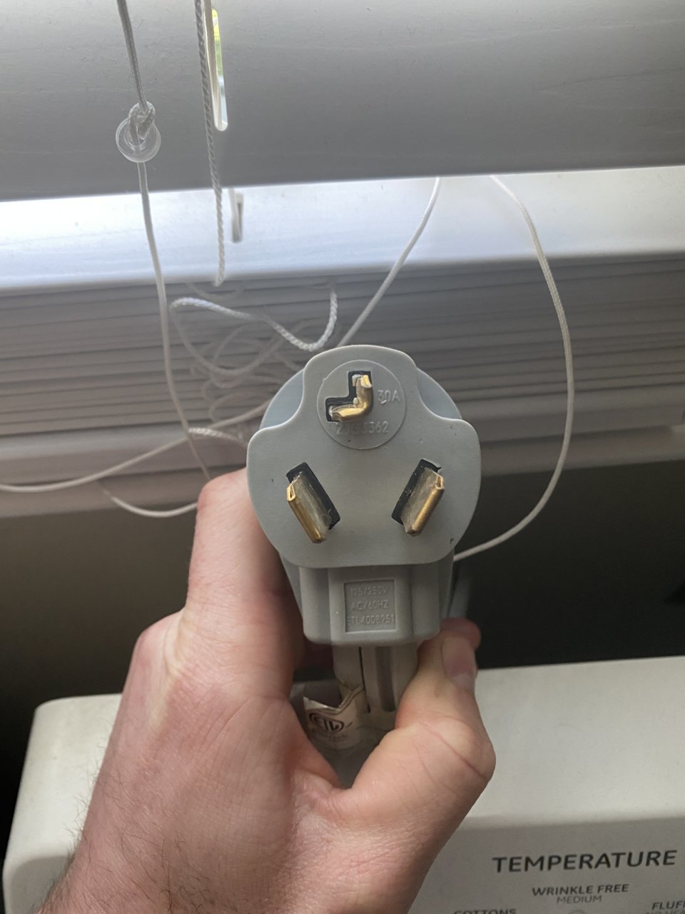

    Yes you can do that. My extension cord is a mix of receptacles similar to that. I used 10ga extension cord which is good for 30A, but I have also used 12ga with no issue because my welder doesn't pull that much current in 240V anyway.

    That is excellent to hear, thank you. I found this on Amazon and would just swap the male plug. Seemed like a decent price for 40’.

    Yeah, you would just cut off that male side and install the new plug that fits your dryer receptacle. I'll try find the company that makes a cord already made for that dryer receptacle.

    Check Lowes. You can buy 3/10 wire by the foot for a lot less than that and all you’d need to do is get the right plug ends. That’s what I did when I built my own experience cord and was all-in under $30 for a 30 foot extension.

    Does it matter which wire goes where regarding the two hots when wiring in the new connector? I know dick about AC.

    ^^^What he said, or check Home Despot if it's closer.

    There's a diagram on with the plug/receptacle, GREEN screw is Ground for the green wire.

    So the down side of those 3 pin dryer cords is they don't have a ground. Its just L1, L2 and Neutral. If you go across L1 and L2 you get 240V, if you go L1/L2 to Neutral, you get 120. Its not great for safety, which is why the new 4 wire plugs exist.
    The best way would be to get the landlord to upgrade to a 4 pin plug, and then get one of the extension cables other people posted.

    Just put the longer input cord on the welder and be done.
    No reason for an extension cord unless you need it for another piece of equipment.
    The less connections the better .

    Those 4 post plugs are for stoves and dryers that need a dedicated 120 volt for the oven/dryer light.
    If you use the same plug for your welder, you just wont have any wire going to the 4th post in the plug.
    Like Craig said, skip the extension cord. Make a long input cord for the welder. Both of my welders have 25' input cords.
