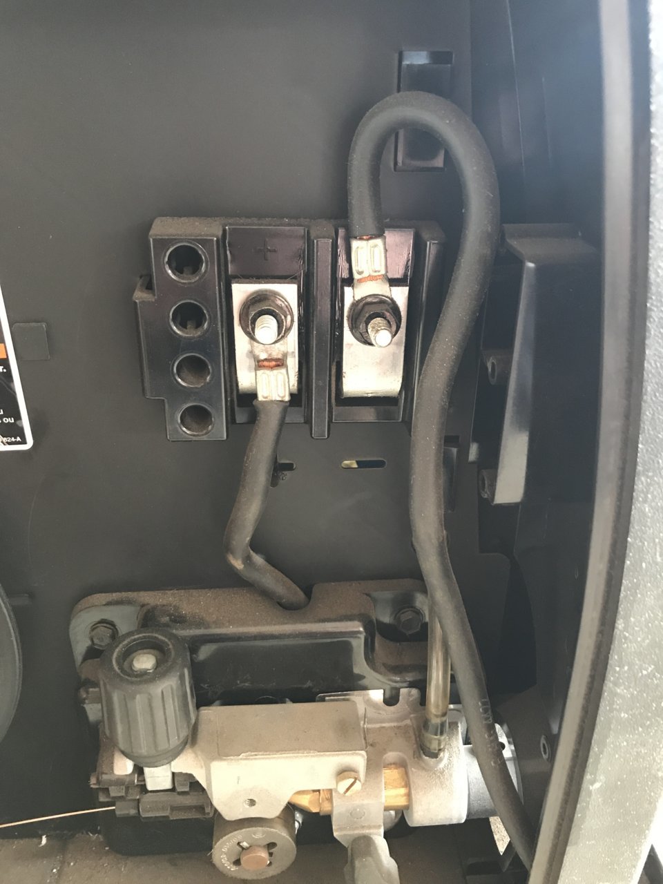

    Might sound silly but is the polarity set up correctly?
    Have you tried using anti spatter spray? That stuff works wonders for me
    Wyoming09, koditten and Drainbung like this.

    Not silly at all! That was one of the checks I did do. I did try the spray, and it does seem to work for splatter but the surrounding area to the weld get idk, burnt? Nothing a layer of paint can't fix.

    Kinda looks to me like its not getting hot enough - maybe there's a high resistance connection somewhere in the circuit limiting the current. How does the ground clamp look?

    I honestly don't have an answer to that as I don't know the history but... not that I noticed. Everything checked out. I've had feeding issues before and this is not that. It burns well and consistent, just doesn't look good after.
    That is something I haven't looked into. Ground clamp looks pretty rough actually. Not as bad as some of the pics I've seen on here but it's definitely had better days. Could that be something that causes splatter?
