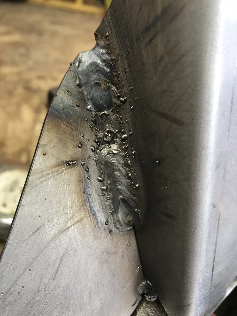

    Are you sure you're getting a good gas feed? Not trying to be a smartass but make sure the torch is seated in the unit securely.

    Meaning?
    No offense taken, even if it's something simple I haven't been able to figure it out so I deserve whatever you've got. lol
    We did check gas flow at the gun. Idk if there is an official test but it sounds like good flow and the gas ports aren't clogged.

    Stick out refers to how far away you’re holding the gun from what you’re welding. It can be very finicky. What I’m suggesting is maybe it’s as simple as you just holding the gun too far away by a little bit.

    I wasn't really looking at the spatter, but at the edges of the weld that look like they're sitting on top of the parent metal and not melting together with it.
    Might be worth cutting an inch off the ground cable, stripping it back and getting a fresh, clean connection.

    I can give that a shot. Can't hurt to have a new ground on the machine even if it doesn't work. I do see what you're saying though.

    I had this problem after I let one of my friends weld and he disconnected the hose. I had to fiddle with it to get it to seat into the machine properly. I'd put my money on gas not getting to the tip properly. Check the connections for gas and where the torch goes into the welder.

    I checked the gun end. I haven't looked at the connection end into the welder. I'll check it out!

    Burn some incense or something near the clear hose by the drive wheel the pull the trigger on the welder to see if there’s a gas leak (the smoke will move). I had that happen to my miller a while back and the mechanism look almost identical. I’m going to assume that’s a Hobart welder? Word is the drive mech internals have the same origin.
    a small hose clamp solved the issue but I don’t remember having spatter because of it.

    It's actually a Miller. A 170 I believe? This is a creative idea. I'll add it to the check list!

    Another thought I've been tossing around in my head. In this picture, the top of the weld, where I assume you started, looks pretty good. Its nice and smooth and melty. But as it went on, it got bumpy and wavy and colder looking. That's suspicious to me. Has anyone here seen a capacitor go bad in a welder? I'm not sure what that would look like, but if I had to guess, it might look like that. :laughing:
    EDIT: How old is this thing?

    Great observation! To clarify, the top of the weld where you pointed out is actually a second pass where I turned the voltage up. You can see the original weld (first pic) underlying in between the top and bottom second passes.
    How old is the welder? Not sure. Doesn't look like Miller makes a 170 anymore. It really doesn't look that old though.
