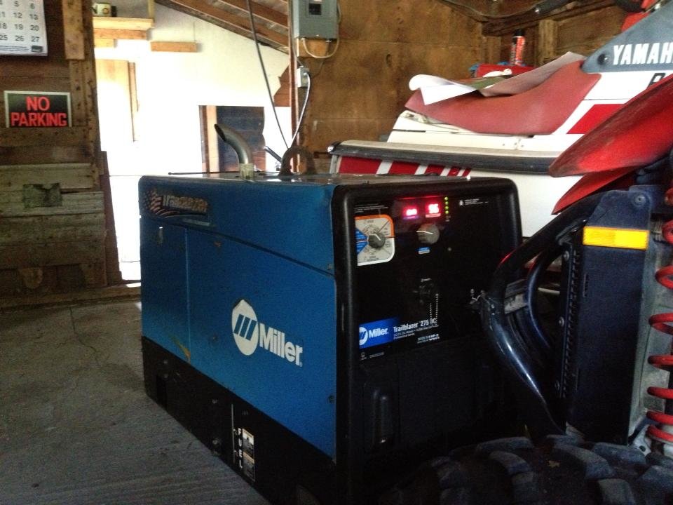

    My new machine, should serve my purposes well.

    Looks good Brian.

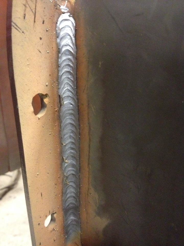

    Not too bad for the Cert. passed though

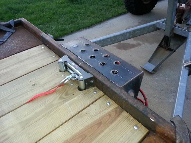

    I'll play. Not nearly as pretty as most of you guys, but added a winch and a step plate to a trailer yesterday:

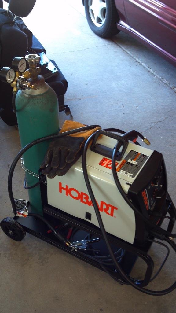

    New welder! Also picked up a spool gun for aluminum while I was at it.
    First time I've used mixed gas rather than 100% CO2. Welds look a lot better!

    Nice little welder!!
    What mixture are you running? 92/8?

    75% Argon/25% CO2

    One thing to watch out for is you're gonna need a little more heat to penetrate with the mixed gas. But yeah I was surprised how terrible my mig welds look on our school welder which uses 100% CO2.

    100% CO2 gives better penetration with splatter. C25 gives a cleaner weld.

    Thanks, good to know!

    Personally I'd stick with the C25.
