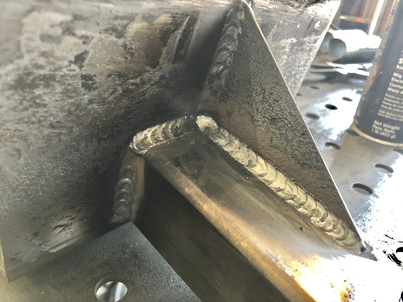

    Never really used anti spatter spray but I’ve been using it lately and I like it. Still a little bit but cuts down quite a bit

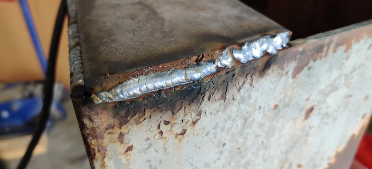

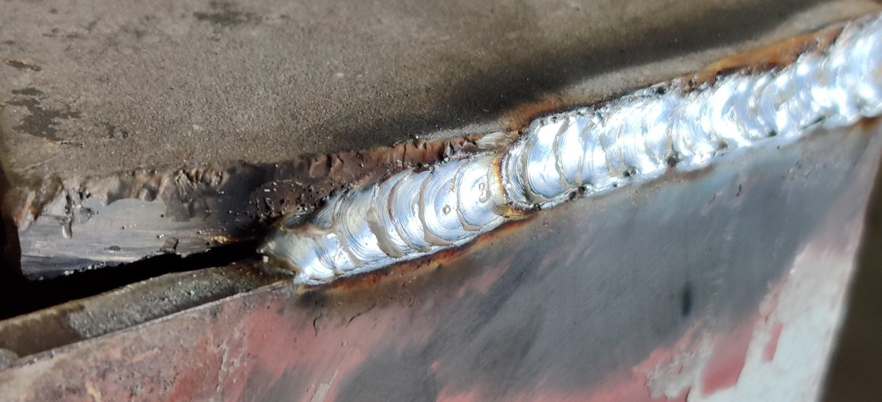

    I finally got my first project. Just welding some plates into an old telephone pole so my dad can use it as a bench for his grinder.
    Gauge was way too heavy for 110v weldpak but it seems to be strong.
    I was messing with alot of settings, 13-16psi gas, voltage and wire feed. I was attempting to get some dimes but only did so for a few passes.
    Would not mind constructive criticism. It is nowhere where I want it to be lol. My welds need Jesus. Maybe a cleaner surface wouldve helped.

    They don't look bad, you need to grind away the paint and rust before mig welding though.
    Drainbung and will.i.was[QUOTED] like this.

    Cleaning up your base material would do wonders for it. The slight porosity you're seeing on the edges of the weld puddle are from contamination, but you're headed in the right direction. Welding to clean metal makes it so much easier, but we all know you can't always clean what you're working on. If you're just starting out, try and clean your surfaces from paint or rust as much as you can so you don't have anything contaminating your weld.

    Thanks for the tips! I only cleaned the surface where the material butts next to each other. I only had a wire wheel as well and it wasn't playing well with the finish that was on there. Didn't bring my flap wheel. Ill keep in mind your suggestions, I really appreciate it.
