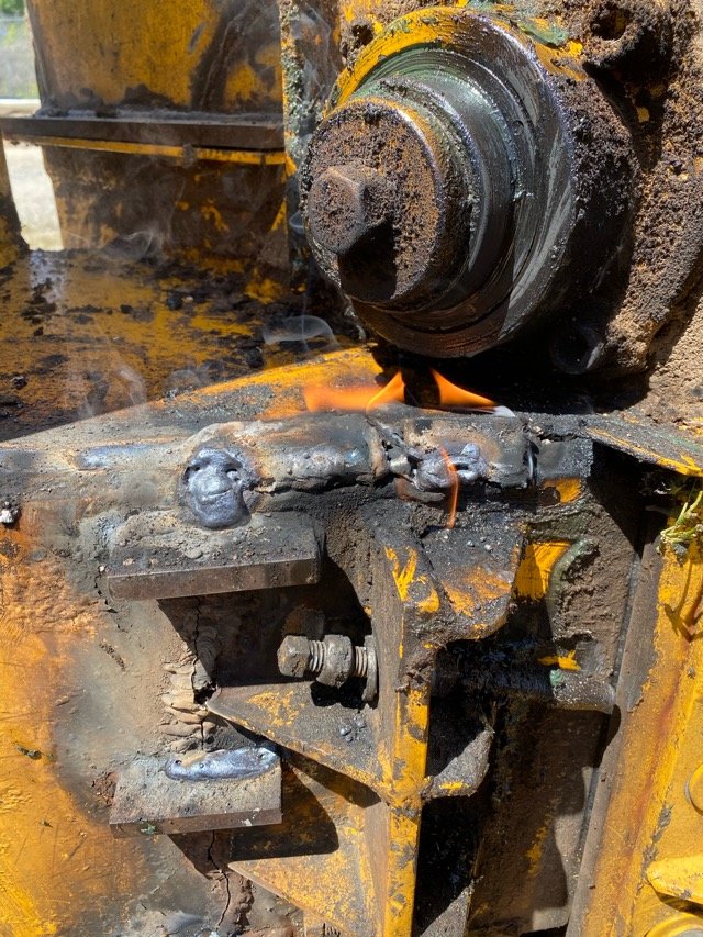

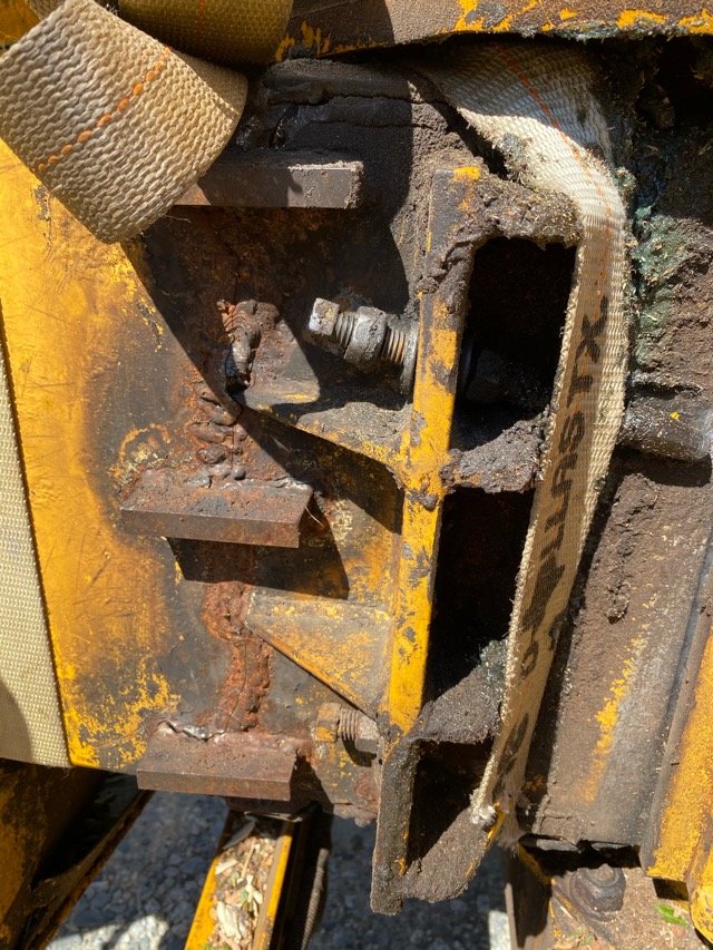

    First repair held for two years. It didn’t break from a lack of grease that’s for sure.

    The grease was in the way, had to burn it out of the way :D

    Stick welding can be fun :rofl:

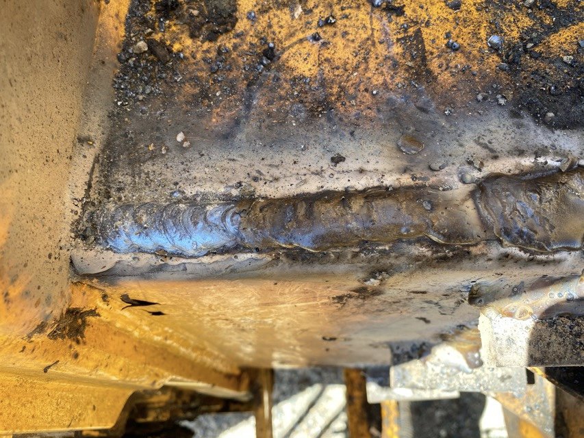

    I did a root pass with a 6013 and capped it with a 7018. It’s not pretty but I learned to weld from dad on the farm.

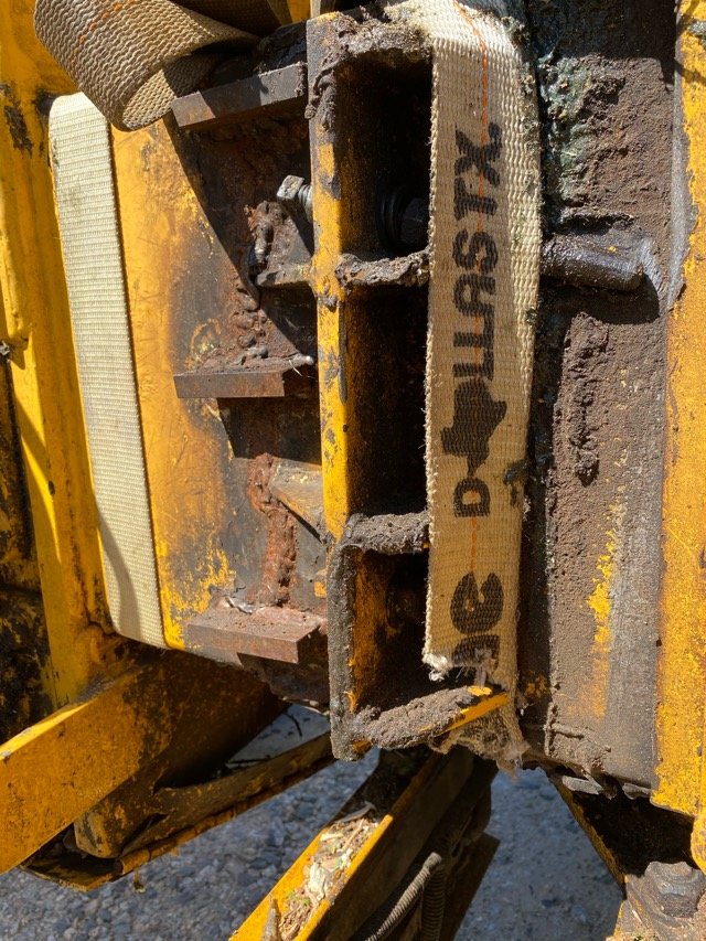

    That machine looks like it needs some quality time with an arc gouger to get buttoned back up so it doesn’t keep cracking

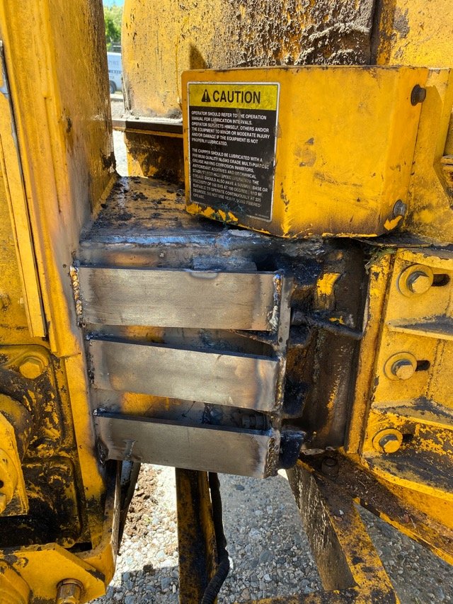

    Hopefully this helps. We’ll see. I fixed this other door a few years ago. He tore it up real good.
