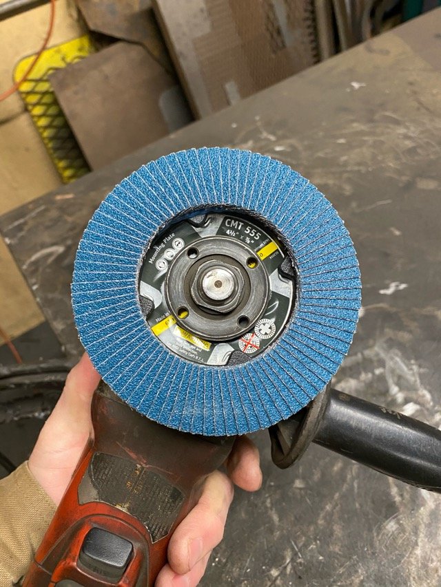

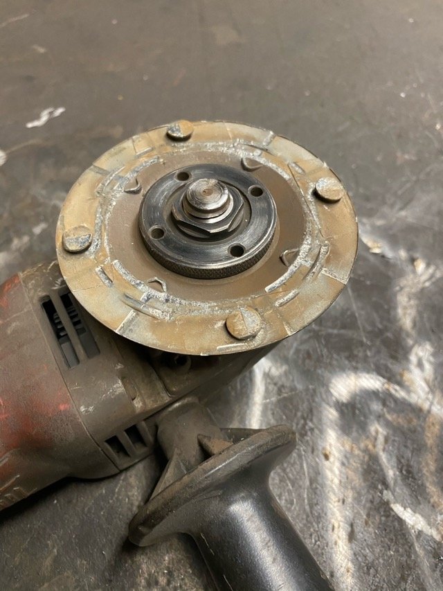

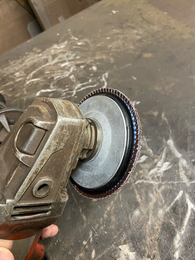

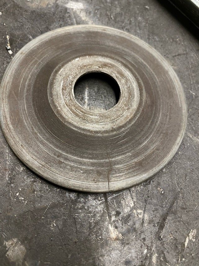

    For those that don’t know, Klingspor has a quick attach flap disc. We use them at work. Have had this one for years and saw it was cracked the other day so got the boss to get a new one.

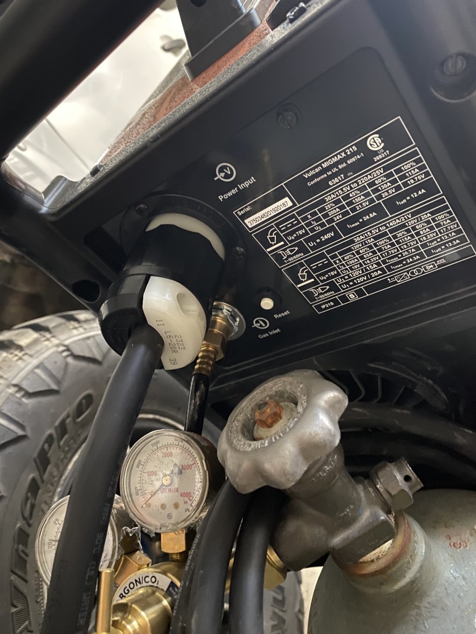

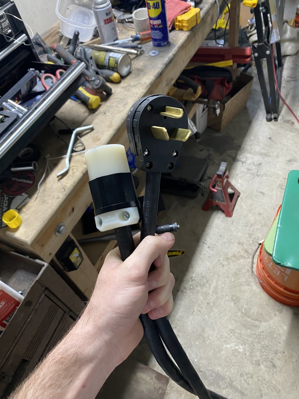

    Since I’m sure everyone has been losing sleep wondering about my extension cord situation I wanted to provide closure. After buying the Vulcan I learned that it has two separate cords for 120/240 rather than an adapter. So I picked up the right plug and now essentially have one long lead coming off the welder. I will repurpose the lead it came with as a 10’ extension cord if I ever need that extra little bit.

    Never seen this before I might need to look into this since even trying to keep the grinder wrenches in one spot it takes me 20 minutes to change a disc I no doubt have enough boxes of assorted Discs to last very long.

    Grinder wrench... grinder wrench... that's just a leather glove right?

    The grinder wrench and the guard are usually in the scrap bin before install the 1st disc.

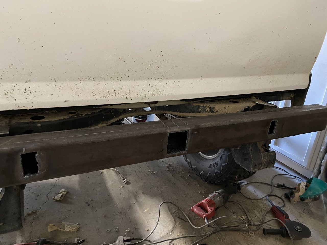

    I’m gettin halfway decent with this oxy torch! Had to make some cuts for my shackles and hitch. Still need to cut the back.
    Question. Aside from normal clean up i.e. cleaning up mill scale, is there anything that needs to be done to these cuts before welding it? Like grinding off the outer surface of the cut because it will make the weld porous, or something like that.
