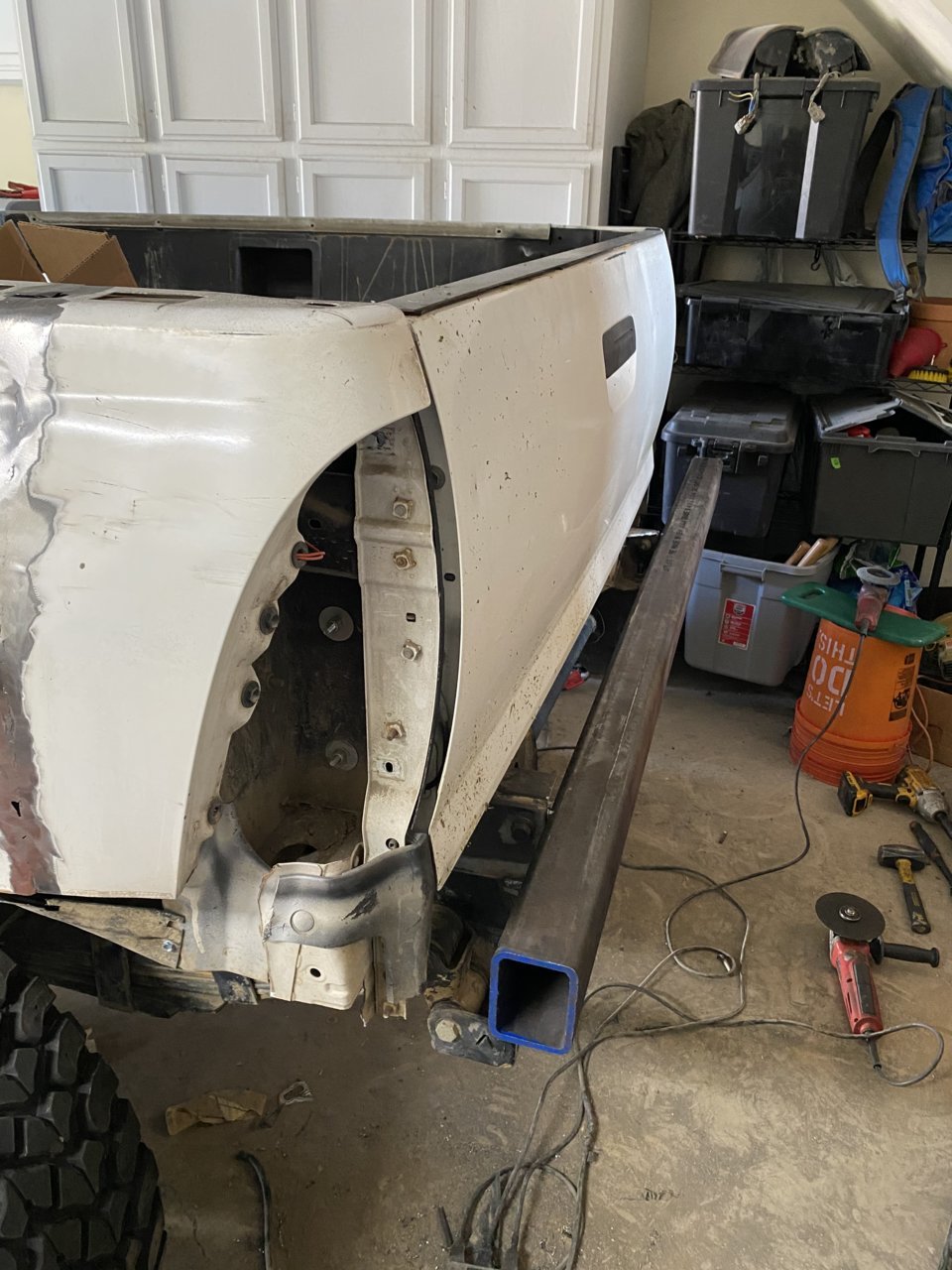

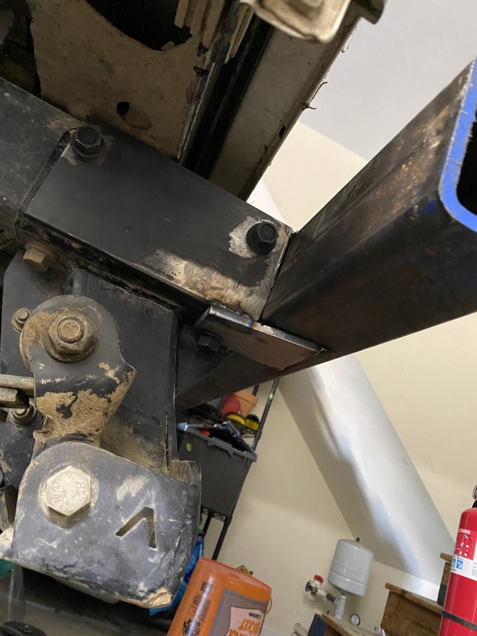

    Bumper is coming along though, just got started today. I miscalculated my cut on the bed and cut out about 2” too much so now I have this slight bumper gap. I’ll fill that in with some sheet metal and blend it best I can so it isn’t noticeable.

    It doesn't have to be perfect. As long as you can get some of the grinding wheel in the cutout, you can span the rest with the weld. Corner welds are the easiest, as you already know.

    So are you saying it’s more fitment issue rather than the slag contaminating the weld? Or both.

    You should be able to bridge the areas where the slag is the worst. Don't weld to the slag at all.
    You are using 60s or 70s wire. 60,000 lbs of shear strength/inch of weld. Do you think you can exceed that with the power available in a Toyota...web strap snatches included?
    You are welding 4 sides. You have wiggle room.

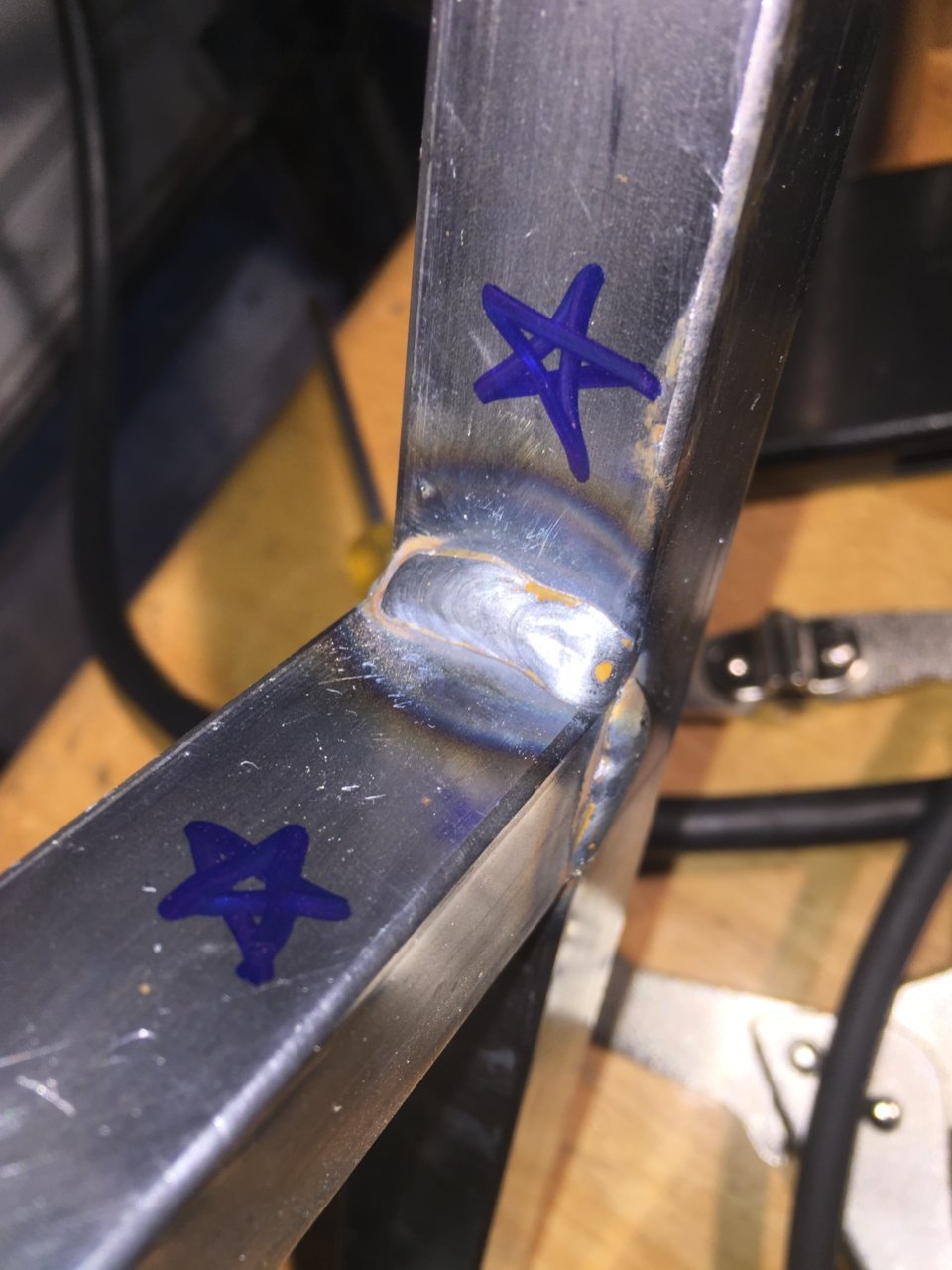

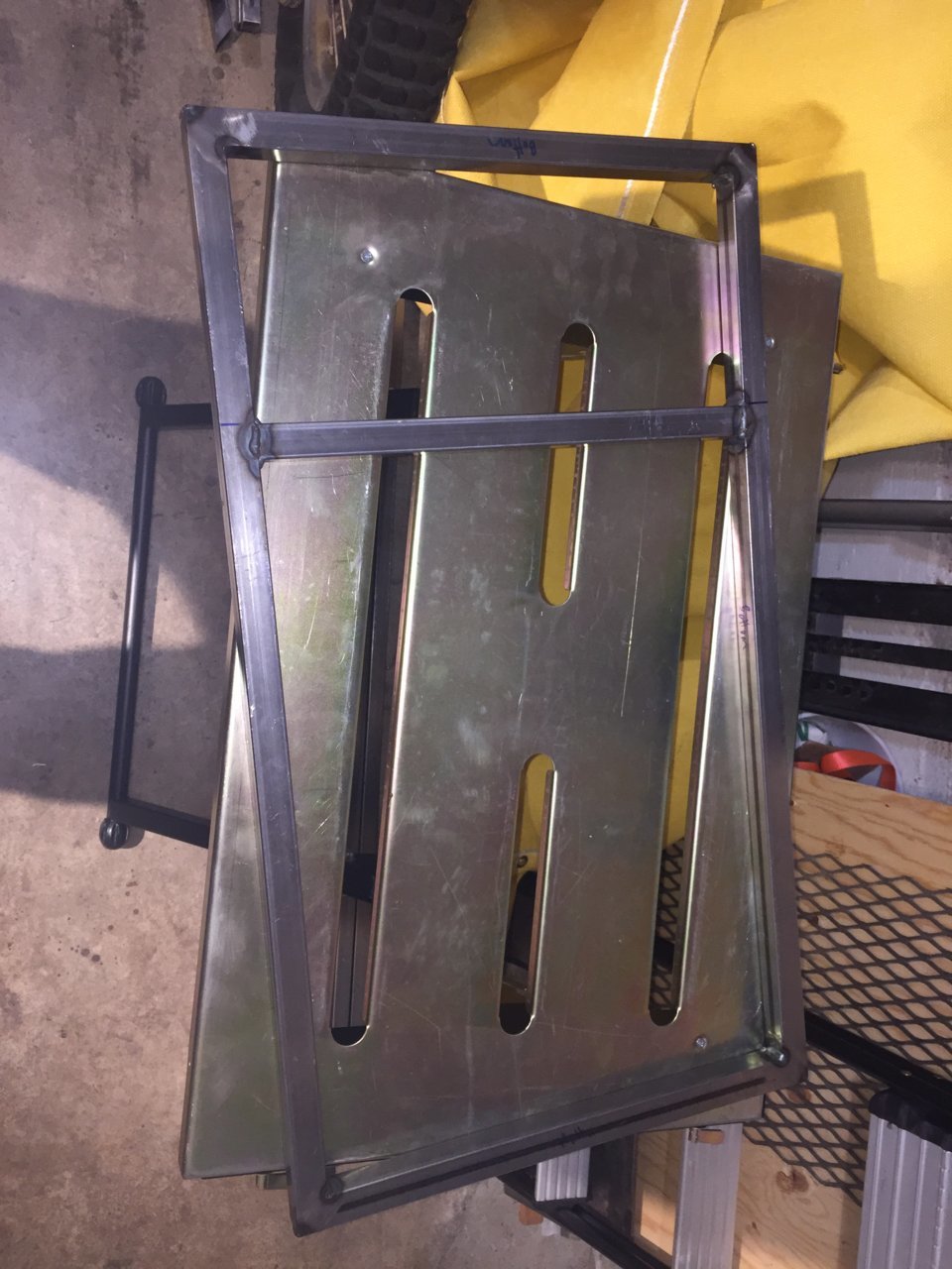

    Thanks to everyone that recommended switching from 0.030” to 0.023” wire for 16ga tubing.
    I can’t believe how changing the wire size totally changed the character of the welder. 16ga was fun and easy to get consistent welds on. It made 16ga feel like 1/8” with 0.030” wire. I went from burning though on every single weld with 0.030” to not burning through a single time tonite.
    An bonus result was a lot less smoke and sparks which makes thing feel much more reasonable to use in my small 1 car garage.
    I’ll defiantly pick up a 10 lb spool when I burn though these 2lbs.
    Welded up the bottom shelf for my welding cart and was starting to get a feel for the gun by the end. Was a lot of fun to have the machine dialed in and focus on technique instead of fiddling with settings.
    Has some welds by the end I was pretty happy with. Gonna turn the wire speed down a smidge next time.
