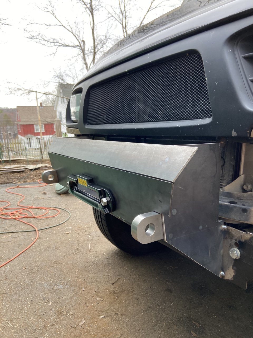

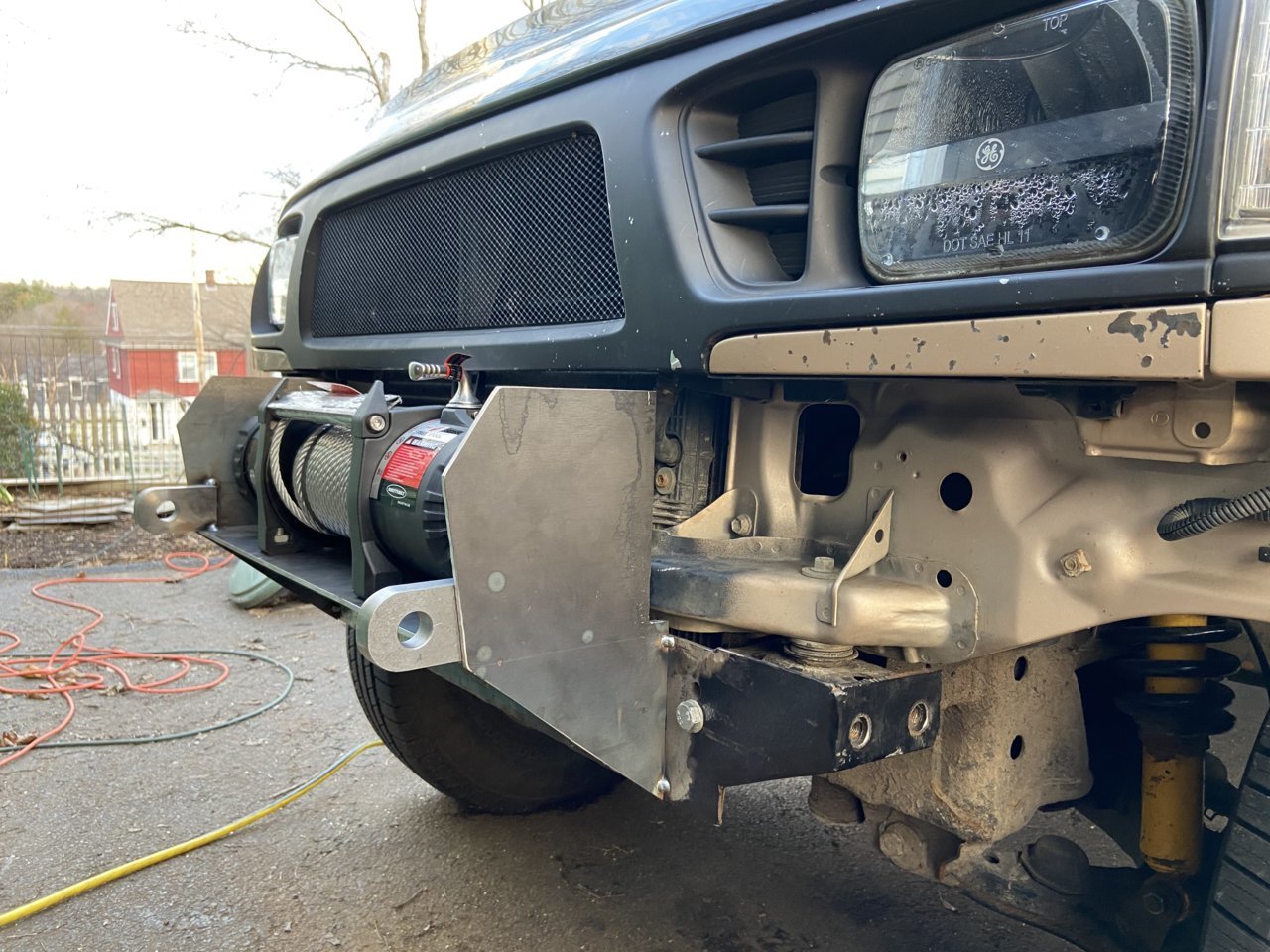

    I’ve been re-building my front bumper from my original mount in between helping the wife and infant baby boy and remotely returning to work from paternity leave. Life feels full! My shop is tiny and I do all my wedding outside, so the rain has been limiting me too.

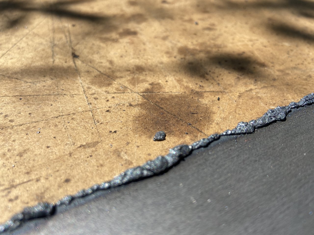

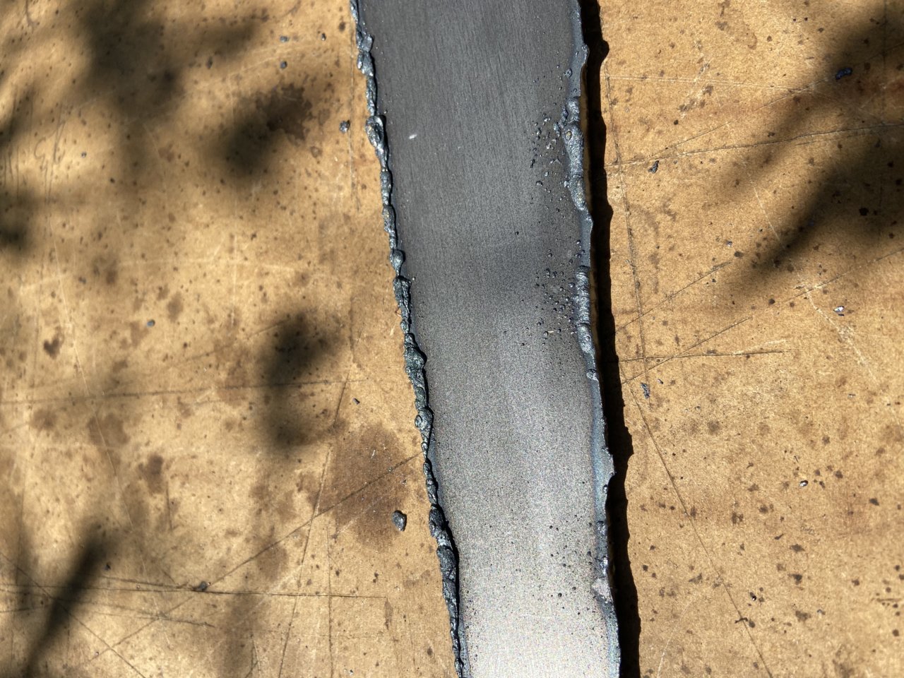

    Also, I don’t know how to use my plasma cutter :anonymous:
    what’s up with all this slag? I’m using a straight edge to guide the torch. Travel speed? Air pressure?
    using a 30 amp machine. Viper cut 30. I haven’t used it in a while but I swapped out new consumables before starting to cut for the bumper rebuild.

    Are you using a drag tip?
    With a plasma torch, with a drag tip, you actually let the torch tip contact the metal to be cut.
    As a former gas torch user, this was very difficult for me to get past.

    Show the sides of the cuts.
    I'm the furthest thing from an expert, but the sweep of the cuts can speak to the travel speed.

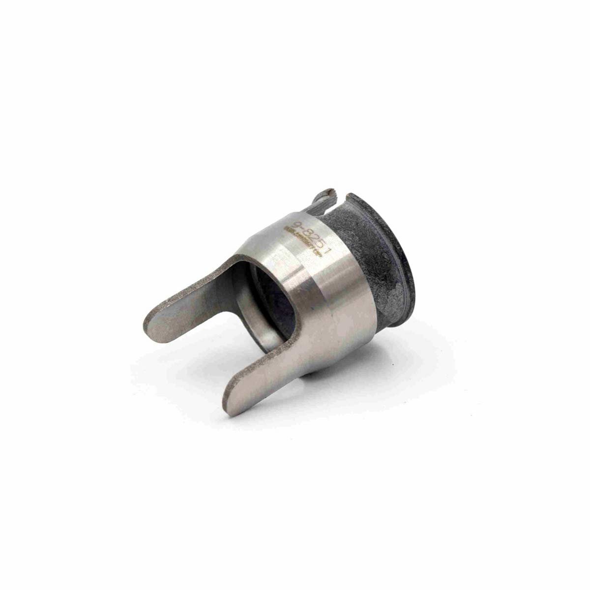

    It is not a drag tip but I have a standoff guide like this one
    thank you!!
    3/16
