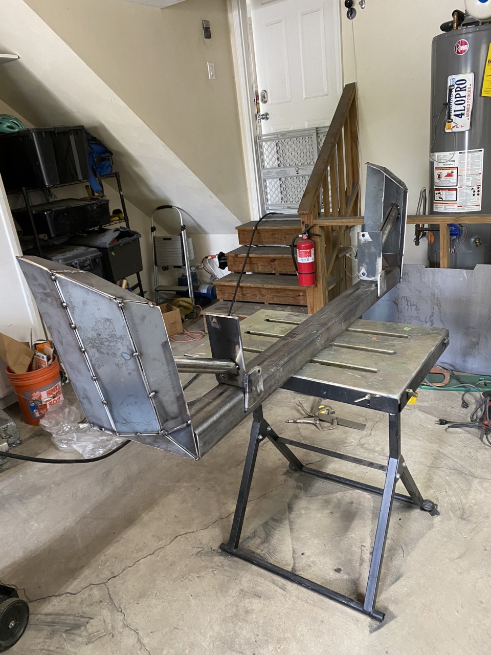

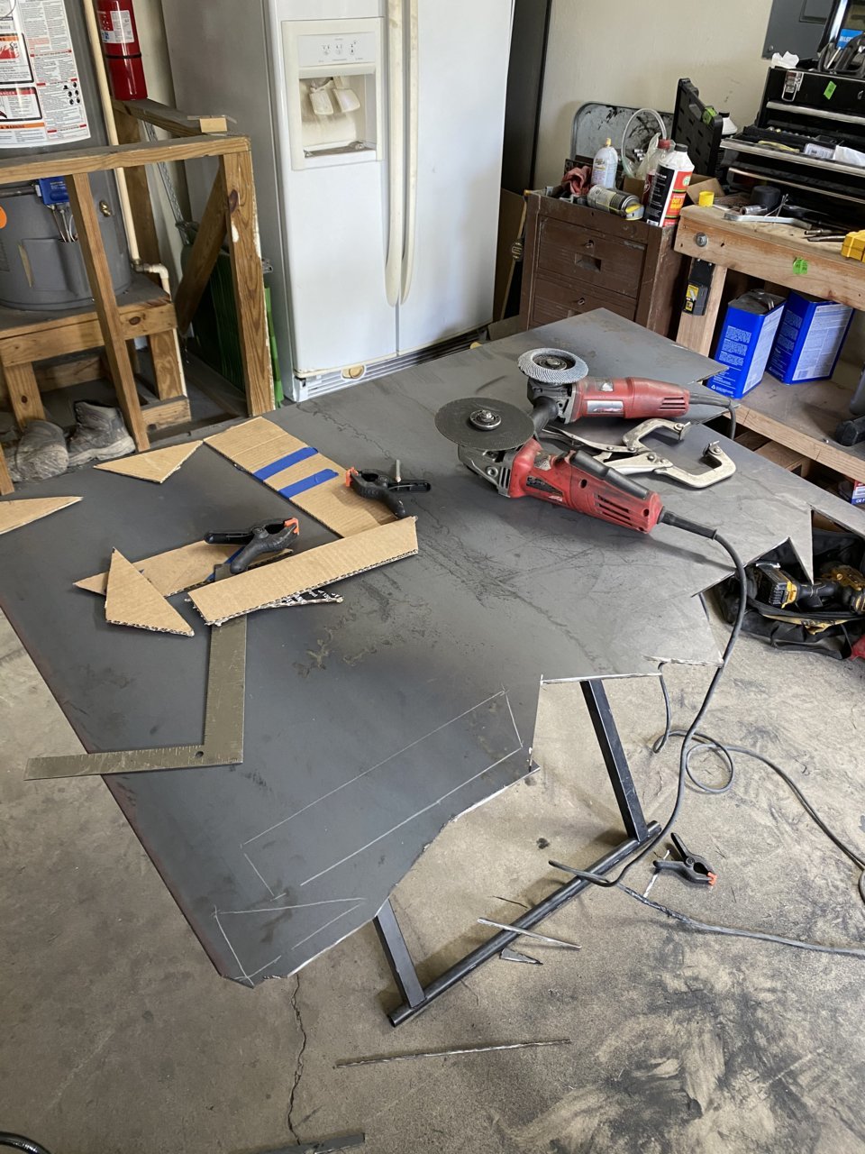

    Looks awesome bud, how are you cutting the pieces or are you having them cut?

    Thanks man. I’m just doing the cutting with angle grinders. Shaping it up with cardboard and tracing it onto steel with one of those steel pencil things. While the cardboard and tracings aren't perfectly straight, I'm pretty good at eyeballing a straight cut with the angle grinder. That's one perk of lacking a plasma cutter is now I'm great with an angle grinder.

    Steel Pencil thingy = Soap Stone !!

    I use these:
    https://www.amazon.com/Markal-96006...7VAN8D6MZJC&psc=1&refRID=GKBB2ZWBX7VAN8D6MZJC
    Mechanical version, but the same thing just no sharpening. Soap stone is good for laying out larger designs, but if you need to be more precise with your lines/cut, I'd use the pencil since you get a finer line. I use soap stone to draw refence lines on my garage floor all the time.
    Also for future reference, I use Ram Board to CAD things up. Easy to cut and layout and cheap enough to keep a roll around for miscellaneous things.

    I had that same pencil but I kept breaking the tip off. I found the actual pencils are better for me because they're finer like you mentioned and a bit cheaper. All I had to do was steal my wifes pencil sharpener first lol
