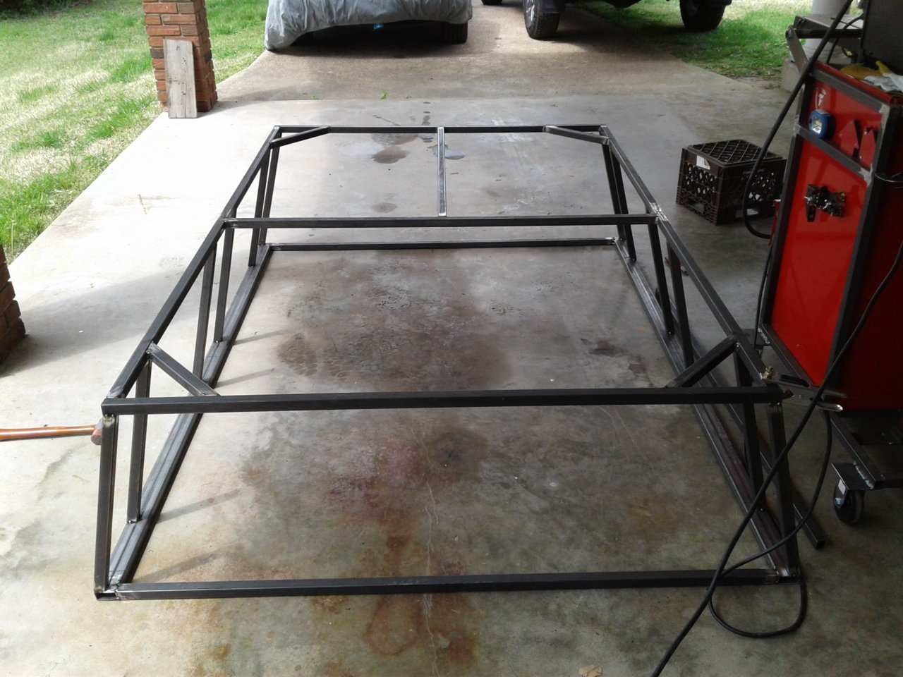

    Nice work! I’m fixing to start on my spaceframe in a few weeks. Can’t wait to get started on it, just gotta finish up this last project I’m in the middle of

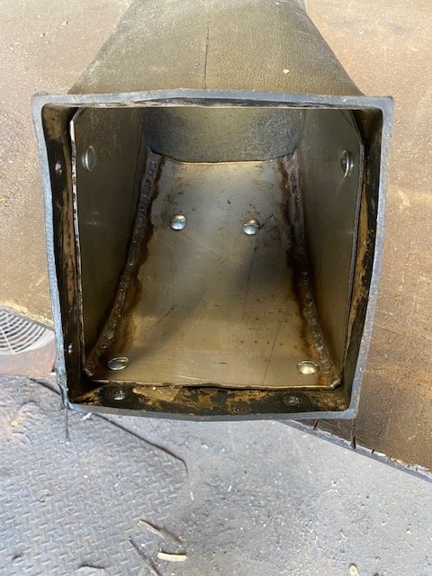

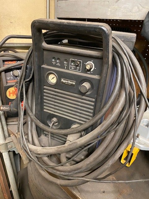

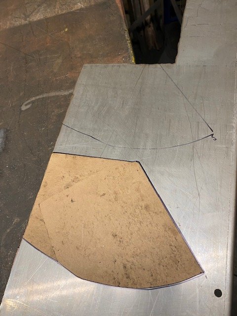

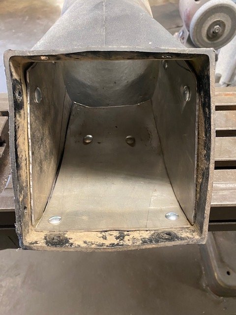

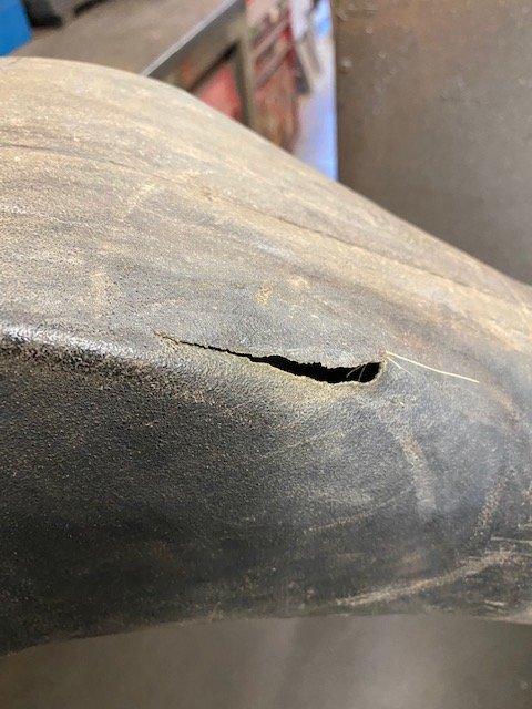

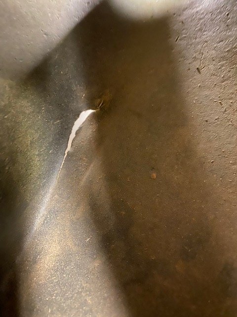

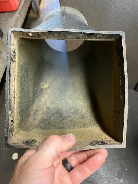

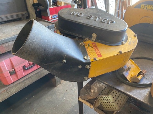

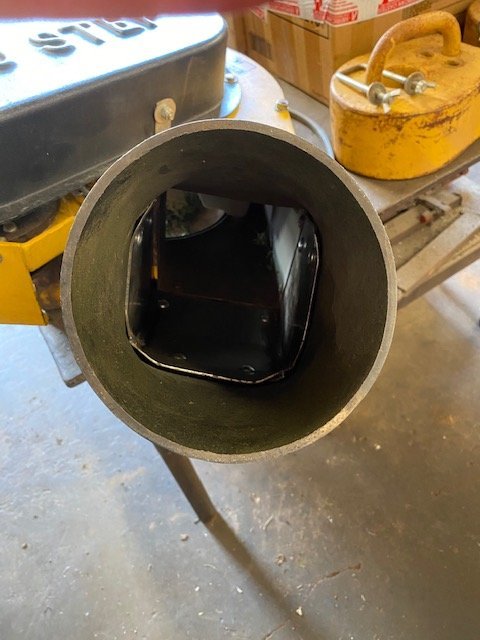

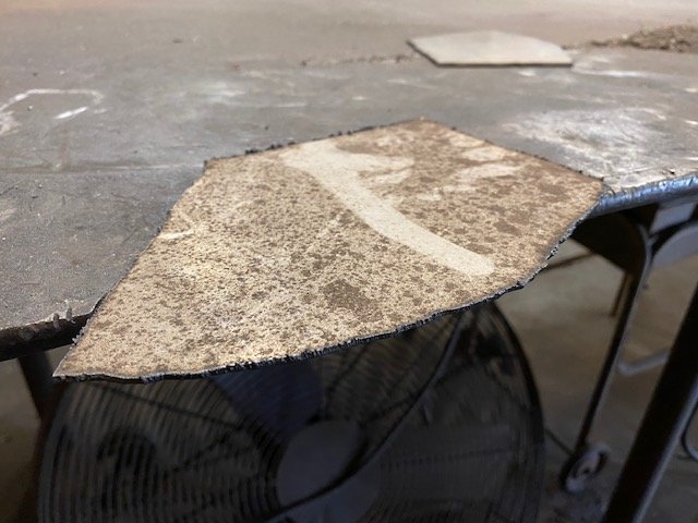

    I bought a used zero turn mower last week with a vacuum system and been going over it and this chute piece was worn and had a hole in it. Decided to break out the cardboard and fire up the plasma cutter and fix it. Should last me a long time. Welding it and not catching it on fire was fun. It wouldn't fit in if I welded it outside.

    Reserected from the dead.
    Nice save!

    I was excited I thought you were going to break out the plastic welding kit and weld a piece over the hole.
    Not really much different then tig welding a heat source and the correct filler rod.

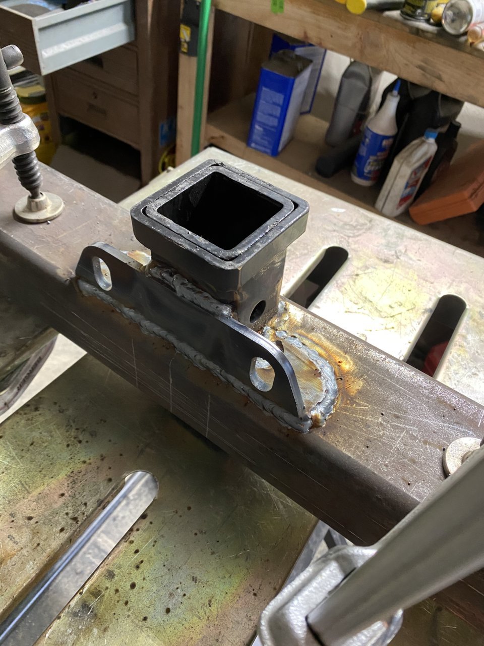

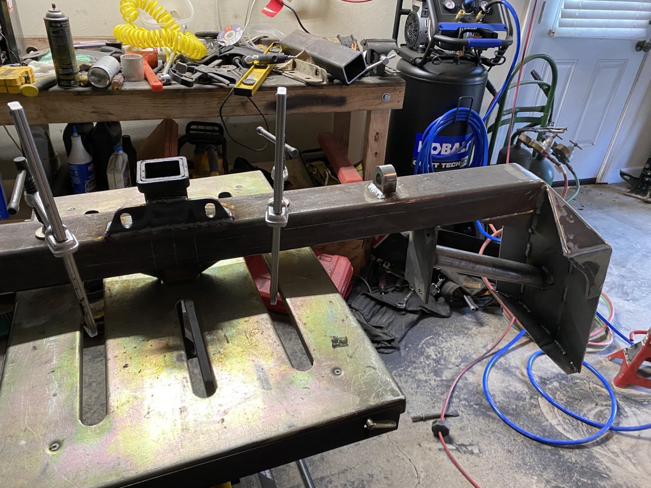

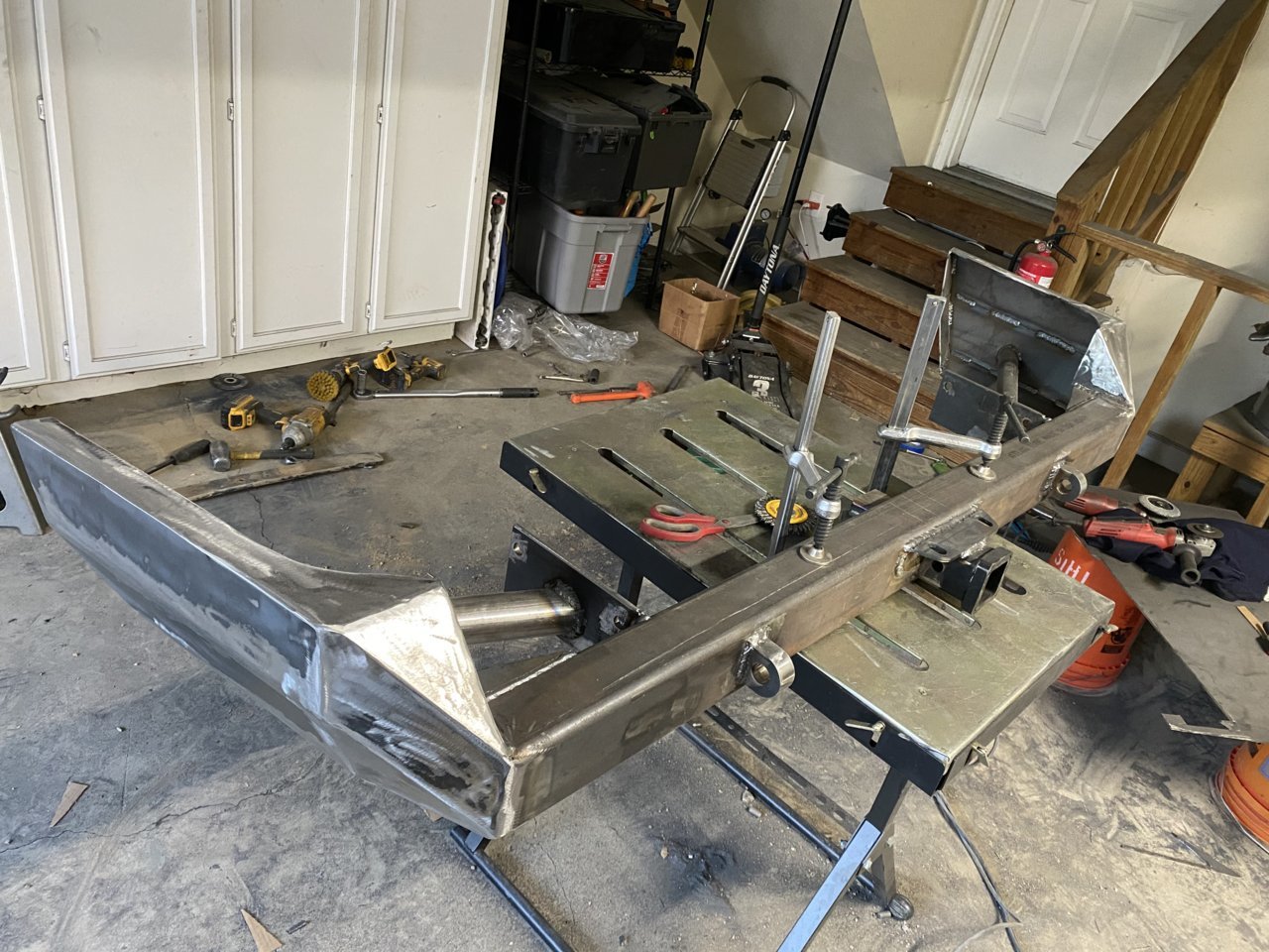

    Bumper is just about done. Just need to cap one of the end tube (minor oversight) and then hit it with a da sander to get it nice and smooth and millscale free.

    So awesome! I didn't even start on mine yet.

    Thank you. I should have it skinned by Sunday.

    How much does it weigh?

    98 lbs
