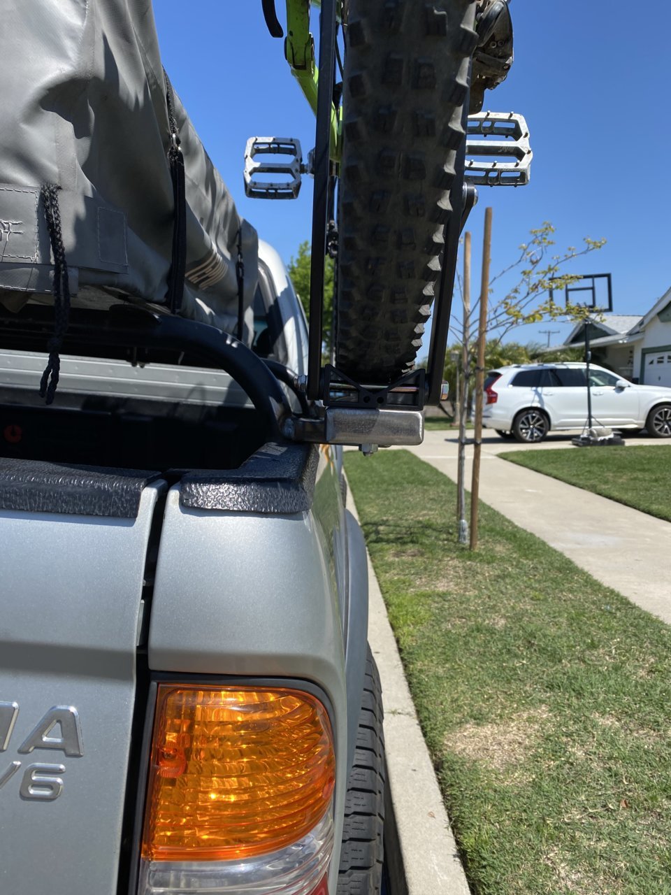

    Picture stolen from https://www.tacomaworld.com/threads/bottle-opener.485790/
    Post #4, Picture credited to @Cmurder

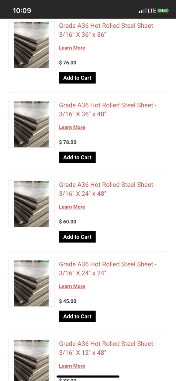

    I would guess the Craig`s List is A36 as well that is pretty common in my part of the country.
    anything rare would be more expensive and it would be noted

    If im reading that right, that is Abrasion resistant iron. It's gonna be expensive. It's the same thing back how buckets are made of.
    JTFisherman[QUOTED] likes this.

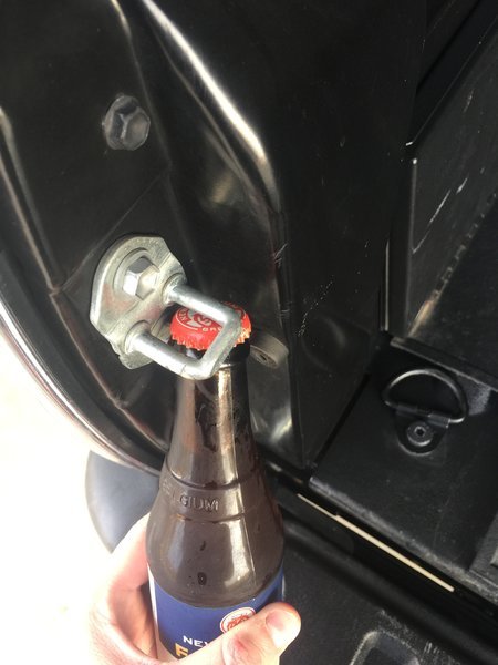

    I've often thought about adding a bottle opener for things used away from home. After giving it some thought, I can never think of times we don't drink canned beverages. Bottles are an excessive hassle to deal with. I end up skipping a bottle opener.

    Do you have any more pictures of this bike rack? looks like it's part of a 1up.
    chowwwww[QUOTED] likes this.

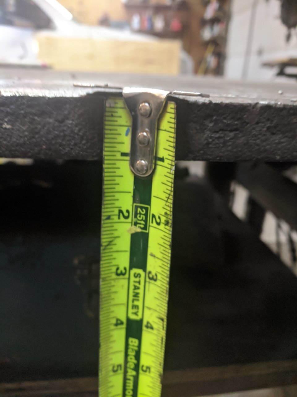

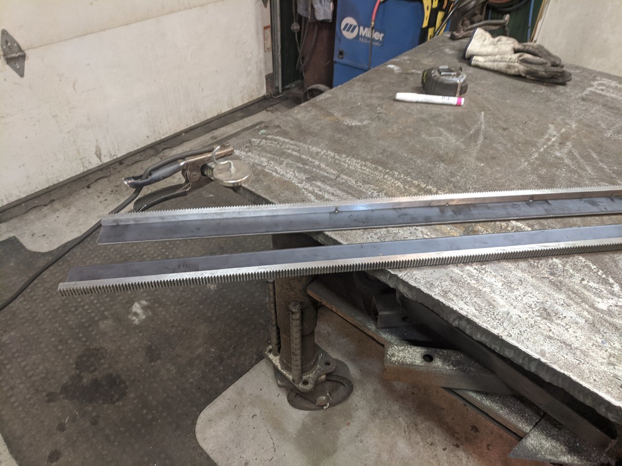

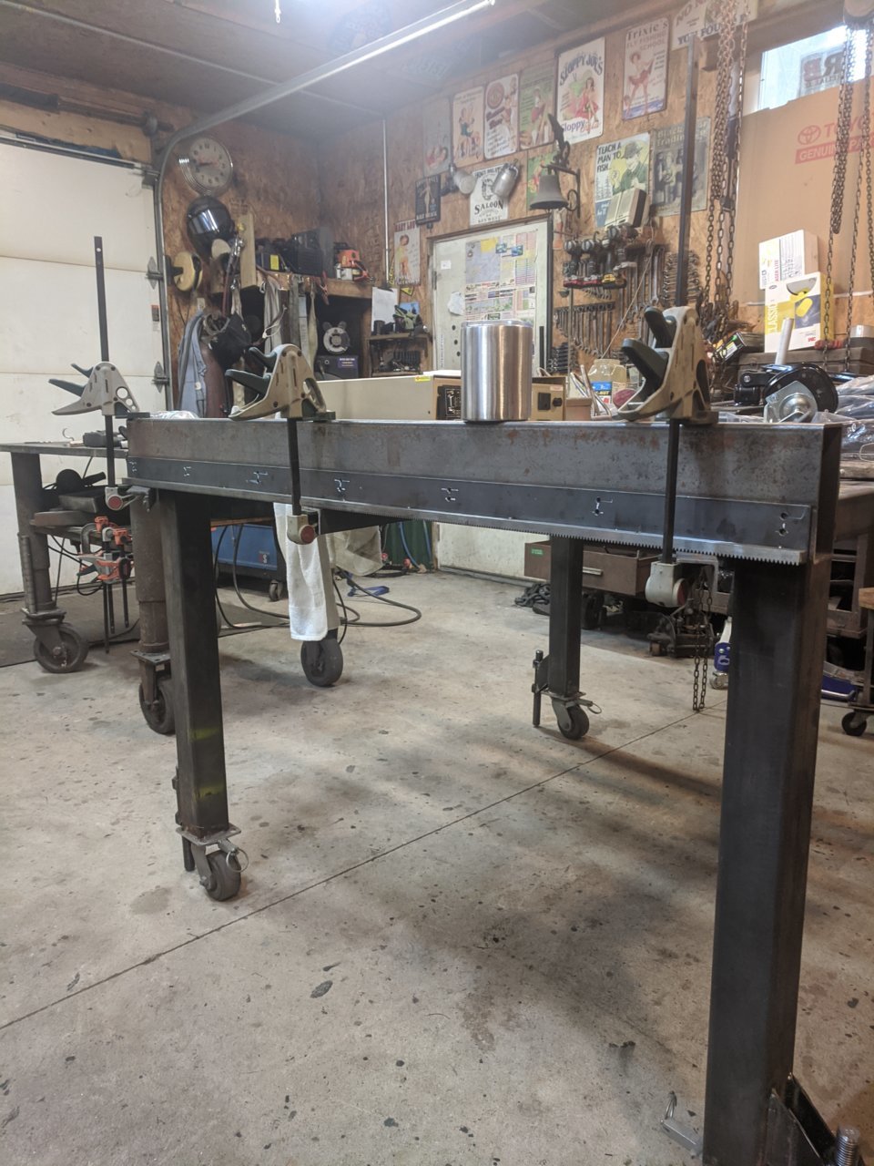

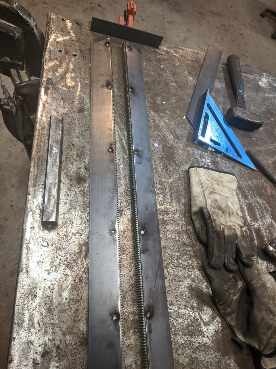

    A bit of plug welding.IMG_20200423_091541.jpg IMG_20200423_091541.jpg IMG_20200423_092856.jpg

    8 lugs no plugs
    What's the gear rack for?

    That is one thick table!

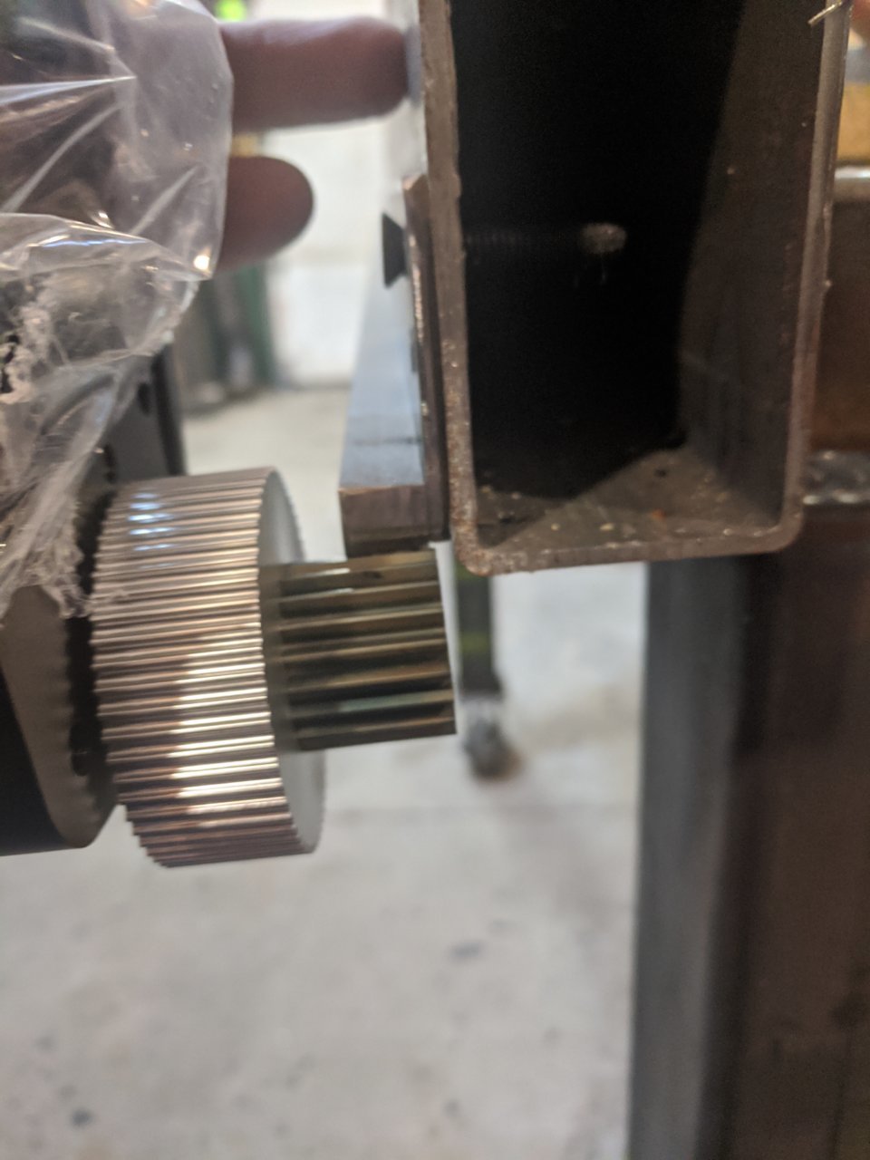

    Right now it's just a very expensive drink coaster...

    Holy weld table. Nice!

    Going with the plug welding from the back side ensured the gear rack would not "pull". I know that the rack will be perfectly parallel to the table.
    In addition, the 1/8" space the flat takes up allows me to have 100% contact with spur gear.IMG_20200423_104055.jpg

    That pic makes it look tipped, it's not.
