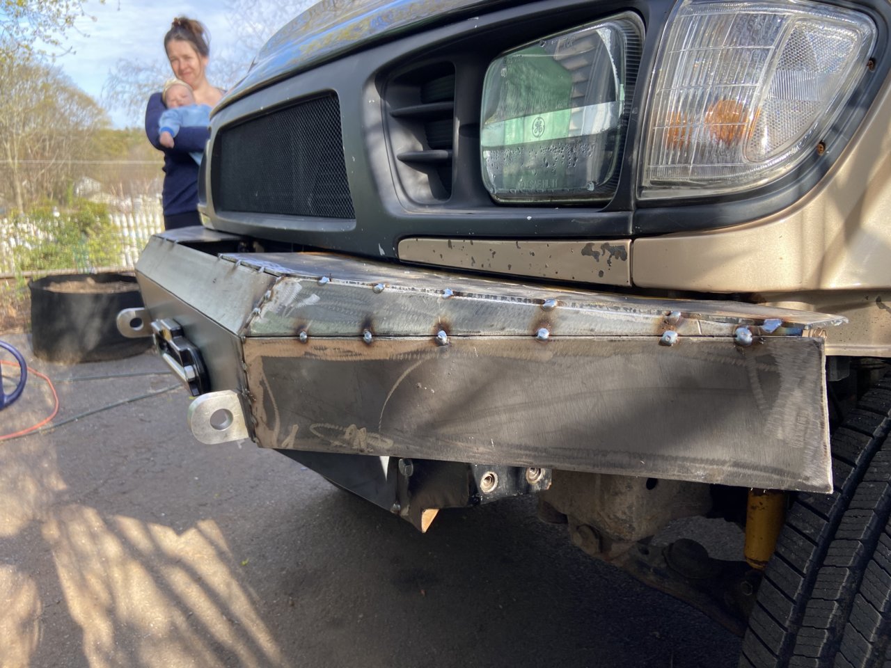

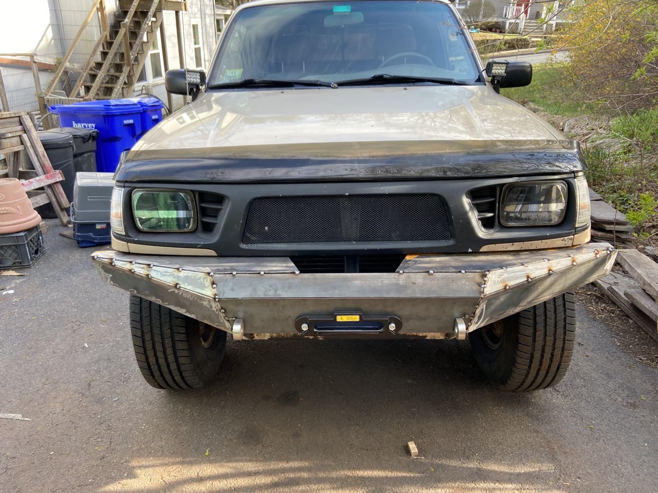

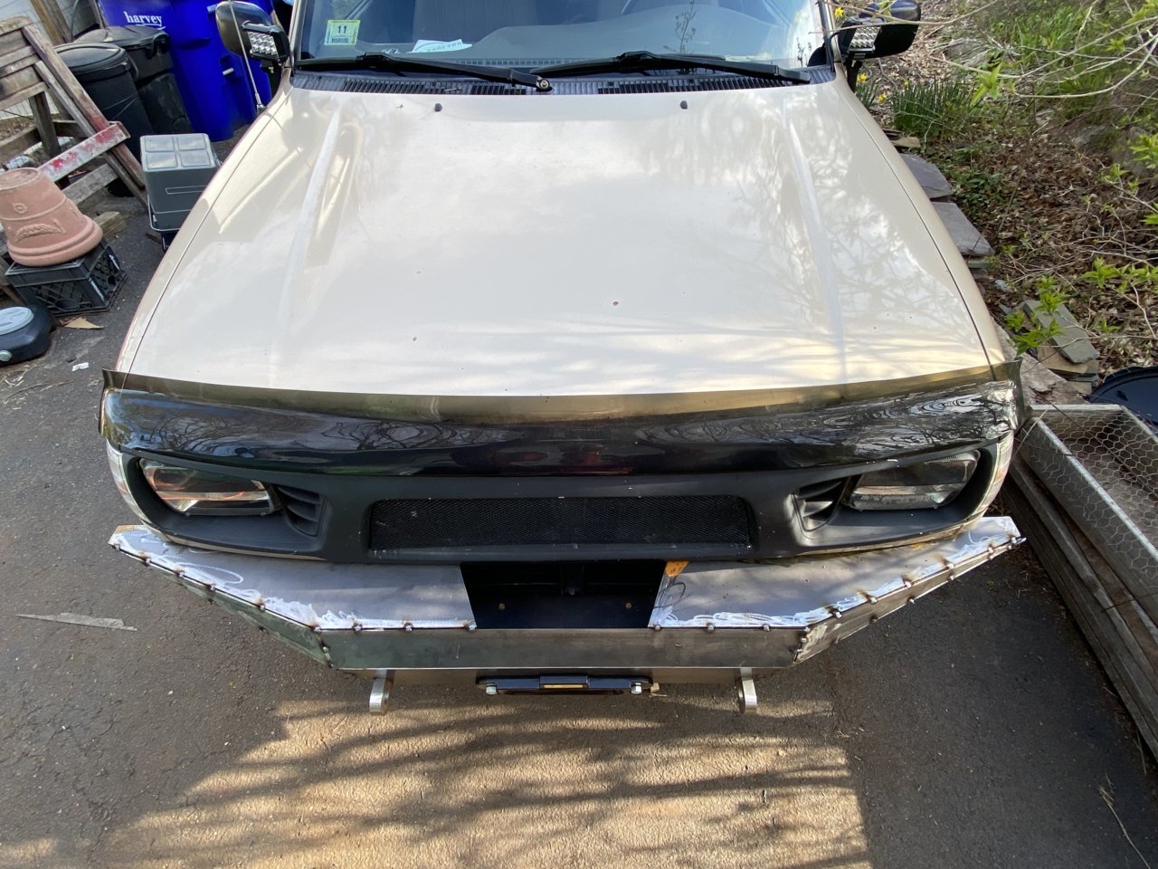

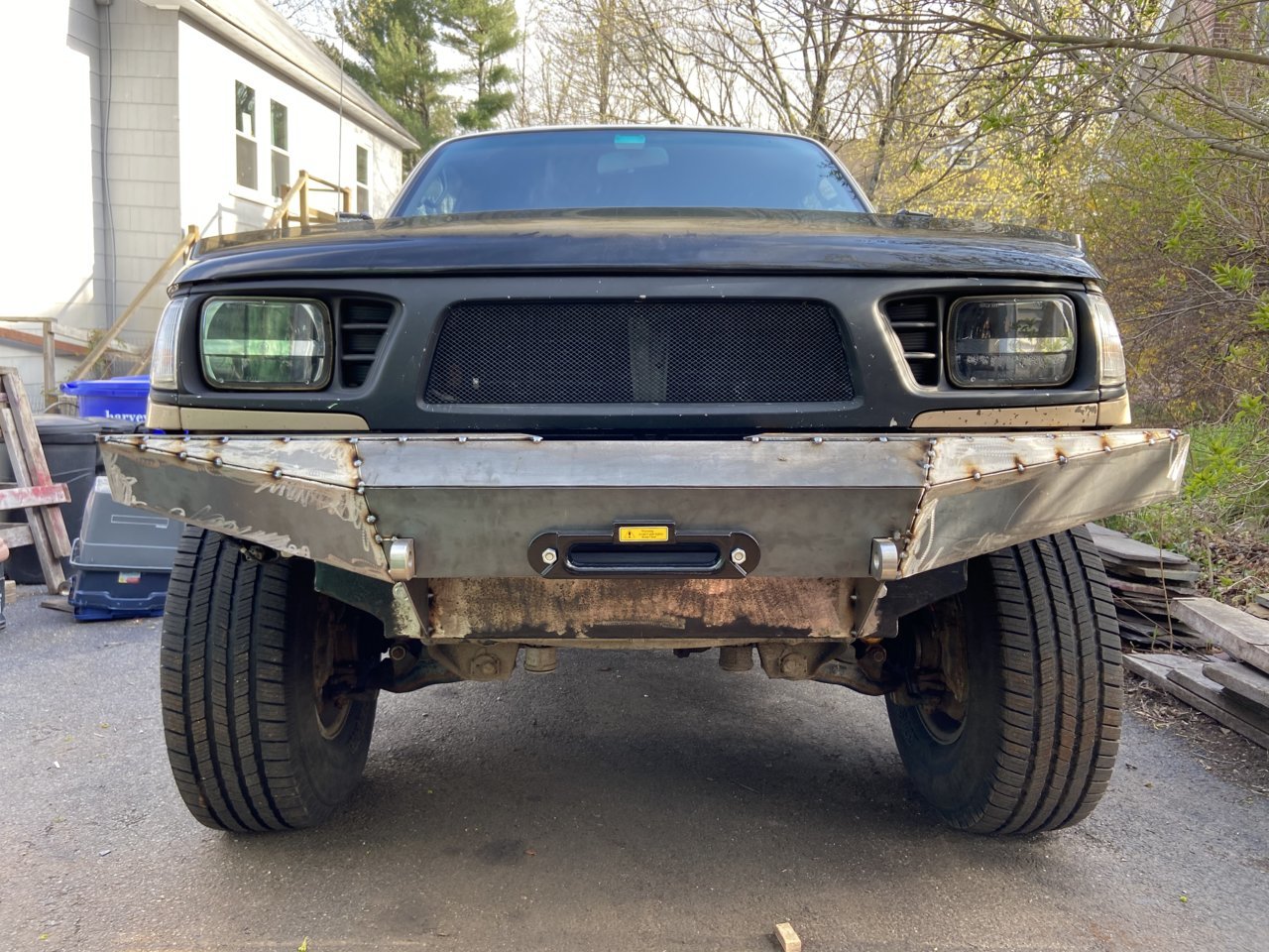

    Happy birthday to me! Got some time in the shop and made a move on my bumper.
    Wifey checkin out the scene with the babe

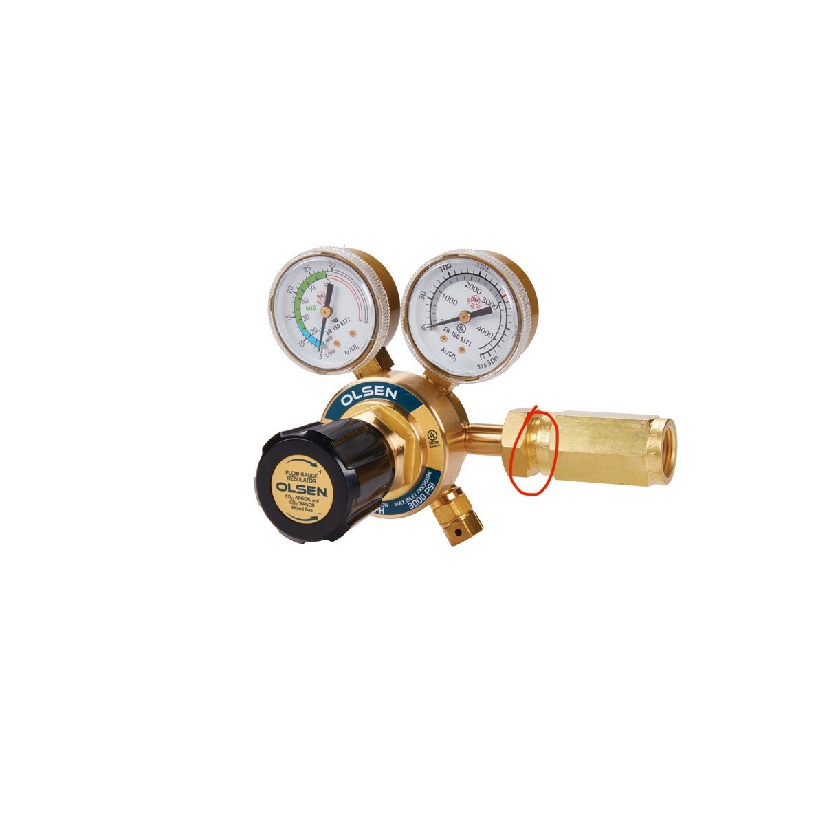

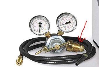

    speaking of valves, I accidentally dropped my tank off of my cart and the regulator gauge broke. Can anyone recommend one that is not $100 ?

    Use a 20% off coupon too

    Thanks. Does anything else need to be added to that? Some other ones that I saw, had a different fitting going to the tank
    I really need to finish the cart so that the tank is not just balancing on a piece of wood.

    The one pictured just has an adapter so it can be used with a straight CO2 tank. The two tanks use a different kind of fittings. It will work with what you have now.

    It unscrews right here and had a fitting like what you just showed.

    When do you start on the second one Now you have the measurements should go faster .
    What do you think you would sell it for paying yourself a decent rate ??

    This was just a one-off thing, I don't plan on making any more. The mounting points bolt to my rear leaf hangers and the side wings are for a bobbed bed so it wouldn't work on anything else. I have way too many hours into it to make it worth it to offer bumpers for sale even if I were to build them for normal trucks.
