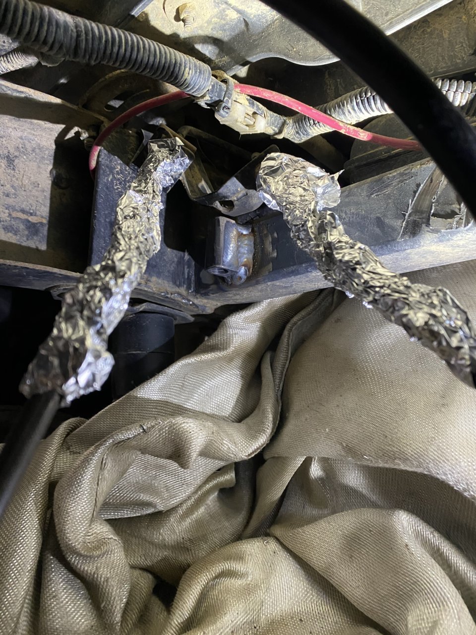

    Hot splatter will burn right through Aluminum foil unless you had wet cotton rags underneath .
    Learned this lesson the hard way burnt a hole into a air line of course it was one that went from the brake valve on the dash to the one on the valve between the rear axles. No splices are allowed it was not a fun day.

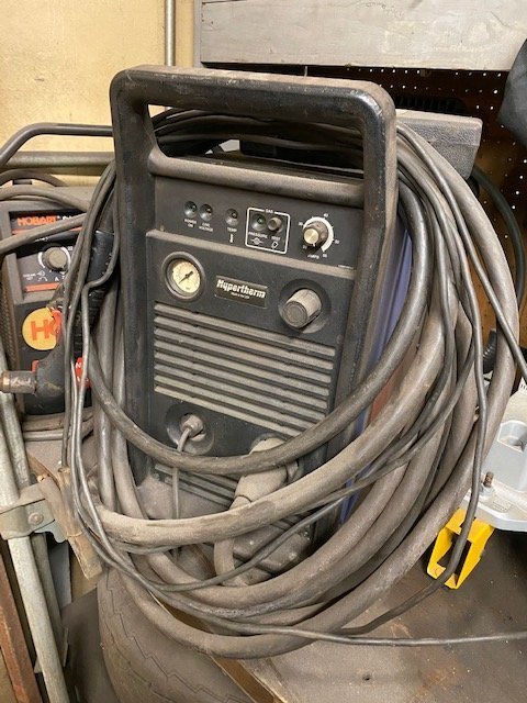

    I bought this hypertherm powermax 900 at an auction with a lot of consumables, a cart, a 50’ drop cord, and two cutting leads for $1,050 I didn’t know if it worked or not. That was 15+ years ago and it’s never missed a beat. I’ve cut 3/4” thick steel with it.

    That is the same model I have
    The only downside to the PMX 600 ,800,900 was the Torch it was a poor selection in torch covering it was just as bad as a cheap garden hose .
    It seemed if it heard a Weather forecast any temperatures colder then 45 F it was impossible to get any where close to straight.
    Replacement Torch was a great upgrade that never gets used .

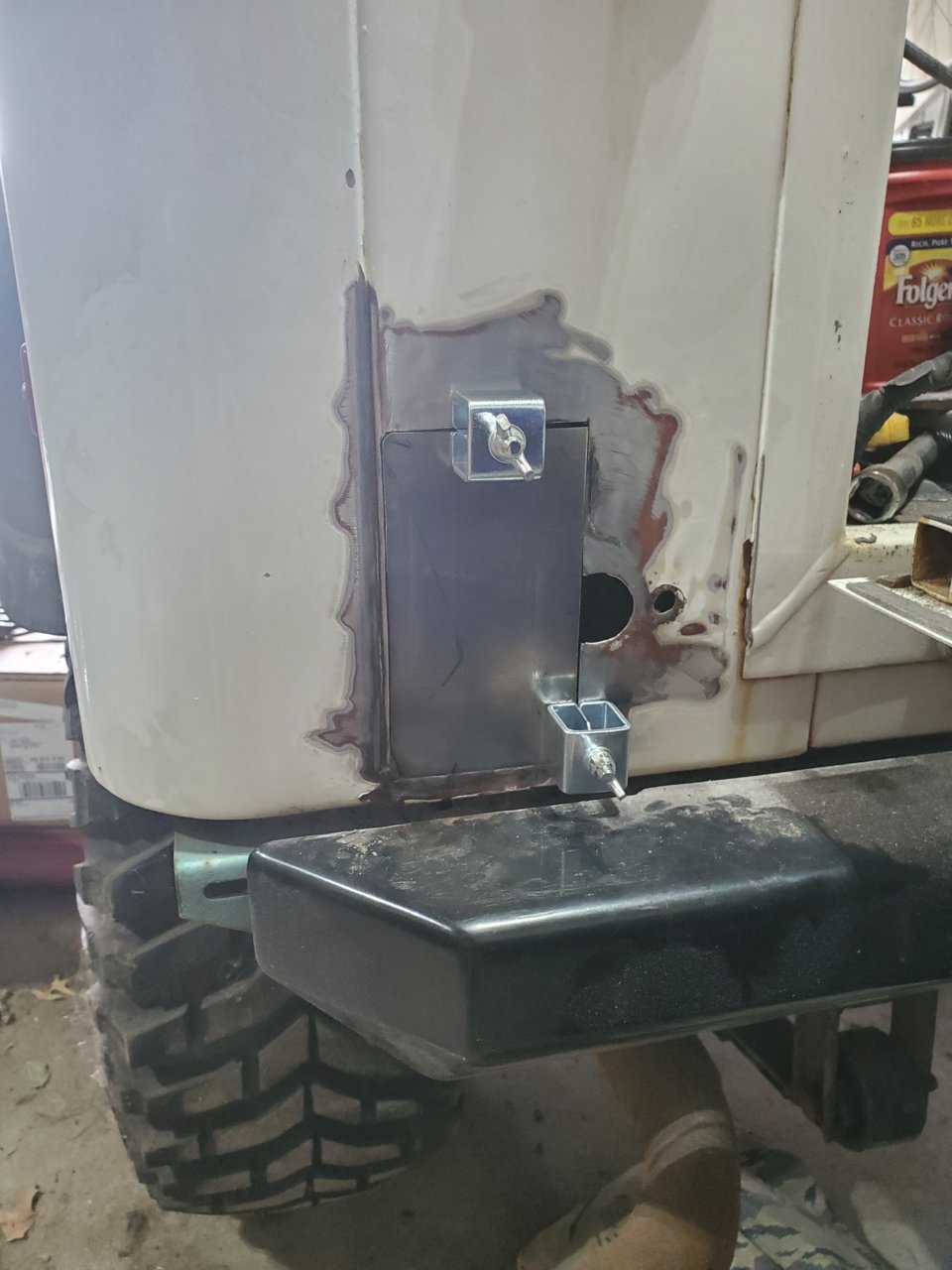

    Today is body work day. I figure while I’m here, I may as well take the time to weld these shut.
    tack tack tack tack (repeat for 30 min per side)

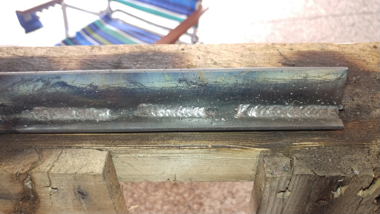

    So my hobart 140 came in today so i got to try it out. Pretty excited! Heres some photos of my first ever welds. .035 flux core wire on 1/8" plate. Let me know what you guys think. I have no idea really what to look for in my welds so i dont know if i need some adjustments on my machine or not.

    That looks pretty great for your first welds. Are you using the machines recommended settings for wire speed and voltage?

    Thanks man. I'm kind of just running an in between setting cause the chart on the machine doesn't have anything listed for this thickness

    I also have a Hobart 140, an older one that has only 4 taps. For me at least, I've found that it runs really well with .030 flux core. It may be that I move the torch slower which give more time for heat transfer w/o too much bead build-up. Give it a try.
