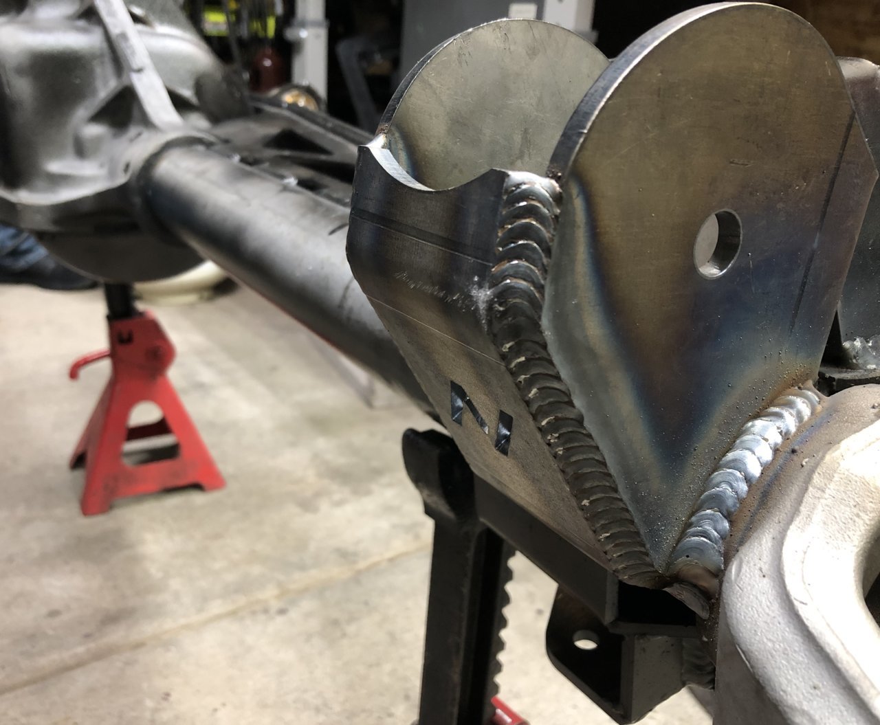

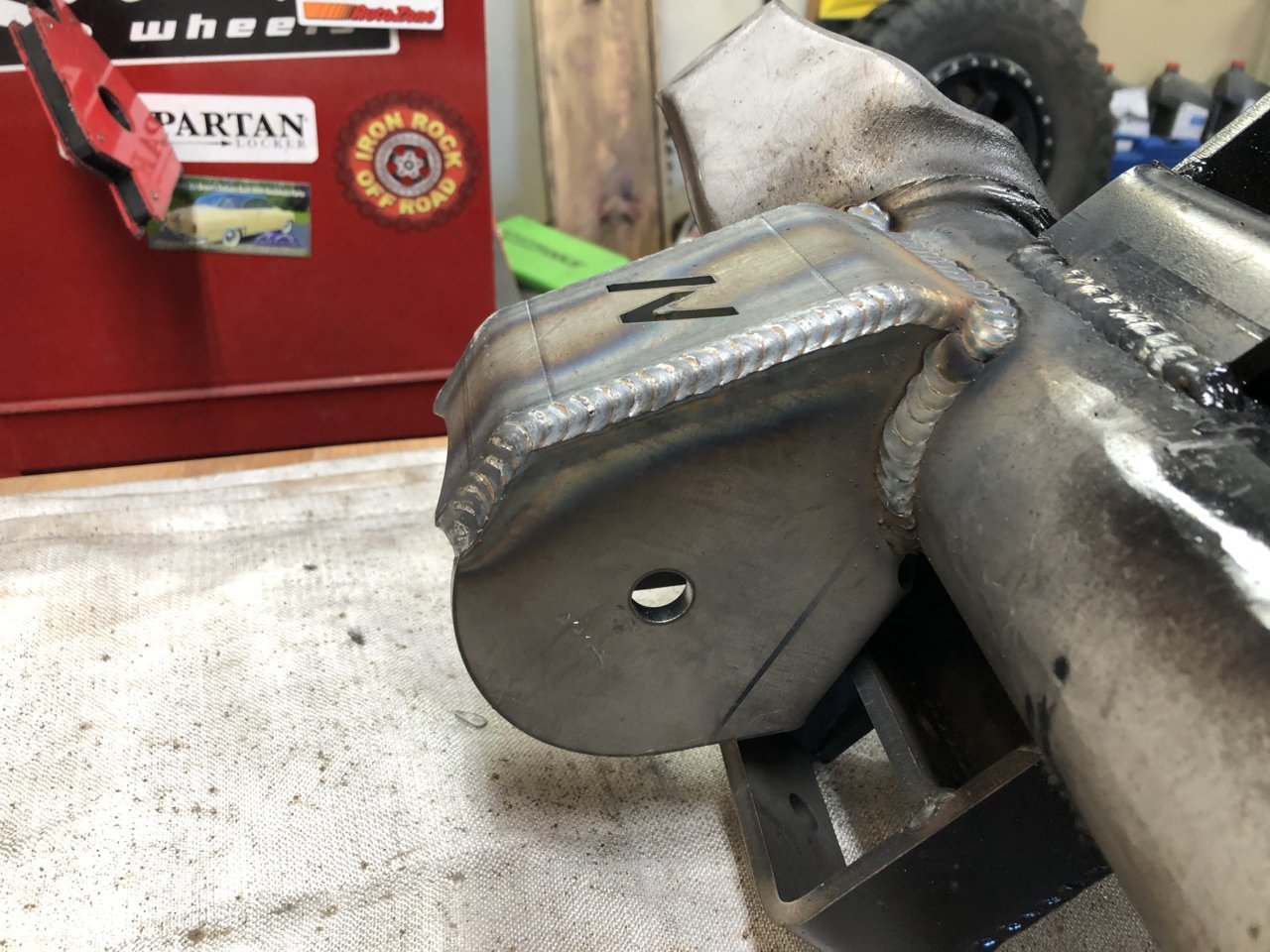

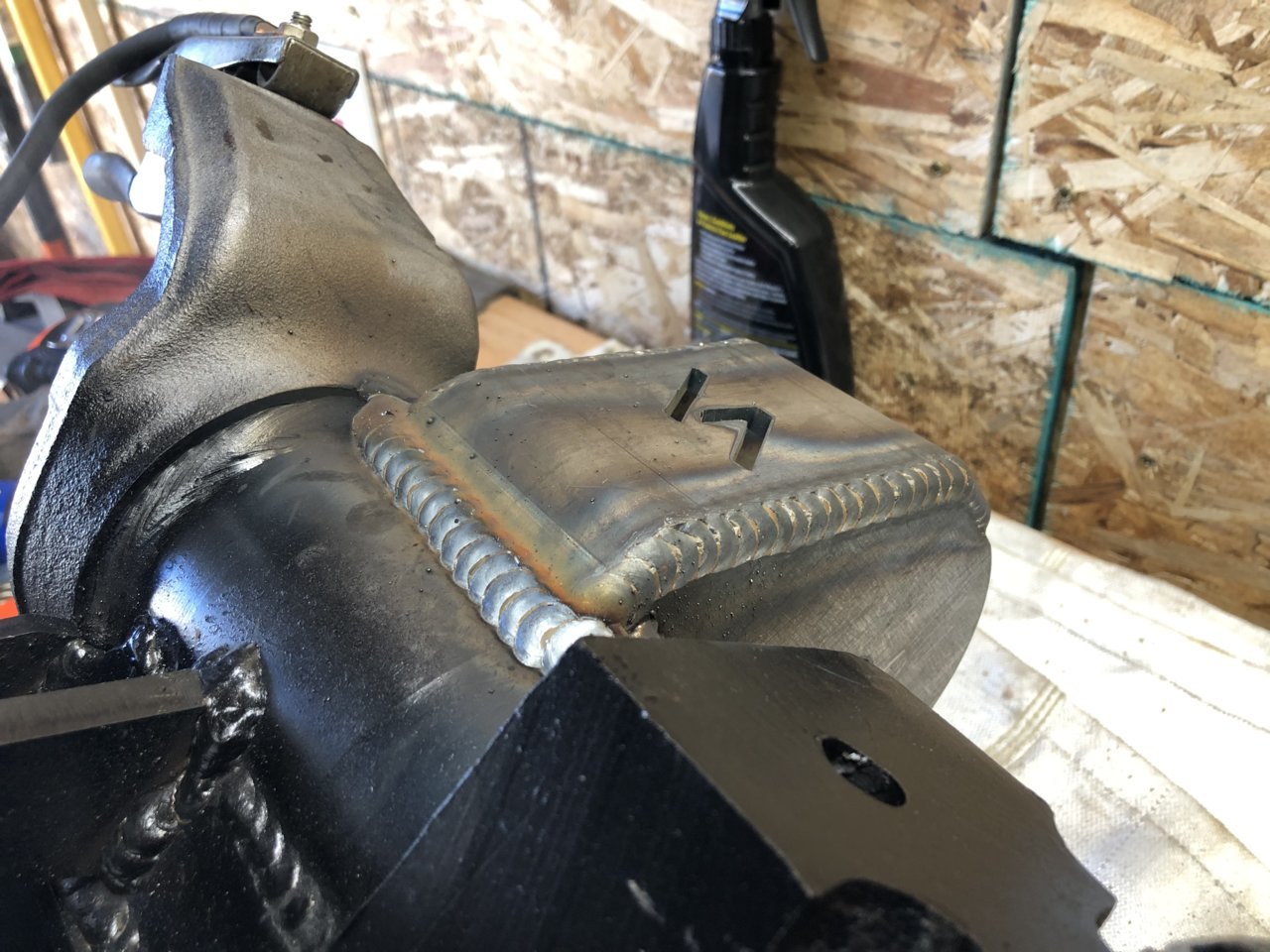

    I switched to my spool of .035 this weekend since I was welding some thicker stuff that would make me feel comfortable welding with thicker wire. Supposedly according to my chart I am supposed to run the welder maxed for 3/16". It undercut the shit out of 3/8" lol, but of course it could have been me. Also blew through my 1/8" round tube once or twice, but it was nice getting a thicker bead that I would have needed multiple passes on my .023. Really this was just for me to learn how to change spools, and resetting up the drive tension (I was having large random spatter from inconsistent feeding when I swapped) and all that. Was good learning experience since I bought this welder with a spool on it already.
    I def see what @Wyoming09 means about not needing much more than .023 for most stuff now lol.
    Anyway, enough rambling, here are my welds. Welding under the bed sucks. I found that for ideal position stuff I like the lower case e approach, but the c's are much easier in out of position stuff, for me anyway.
    [​IMG]Untitled by Michael Halat, on Flickr
    Most of my vert stuff that's not a fillet I go down instead of up. My ups on anything else never look good. I'll be switching back to my .023 after this project is over lol.

    Have you tried 030 before? It’s my favorite wire, kinda a jack of all trades imo. I comfortably weld 1/4” with it down to sheet metal, in a pinch. Welds look good btw. My out of position go-to is a C as well, just Slowly jump back and forth between the two pieces best I can.

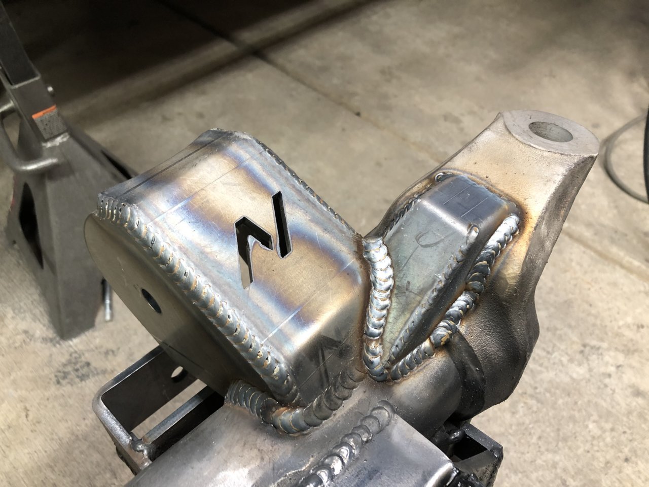

    Thanks! No pre heating and that is stainless 316L.

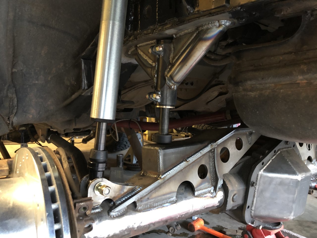

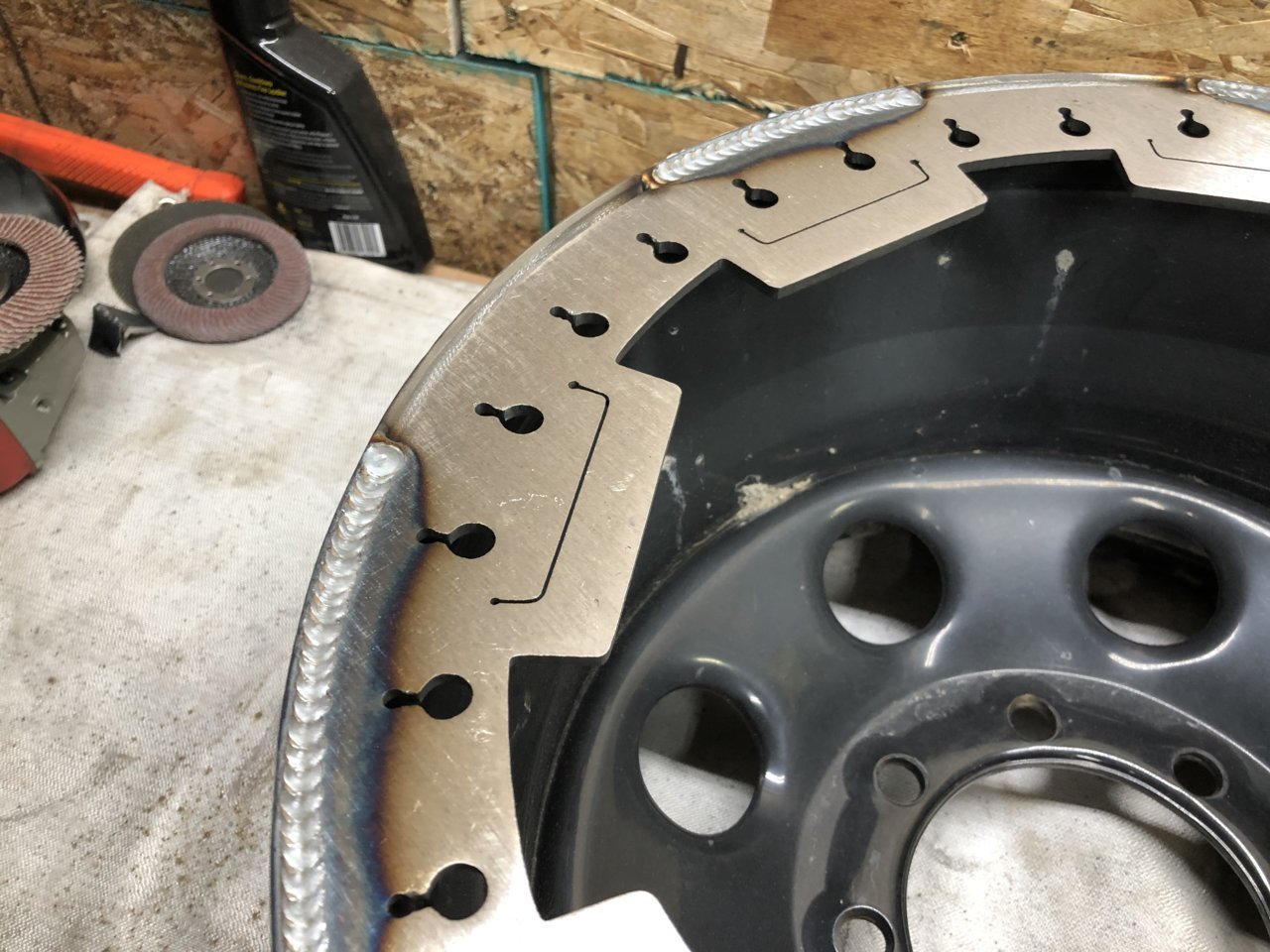

    Photo dump of some recent stuff plus the rear bumper added onto the flatbed and tied into the frame on the last truck, simple but clean in my opinion 29E6F601-0DAF-4397-98A0-13946C1993CE.jpg90B49946-5EF9-4C8D-B7ED-A928E8C161B5.jpg2E0F3BC5-8C7E-4D73-9BF3-5A8AEE437B71.jpgE9168AC7-C44C-488E-8803-60AFEED75FD1.jpgD0CA7EF7-AA16-4B03-BC83-71B9C3F13A50.jpgA41A339E-E328-4AB0-A934-C2BD603BC3F3.jpg6082D4C8-E13F-4C95-AF08-921C18153C46.jpg8B7DB048-8EB5-4AD0-86D2-77E46A282775.jpg02AFB1CB-79FD-4CA8-853C-823E3D21358C.jpg169C3B71-F0D7-4B2B-B714-1E6B6C464EC8.jpg49717CFC-2ED0-4C61-876E-DA4AAC6A5E70.jpg
    Jpiskura, buyobuyo, Tacman19 and 12 others like this.

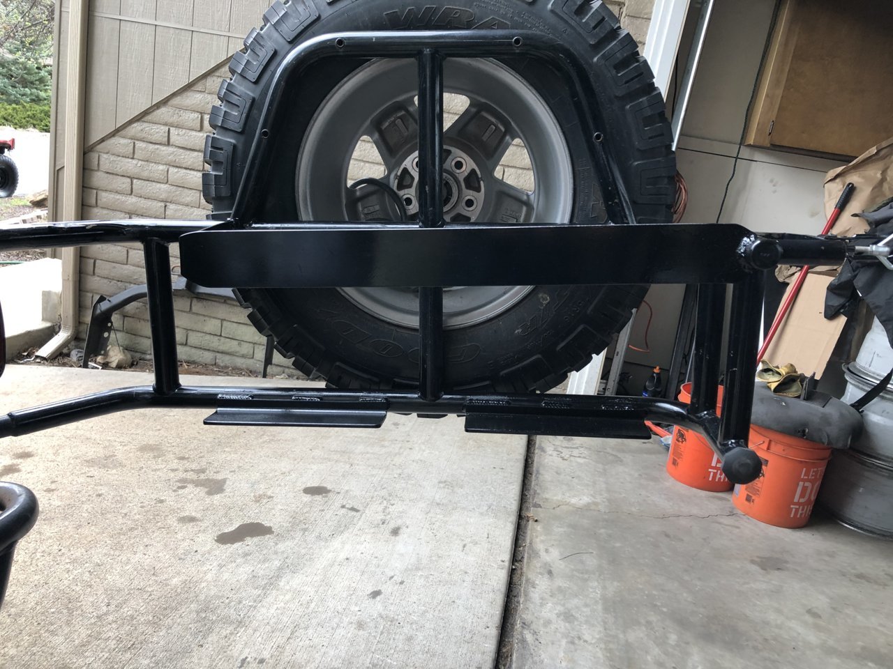

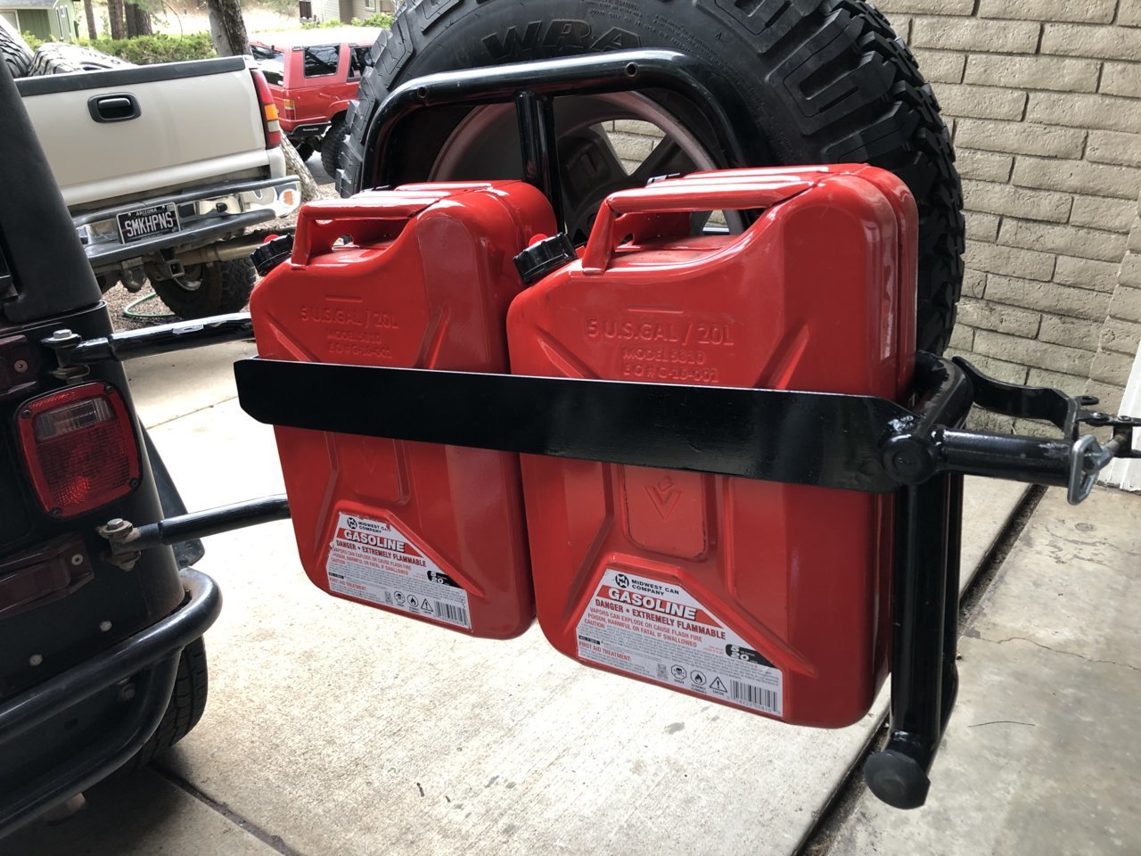

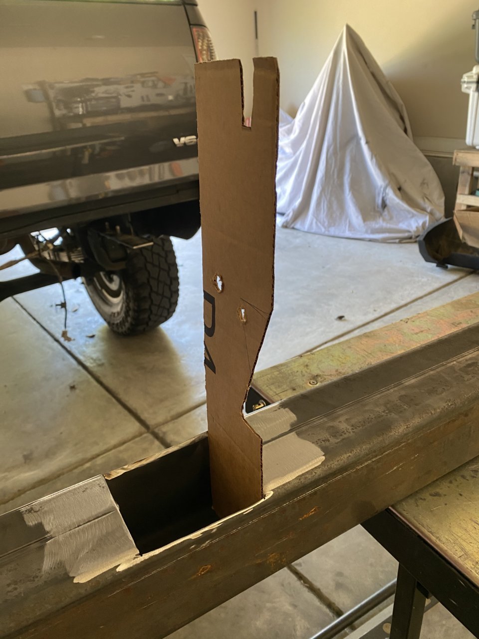

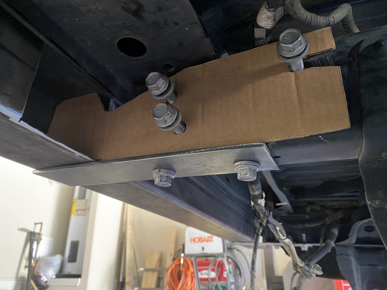

  17. Apr 26, 2020 at 12:47 PM
    BamaTaco56
    BamaTaco56 Well-Known Member
    Mar 25, 2017
    #214383
    10,306
    Trey
    This has to be the worst part
  18. Apr 26, 2020 at 1:15 PM
    Wyoming09
    Wyoming09 Well-Known Member
    Apr 24, 2015
    #153833
    14,277
    New Tripoli Pa
    2000 Work truck 5 speed 4x4 3.4
    Super Springs
    I would do them all day long!
    Section Aluminum plates into the floor of a garbage trailer not only does it cook out of the floor no matter the prep method getting things welded without inclusions is interesting
  19. Apr 26, 2020 at 1:19 PM
    EatSleepTacos
    Mar 24, 2015
    #151688
    59,838
    Randy
    West Valley, AZ
    2017 4Runner
    I like the way you did that. You could then pass the recovery point through the face, weld it there, and weld it all along that mounting plate.
    edit: I’d cap all the ends that you can so you don’t have to worry about corrosion in the tube. If you weren’t already planning. It looks like you know what you’re doing though so I’ll shut up :D
    six5crèéd and Drainbung like this.
  20. Apr 26, 2020 at 1:29 PM
    BamaTaco56
    Mar 25, 2017
    #214383
    10,306
    Trey
    I actually did this with the recovery points in mind. And it’s easier for me to trust my welds with more surface contact.
    I need to find a source for the recovery points though. Haven’t found any that are long enough.
    I have you fooled if you think I know what I’m doing, lol
