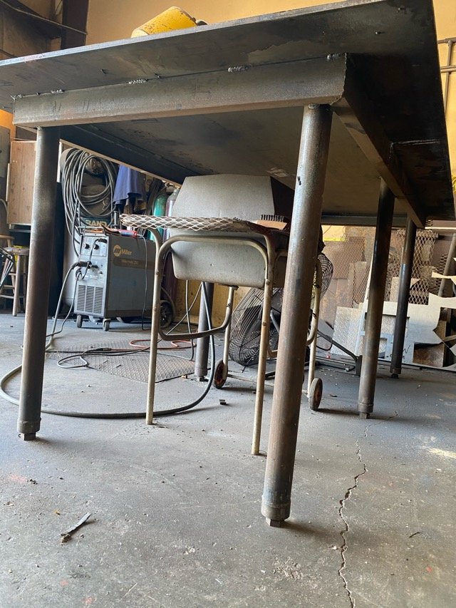

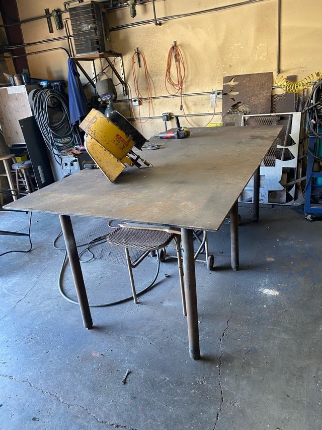

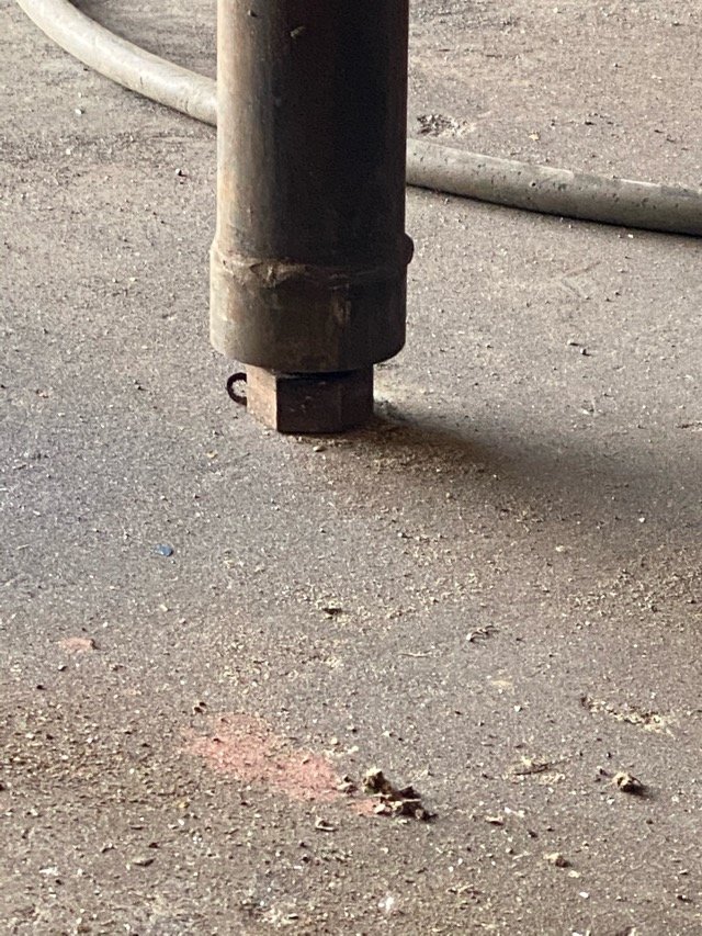

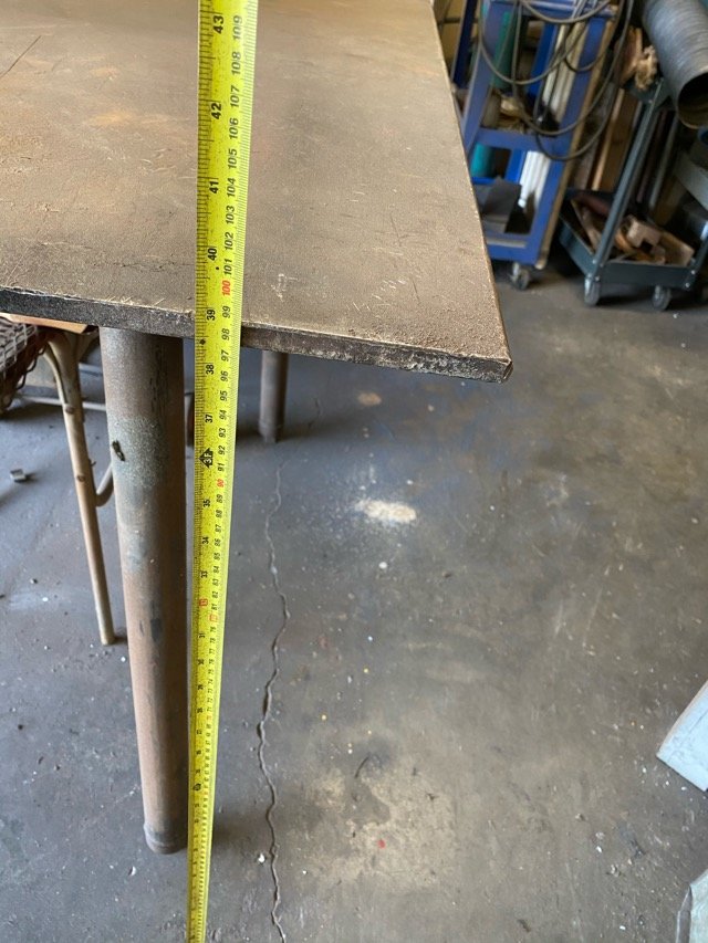

    Here’s our welding table at work. Made it several years ago with a 4’x8’ piece of 1/2” steel. Welded 3” channel under it for stiffness and the legs have adjusters cause our floor isn’t perfect. Also made it 39” tall so I don’t have to bend over to work.

    The table height needs to the height for who ever uses it the most.
    My table has adjustments for height that I thought I might need I also added Good Casters in the event I needed to move it.

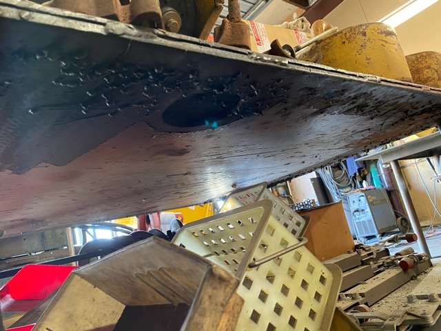

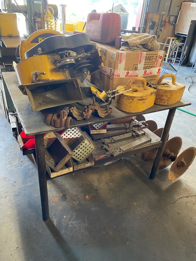

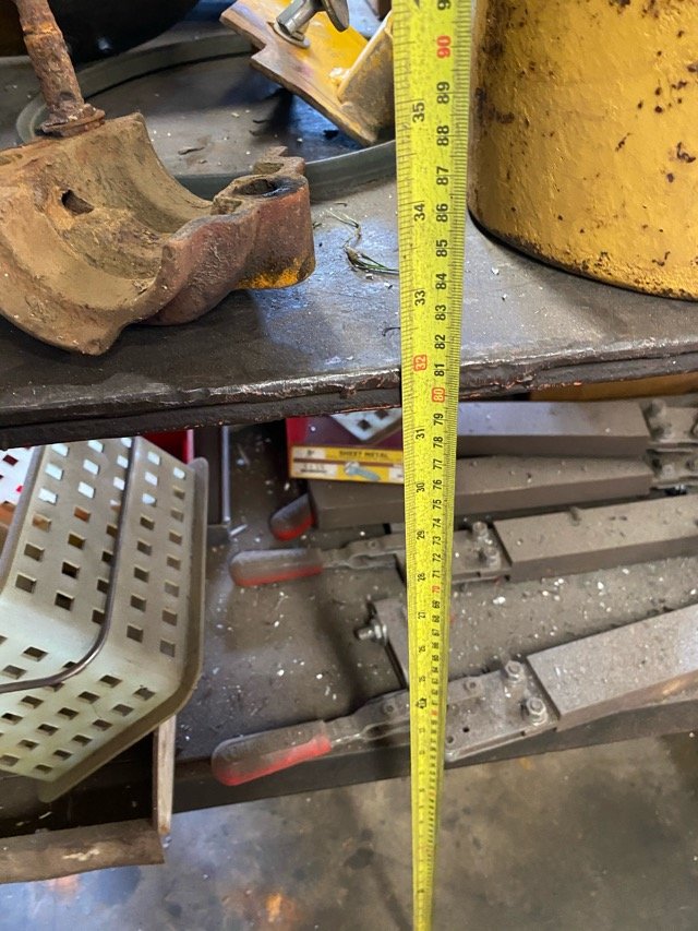

    Exactly on the height. Our old shelf table is 32”. Too short for me, and small. Took me several years to convince the boss to let me build a new one. It’s had quite a few wire burn offs too.

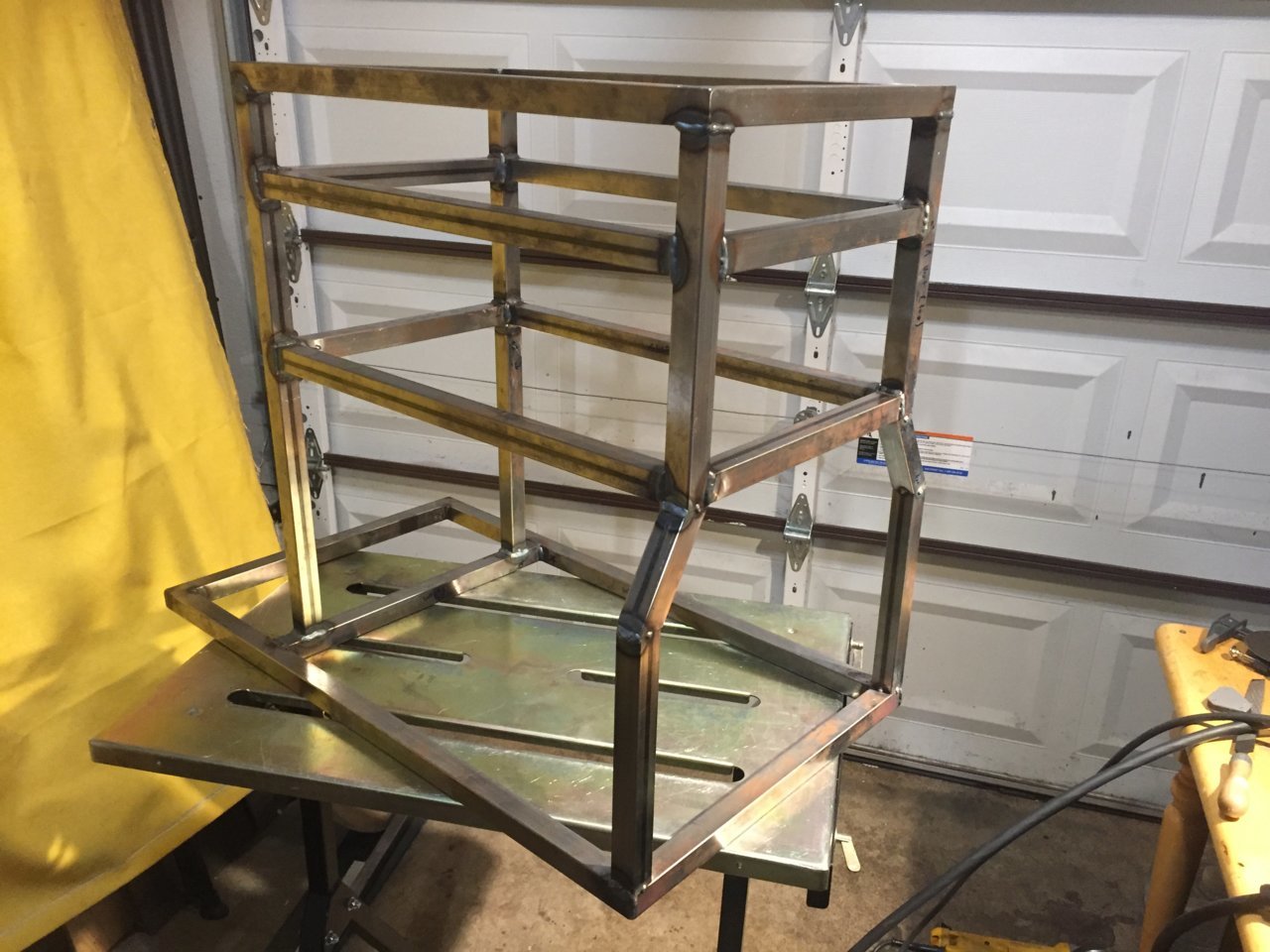

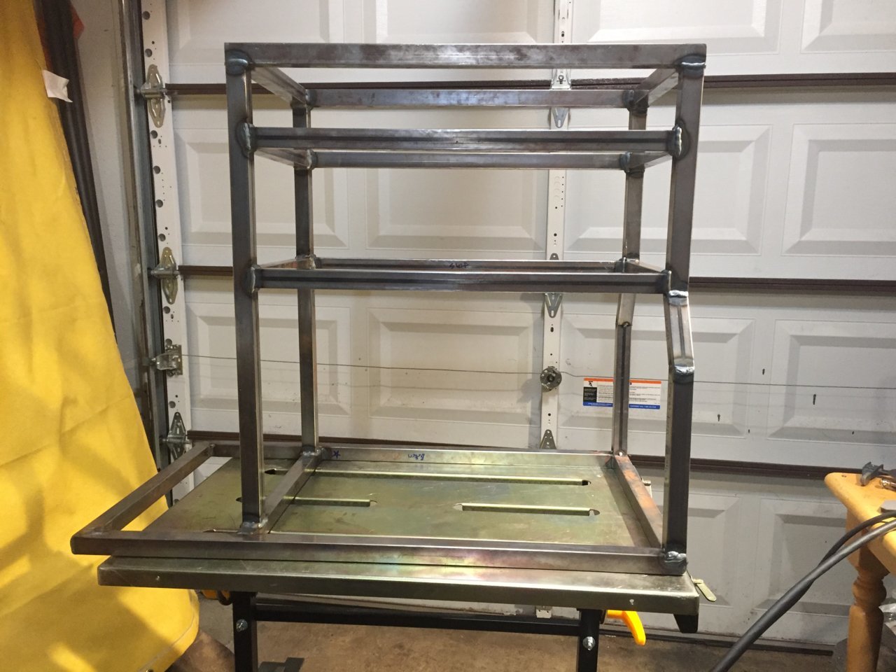

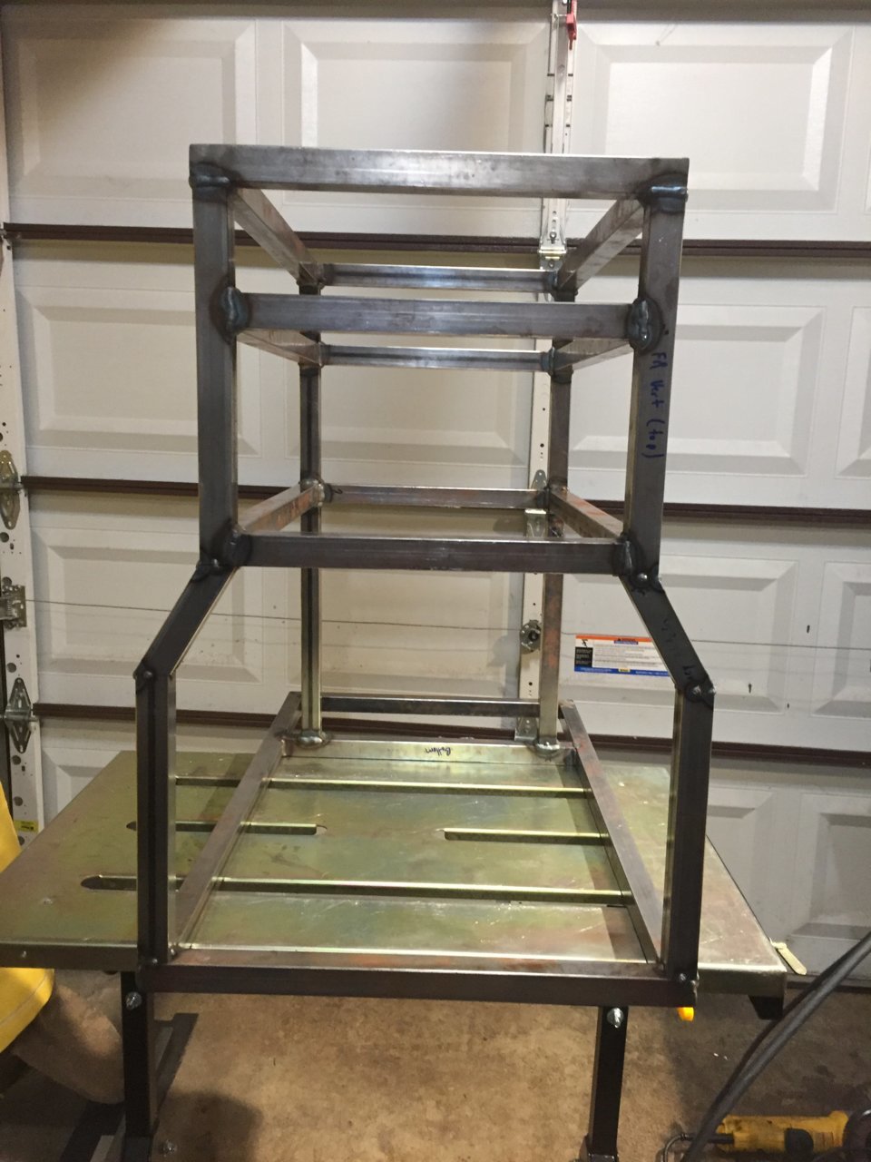

    Finished getting the frame for my new welding cart put together last night. Just need to finish up a few last welds on the front. Next I gotta start getting the tank holders together, It’s going to hold 2 155cu ft bottles. Hoping to have it all done by the end of the weekend.
    I’m really happy with how it’s turning out.

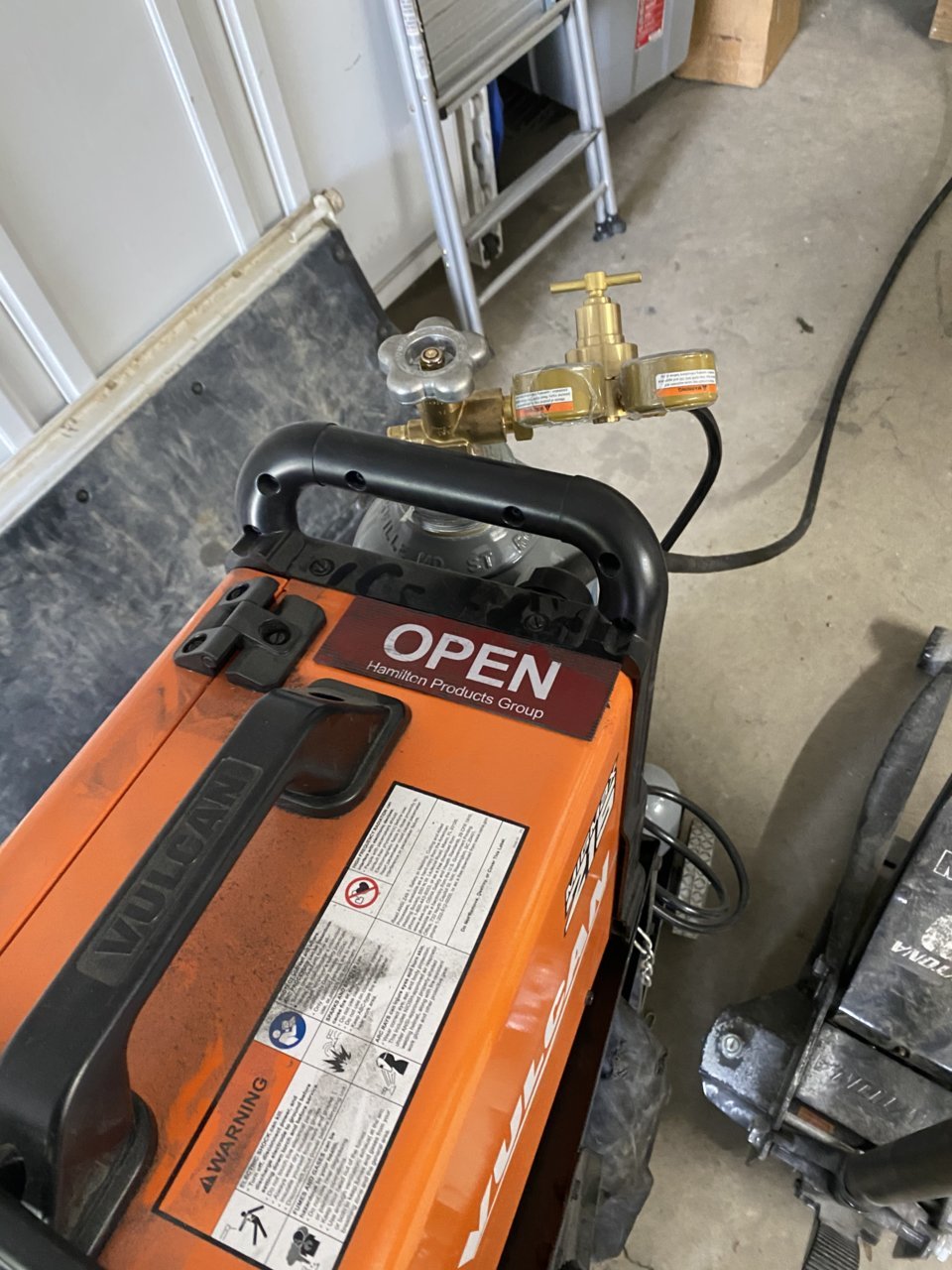

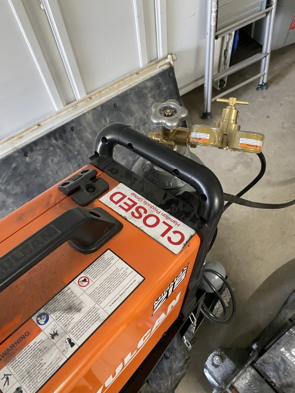

    My safe magnet from work fits perfectly up there. I think it’ll help as I’m in the habit of using them at work, as well as a dirty/clean magnet on my dishwasher. I just need the visual representation.

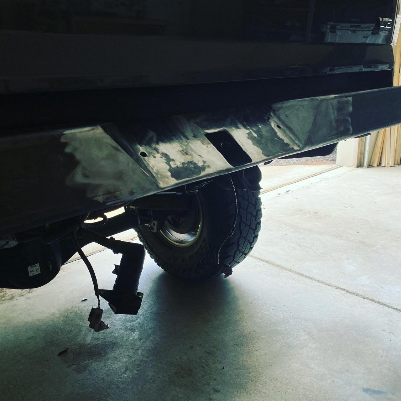

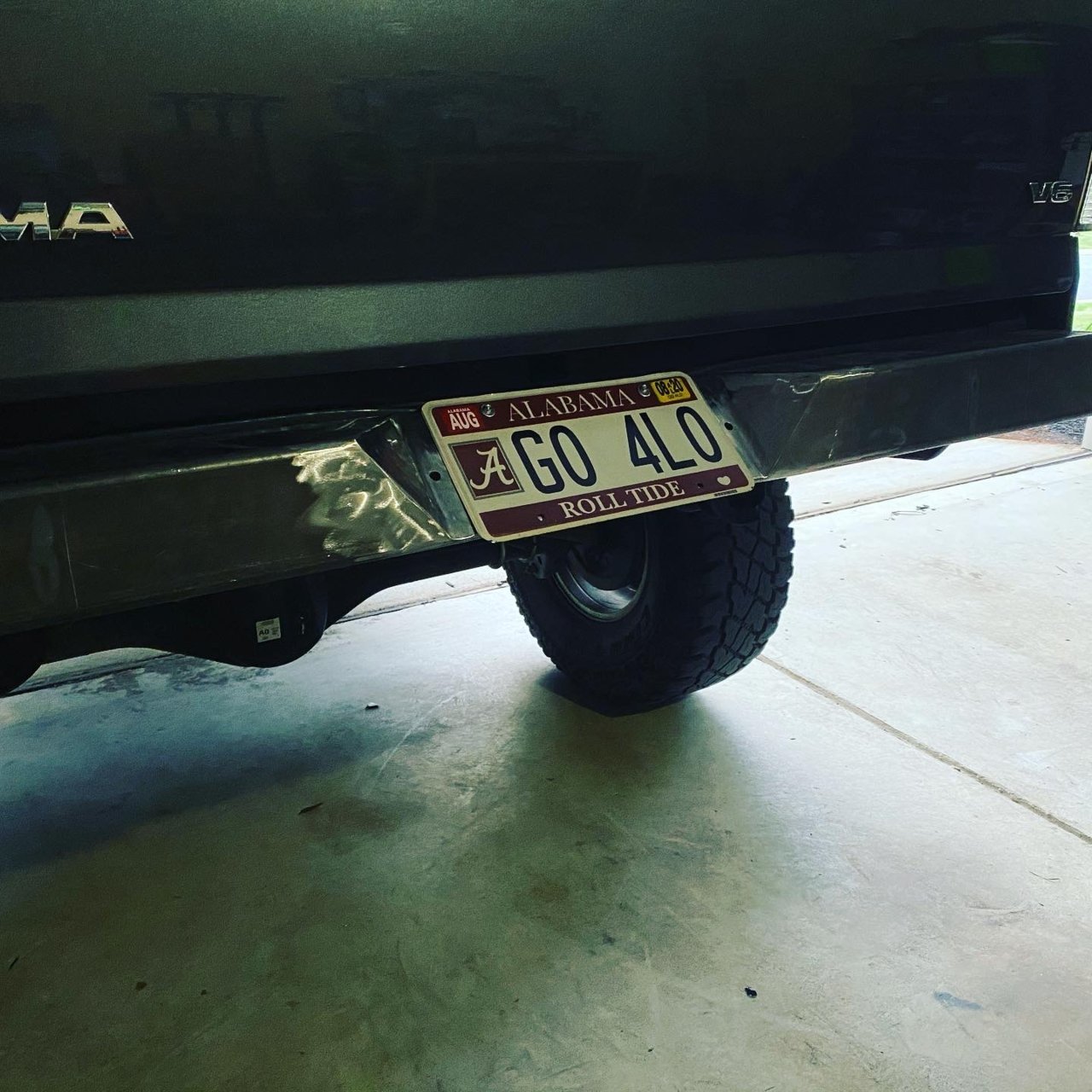

    Got the license plate / hitch area done.
