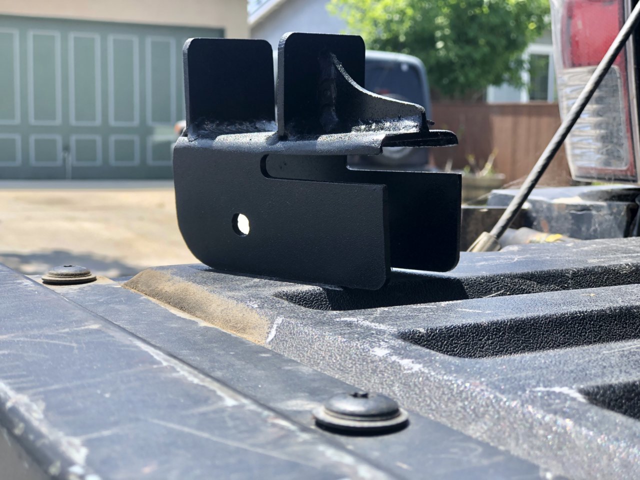

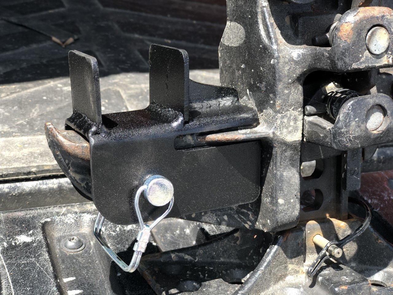

    It was invaluable to hold it up while I tacked it! Had two of em

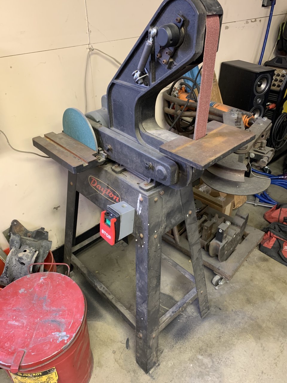

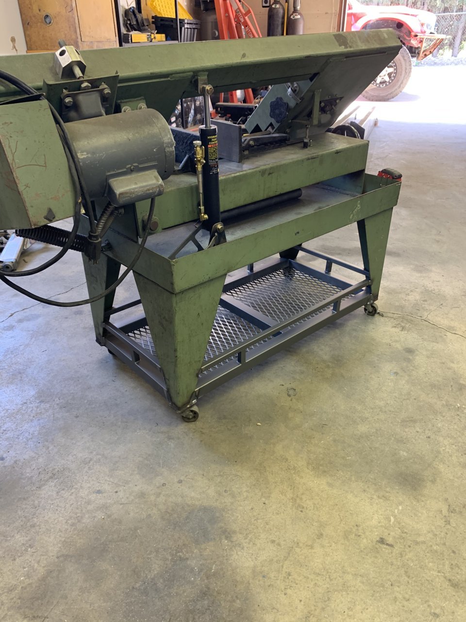

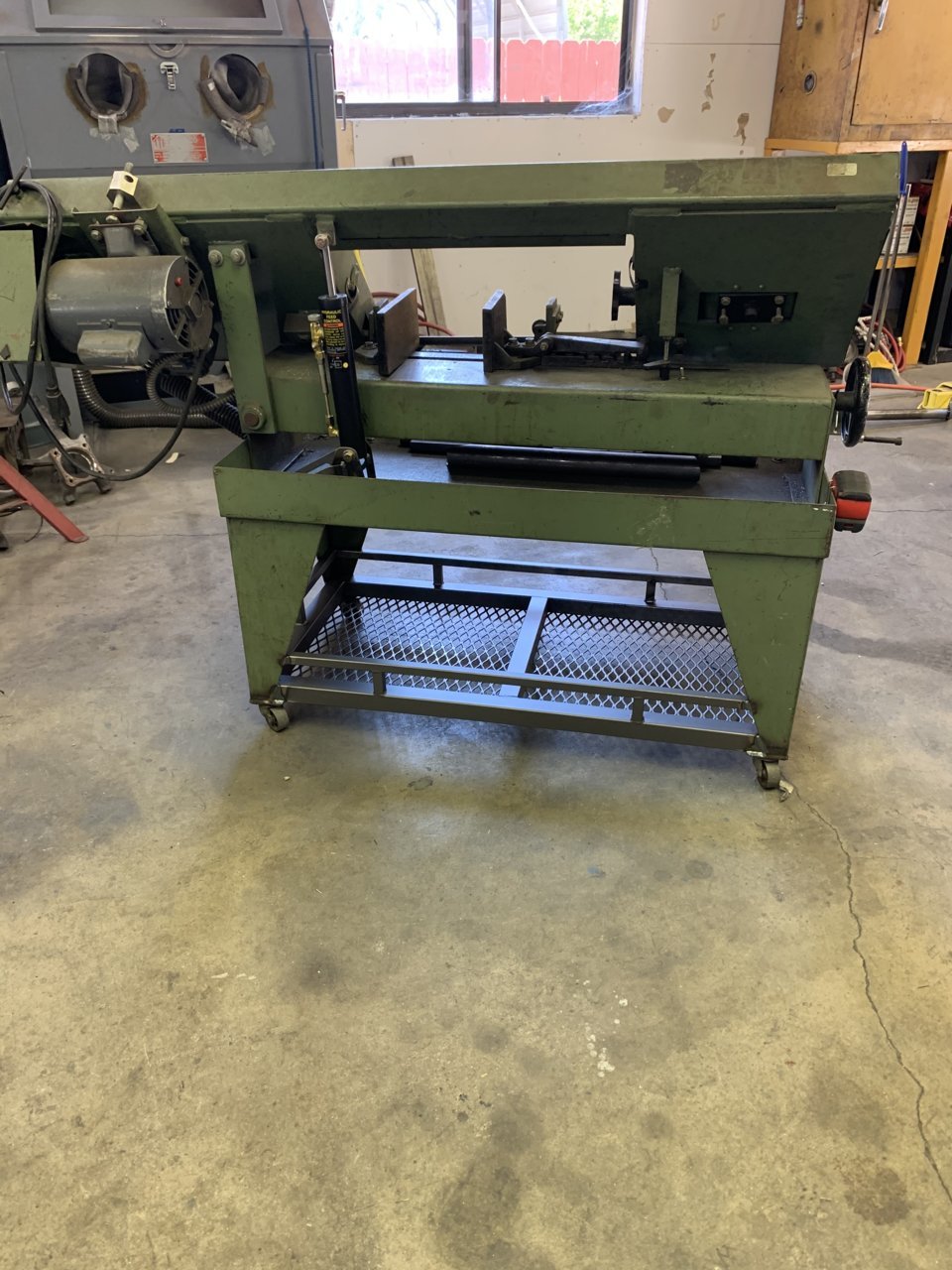

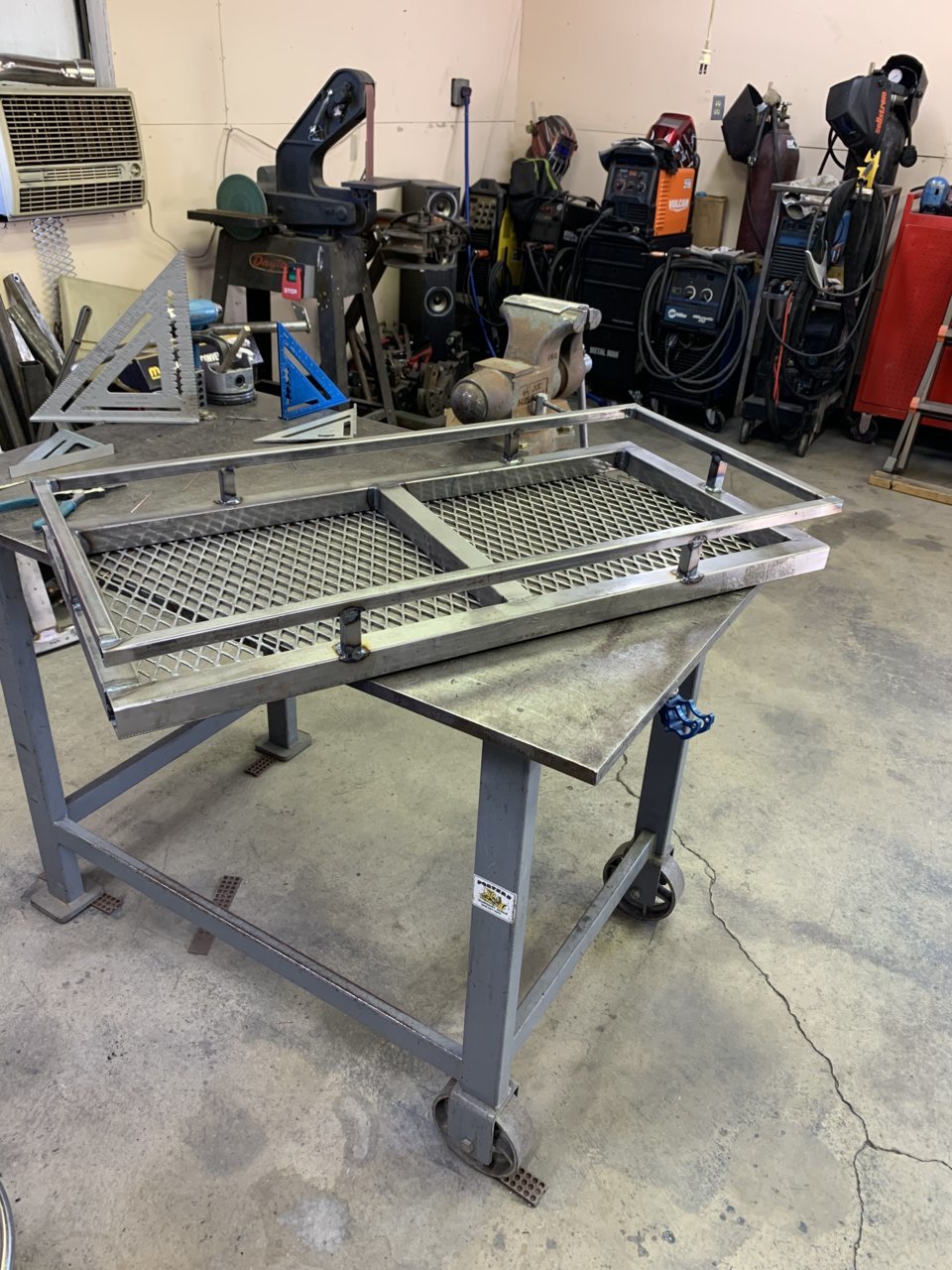

    Added a basket to the bandsaw. Needed to stiffen the legs up a little.

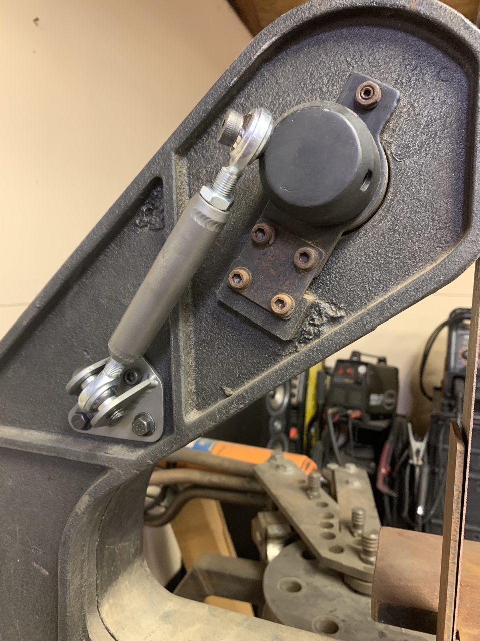

    And got this belt sander running. Bought it off Facebook for $50. It needed and on/off switch. Put a new switch in and noticed the belt tensioner wasn’t applying enough tension to the tensioner. I added the tensioner rod and now it works great.

    What hasn't been modified?
    Did you choose square tube for extra strength? Vs bending round tube?
    I’ve got extra scrap of square, but can bend round also

    I chose it because I don’t have the capability to bend round. All things equal I would likely go round tube, with the gussets. But I would have holes cut out and dimple died because it looks cool.

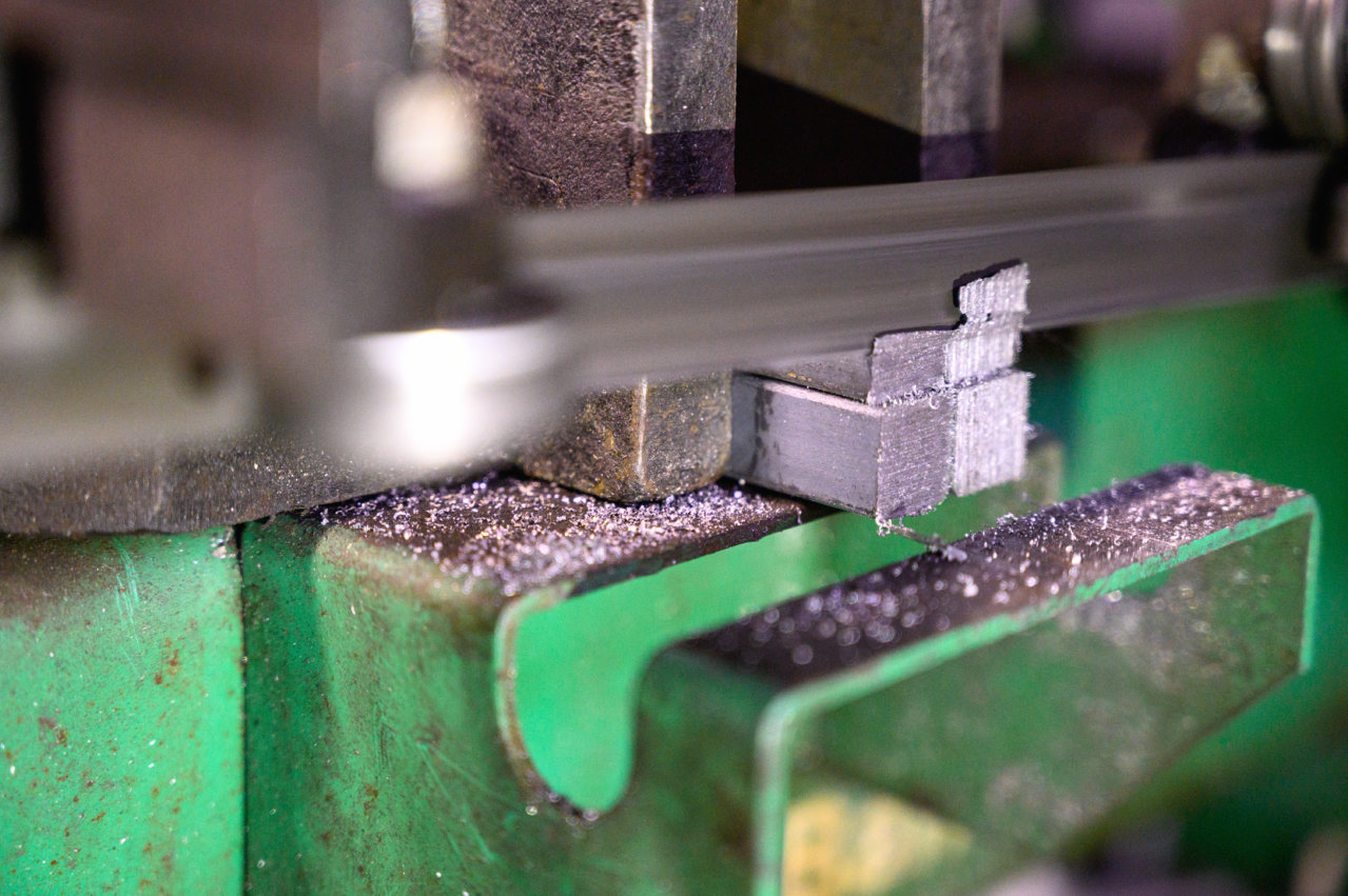

    I have the same bandsaw. Got it for cheap years ago.... It can be a fickle bastard but it cuts well!715FB3E2-02C5-4BD6-B455-9957484D9332.jpg

    Same here. I jumped the gun when I bought it. It’s definitely got its quirks, but it cuts super straight, so I decided to invest a little time into it. I added a new hydraulic downfeed cylinder a few months ago. Hopefully in the next few months I’ll have the time to reinforce a few more things on it.

    I absolutely need to change mine. It’s the biggest issue with the saw but I work through it.

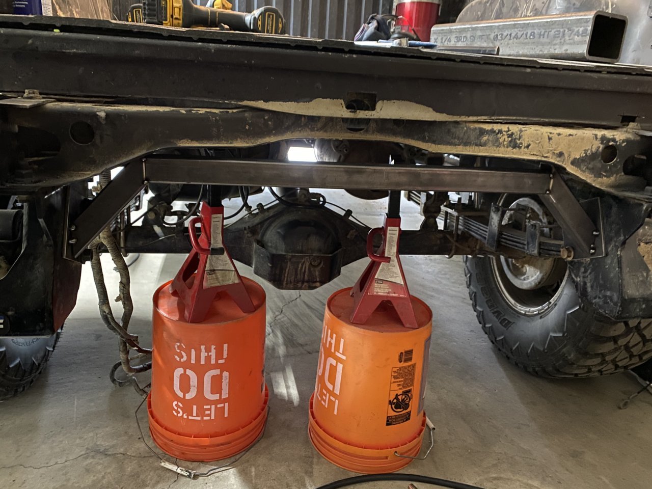

    We know for the most only a few pounds is being supported .
    Here I will put these plastic buckets under the axle to swap the tires.
    Some people get in enough trouble without help !!
