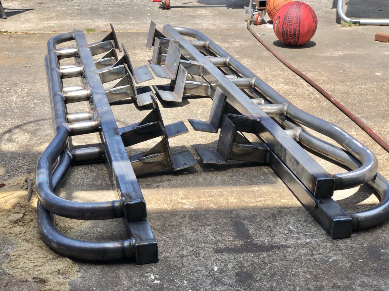

    Couple sets of sliders done today. I’m tired

    What size angle iron do you use for the frame mounting plates?
    That looks like a good way to to a bolt on slider that could easily be converted to weld on.

    5x3 x1/4”
    definitely! I’ve had multiple people go bolt on and then want weld on later and it’s a very easy conversion.

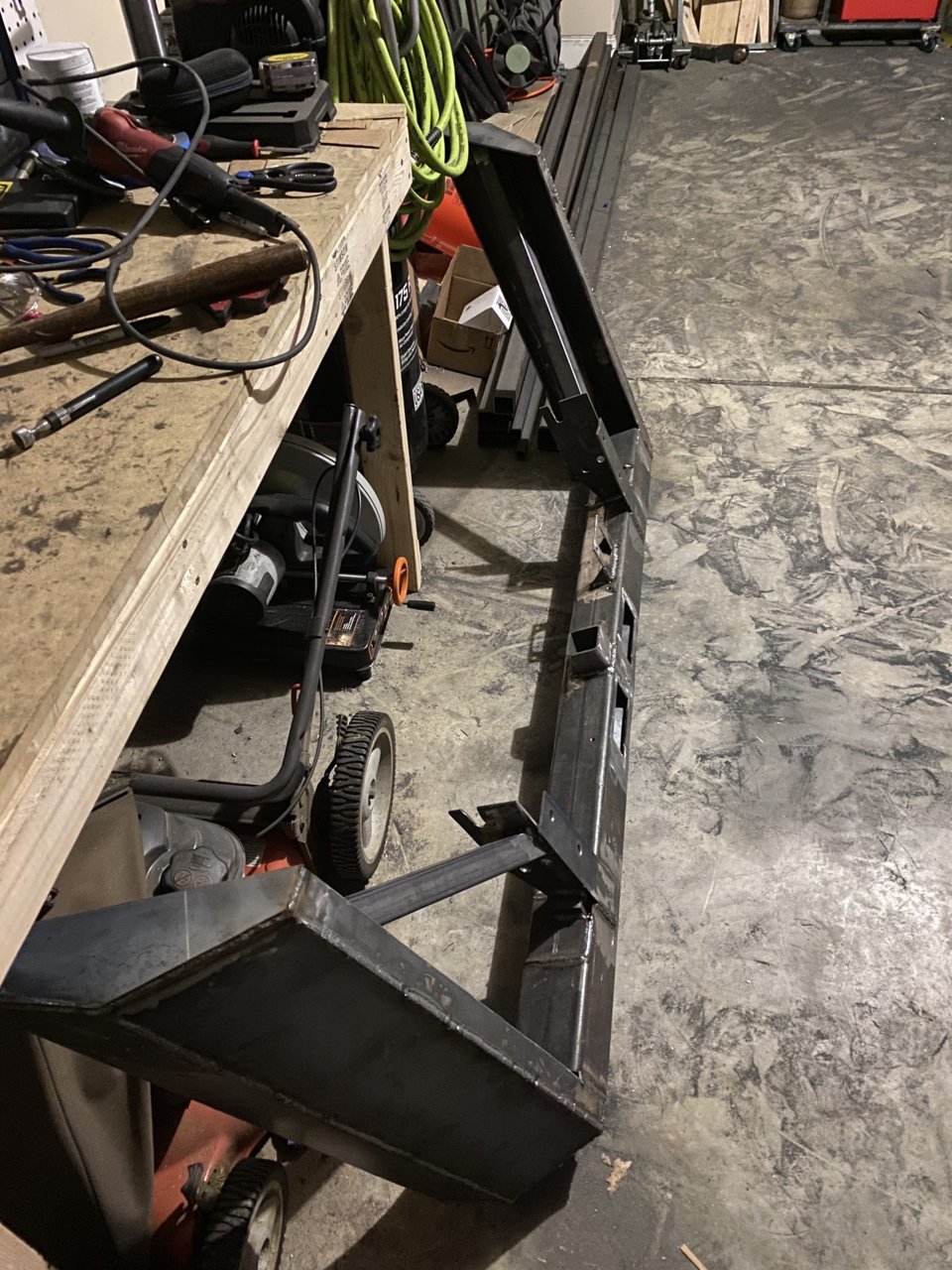

    I can only guess you do lots more grinding then I do.
    Then maybe your in a Much smaller area so the fumes and dirt hang in the air .

    Judging by the dust on the floor it looks like you've already done quite a bit of grinding! hahaha Looks great though!

    thanks! That is all dust from about 10 cutoff wheels. Figured I’d just leave it there and clean everything once this is all done.

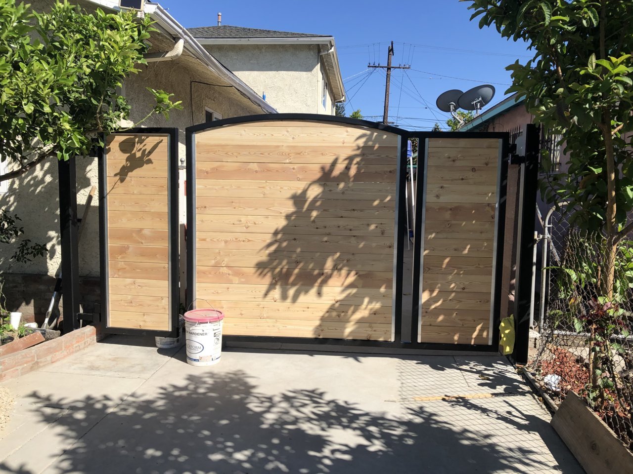

    I’m just a hobby welder but it be nice to have a welding table. Came up with a on demand table which is pretty legit.
    Welded up some trusses for a shed. Don’t know if it’s a bright idea to be welding directly to galvanize but it holds for what I need it for. Use the same concept for a gate too and it stayed nice and level after cool down.

    That gate looks awesome! Good job

    What's the size of the square tube support posts? 4X4 or 6X6?

    4x4 0.25 wall thickness

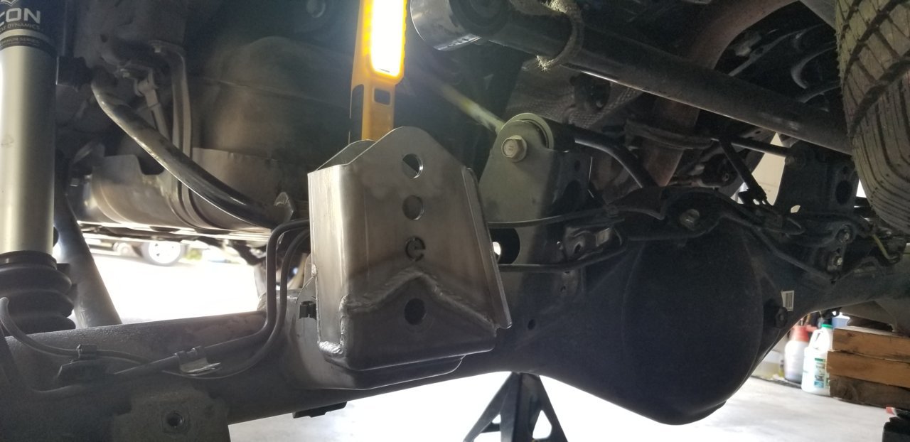

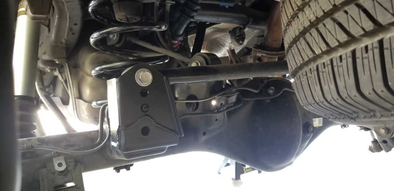

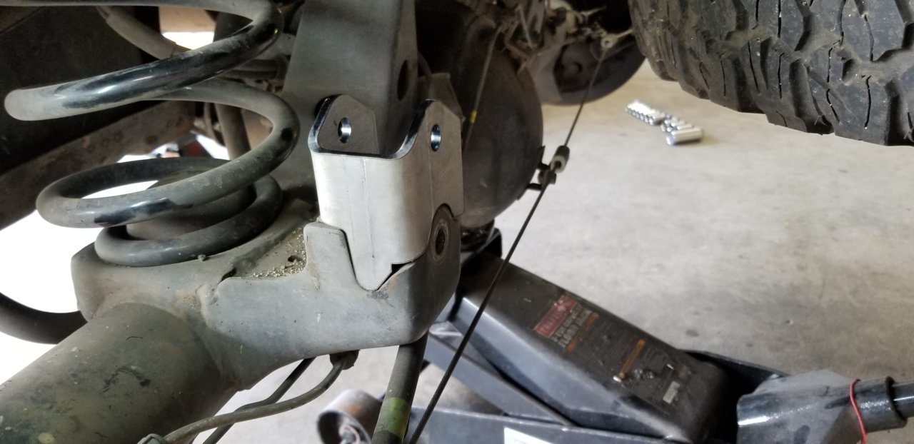

    I welded up a few of these panhard mounts on a couple 4runners. I beveled all of the edges and burned em in. And a cab mount chop.
