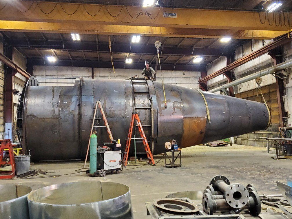

    What is it?
    i like the little miller

    Its a cyclone for industrial dust collection. They're used in a lot of industries, but most of the ones we make are used in saw mills.

    Surprisingly thats what I thought it was. Always interesting how different areas (and industries) do things.

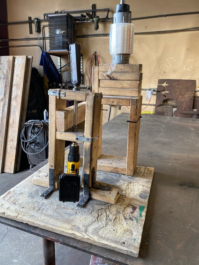

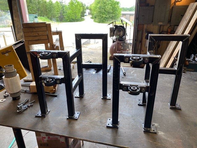

    My buddy at powdercoat had us make this prototype out of wood a couple years ago as a test. He wanted to see if it worked then he was going to have us make two. They’ve added to it and fixed and repaired. He brought it to me today at lunch and ask for 2 by Monday afternoon. Check. He said they’ve ran approximately 3 million parts through this one. They put 5 parts in it and wrap them. I need about an hour in the lathe and I’ll be done with them.

    Whats the little miller machine? so cute lookin lol

    Just the wire feeder hooked up to the Hobart, it's a Frankenstein machine, lol.

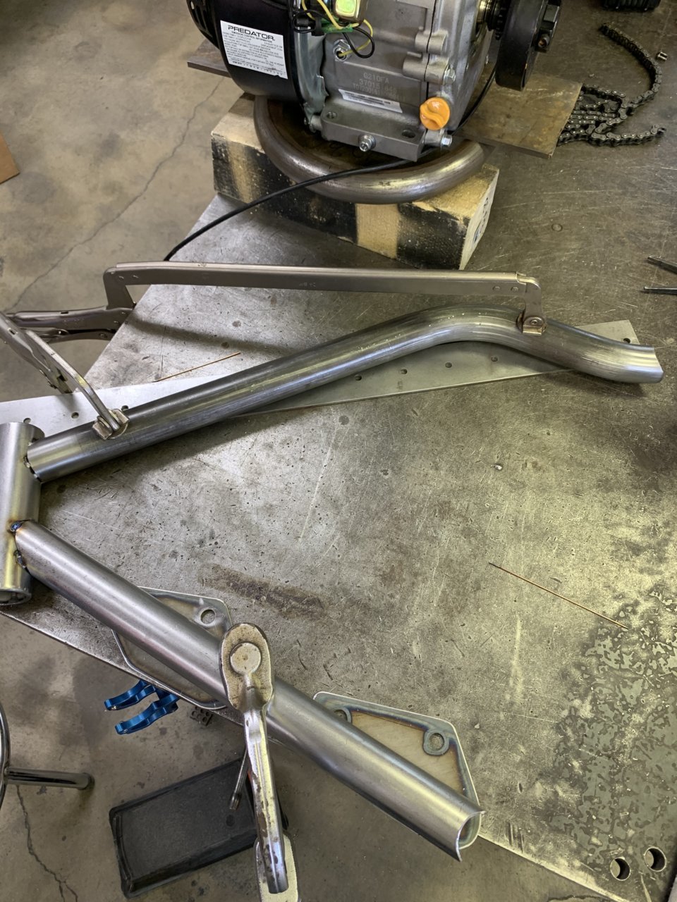

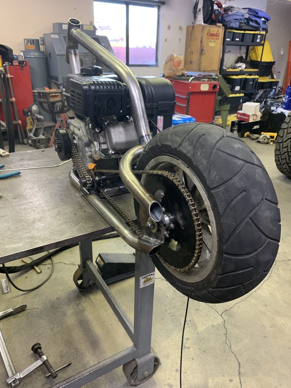

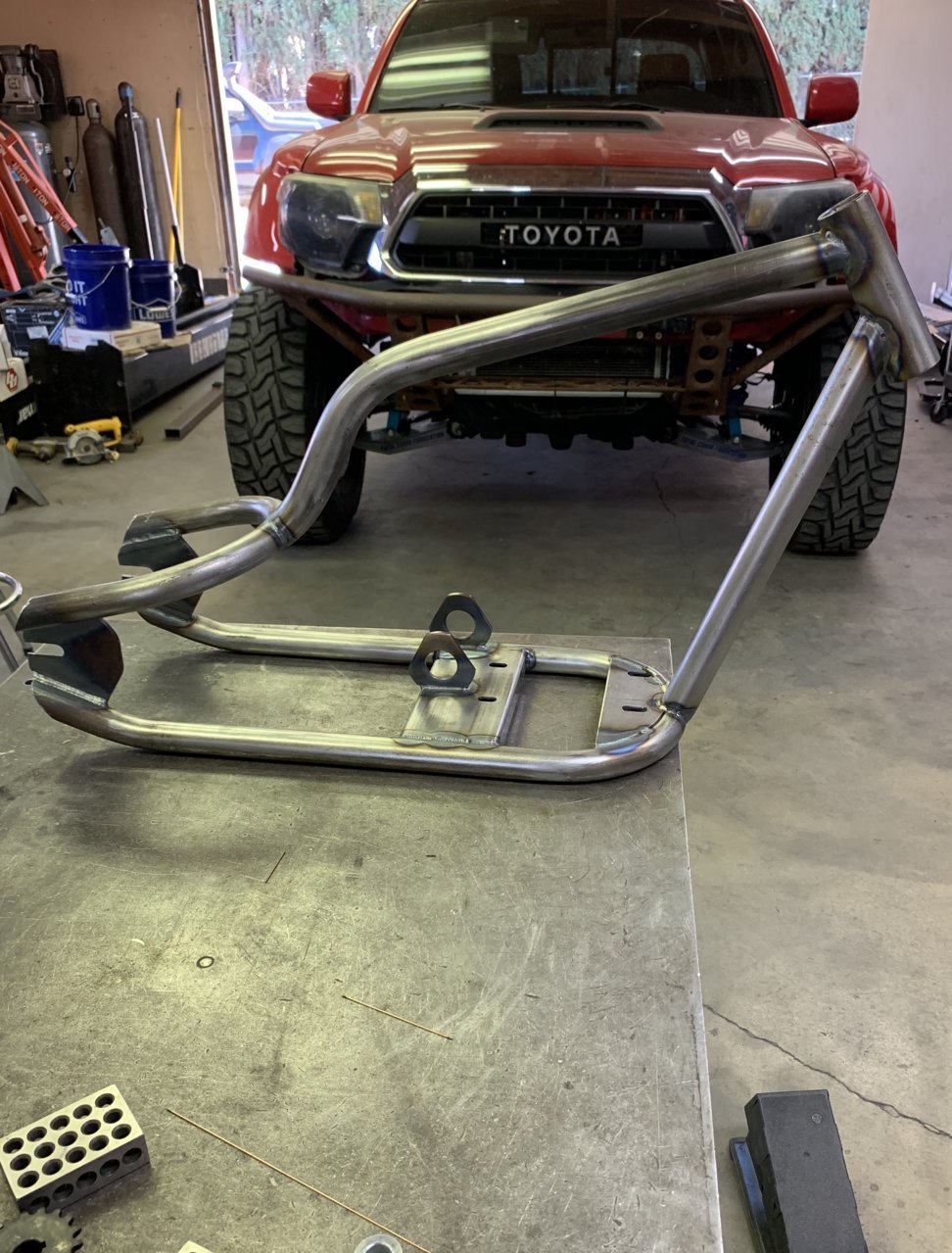

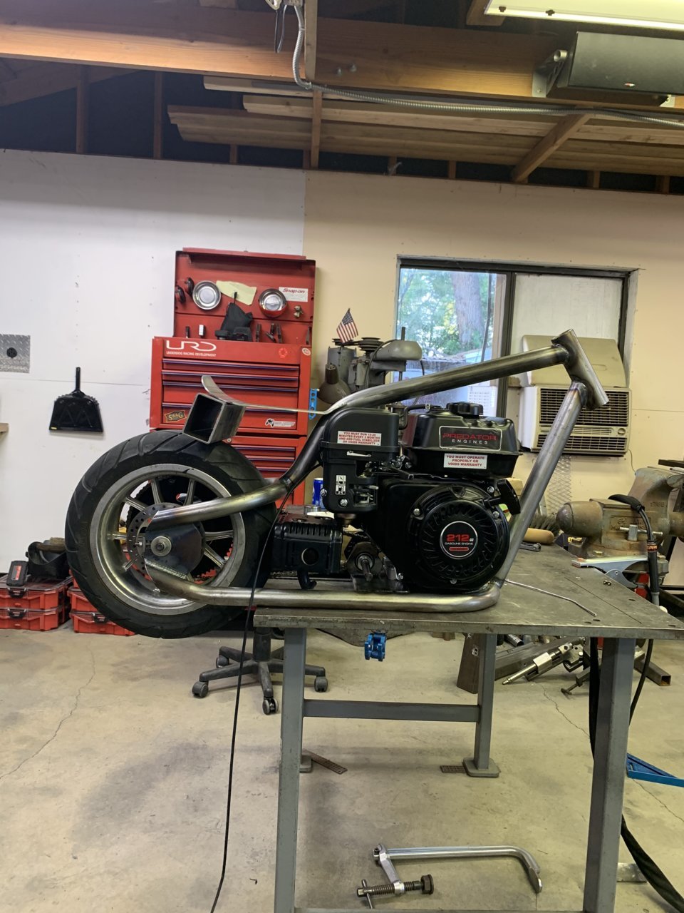

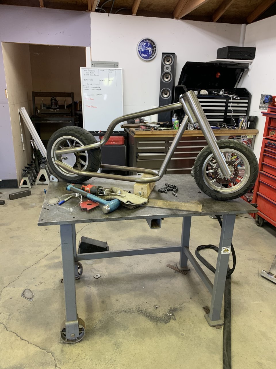

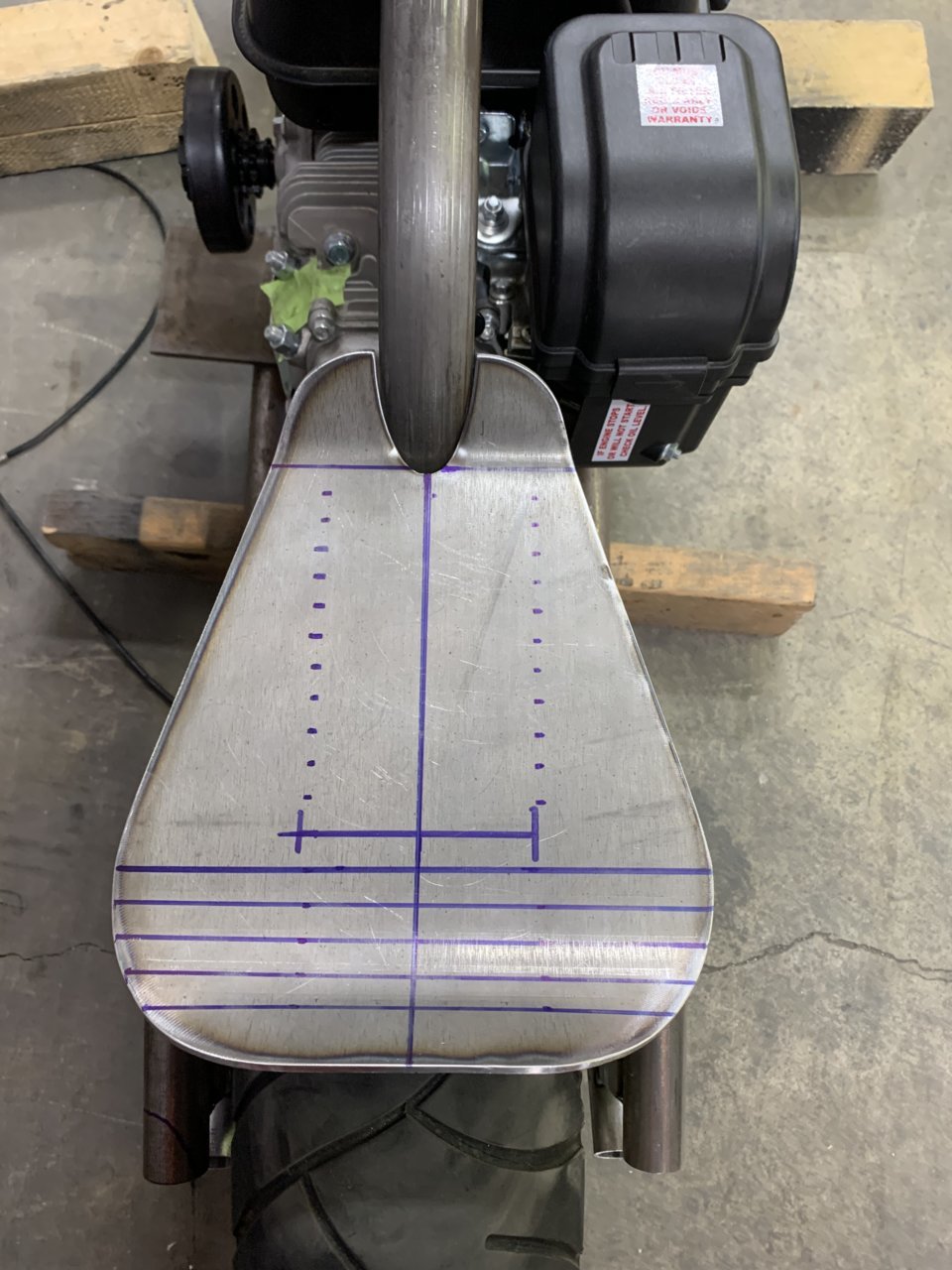

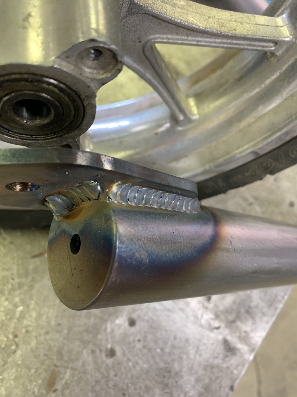

    Still working on the mini bike in between jobs. Got the frame and forks welded up today. I still have a few details to tidy up before paint but for now I’m gonna assemble everything, build handle bars, foot pegs, weld the seat on, and ride it around.

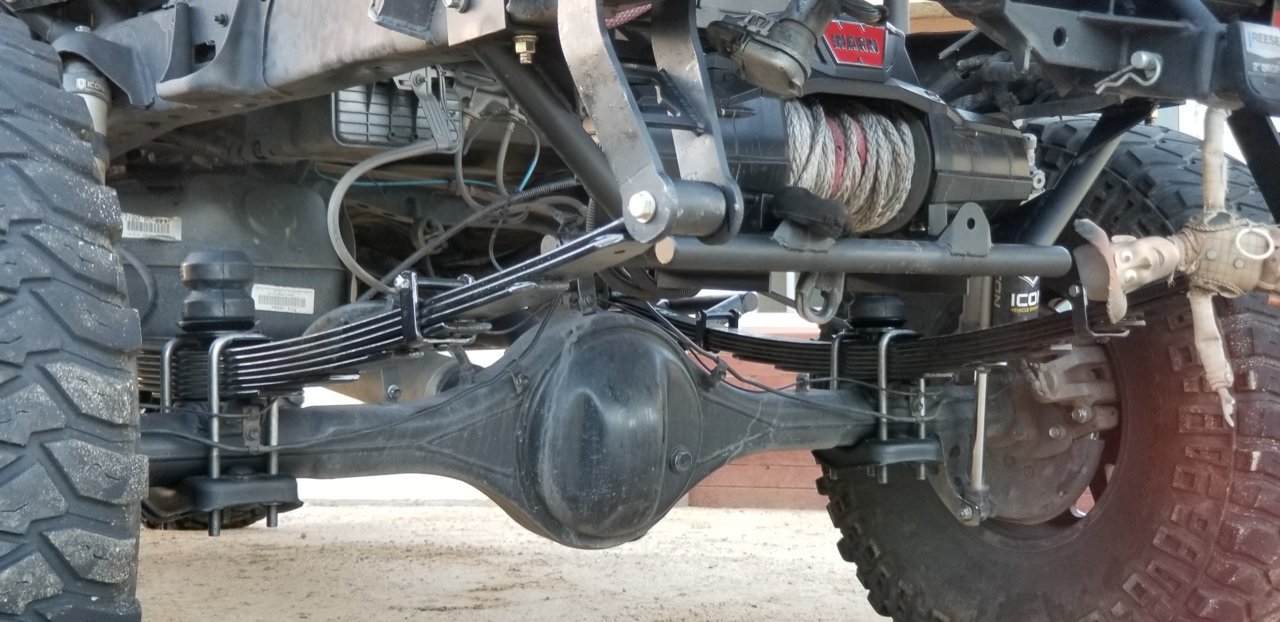

    Got it. Thanks, guys. I'm going to be welding on new lower shock mounts, some limit strap mounts, a bump stop strike pad, and maybe a simple crossover truss. What I have now..

    One thing I learned the hard way is that, depending on your rear set up, the two limit strap mounts can contact each other at full stuff. I had to tweak mine. They’re not directly in line with each other now.

    run an adjustable clevis on one side of the limit strap mounting point... new straps stretch
    if you’re welding on new lower shock mounts try to make the leafs limit downtravel.. then no need for a strap

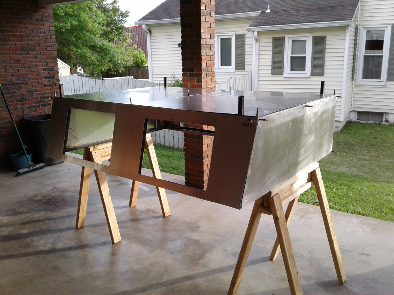

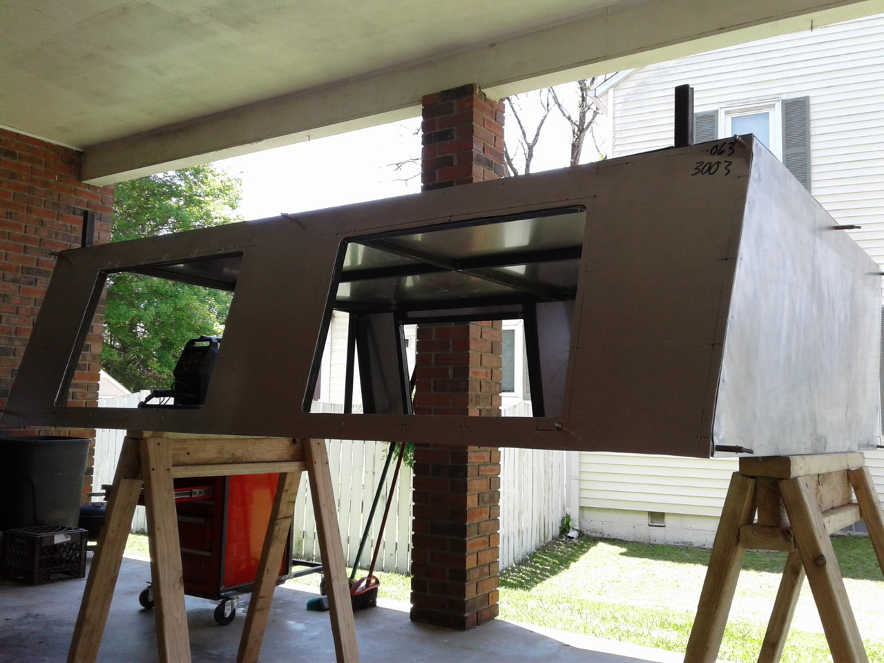

    On a happy note, my camper is dried in.
