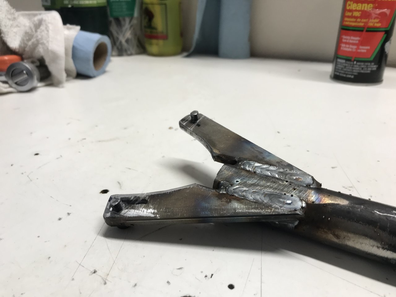

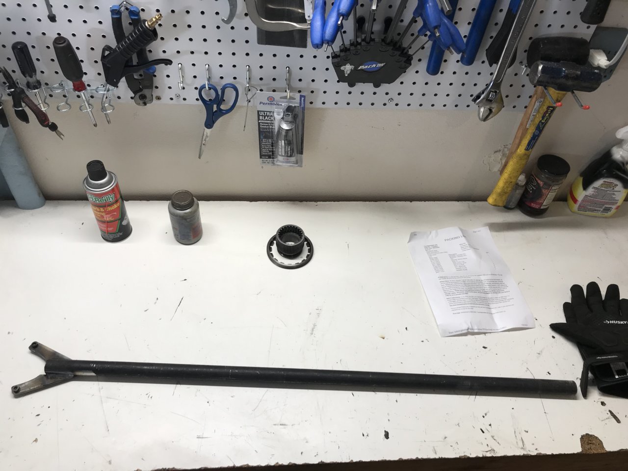

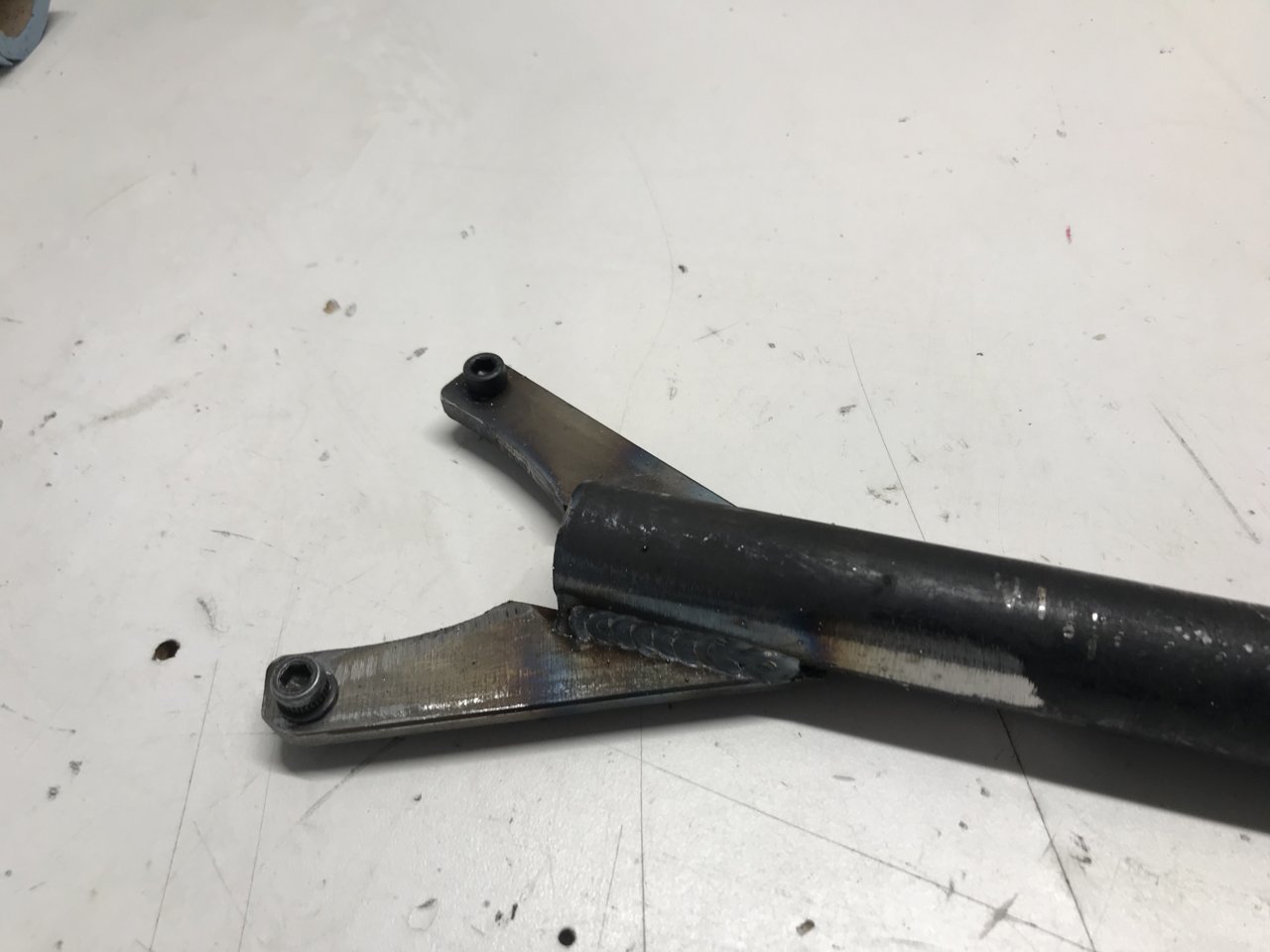

    Made a big ass wrench
    deeezy, 95 taco, Shmellmopwho and 5 others like this.

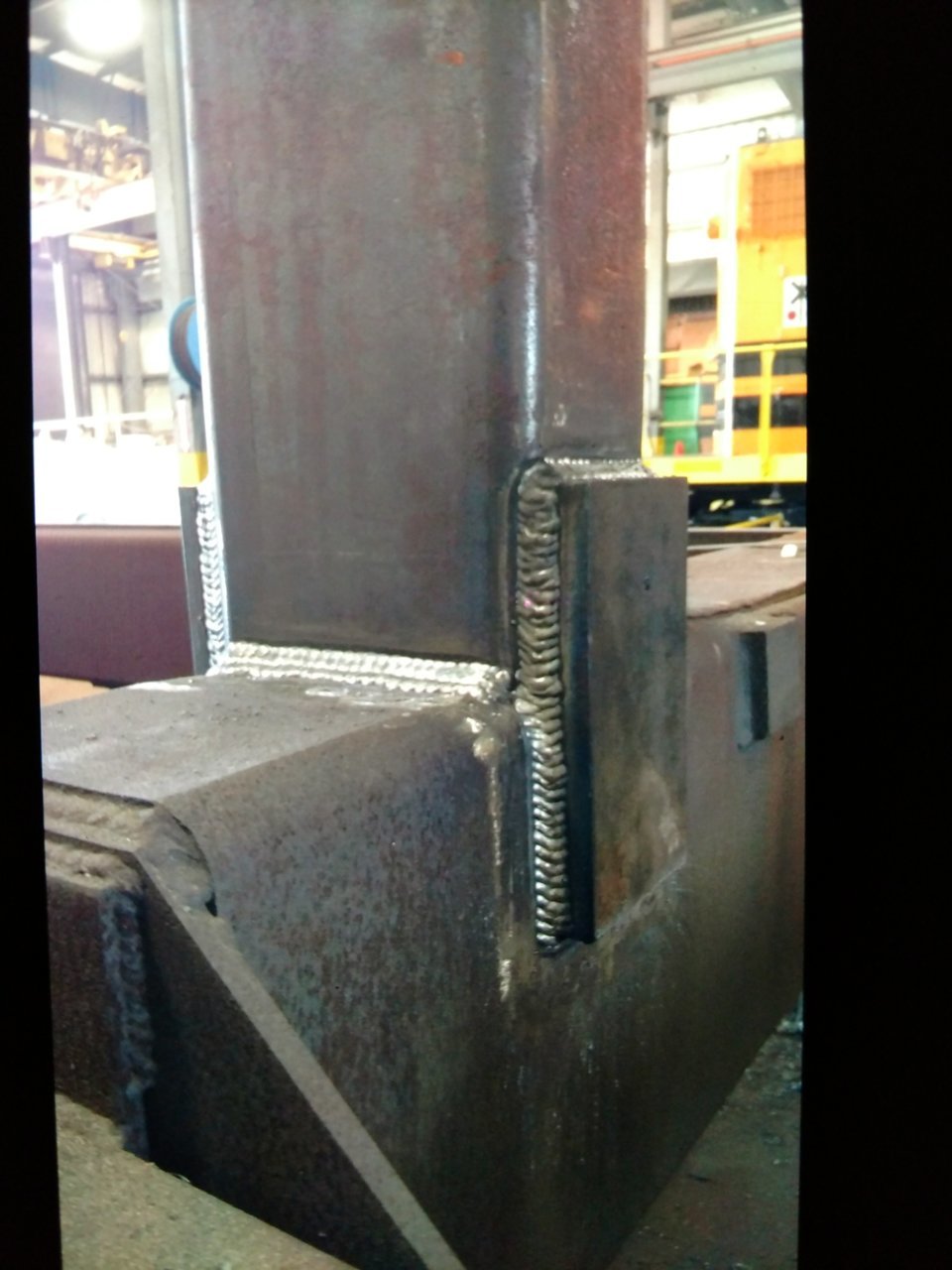

    Some welding from work

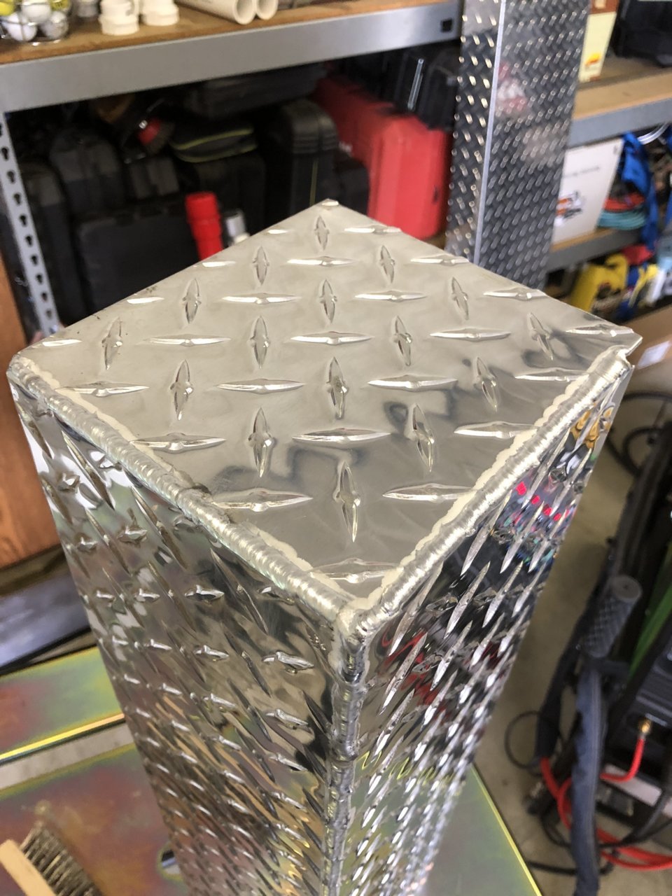

    Some aluminum tig welding I started to do
    95 taco, jubei, six5crèéd and 5 others like this.
