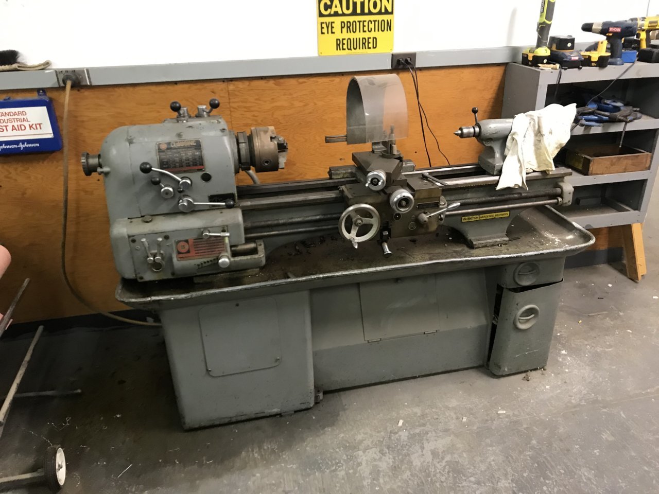

    Is that a Clausing? My son has a sweet Clausing Mill in his shop.

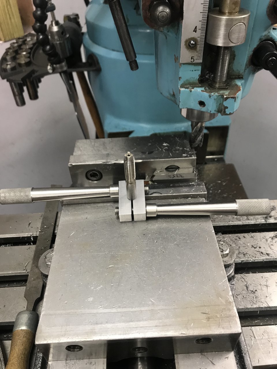

    this is the best I have so far. A copy of This Old Tony’s tap handle. I’ve tweaked it a little since this pic, and it works pretty well.

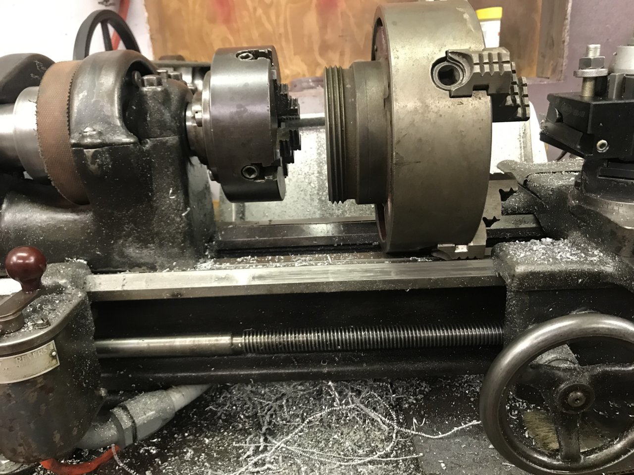

    says clausing/colchester on the tag. So yes? My best guess is a master mk.1.5 4C343B15-EC46-45FD-8EAA-A3519A5EA778.jpgFor reference here’s the 4 jaw that comes with it on the bed of my South Bend 8”

    So cool. I was just lamenting the sad state of my little lathe today. Slowly trying to clean it back up, re-tool it.
