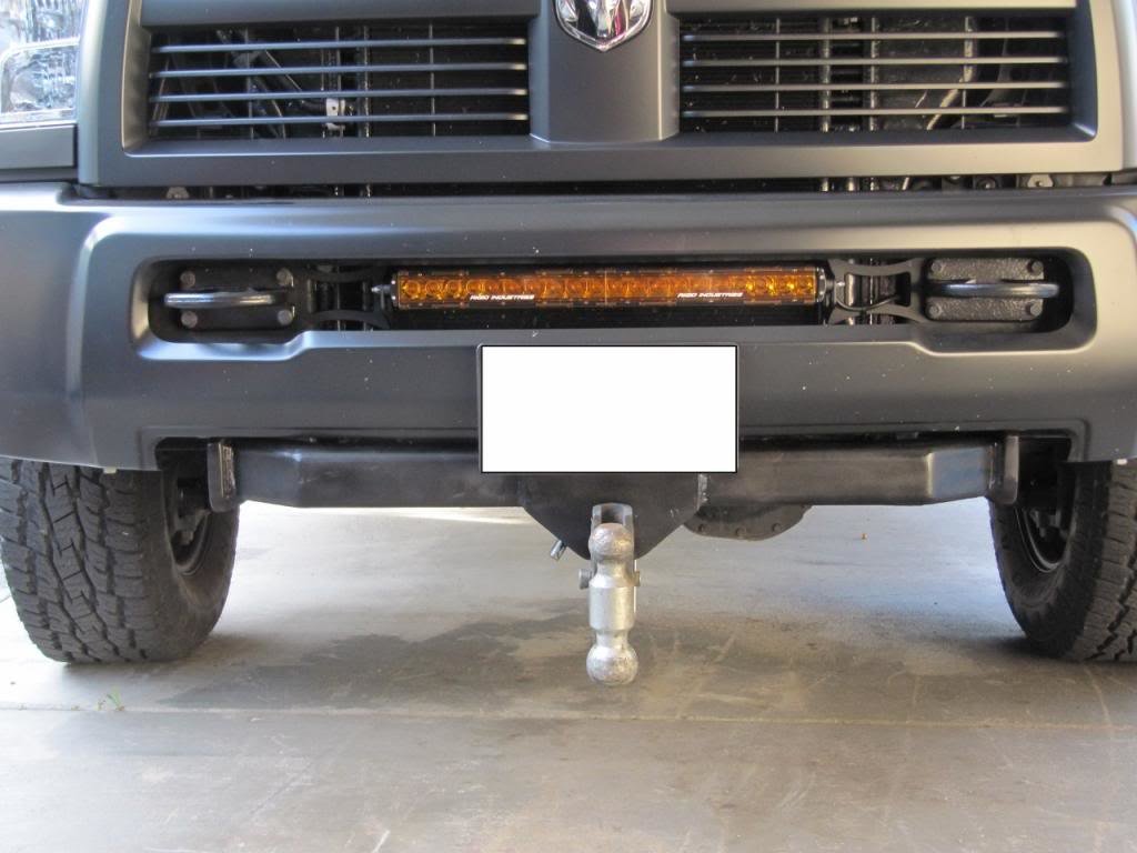

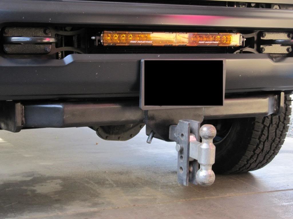

    So here is what I finished making for the front of our Dodge 2500 to maneuver our trailer in tighter areas during fair time. Also to mount a portable winch on the front end for recovery.
    Side plates our out of 3/4" plate. The box tubing is 3"x3"x 1/4" wall tubing. The front plate gusset is out of 3/8" plate. IT is bolted to the main front frame with 11/16" bolts 2 on each side.

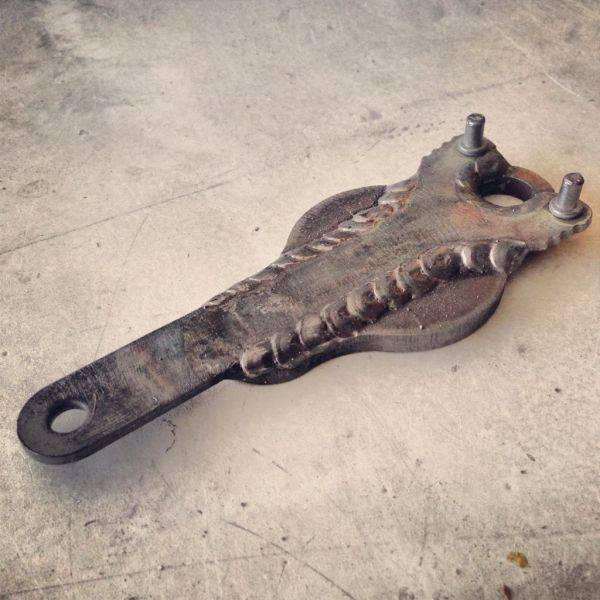

    Had to reinforce my angle grinder tool as the fingers would bend before it loosened the nut. Overkill, sure. But it worked!

    Lol That Certainly Is Overkill.
    I hardly Even Use Those, Never Had A problem tightening By hand. What Grinder You Using?

    I usually do it by hand too but the flap disc caught an edge and got super duper tight like a tiger.
