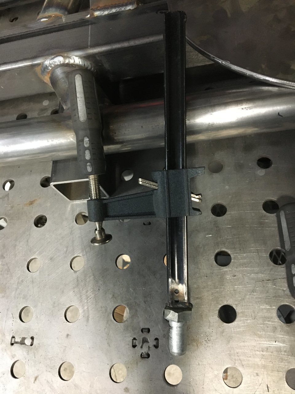

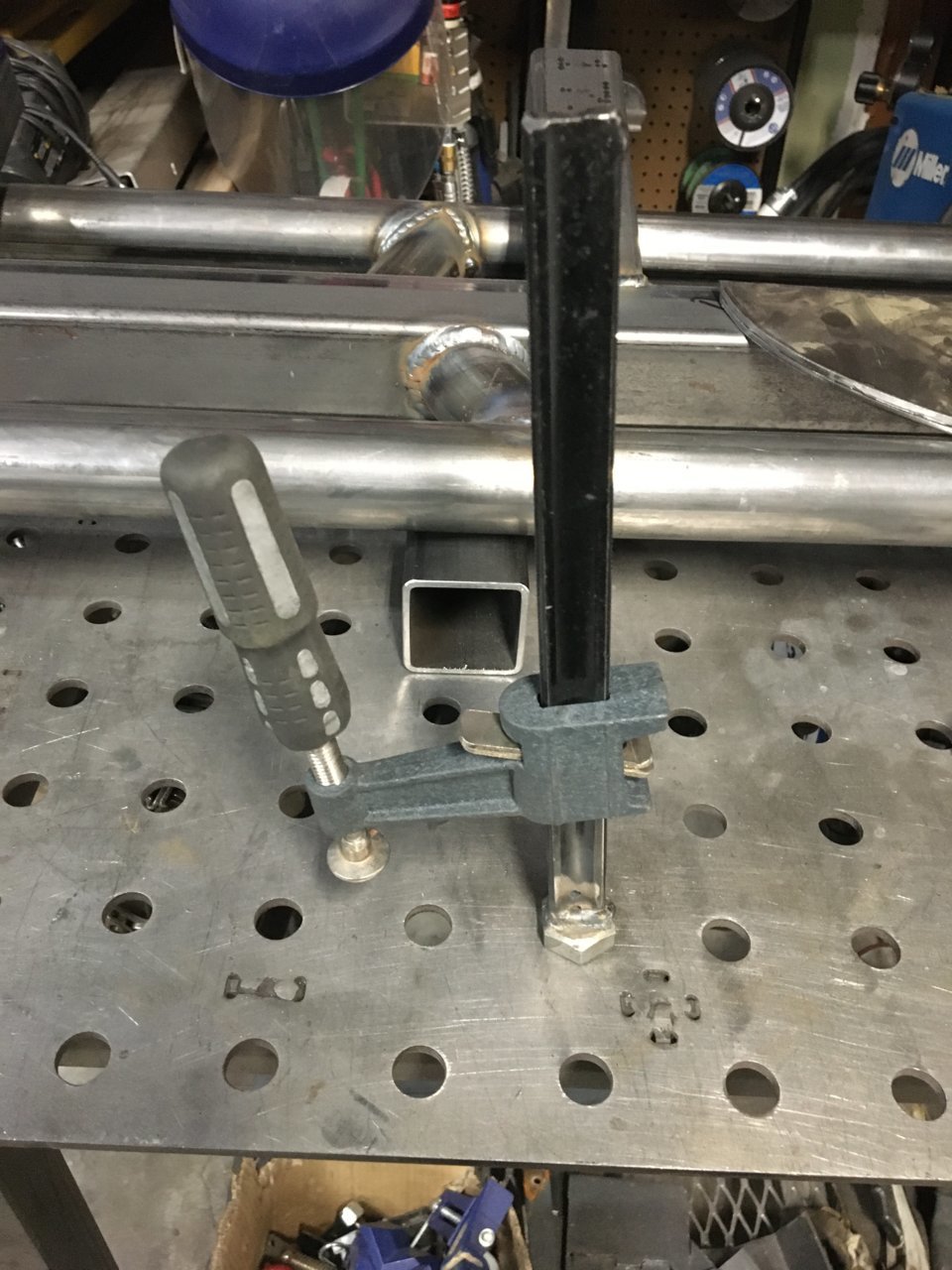

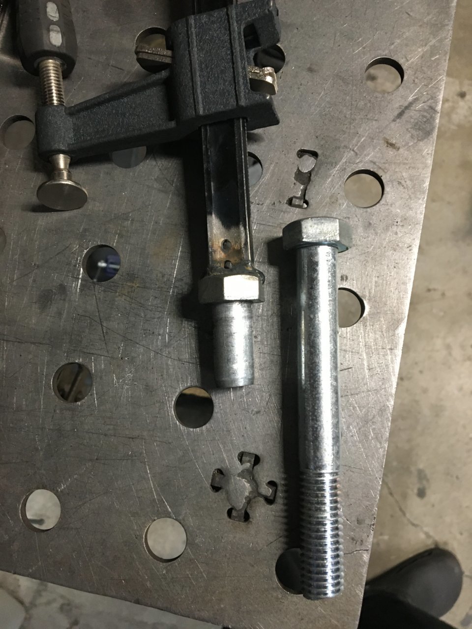

    My clamps start as these from HF: You just cut off the fixed end and prep it for welding. Here you can see the finished clamp.
    I also made these for clamping round tube. Just a 1” piece of angle iron welded on and the head still rotates and pivots.
    And a few of these “long reach” clamps for random jobs.
    I probably have about $5 per clamp.
    I originally saw this YouTube video that have me the idea:
    https://youtu.be/NP2wWQG1vlI

    That is cool. I will have to get the boss man to grab some clamps and we can borrow one of our friends mag base drills and I can drill some holes in our welding table. It's 1/2" thick. Thanks for sharing :thumbsup:

    The strong hands clamps are cool but paying that much for them makes it hard to buy a bunch at once. Honestly the clamps are great but I’ve rarely found myself welding something that only uses one or two clamps. I’m usually using several at a time and that’s what makes them useful especially for odds shapes or projects with a lot of angles that you don’t want moving on you as you weld. Making these cheap clamps I can keep a dozen of them around and use as many as I need.

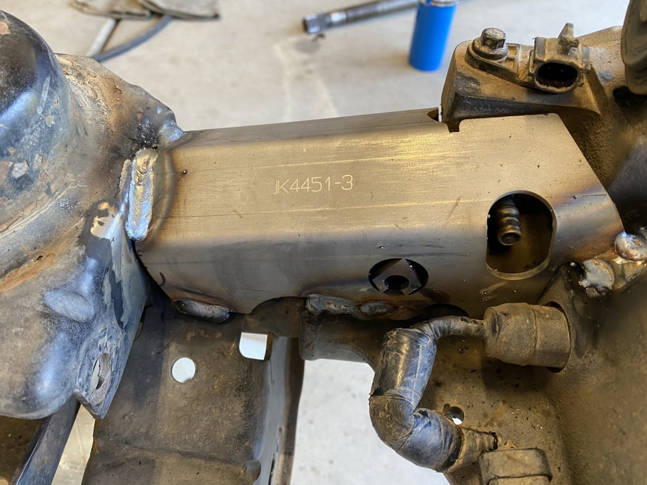

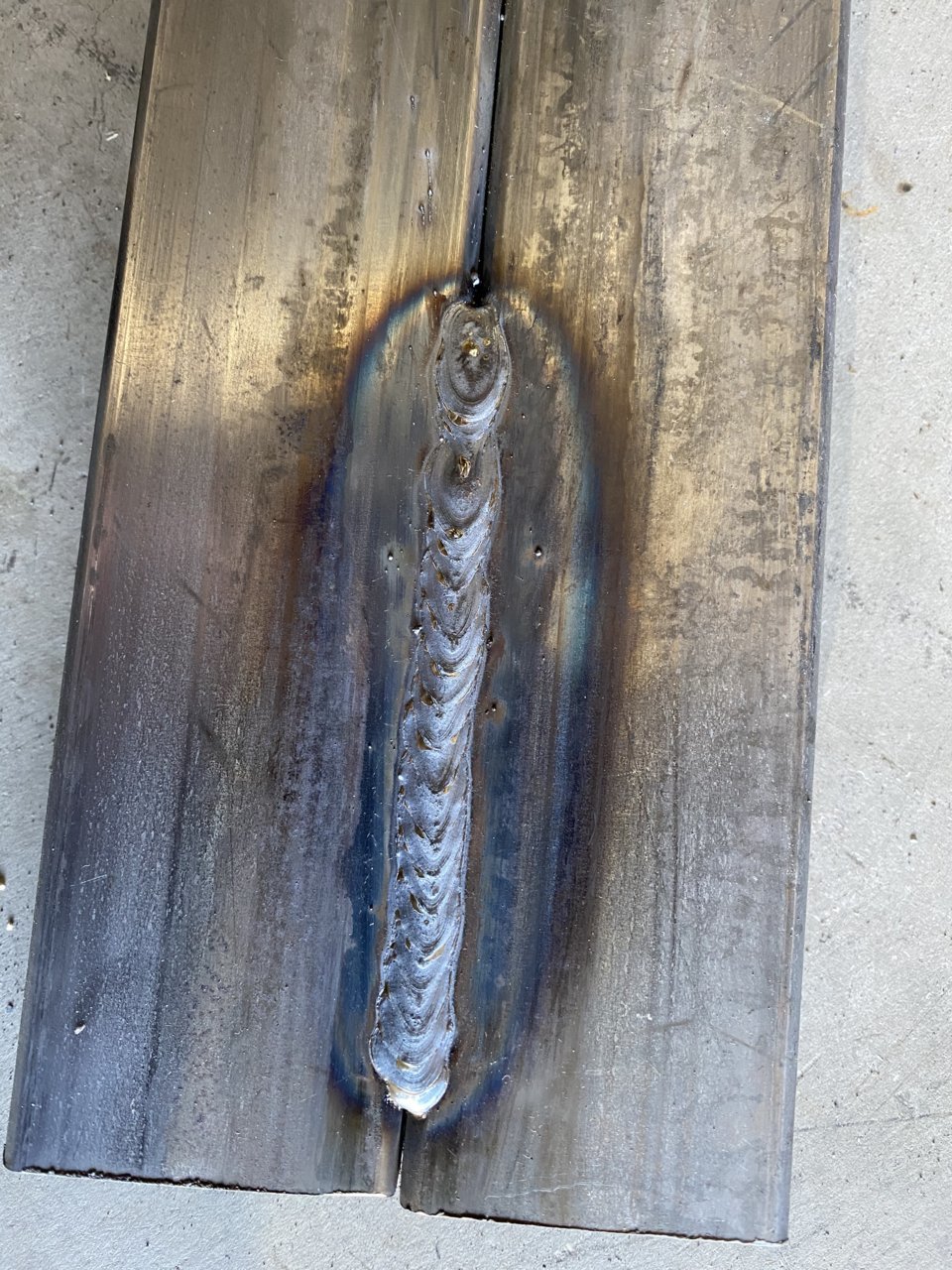

    Ran a couple practice welds since it’s been a while since I’ve ran a bead and to keep myself humble... the first practice was on round tube (1.75x.125 hrew), second was on 1/8” square stock.
    If I do this well on my axle I’d be happy.

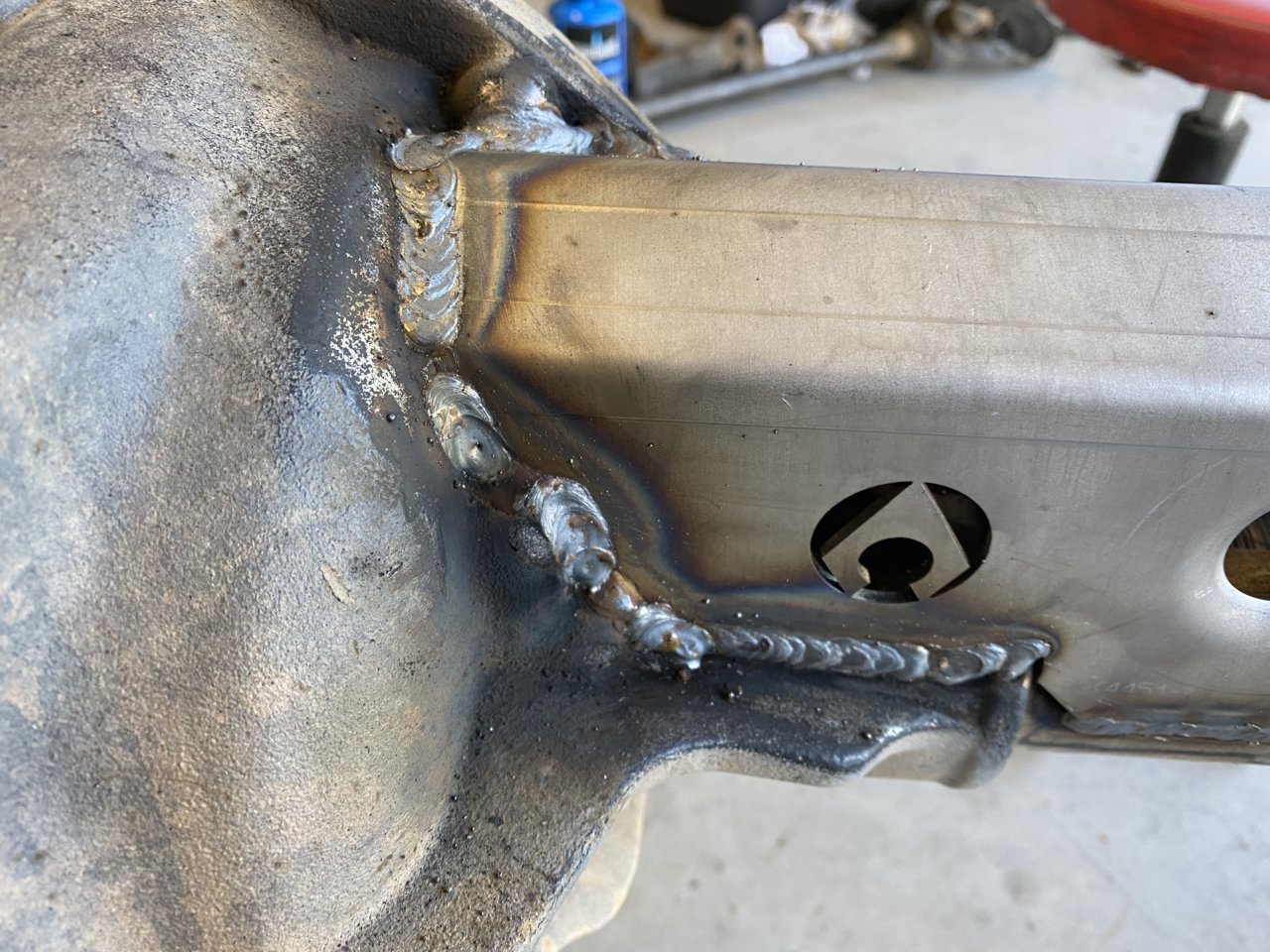

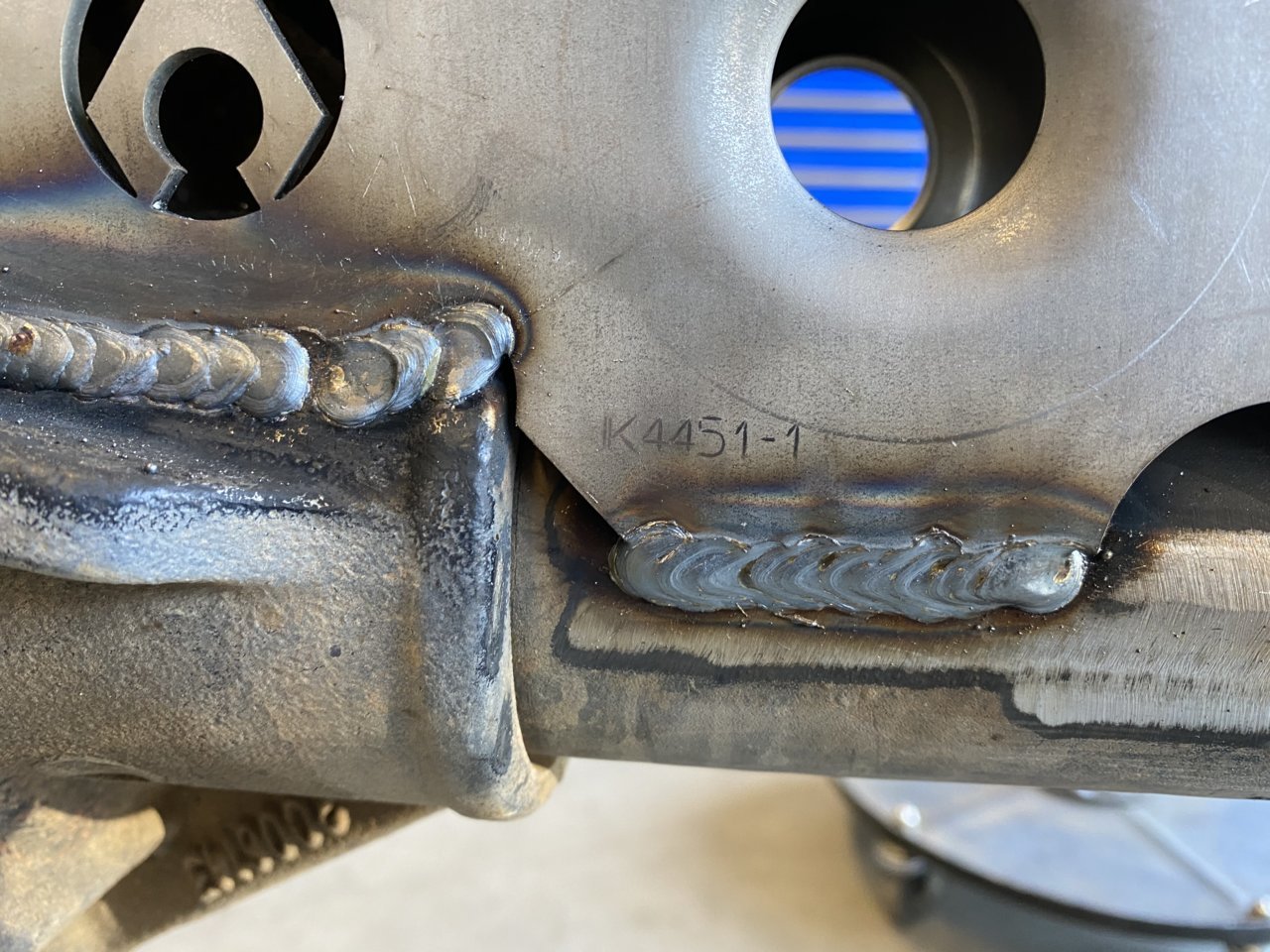

    Got everything welded up. In hind sight, I may have done this a bit too fast... oh well, at this point it either works or it doesn’t. I don’t think I got it hot enough to warp the axle, the trusses were all tacked and nothing popped while welding so the tack welds held fine. One weld is a bit boogered but hopefully it holds.
    Some areas didn’t get welded due to the proximity of the locker wires but that’s in the short side so I’m not overly worried about that one.
    The axle is snug as a bug in a rug all wrapped up in a welding blanket where it will sit for the next day.
    Tomorrow I’ll weld in the c-gussets before replacing the ball joints.
