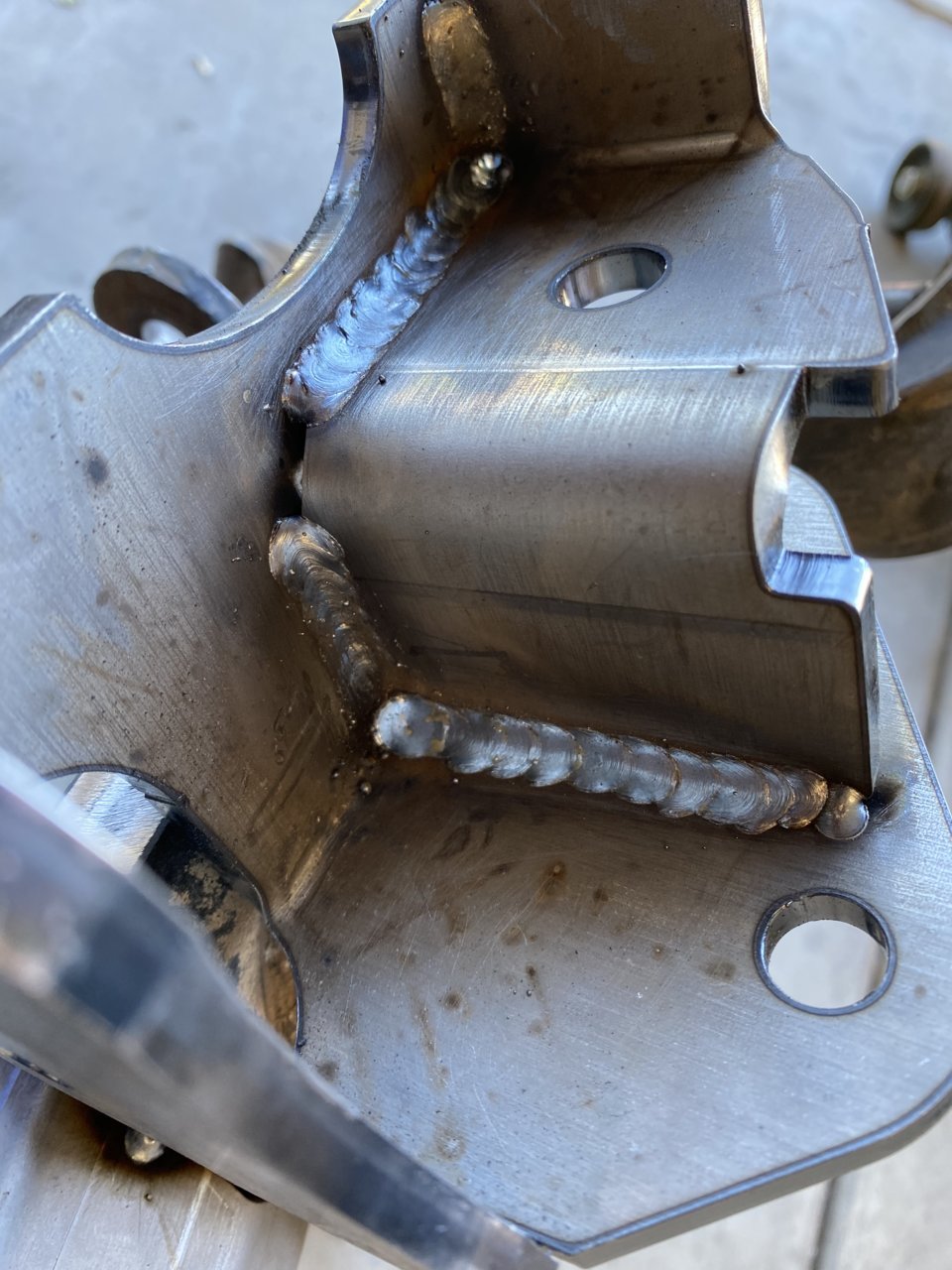

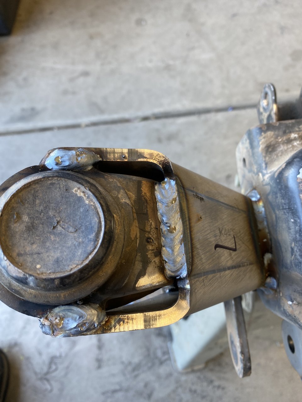

    I trust that the truss welds in the axle tube is good, I’m decent at welding mild steel... decent enough anyways. But the truss to the cast may see a fair bit of stress since I’ll be running a 38” tire on this axle. I don’t wheel the Jeep easy at times and I’m this far into it, I want it to be right.

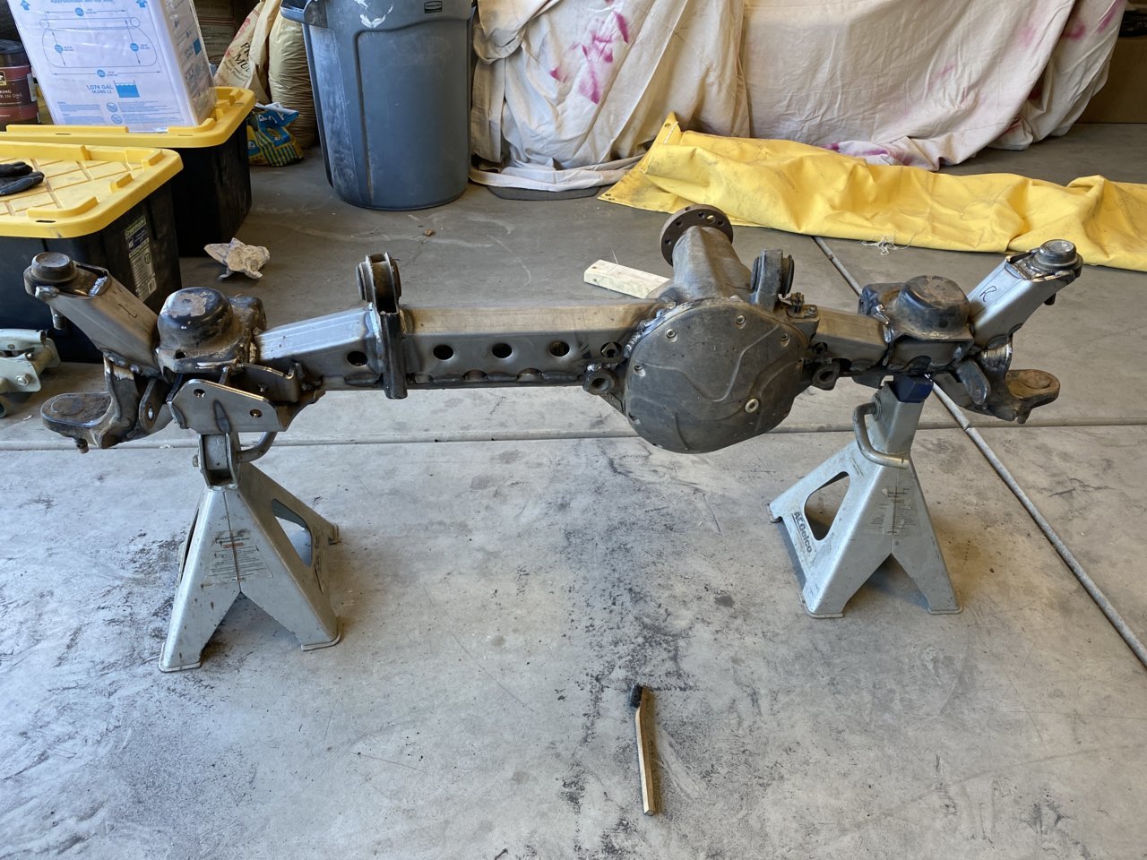

    19,763

    This pig is done... this is by far the most I have welded onto an axle before and I’m glad to say... I’m finished. Time to clean it a bit then paint.
    Most of the welds are decent but overall I feel the axle is much stronger than before and the welds will hold fine... fine enough for a newbie welder.

    What ended up being your determination on the cast welds?

    I had another friend look at them who has a lot more experience than I do. He did say they aren’t the best but they’re good enough for this. He pointed out some overlap, undercut and a little porosity on some welds but nothing that will be fatal to the overall scheme.
