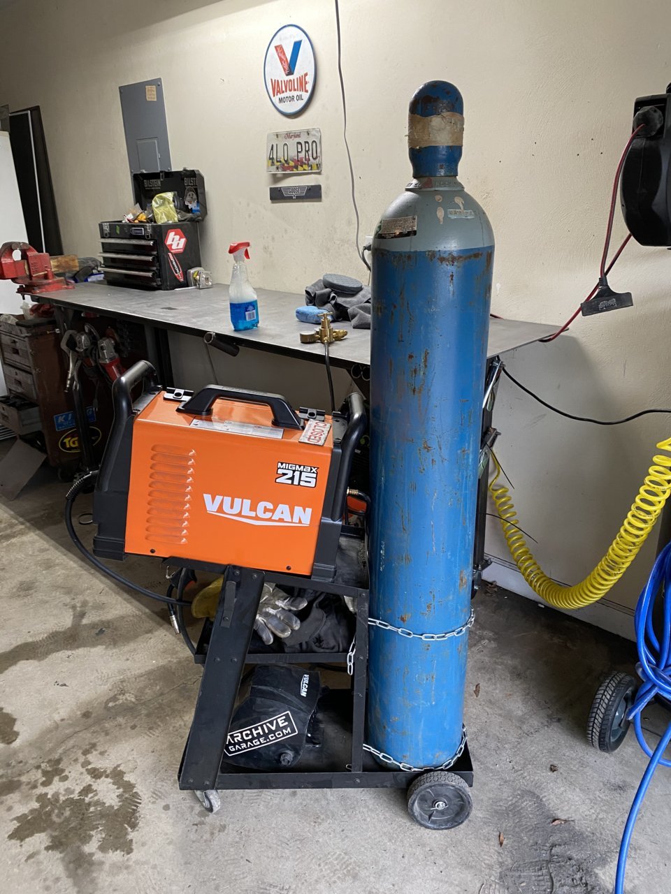

    Perfect, I see nothing wrong here.
    jk big Bertha will sit here until I build a cart.

    Man those 300 tanks are massive. I got one years ago and still haven’t had to refill it.
  17. May 30, 2020 at 4:51 PM
    EatSleepTacos
    Mar 24, 2015
    #151688
    59,835
    Randy
    West Valley, AZ
    2017 4Runner
    This ones a 390. It’s a fucking bear lol

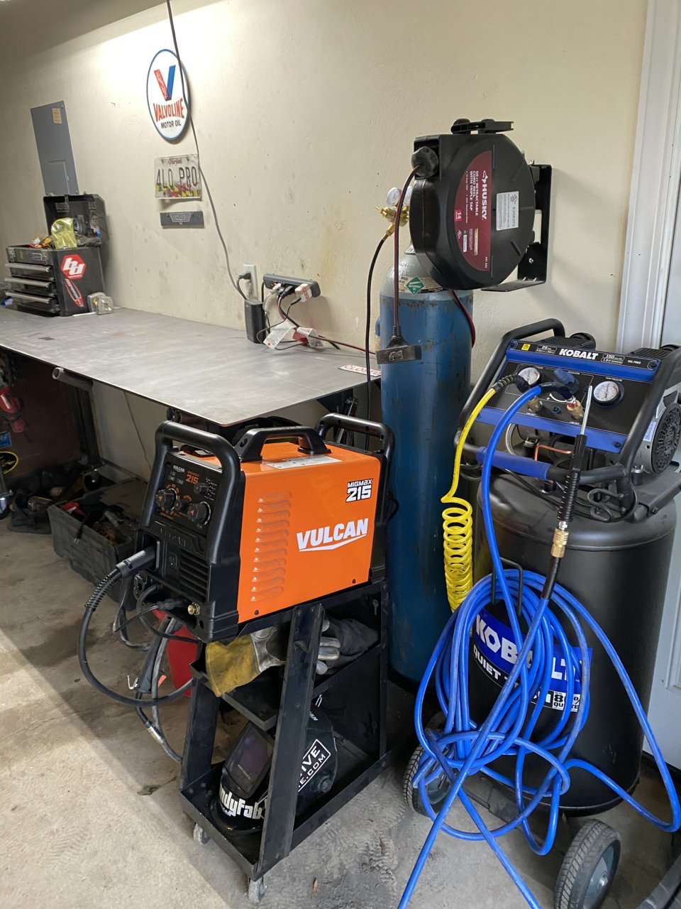

    How do you like that compressor?

    I like it a lot. It’s pretty damn quiet and like that it has two outputs and a built in regulator. So far the only air tools it can’t keep up with are my little right angle doe grinder and my da sander. It’s good for intermittent use but not long, continuous sanding.

    jeez. You’re going to have to build a 3/4 ton welding cart for that monster.
