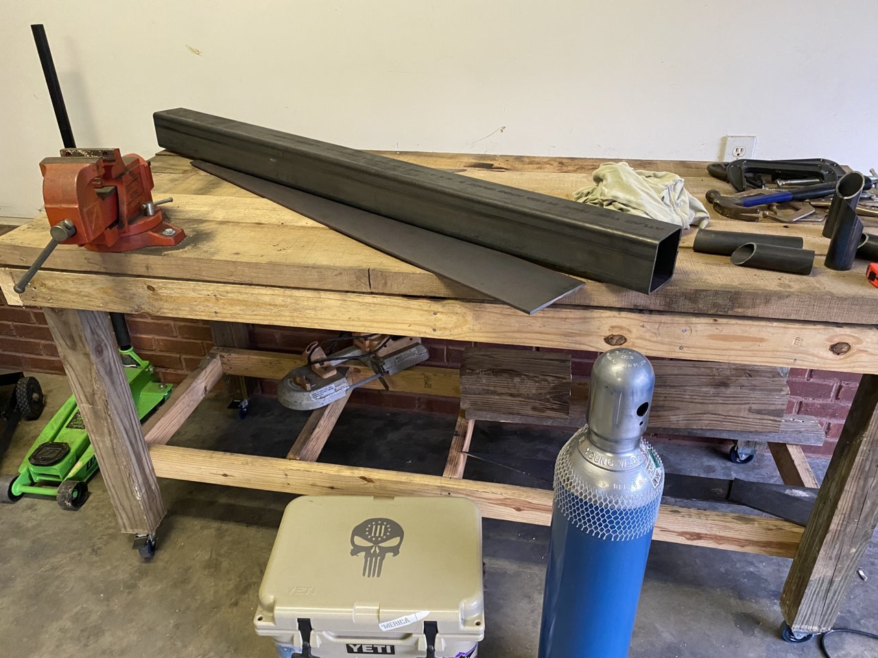

    Got a little extra steel today.... may start a rear bumper soon :help:
