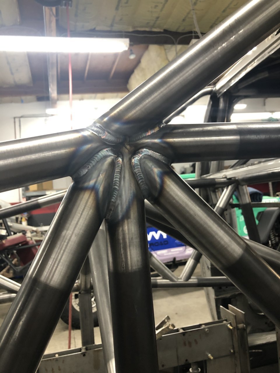

    You will be ready for a tig machine in no time... silicon bronze rod will change your life with sheet metal :)

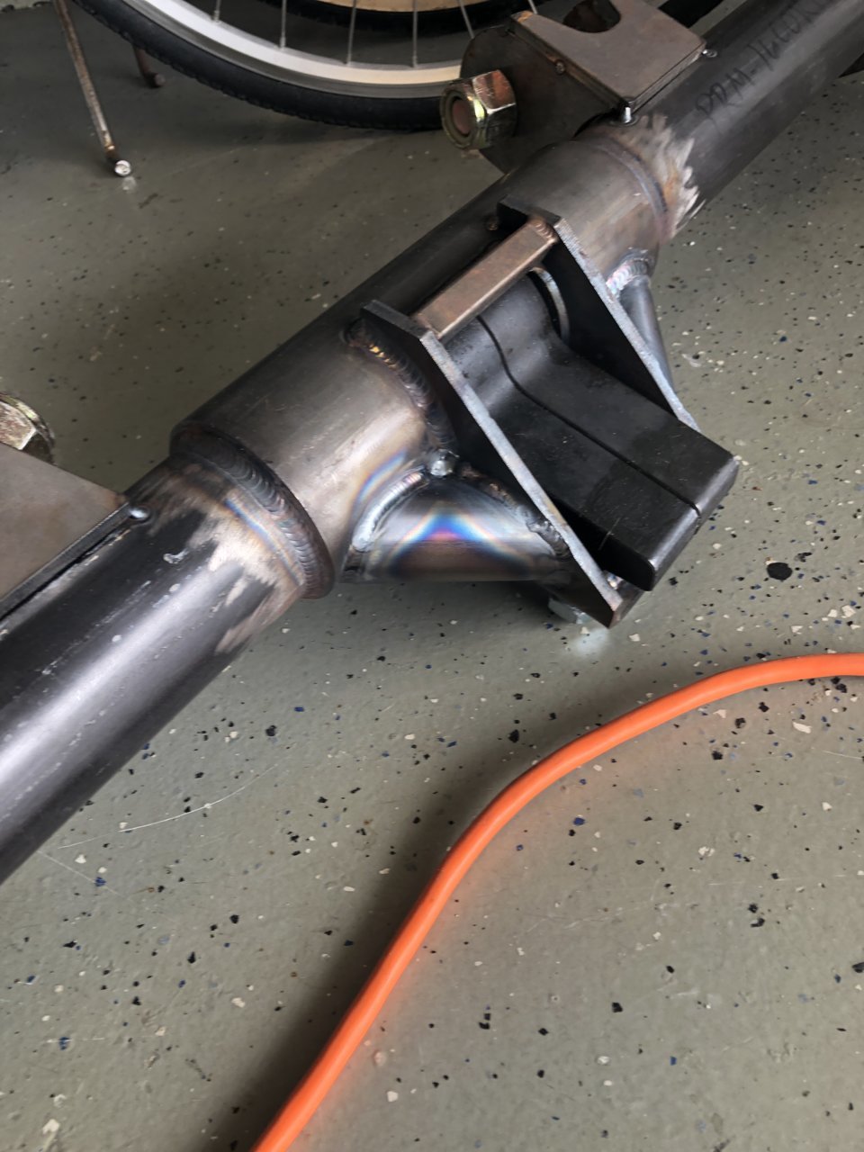

    Been building a new torsion housing (in all my spare time lol) for my brothers buggy, all tig welded cromoly...

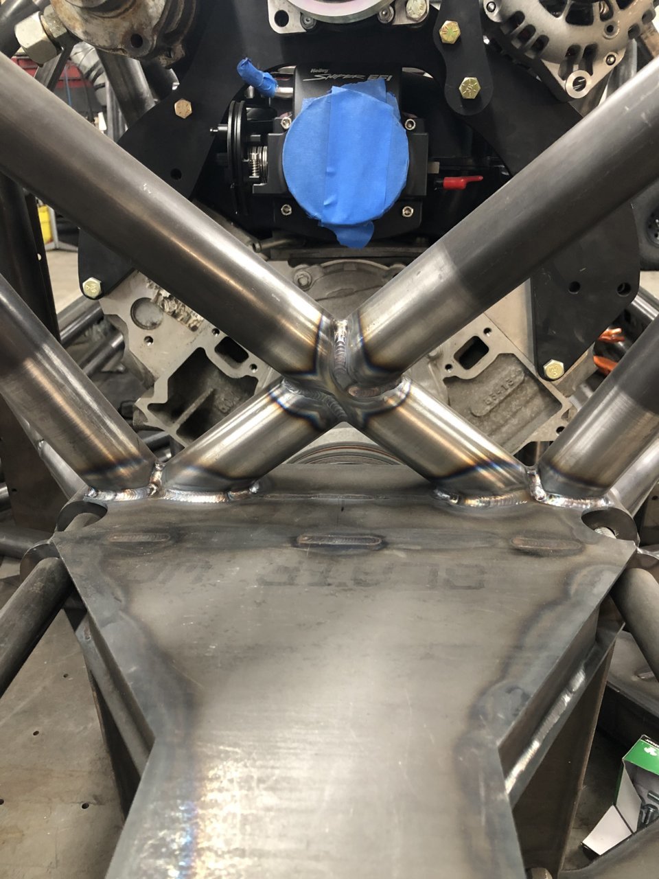

    I love early morning tig welding :)
