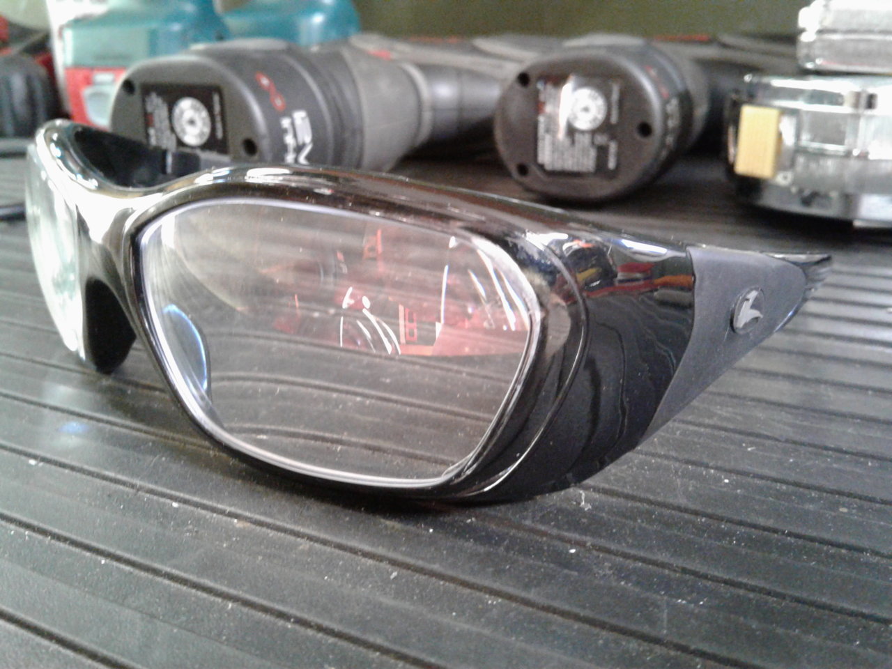

    Got my safety glasses and they rock. Prescription and the peripheral vision is awesome, almost perfect. Weld, grind, all is good. Gets steamed but I can fix that.
    http://www.forceflexeyewear.com/
    Zim
    Dalandser and EatSleepTacos like this.
