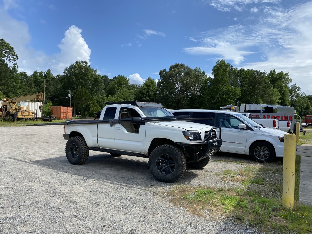

    Kinda works. For the front, I ended Strapping it to the door itself so the weight isn’t resting on the mirror. For the rear, I need to run a strap to the tip back to the opposing bedside to help support it. The bedside twists and flexes a bit. It worked though

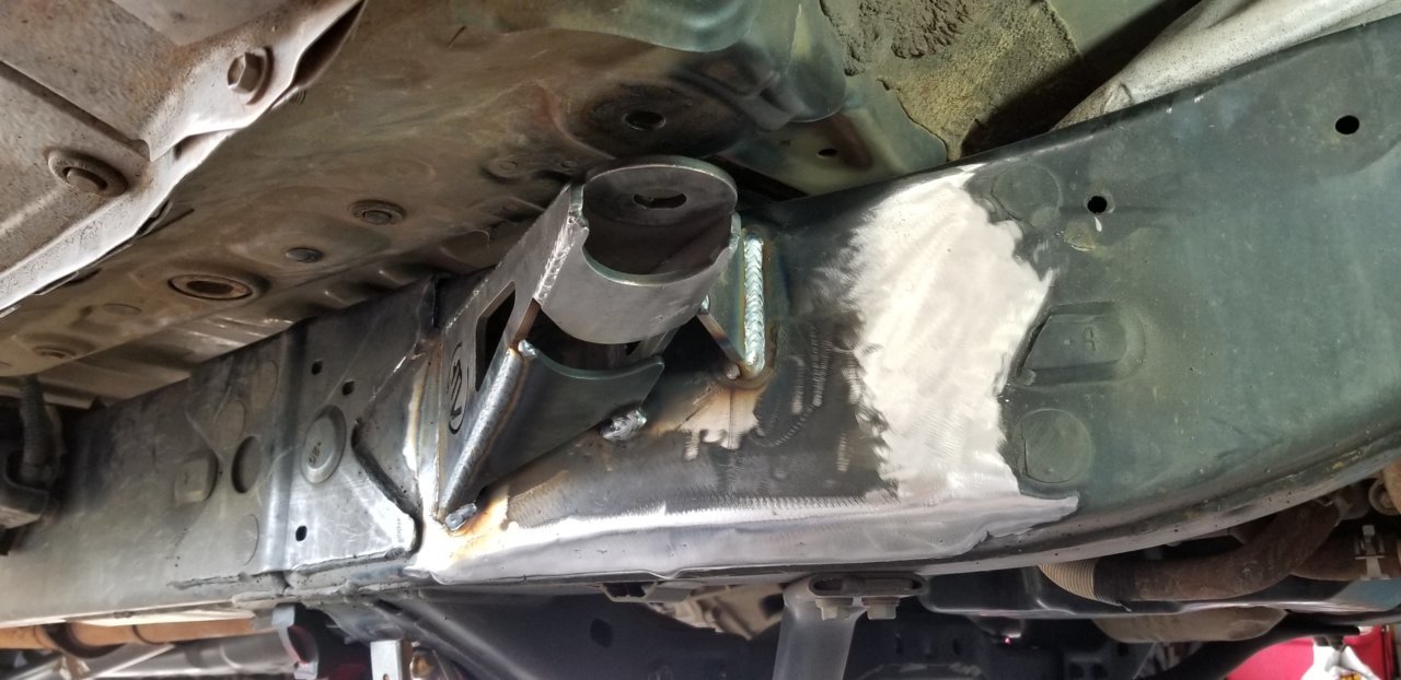

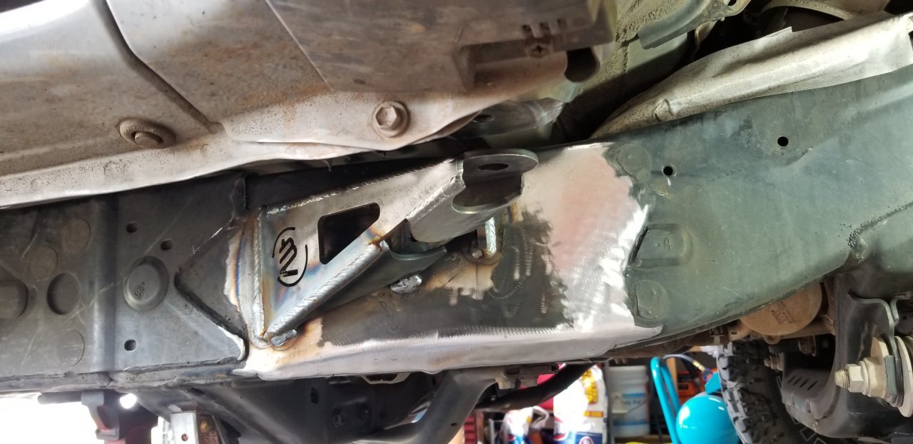

    I got this cab mount relocation buttoned up on a 3rd gen a few days ago.

    How much do those suck to do?

    What is the purpose of doing those mount relocations?

    It pretty much sucked just a little more than a 2nd gen, but as long as you jack the cab up and hold the wire harness way out of the way, it wasn't too bad.

    Lots of grinding, because the plasma can only get you so far.

    For when a regular cab mount chop isn't enough clearance for the tire.

    Tire clearance. The stock mounts are bulky and often hit the body mount.
