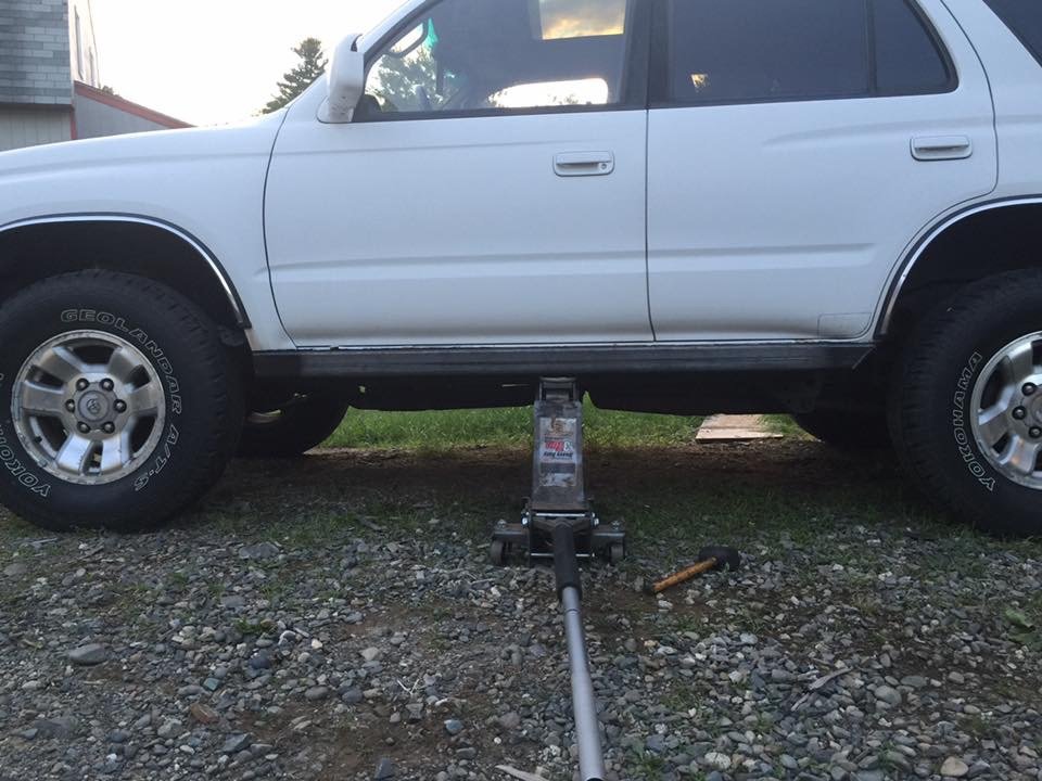

  18. Jun 17, 2020 at 7:19 PM
    cory02taco
    cory02taco Well-Known Member
    Jan 19, 2012
    #71007
    2,256
    Cory
    Maine
    2013 trd super sport
    I made this rocker panel replacement for the wife’s old 4runner out of 3/16 and could jack up the truck with it. If it were 1/4” it probably would have forced the jack into the ground while the truck stayed put. That stuff has dark matter or something in it that makes it special to work with.
    EatSleepTacos likes this.
