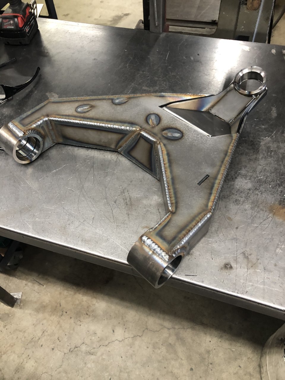

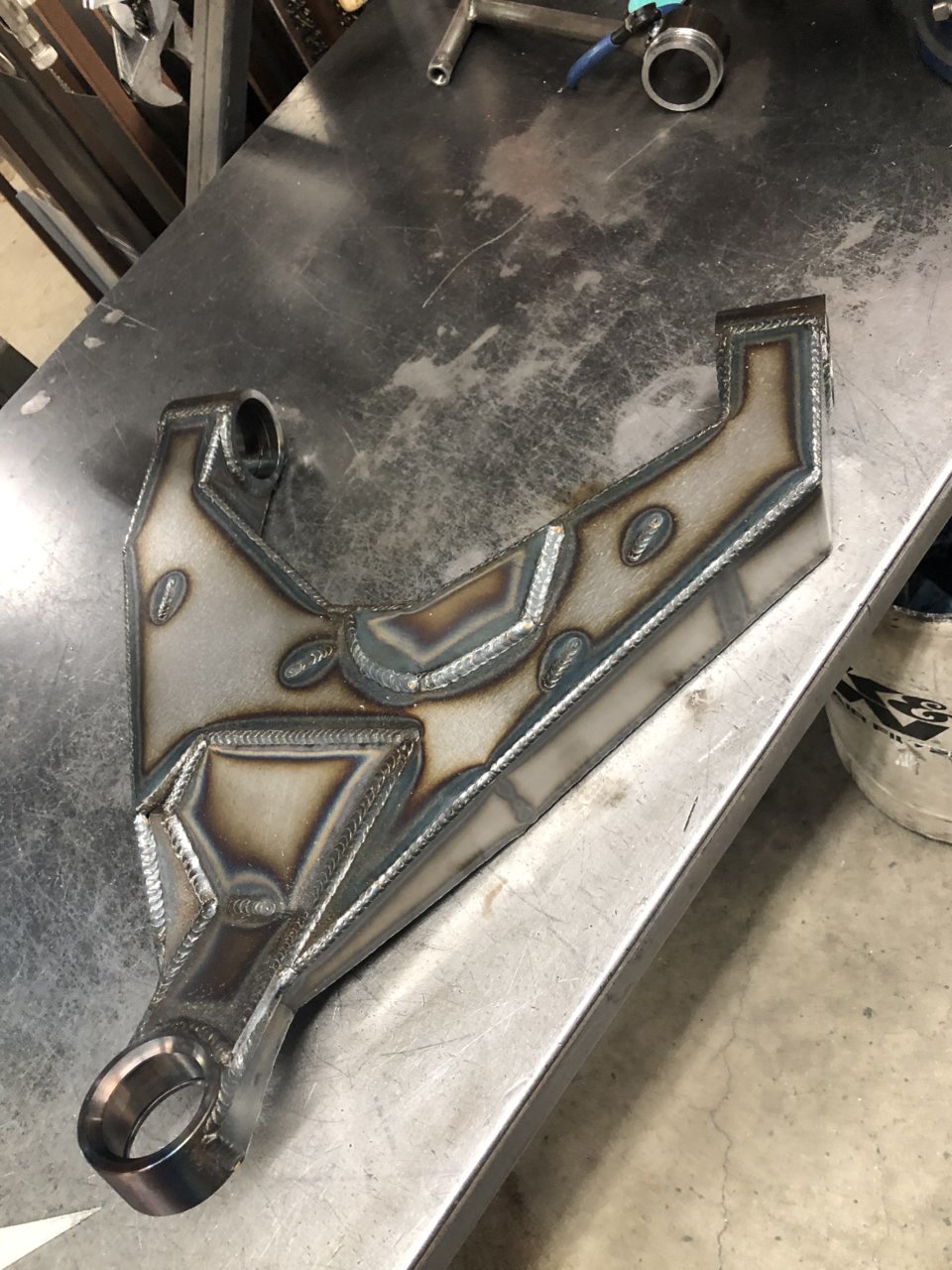

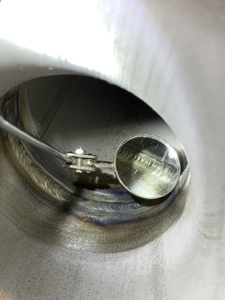

    Miller 255 really burns in the new Tacoma kits!

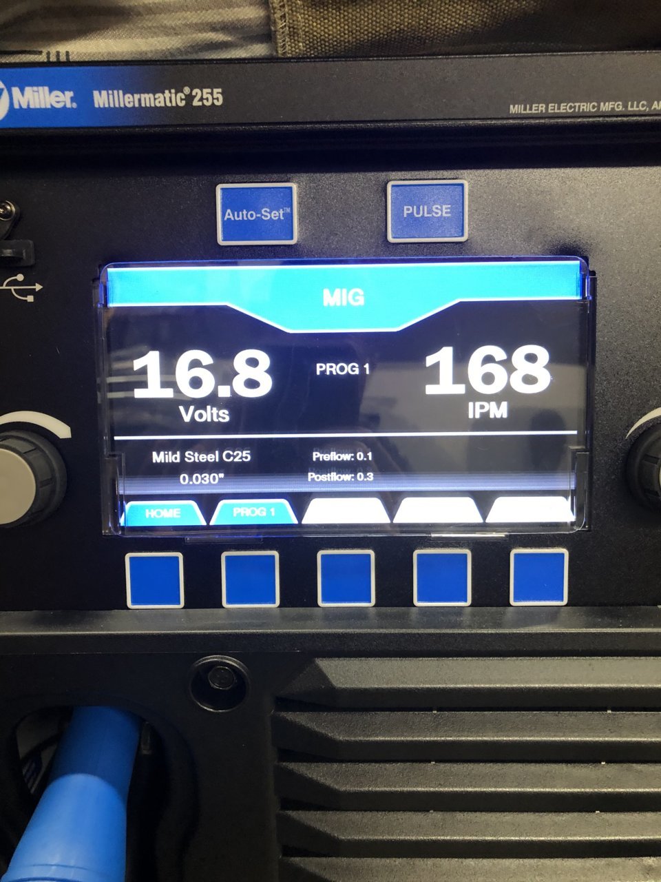

    Can I get some deets?
    Wire size?
    Wire speed?
    Heat setting?
    Gas and gas flow setting?
    I notice you credit the M255. Have you used other wire welders?
    I am leaning towards your skills are making those welds vs the machine.
    Care to elaborate?
    Regardless, that is some fine welding.

    I’ve had a 251 and 252 prior to the 255 and I’m loving the 255 a lot more after a little use and understanding all the settings

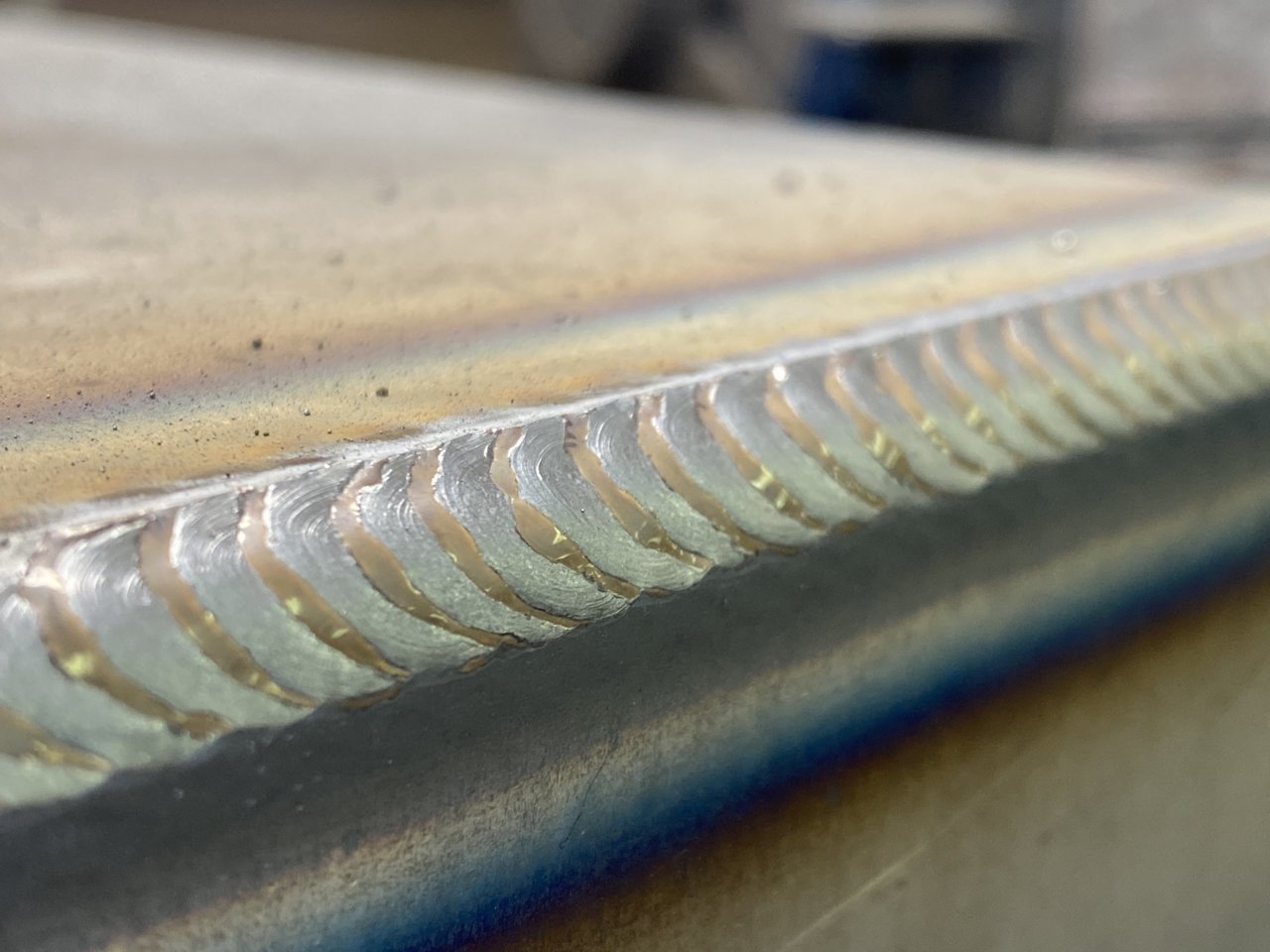

    Nice Fresh start this morning after having to cut out the last weld of the day yesterday.

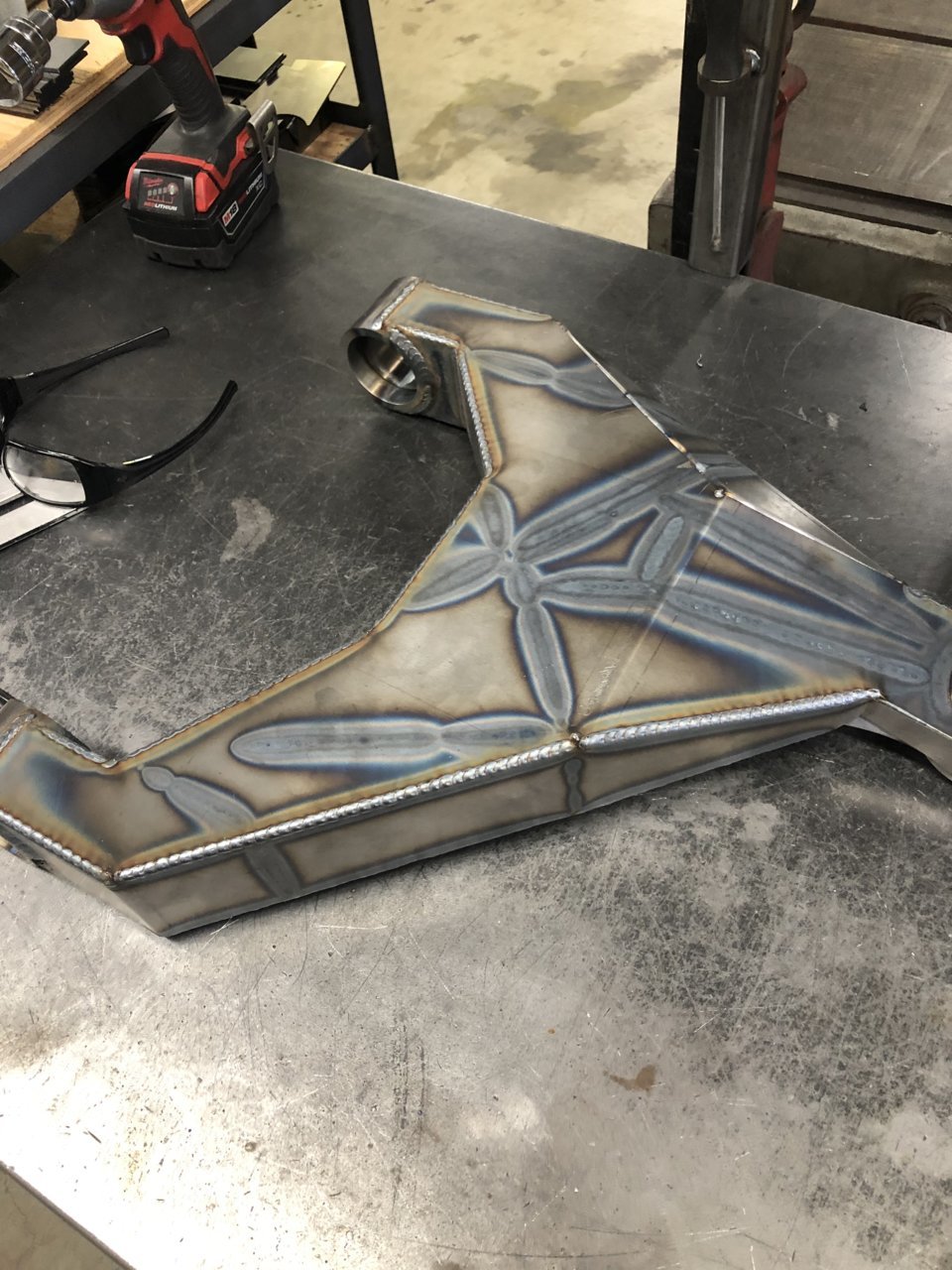

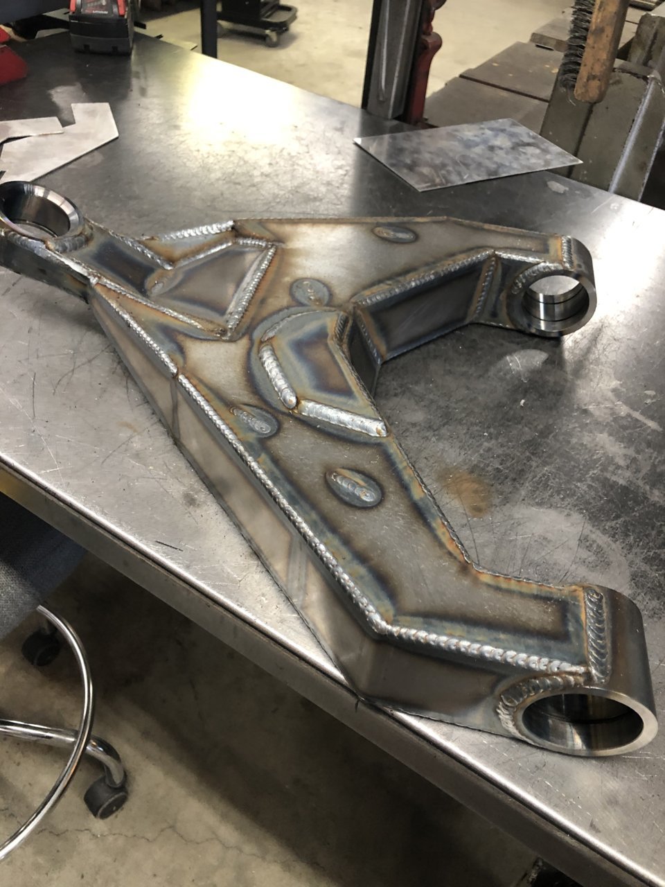

    I think the biggest thing I notice is how you can consistency lay the bead without stopping. Do you ever worry about heat warpage or is the material thick enough for you to not give a fuck? Also I almost never can tell where your initial tacks were.

    The majority of the arm is welded in a jig. I move the heat around and stop and start a bunch. I also do all the internal rib welding then let the arm cool all the way down before doing the top plate

    Are you making these for production or for yourself? If for yourself, you have a build thread for your rig?

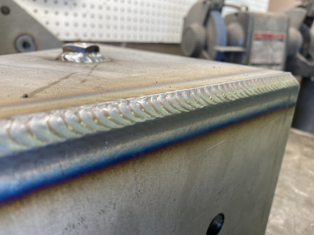

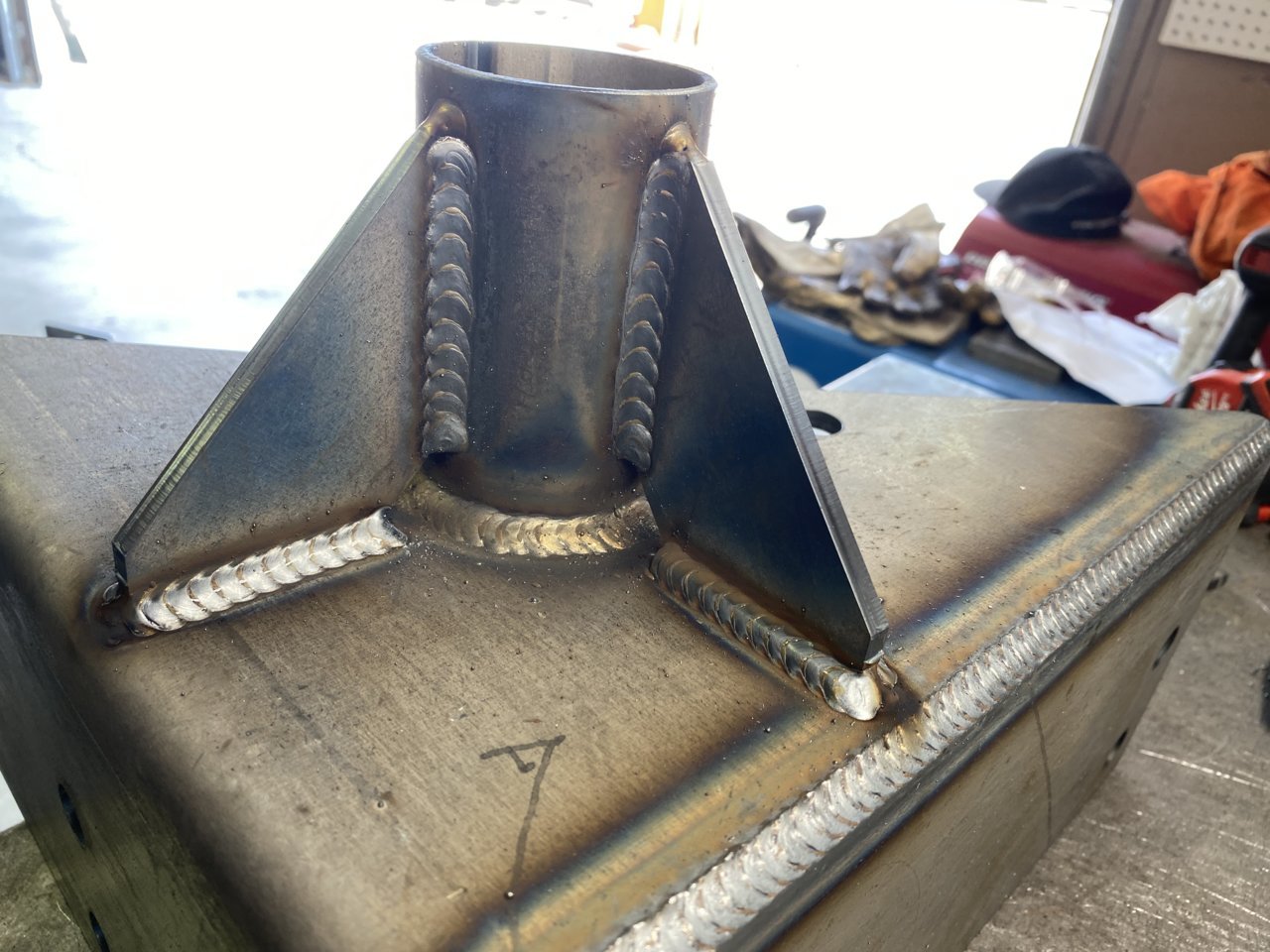

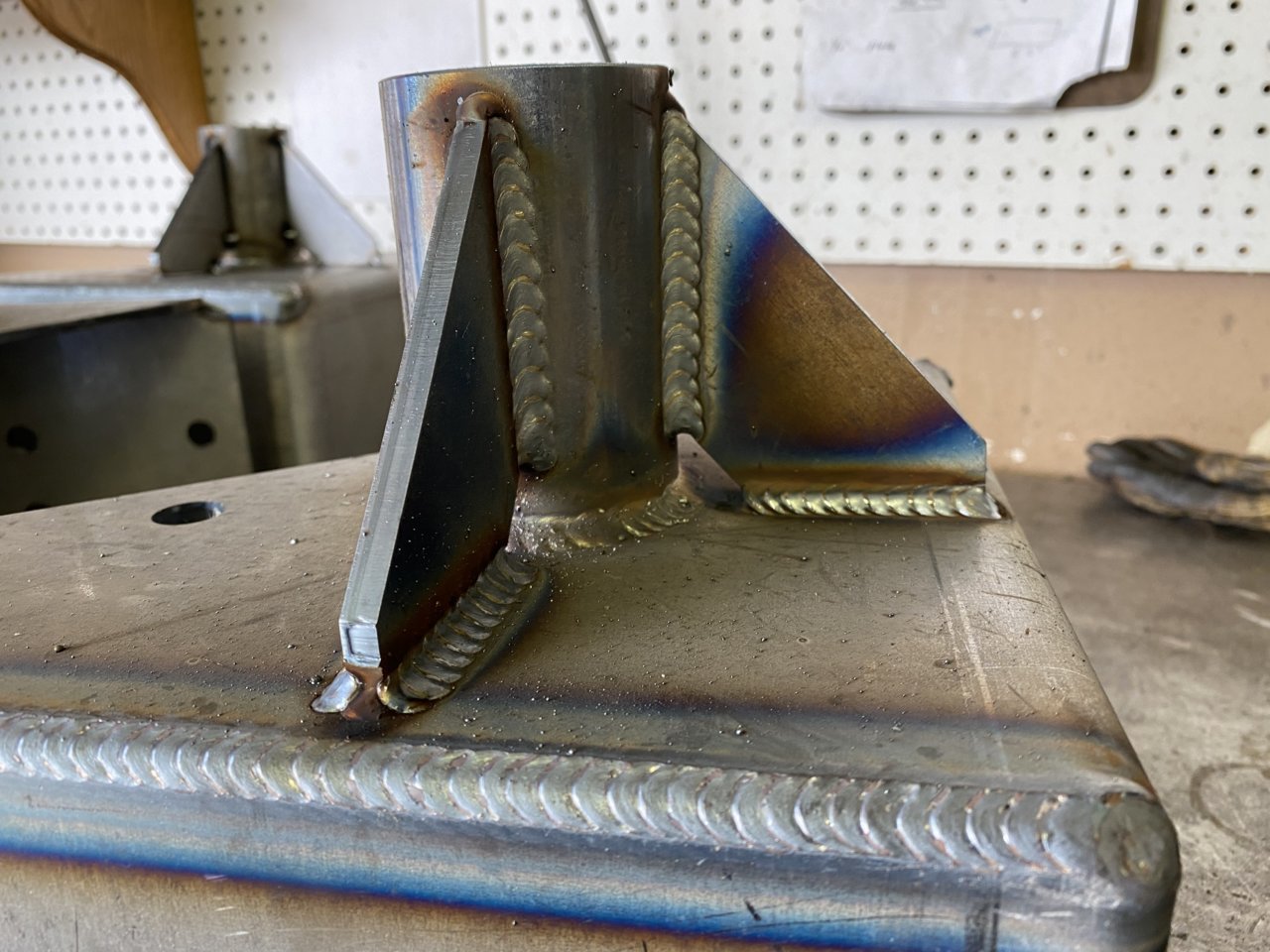

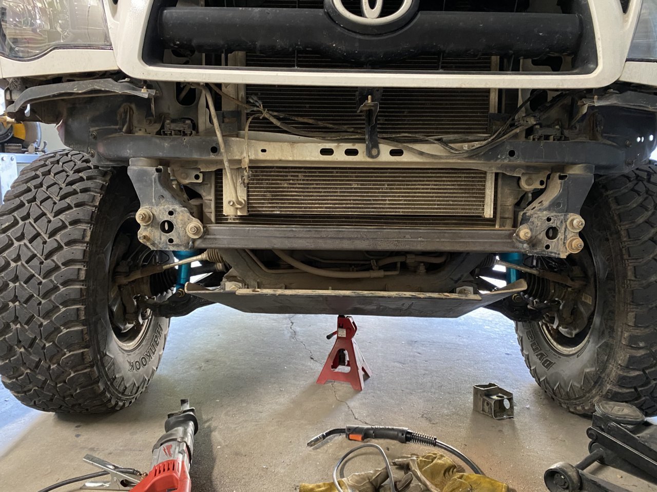

    Getting started on the next project. Pretty happy with how these came out.

    so are you pulsing this or just really good torch control...lol

    What's the plan for the front skid plate? Are you modifying or building from scratch? Or will the new bumper provide the mounting point for the skid?

    I’m going to put two rivnuts on the bottom of the square tube. I’m going to cut off the front of my ifs skid right at the bend. I will build a new front portion from 1/4” (what I have handy). It will essentially bolt up like a normal ifs skid.

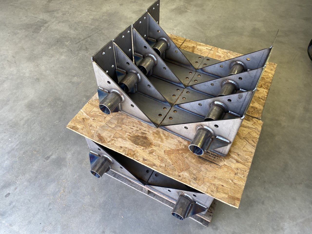

    Few more production parts D118E813-F3B1-4678-ABD3-F6CDF989B111.jpgD25387FE-C398-4AE3-B369-8B92B8A2DB03.jpgEF001F58-C31E-4AF0-AD76-F1AD64240D27.jpg50223807-0A51-4A52-877F-5D53320FB69D.jpg8D426D12-C60E-48EB-AC18-E425A6EDF095.jpg
