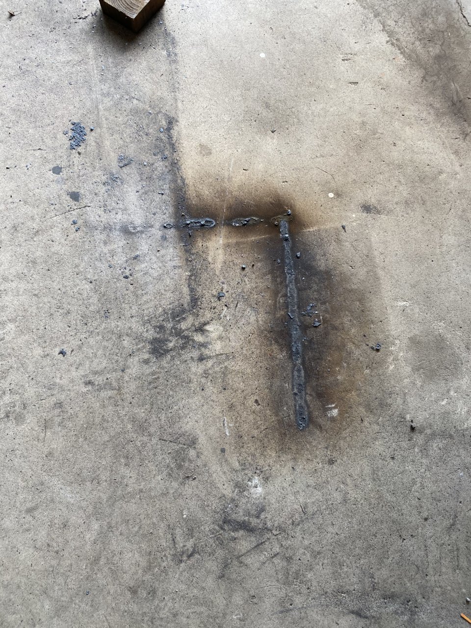

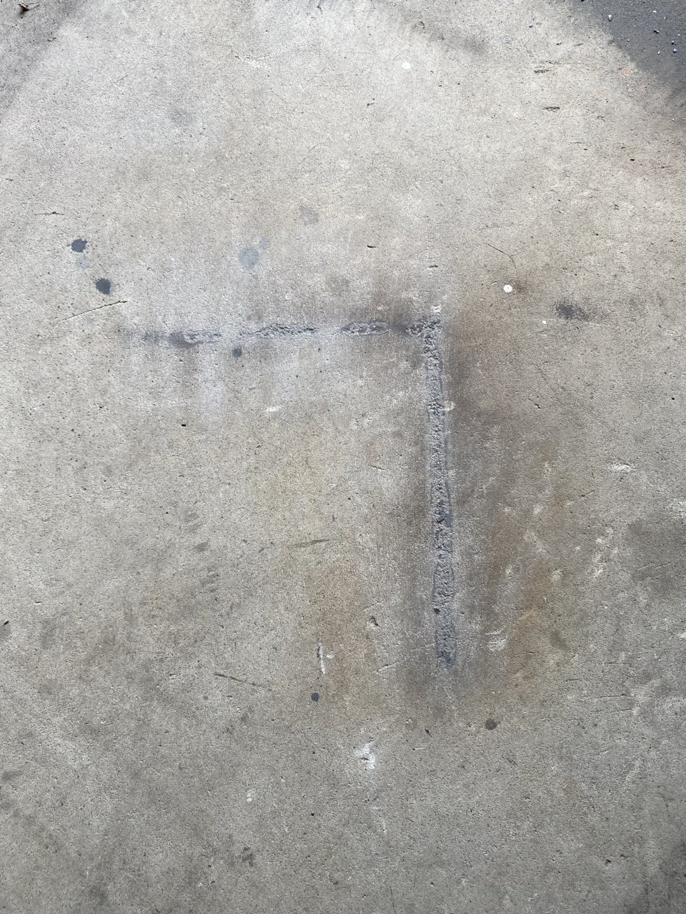

    No pulse... it’s such a pain in the ass welding 1/8” corner joints

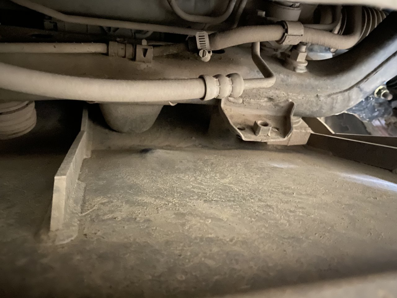

    Cool. Any concerns with taking a hit at speed since the angle will be steeper?

    No, there’s really nothing behind it to be concerned about. I mounted the square tube so it’s lower than the rad. The closest thing will be the edge of the front diff mounting arm, but that’s a solid hunk of steel. I’ll add reinforcements too.
    This is the worst dent I have on the front, and it’s 3/16” and away from any reinforcements. I drove right into a rock going 5ish mph. Rocked the shit out of me and this is all it did. 1/4” will do even better.

    Nice "7".....

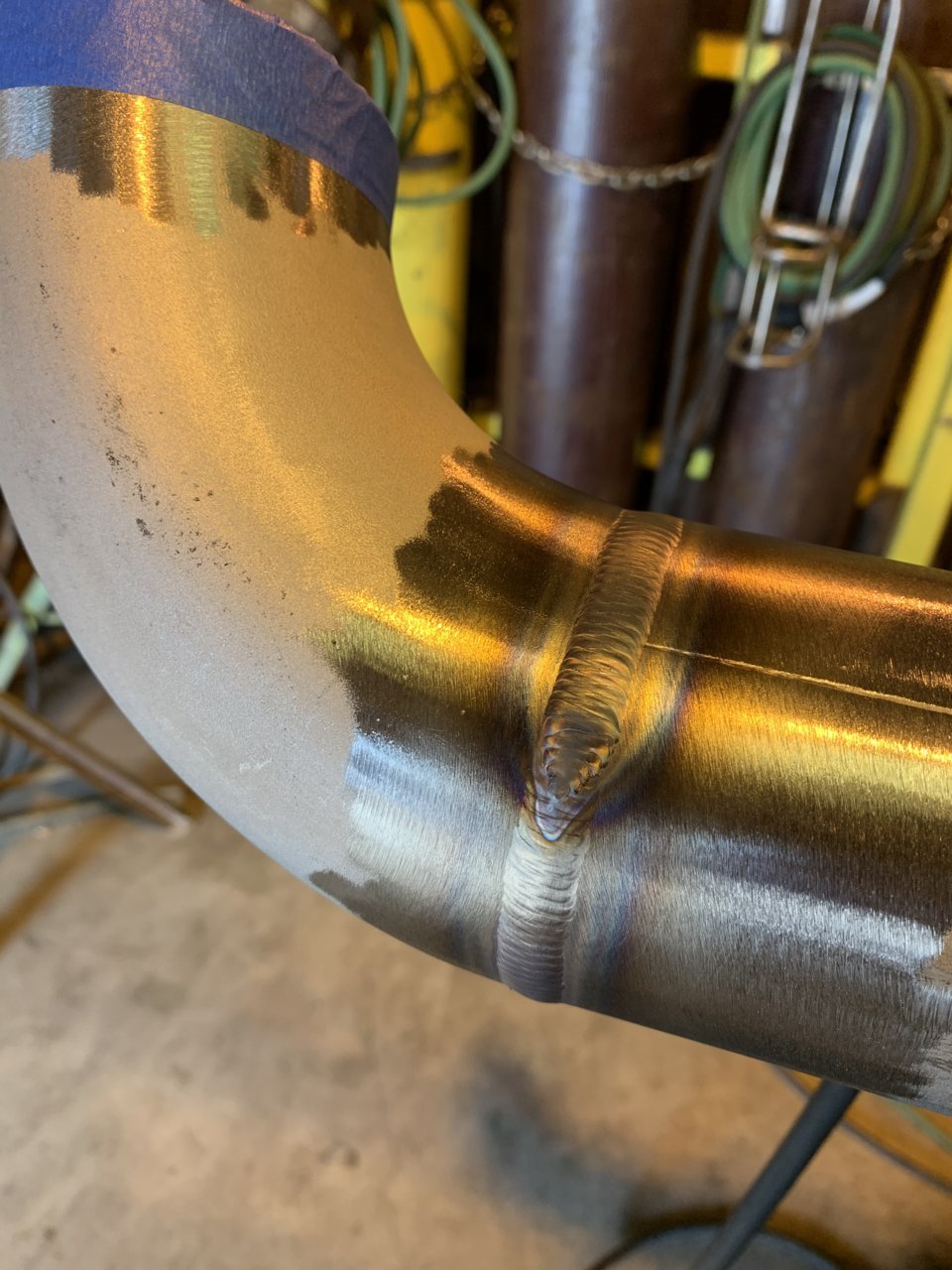

    Fail RT requiring the cut out? How do they make you cut it out? (always curious how different industries handle cut outs)

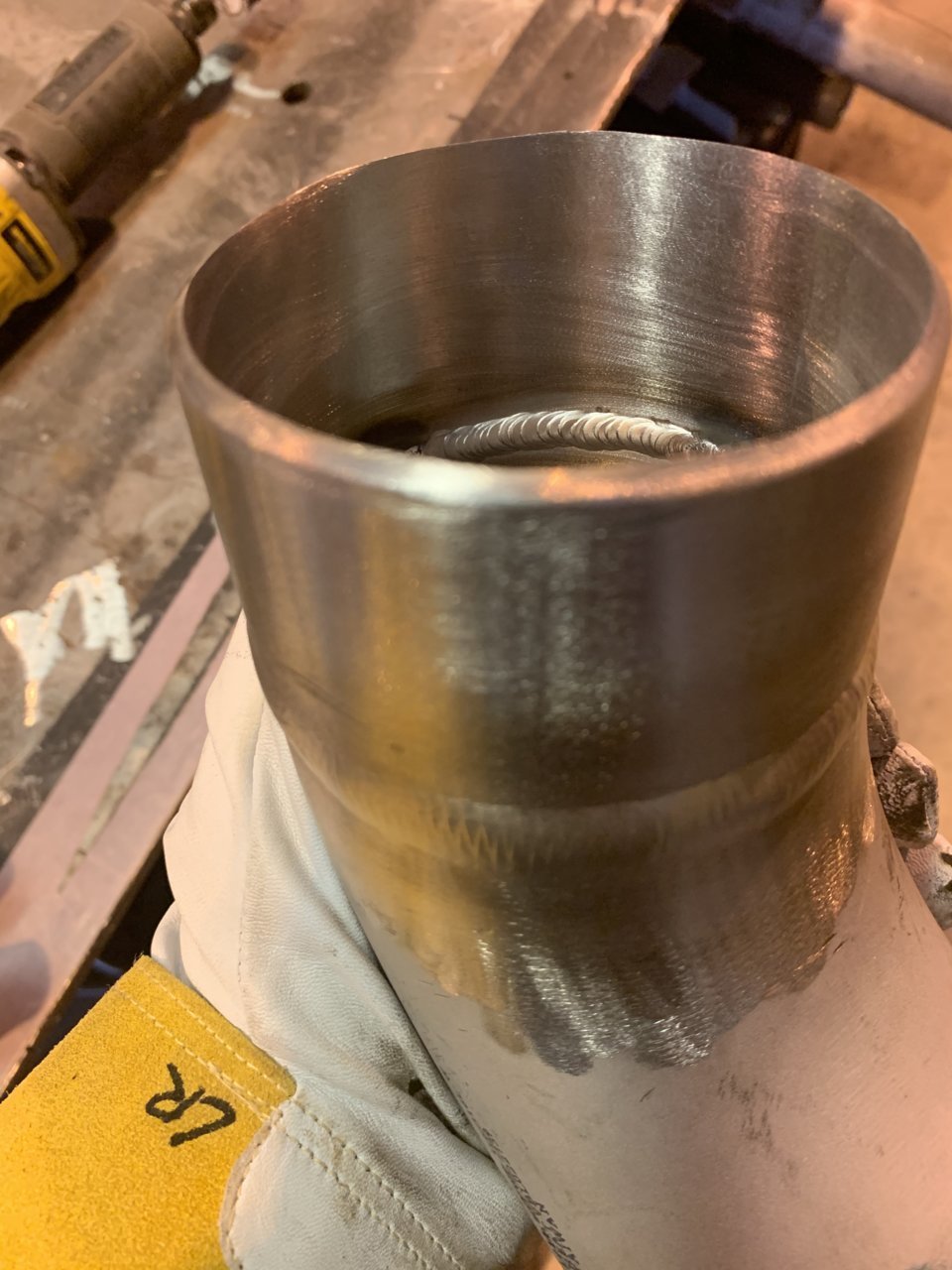

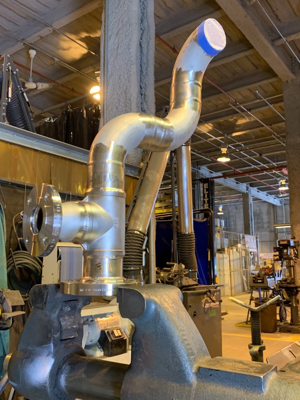

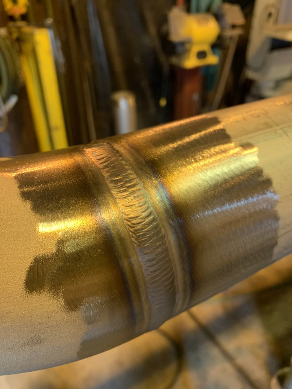

    No I screwed up on the root, cut the bad spot out with a 045 disc and re welded it. Looked back in there with mirror and it was still messed up so I cut the 90 off completely and started over! Second time was good. I screw up sometimes! Here is the second one.

    Gotcha. Not nearly as painful as cut outs for our guys. Especially if cleanliness is being maintained. Get to file away the cap/final pass till smooth then use a clean cut tool (think roller cutter you normally see for copper tubing)
