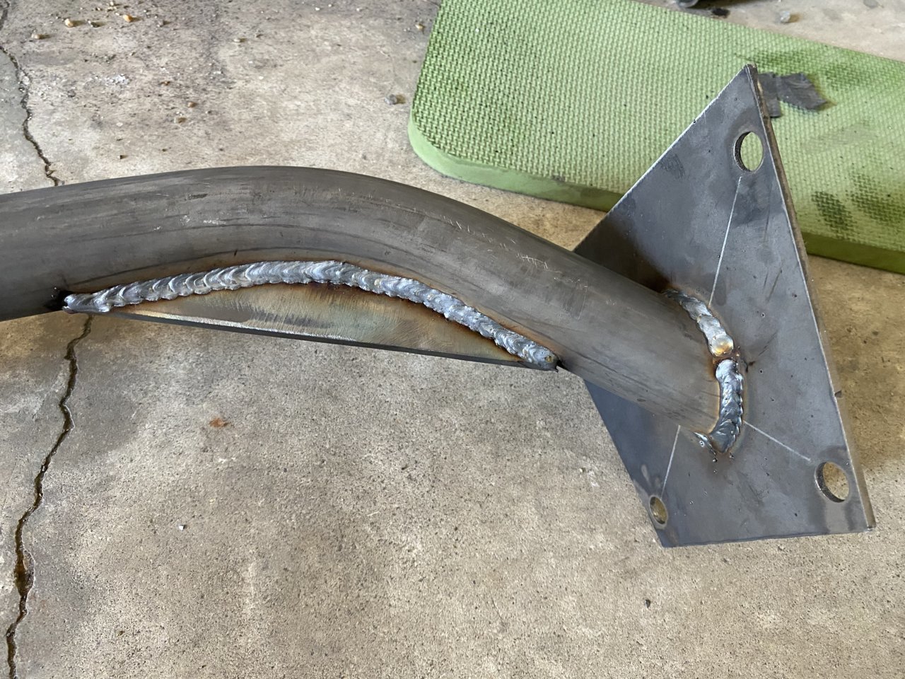

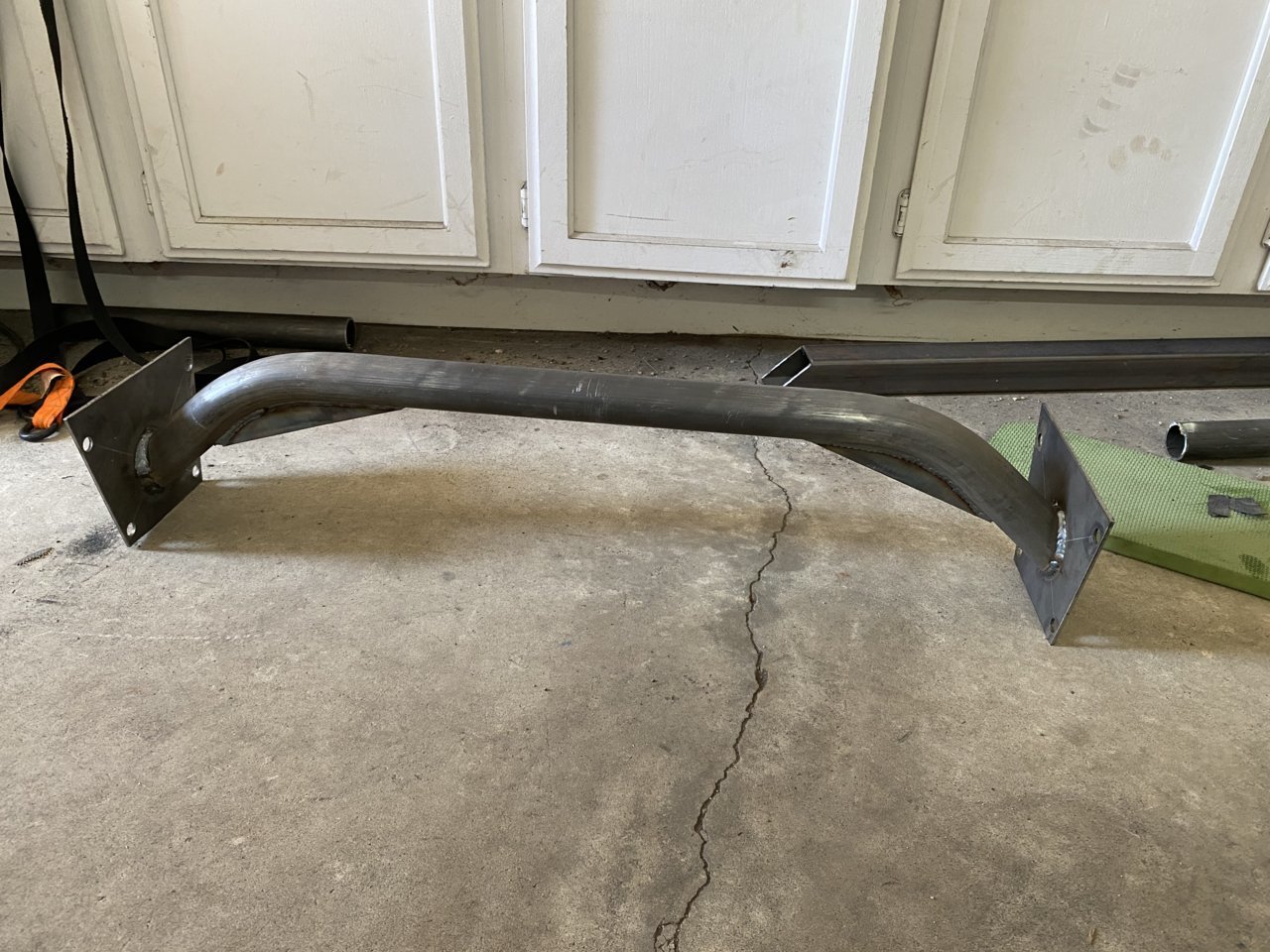

    Made a bamf crossbar for someone today

    I have to build one of these for my truck and another for a friend. Curious as to why you put the gusset on the tubing.

    The whole point of the crossbar is to keep the two hangers from flexing inward towards each other. With the bent tubing, I didn’t think it would be very effective at that. Hence, the gussets. A straight bar is the strongest, but he wanted it tucked up.

    If you want to get really trick you can do Mohawk gussets in the bends. You cut slits in either side of the tube through the bend and put the gusset inside of the tube. You then weld it back up and it looks really clean
