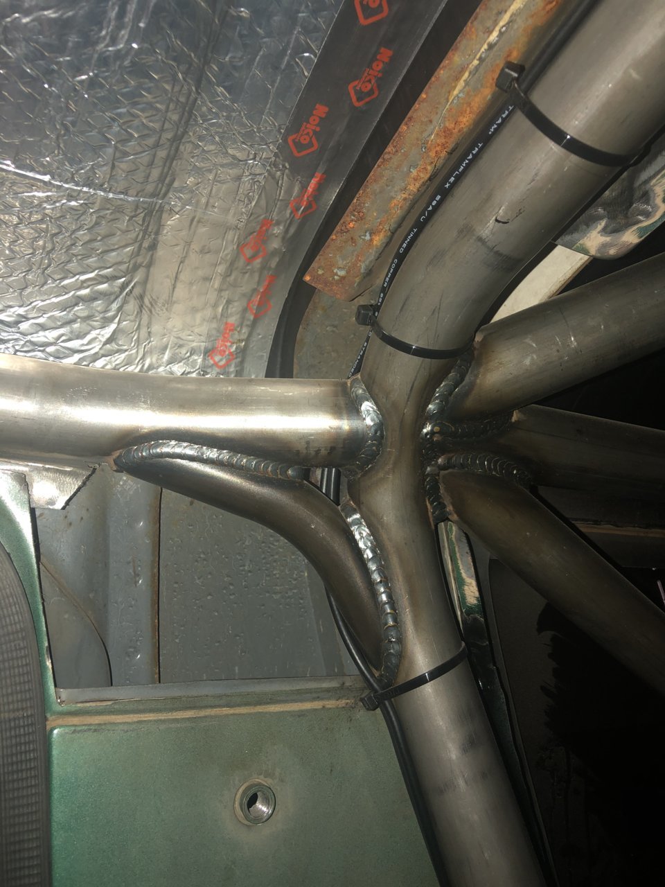

    Do you mean put the gusset IN the tube? Like you don’t even see it after the fact?

    That was my take on it. Some or a lot of grinding and it would great 'fake tube'.

    Yes in the tube so you don’t see it and then weld the top and bottom. When it’s done it will just look like a bent tube that has beads laid on top and bottom

    What's the OD of the gusset vs the main tube?

    1.125 with 1.775
