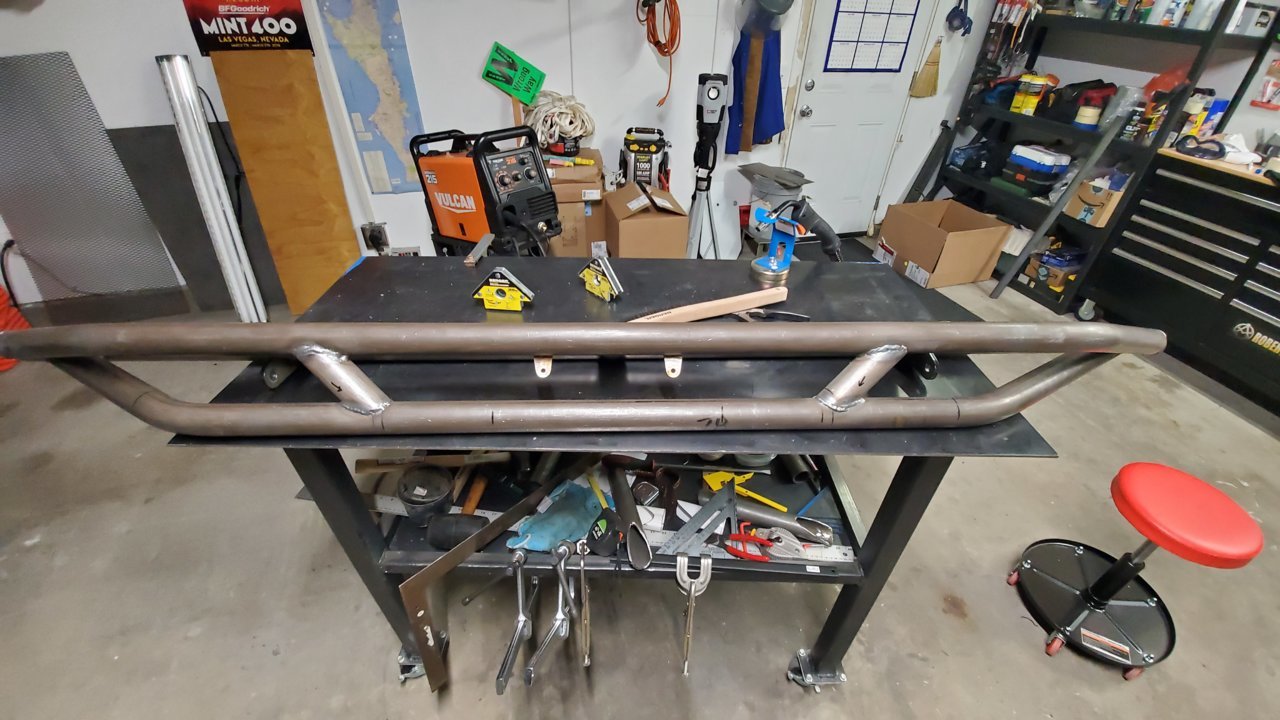

    Nov 3, 2016

    Bending large sticks of tubing is very difficult. It really tested me with getting measurements and angles right, and had to go back and tweak it after the initial bending was done. The angles could be a little tighter to the body but for my first time doing something this large (and like 3rd time ever bending) I’m happy with it.
    I made the tube extra long because the last thing I wanted was to come up short. I worked from the middle outward, going off of the fabricator series videos on YouTube. Overall I’m happy I got it with this tube and didn’t have to scrap it and start over, even if it’s not perfect.

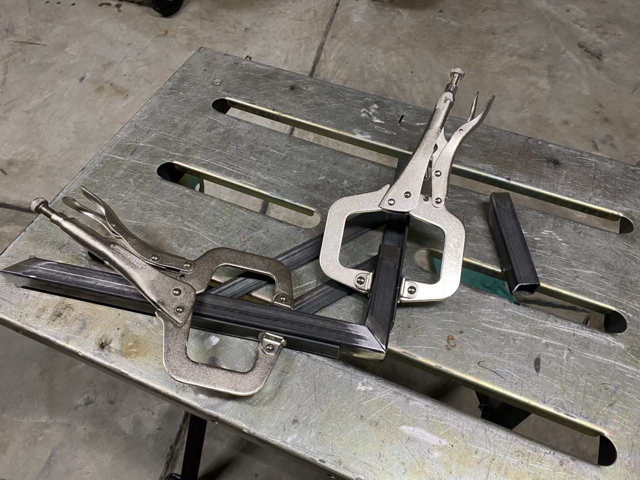

    Home made welding square?

    Yes it is
