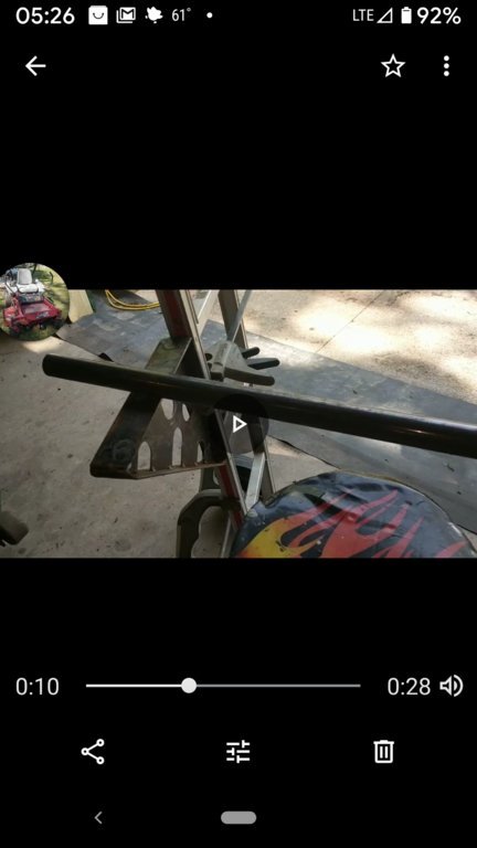

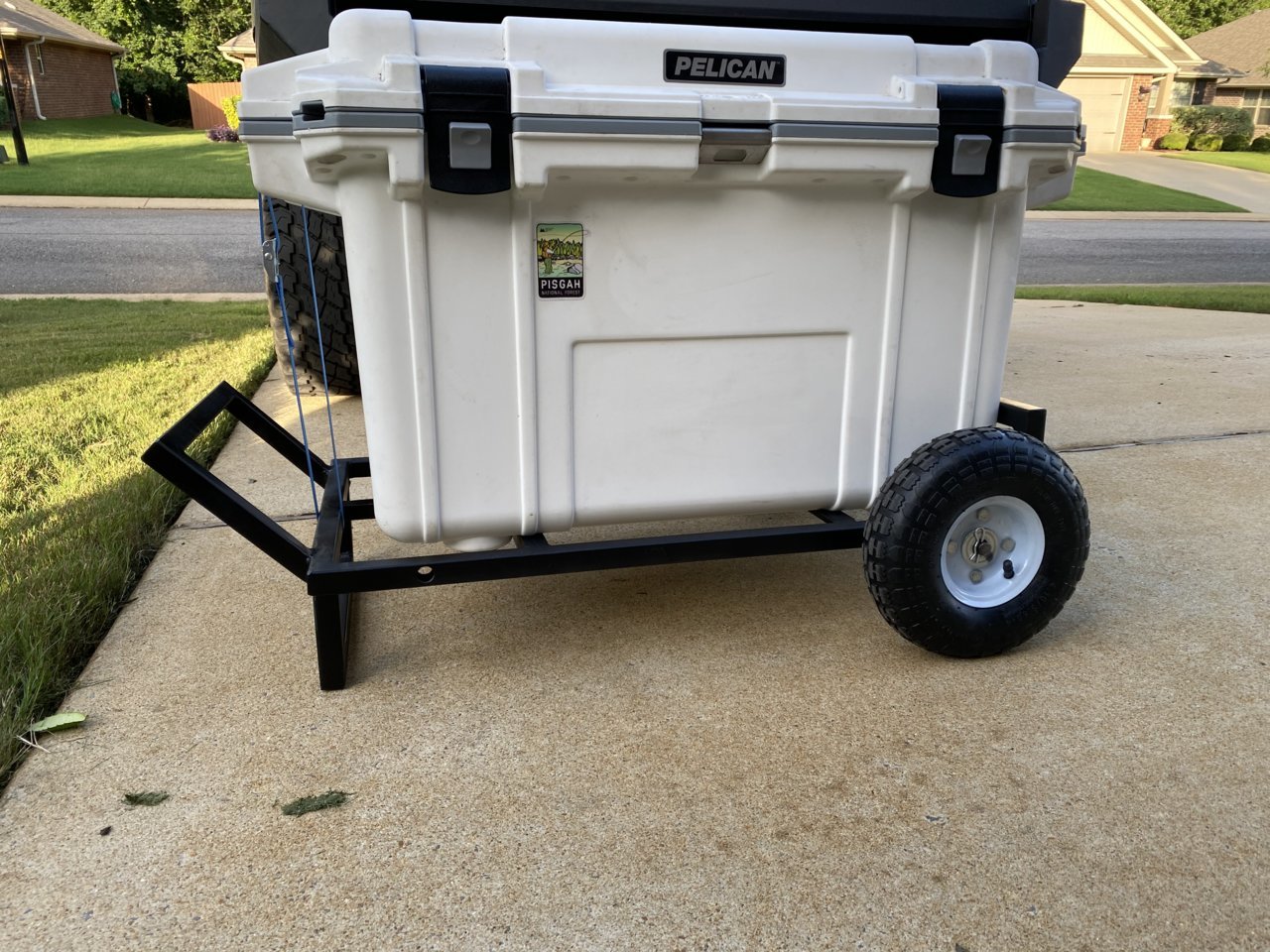

    Is it just angle iron and bar stock? Clever.

    It’s actually angle iron and half of an angle iron...haha
    didn’t have flat stock so I made it

    It is super handy though. My beer wagon is actually square...

    that’s going to look good. I followed the rear bumper build, guess i will have to do a front soon now. Don’t think I will be as successful with the bending

    Psh, see that shiny spot? That’s where my measurements were off somehow and that portion was 1” longer than the other side. My solution was to cut out 1” and weld it back together because I didn’t want to scrap the whole thing. Each bend I had to put back in the bender and bend it a few degrees tighter. Trust me, she ain’t perfect but I’m ok with that. At least now the bend angles are identical on each side. You’re going to do great if you do try something like this.

    Cut a short piece of tube down the middle that is the next diameter up from what you’re working with. Lay that over the tube you’re working with and trace the side of the short piece of tube with a scribe.
    That way you can line the scribe back up in the bender and re bend in the exact same place. Sharpies are junk... throw them away and get a good scribe.
    And yes multiple bends are tricky... just imagine doing the main tubes for a roll cage with multiple bends in different planes and making it all tuck up inside the truck

    Well if my track record with leaving sharpies uncapped tells us anything, I’ll run out of them soon enough. I have a sharpened welding pencil for most stuff but I have a hard time seeing that then lining up in the bender

    Get a good scribe and don’t be scared to dig into the metal with it

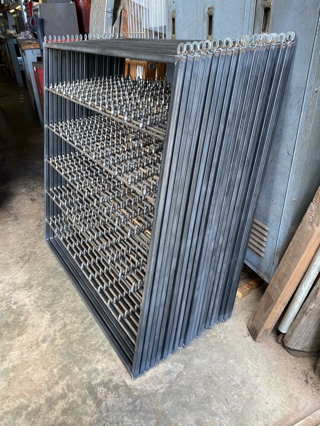

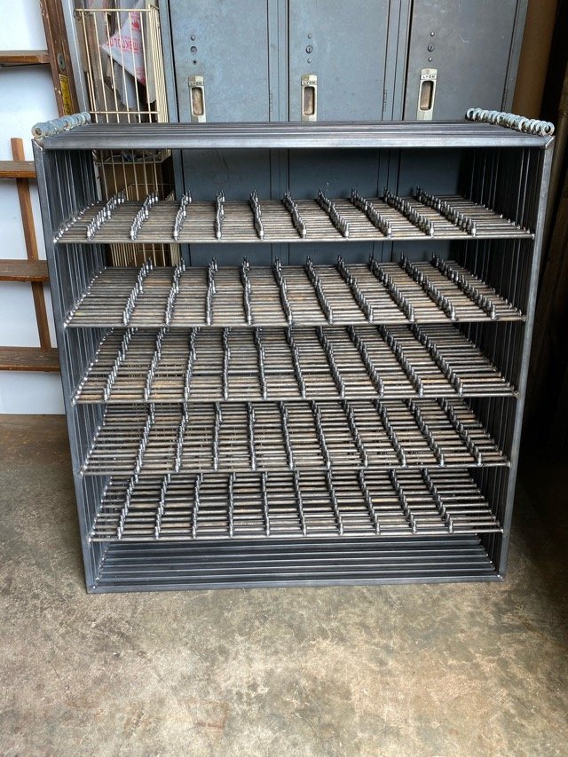

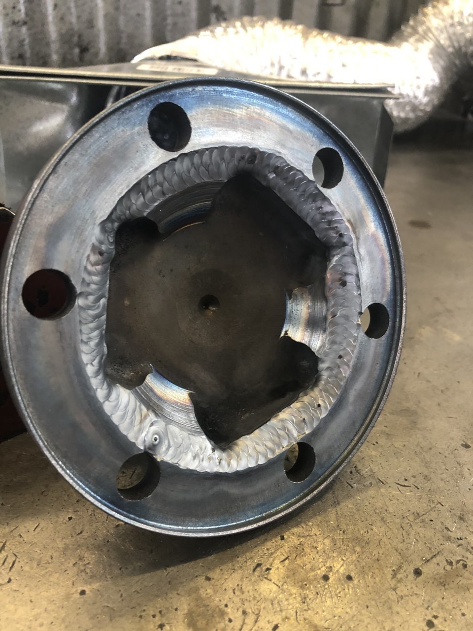

    Been welding some fixtures for the powdercoater.

    934 CV Weave Wednesday??
