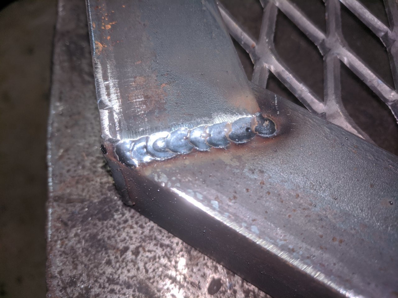

    I decided to build a couple of my campsite grills using TIG style MIG welding. My machine does it just fine, but it still takes too long for me.IMG_20200703_093802.jpg

    How does that take too long? With the correct heat and wire speed that can’t take more than 3 seconds?
    I was welding up some arms yesterday and just for fun timed myself. The first arm I dragged all the inside ribs and the second arm I welded as I normally do. The results- dragged arm- 1hr 55min and the other 1hr 53min.

    I seldom drag my welds. Always push works for me. there is no thinking involved. i have to spend too much time making perfect cursive e's. Its just not that important to me.
    in addition, I wanted to prove that the machine is not getting all the credit or that style of welding. My 20 year old transformer machine can make those welds just fine using .035 70S.
    Also, when I'm doing production work with multiple identical welds, I can't use 2 welders to get the job done faster using that style welding.
    Don't get me wrong. I love the look, I even like the look on my projects, but seriously, who else but the people in this thread are going to care?

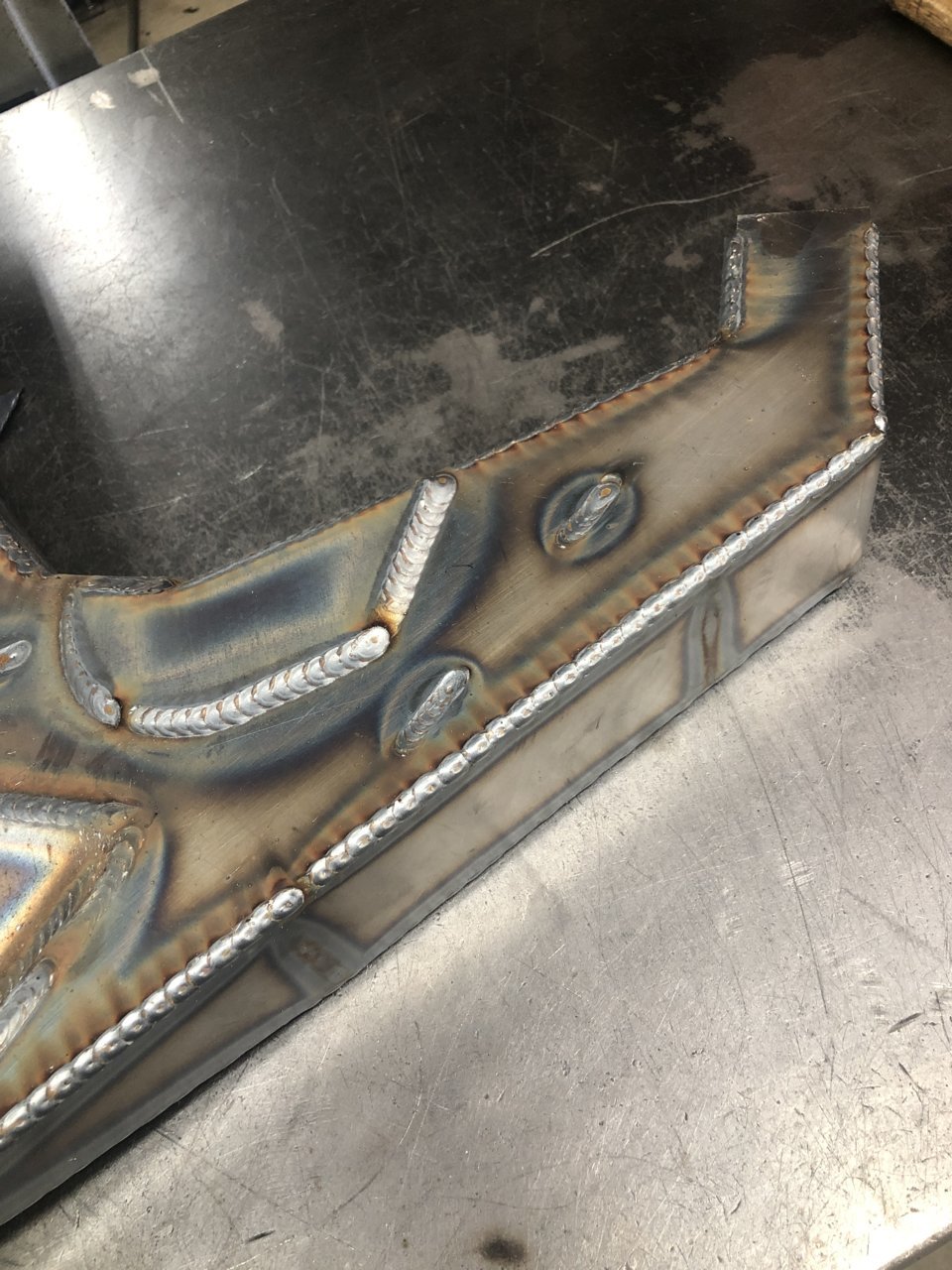

    These are probably the nicest weld on my new bumper. Mmmmm.

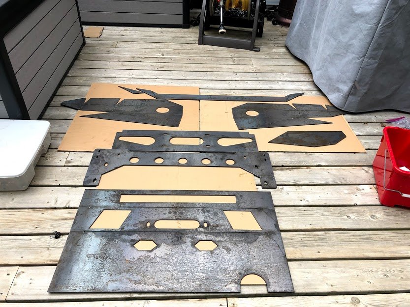

    Building a plate bumper out of purchased plans ( been told its a knock off pelfreybilt ) so its got 1/4" internal support / frame, and the rest is 3/16"
    my question is about shackle mounts.
    how thick do I really need? I ask this because I run a Lincoln Mig pack 140 @ 120V with .030 wire and Gas.
    i'm a bit concerned how I would weld on 1" thick shackle mounts. is 1/2 too thin? is 3/4 OK?
    I'm asking the experts here because I have a tendancy to go overboard without knowing why ( using 1/8" where 14ga would have been fine )
    also should I get long ones that go through the bumper so I have more surface to weld on? or would those short ones you just weld to the front of the plate steel be good enough?
    **pic for the likes**

    1/2” is what I would do if I were welding with 120v. Some manufacturers use that and it’s fine. 3/4” is ideal, 1” is overkill. Make sure you get long shackles that pass through and are welded on multiple surfaces as opposed to just welding something to the face of the bumper.
