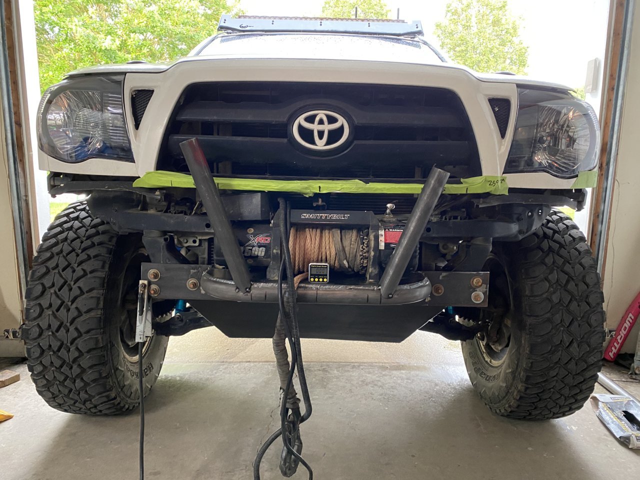

    It’s the basics of tube bending. That, and building a roll cage were the most helpful videos for me. Roll cage was helpful because the main tube of a cage was 4 bends in the video, so essentially the main tube of the bumper I was making. A big takeaway was also using masking tape on things and making marks for measurements. It sounds so obvious but I never thought Of it. It helped a lot. That’s why there’s tape all over my truck.

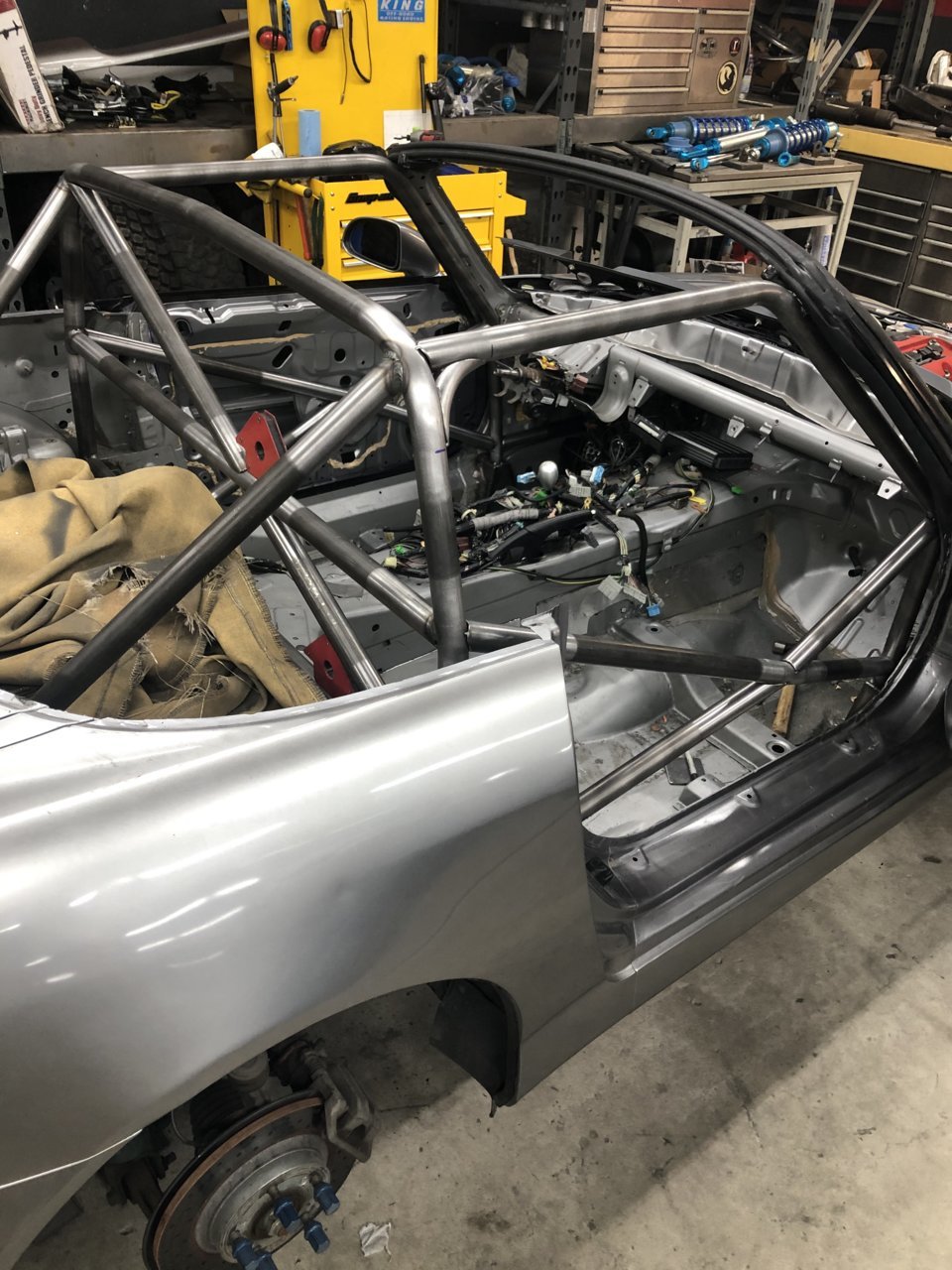

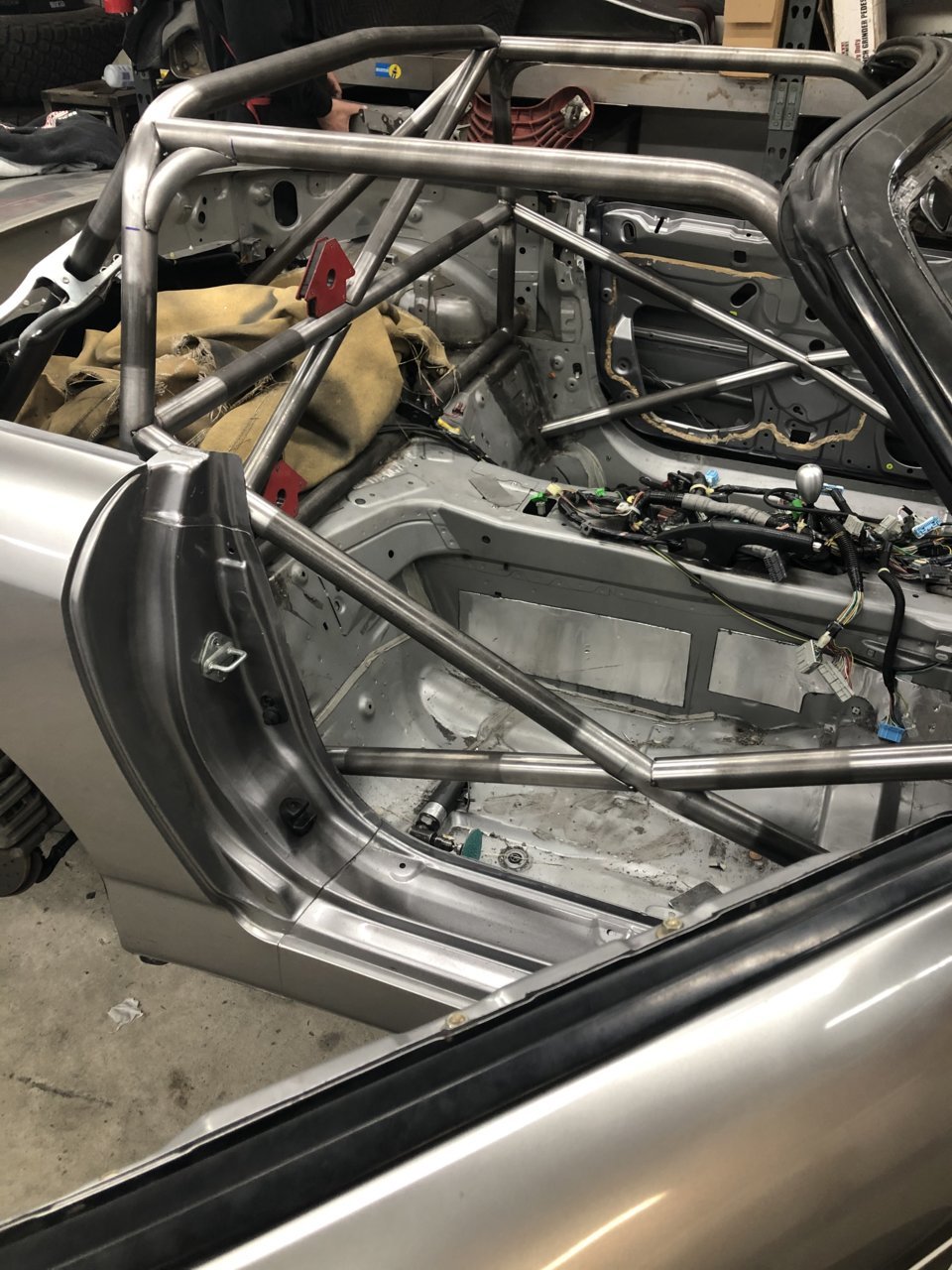

    Butter....pure butter.

    That gusset is to die for. Cope magic right there.

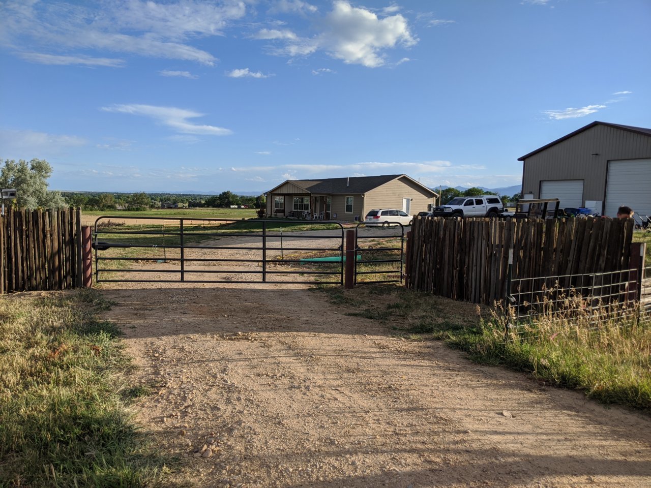

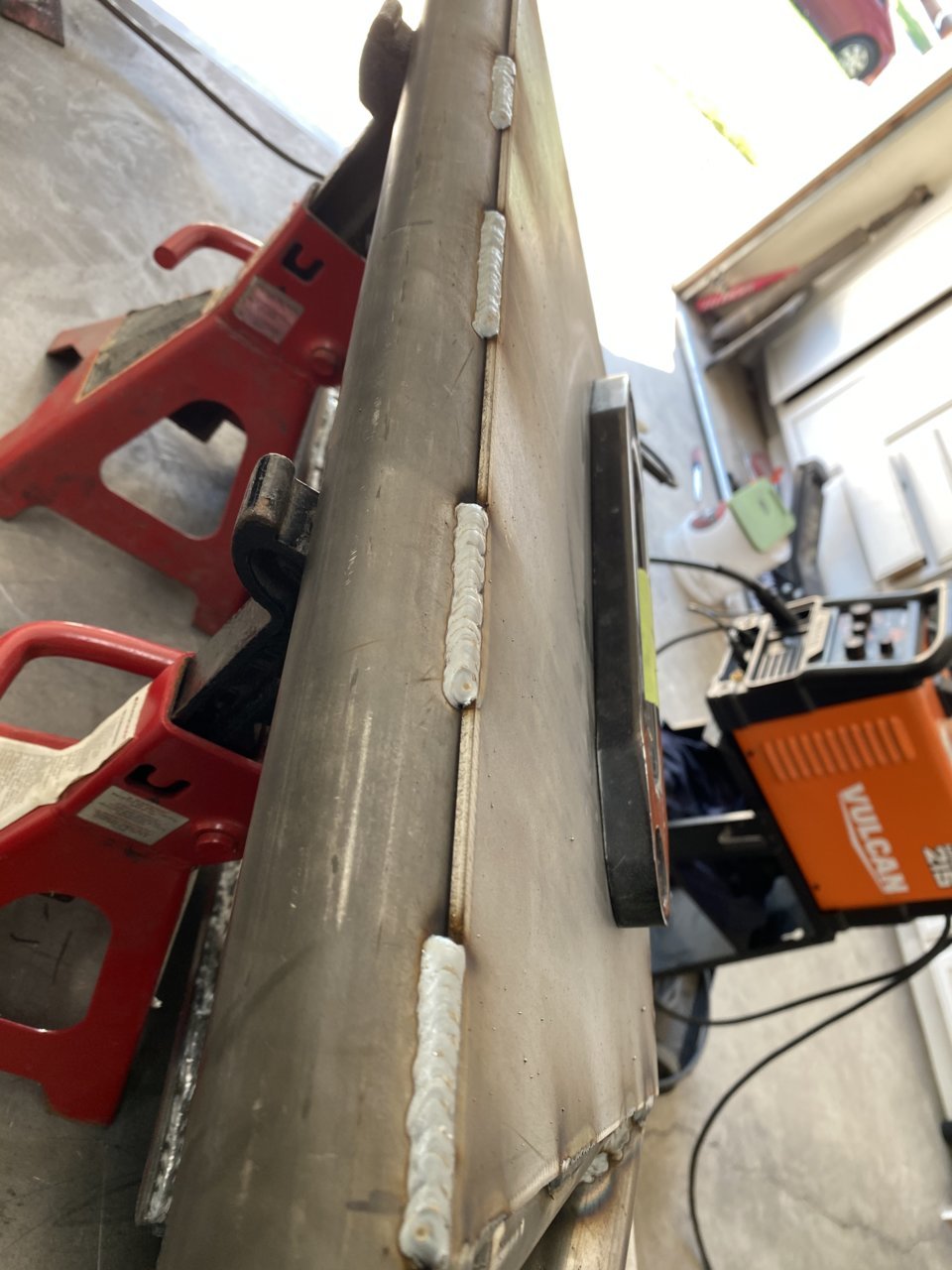

    I'm certainly not a professional welder and no one will ever accuse me of being a fabricator, but I got a welder because I wanted to be able to stick metal together when I needed to.
    Perfect example..... Building a fence/gate for the new house.
    There's just a huge satisfaction in being able to do it myself and not have to call in a welder.
    My little inverter running on 110 with 200' of extension cord. The first cord is so heavy though, I don't think it's a consideration. It's probably 10 guage where the shop wiring is only 12. Second cord is 12

    Very nice, those are some solid looking welds. Good job.

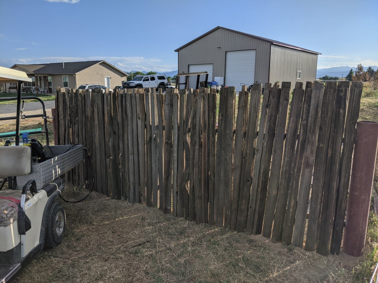

    Wanted the steel for forever structural integrity but it looks way too industrial.
    Covering it with some gnarly old weathered wood salvaged from an old dismantled split rail.
    Wired up the short fence. Wood is just laying on this long section. Not sure if I want to keep wiring or if I should lace it with some twine or something.
    Also debating on covering the gates or not.
    And just missed getting a picture of a huge coyote inspecting my work. :infantry:

    Great work. Great welds. I'd leave the wood off the fence. This way you can see who is on the other side of the gate.

    Good point.
    I also kind of have visions of a big, ranch style over head arch, whatever they're called. The 6" bollards would certainly support it. They're buried 3' in concrete.
