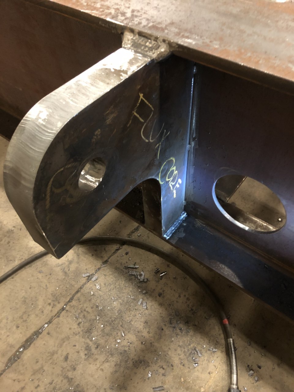

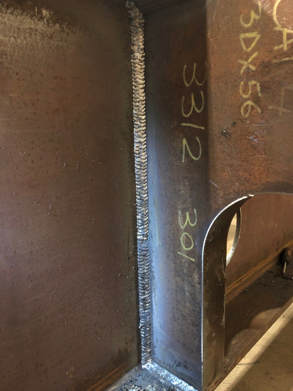

    My buddy’s work he sent me a pic of. The eyelet part is 3” thick. I was impressed.

    Whats it for? 2" hole(?) so something decently heavy since most 2" shackles are 35ish tons.

    No idea, but Its most likely an oilfield skid of some nature, so maybe they are the hook up points for the truck?

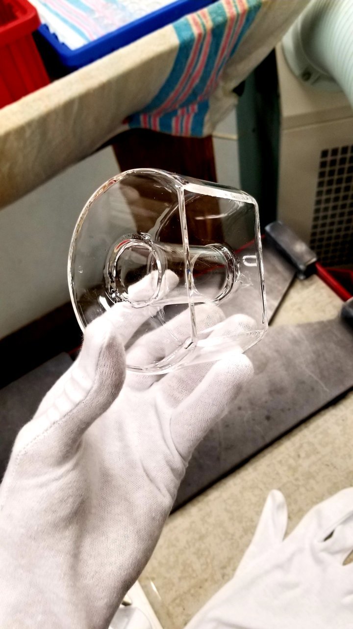

    Here's a contraption I make from time to time. No idea what it is for. I have to weld the semi discs onto the center tube, then weld that in the the ring section around it. Small, but actually pretty challenging.

    Beautiful!! Can you make a video of your process next time you weld glass? I’d love to see the process.

    That looks incredible for flux welding.

    Thanks man. I will try to get a video at some point but there are a couple of reasons its kind of difficult to do so. A) I might need a tripod and camera instead of my phone because I need both hands (of course). B) like a metal welding arc the light produced from the hot glass would glare the video to the point of uselessness. C) out of respect for the proprietary nature of our company's processes and the designs of our customers it may be inappropriate (or in breaching of non disclosure between us and customers) for me to video certain processes. However, much of it is very close to the process of metal welding. I cut my materials to the size and shape appropriate for whatever part I am making, leaving gaps for me to fill in with glass rod. I then set up the edges of the pieces im going to weld using blocks of graphite, and using a hand torch i heat the glass rod and the edges of the pieces im welding together and lay the rod into the seam. The deceptively difficult part of it is in knowing how to set my heat and what speed to lay the rod in at.

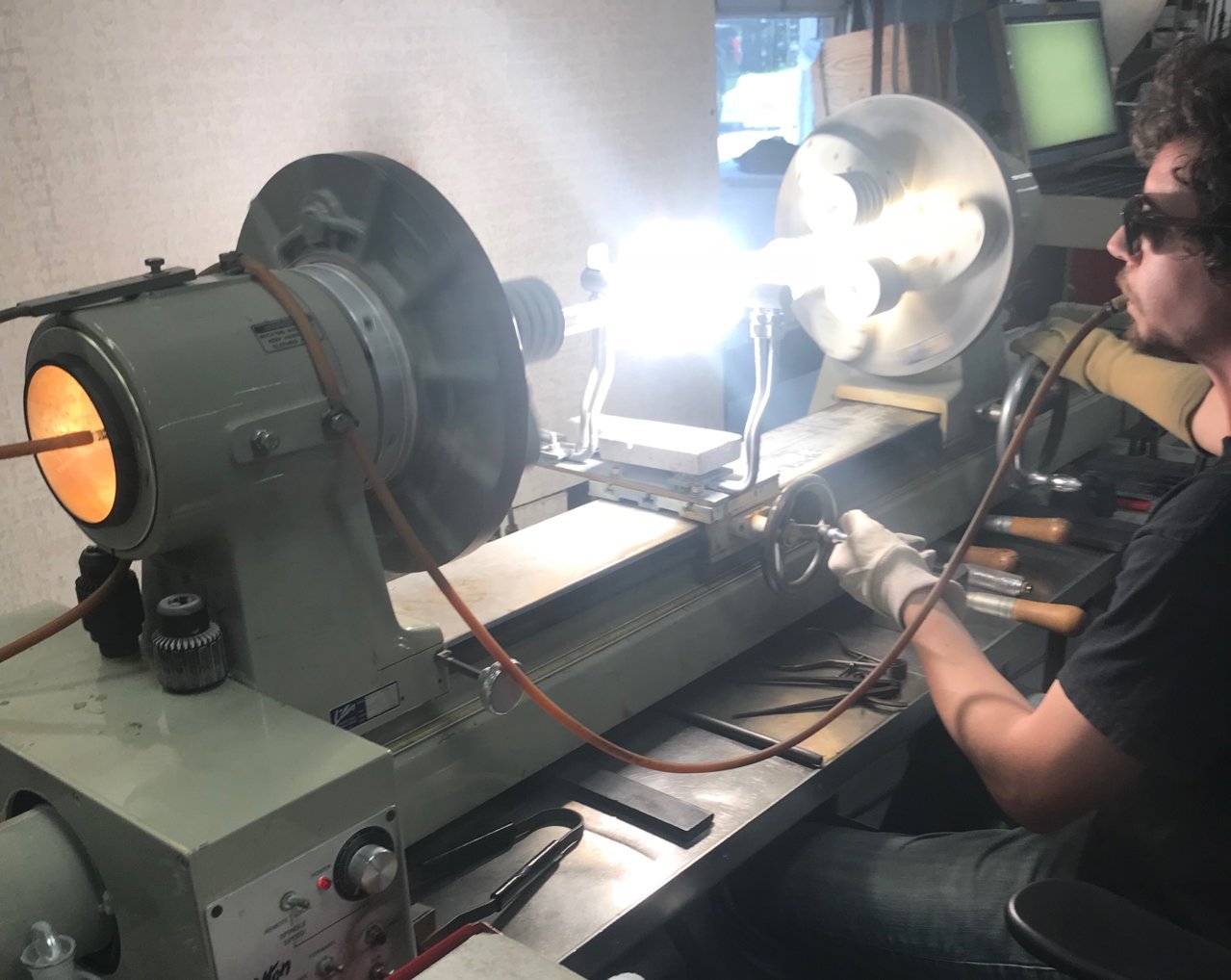

    I dont have a photo or video of me welding currently, but here's a photo of me working at my lathe, which is where I spend the other half of my time at work. This is where we make more traditional scientific glass parts like beakers, flasks, test tubes, etc...

    Its gas shielded FC so it makes a very smooth bead. But yes, the boy know how to weld.

    Makes sense on the video part. How did you get into that field? I can’t imagine it’s a widely know career. I think it’s awesome and I never knew that glass would be in a lathe.

    I pretty much got in by luck. A family friend of mine mentioned the opportunity to my parents when I was 19 and I have enjoyed it so much over 8 years. Actually, lathes are used very widely in scientific glassblowing, its an excellent way to make things round haha

    Are you blowing into the air line, or is that just an odd angle on the line? Very cool, please keep posting.

    Yep, I was blowing air into the part i was making. In that case it was an erlenmeyer flask I was making as a demonstration at our shop. Im glad you guys seem to find it interesting! I hope it isn't too much of a departure from the main vein of this thread.
