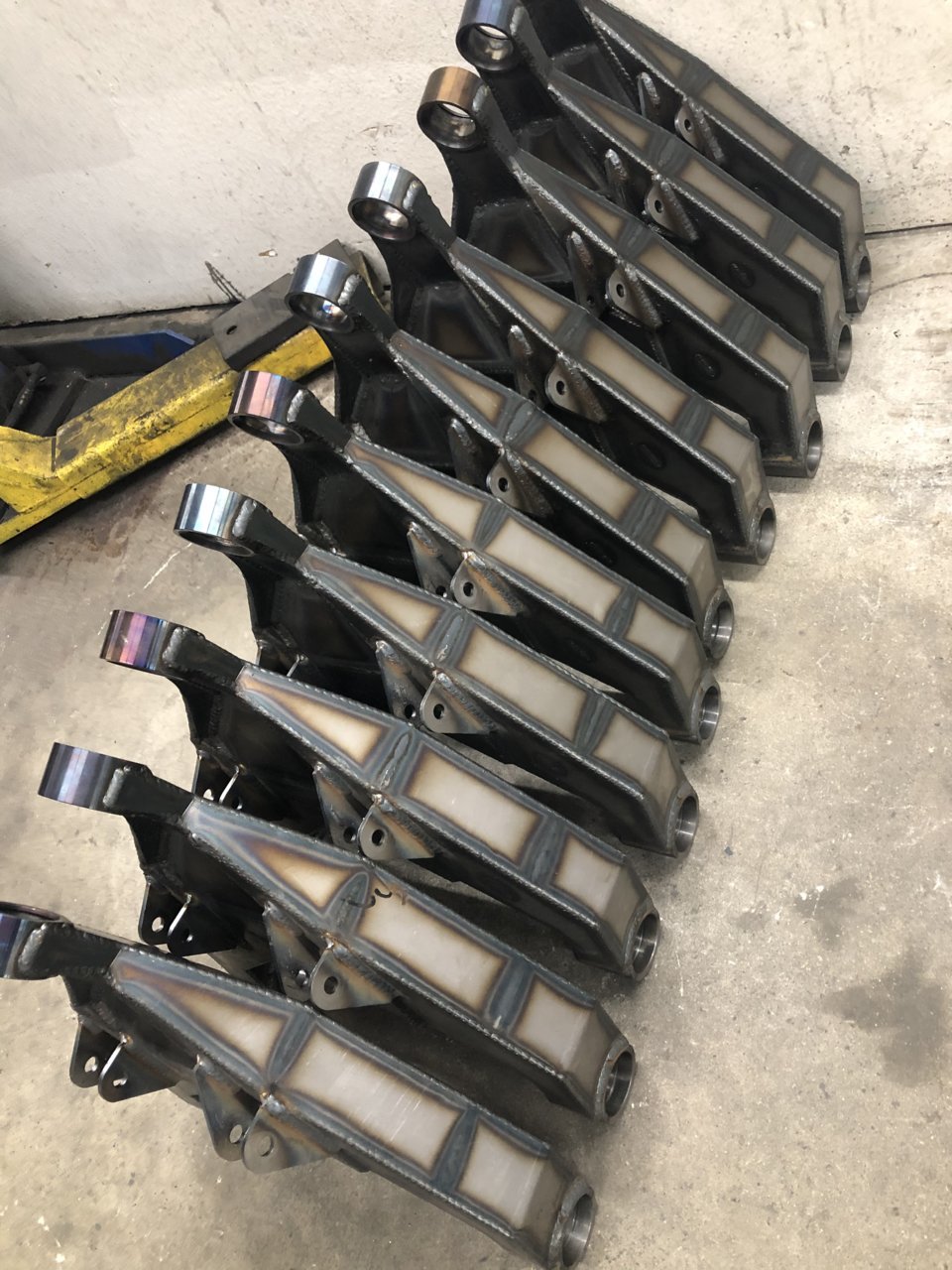

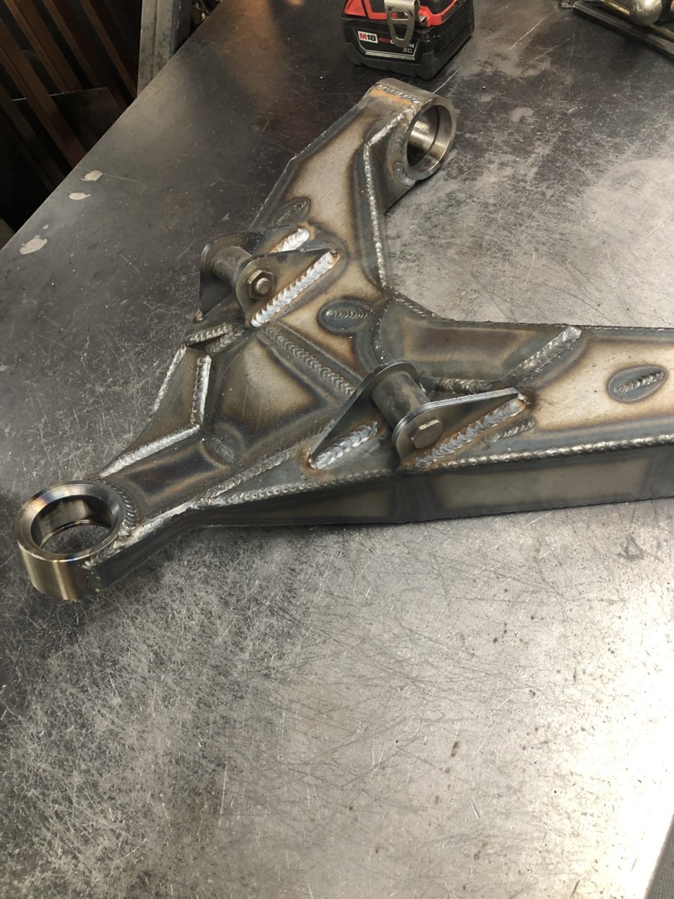

    Bunch of stuff

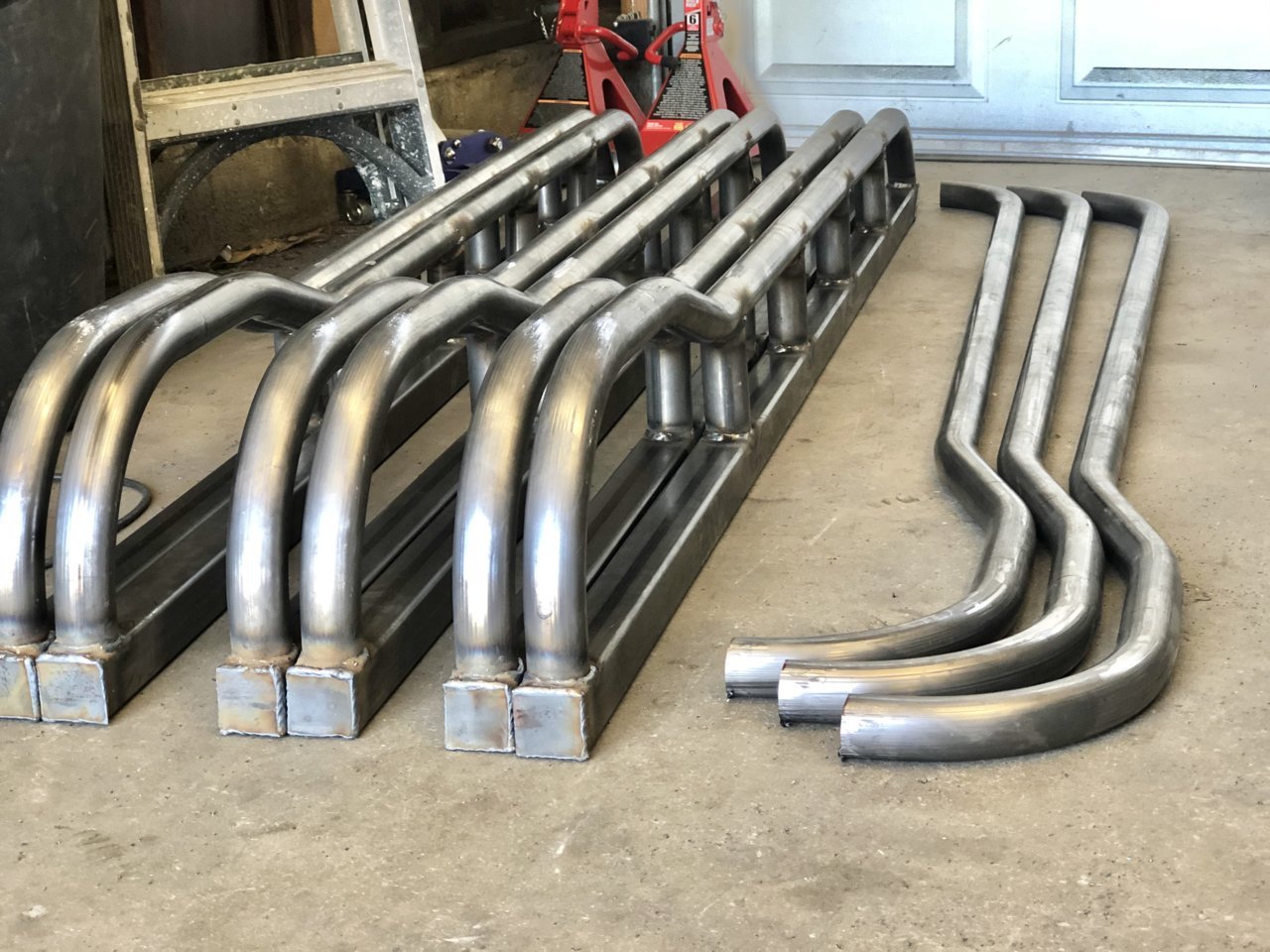

    Trying to chip away at the rock slider orders. Made a little progress today. Only 19 more sets to build. :annoyed:
    WyldeRayne06, deeezy, jubei and 7 others like this.

    Those look awesome man.

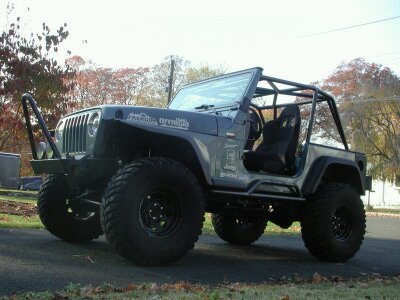

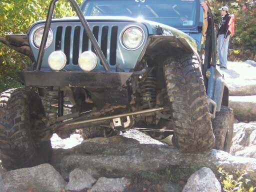

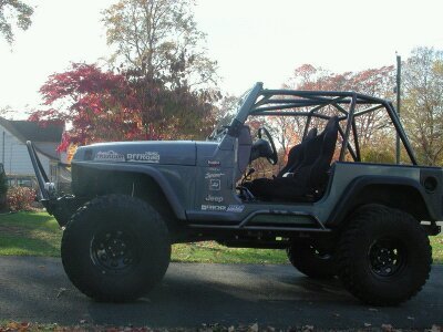

    Whoa.. that looks dope. I made a cage for my old TJ after my shift hours and on weekends for a little bit. Also made front and rear bumpers, steering box skid, sliders, two different versions and a hand full of winch bumpers and stingers for peeps. I miss it but I don’t necessarily miss having to have multiple sets of clothes to change into so I didn’t get my truck dirty on my way home...
    53717CF4-2C46-491C-97D3-6AA41BC83C20.jpg 4FE766DB-50FE-4976-B719-B89914CBEAA4.jpg 1AB13E54-C079-458D-8125-E9A81394519E.jpg
    I made a half cage at first... you can see the difference in pic 3. The full cage I built was one of my greatest welding achievements.. I built it on my own, bent it on my own, no measurements, no help, I took with with a crane. I loved that Jeep.... Also... I wasn’t old enough to drink yet... man, if I was I am sure it wouldn’t have come out so good.. LOL
    hard to believe that was nearly 15 years ago...

    Thanks man! I appreciate that

    I love fabrication of any kind. I really wish my 2wd had any hope of seeing some trails so I could justify owning some of your sliders.

    That means a lot man. I’ve built quite a few sets for 2wd guys haha. So never say never lol

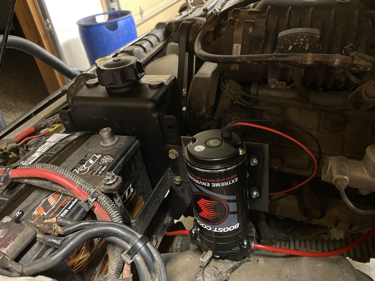

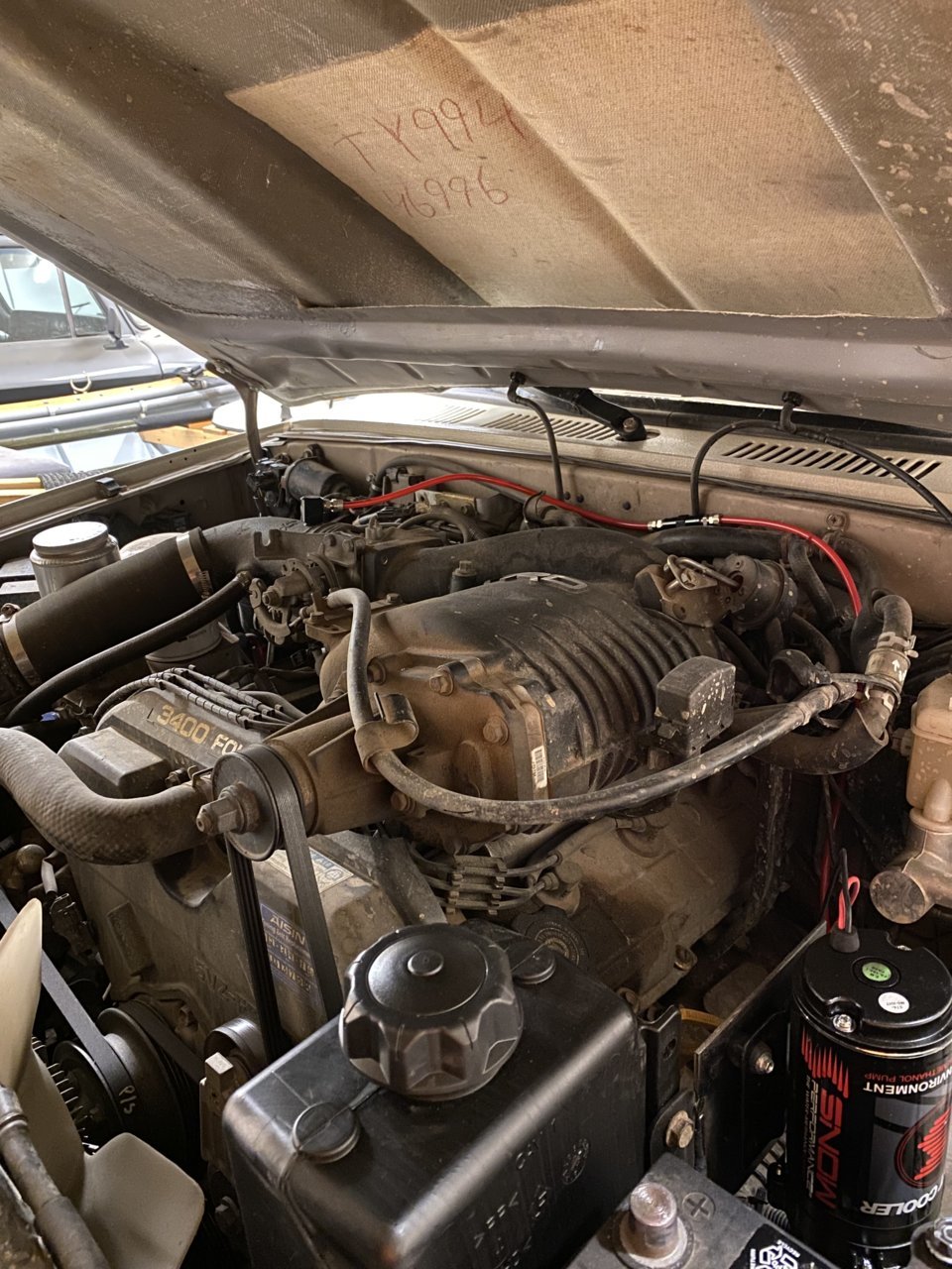

    Kind of crummy pictures but i whipped up this mount for my water/meth injection tank and pump on my crawler last night. tank hangs of existing 1/4" battery tray and pump is off to the side. After I build the mount for the tank, I read the install instructions which state the pump needs to be mounted below the reservoir. Hoping this helps it run cooler/better under WOT.

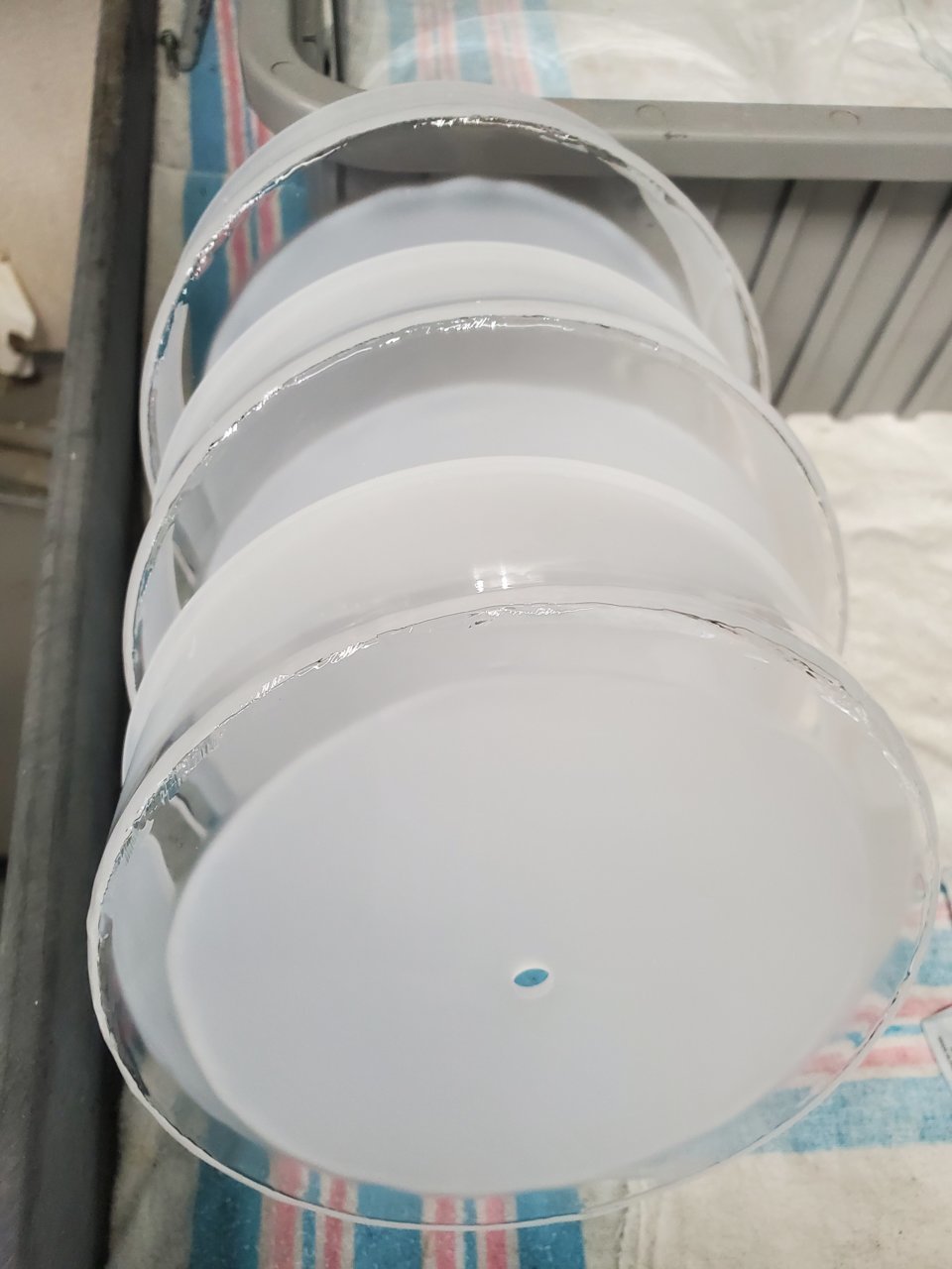

    I welded up some more parts for a customer yesterday, thought I'd show them. All thats left to do is grind the weld smooth then the whole part gets sandblasted. One way glass differs from metal (i think) is that when you heat it it creates strain within the part that weakens it greatly. The way we fix that is by annealing it in an oven which heats the whole part up evenly, removing the strain.

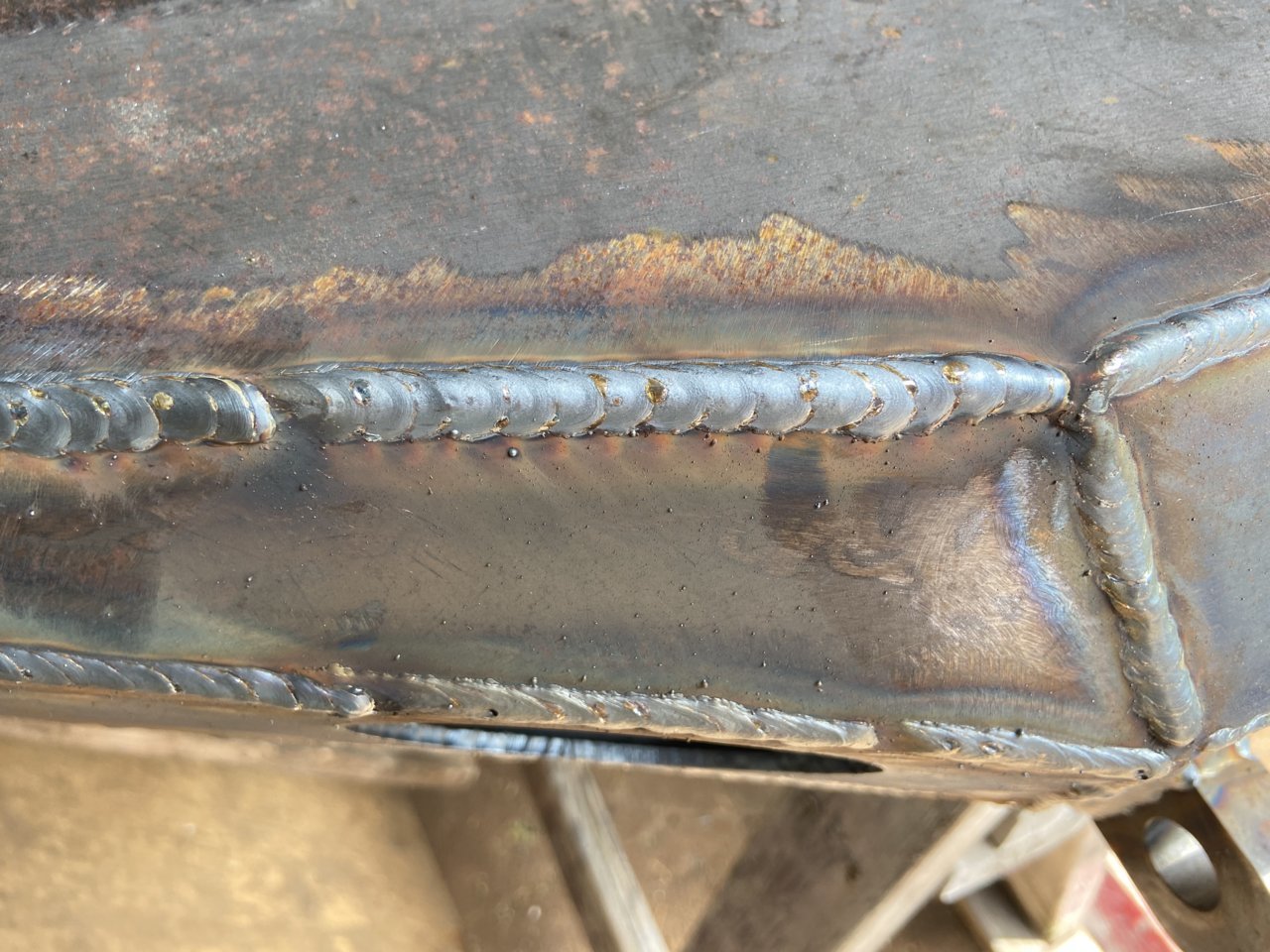

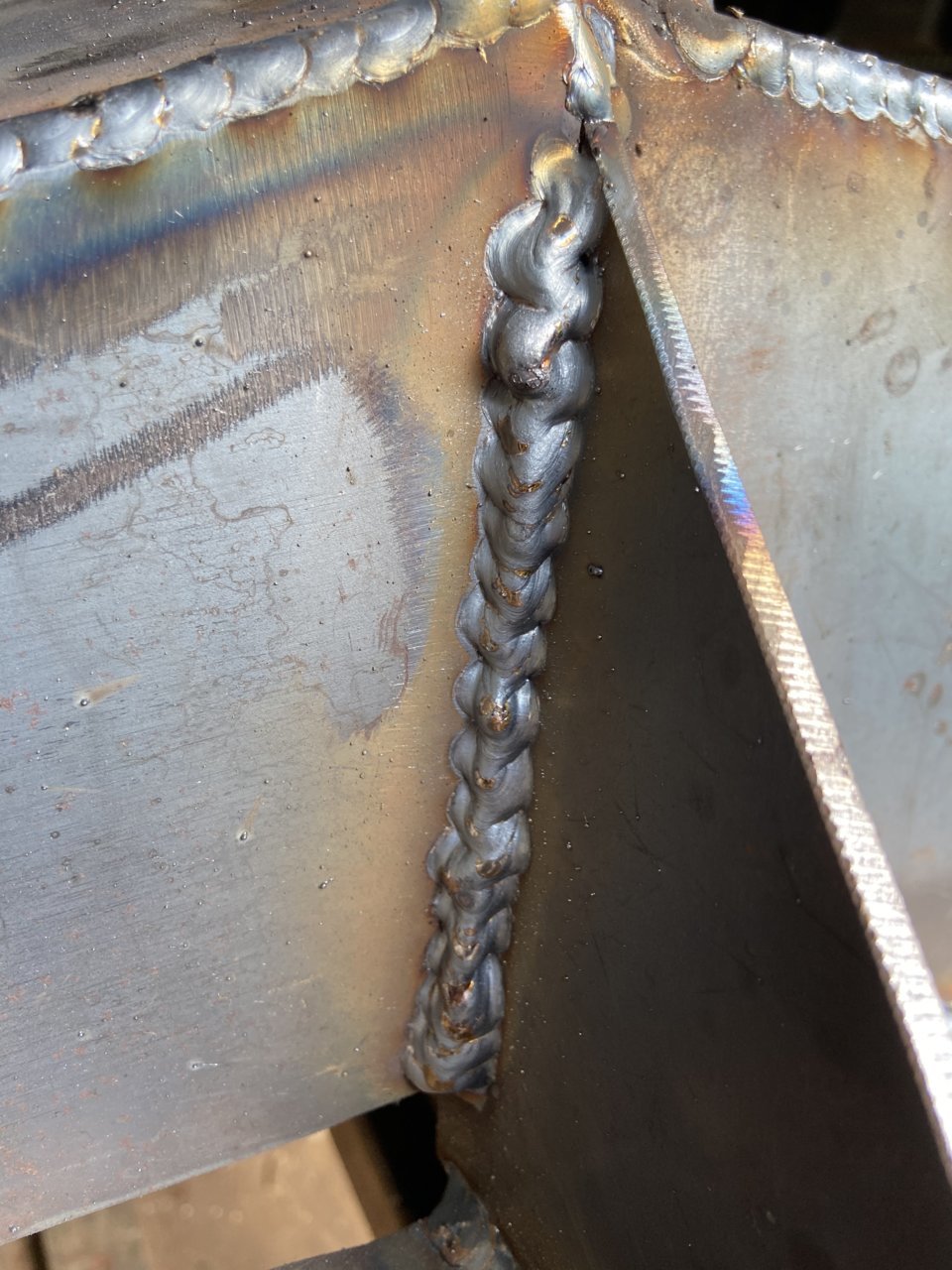

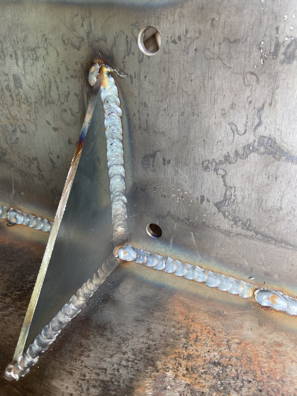

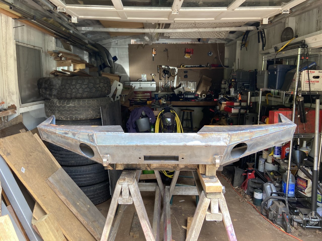

    Pics of my progress as promised.
    I can’t wait to move and :fingerscrossed: get a real shop, but I’m grateful I have some place to call a shop.
    bumper with crusty shop
    A couple shots of some welds
    an attempt at uphill....:anonymous:

    Uphill is hard man! I haven’t practiced it any, but my uphill beads are shit.
